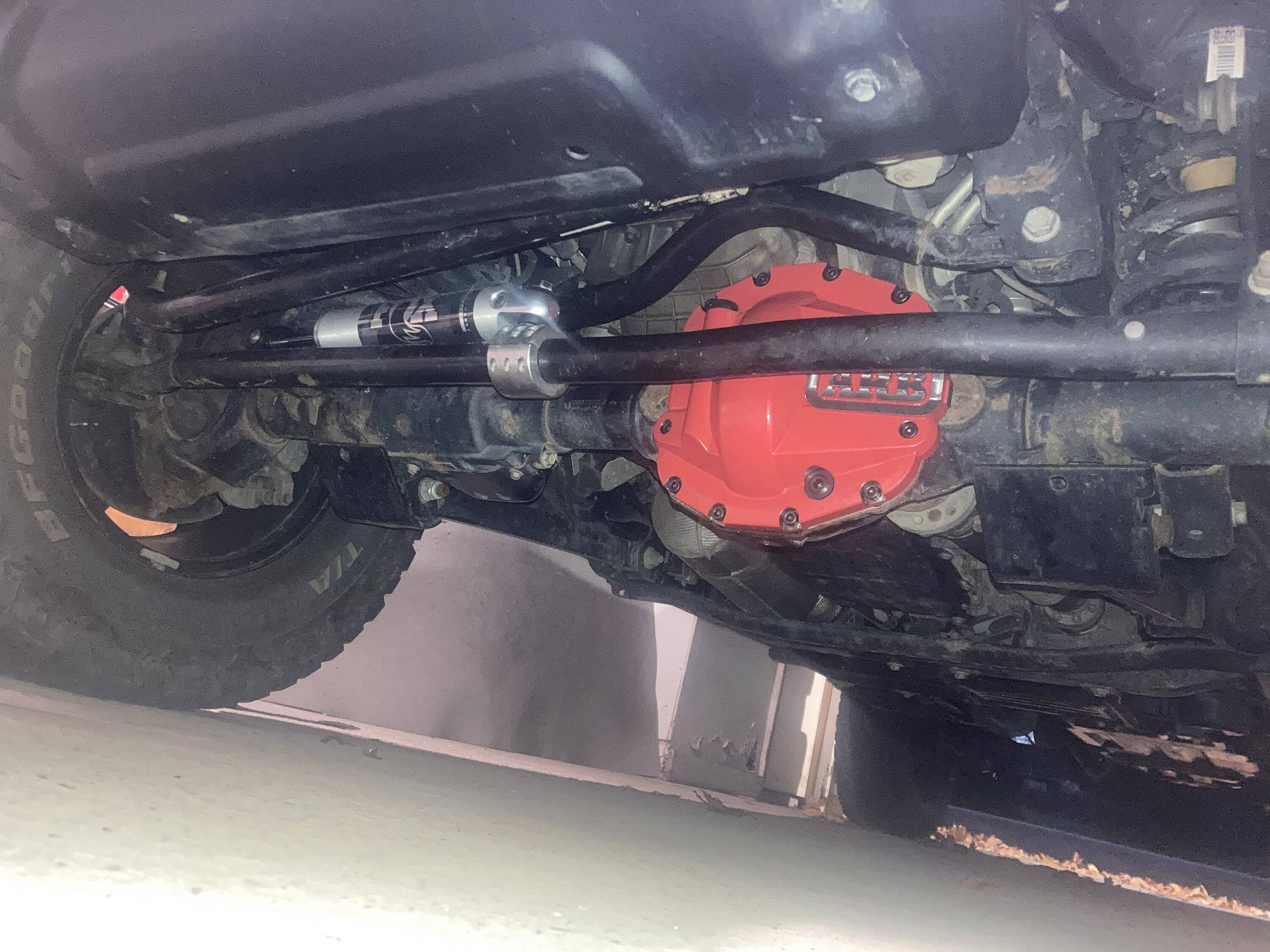

I took out a steering dampener and dented some stuff up front on the blues at AOAA. Getting home with wobble was not fun, but if one of those rocks smacked the front diff cover, there'd be no getting home. I switched to ARB covers front and rear after that, and have not worried about it since.
I think the ARB design is among the best at incorporating what the Banks videos show, and understanding what rocky trails require. If you're going to put the rig in a situation where a big smack from an unforgiving object is a possibility, get the covers or some good skids. You'll sleep better.
Jeep Gladiator Aftermarket Diff Covers? Hype or Help? IMG_2731
PS: I've since added an engine and tranny skid, which I'd recommend as well.
