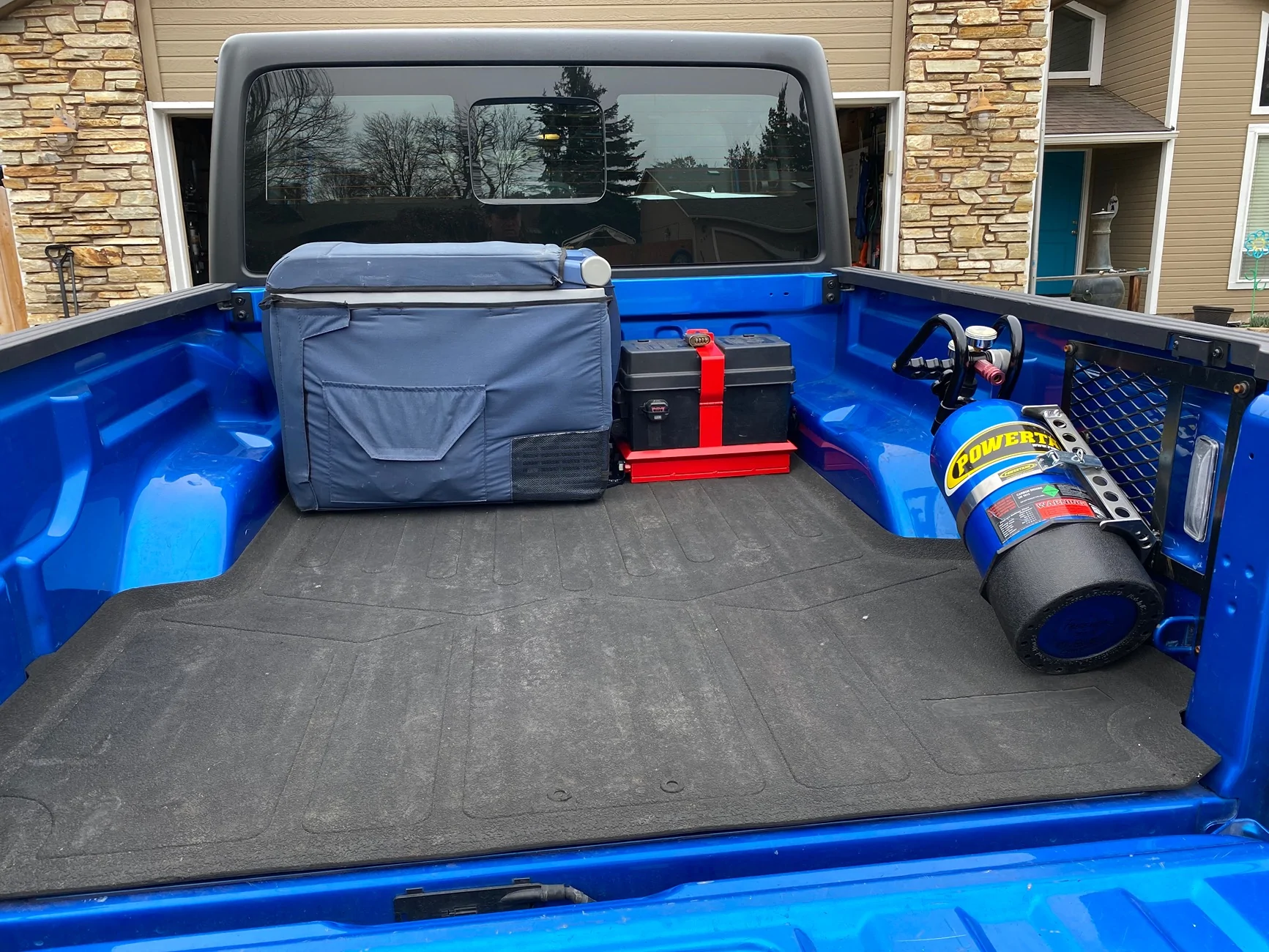

Only problem with co2 (power tanks) is that carbon dioxide molecules pass through tire rubber a lot easier than air molecules. I've got one, and the tires loose 3-5psi/week. I will fill up after a day of off roading, but always dump and refill with air when I get home
