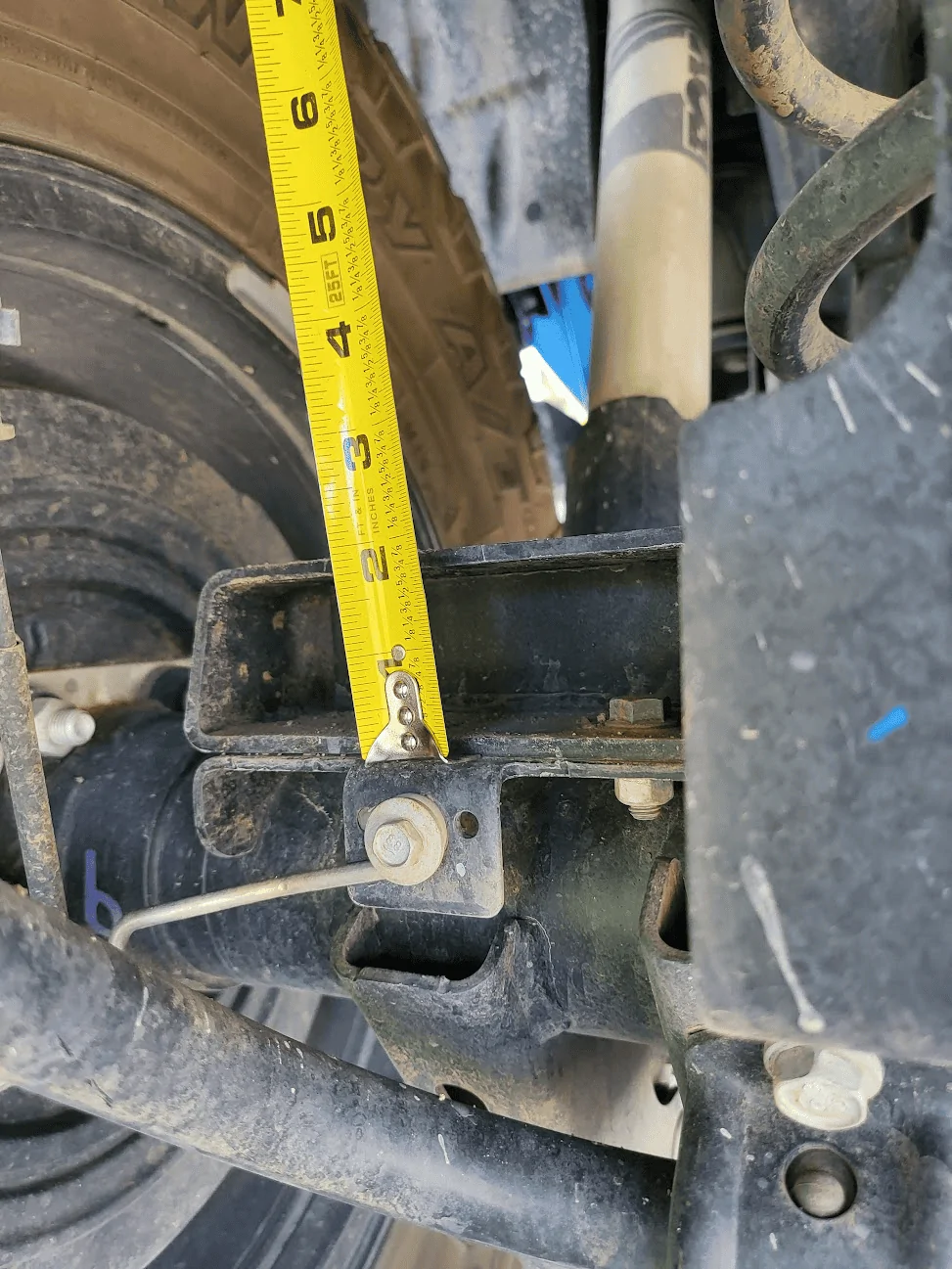

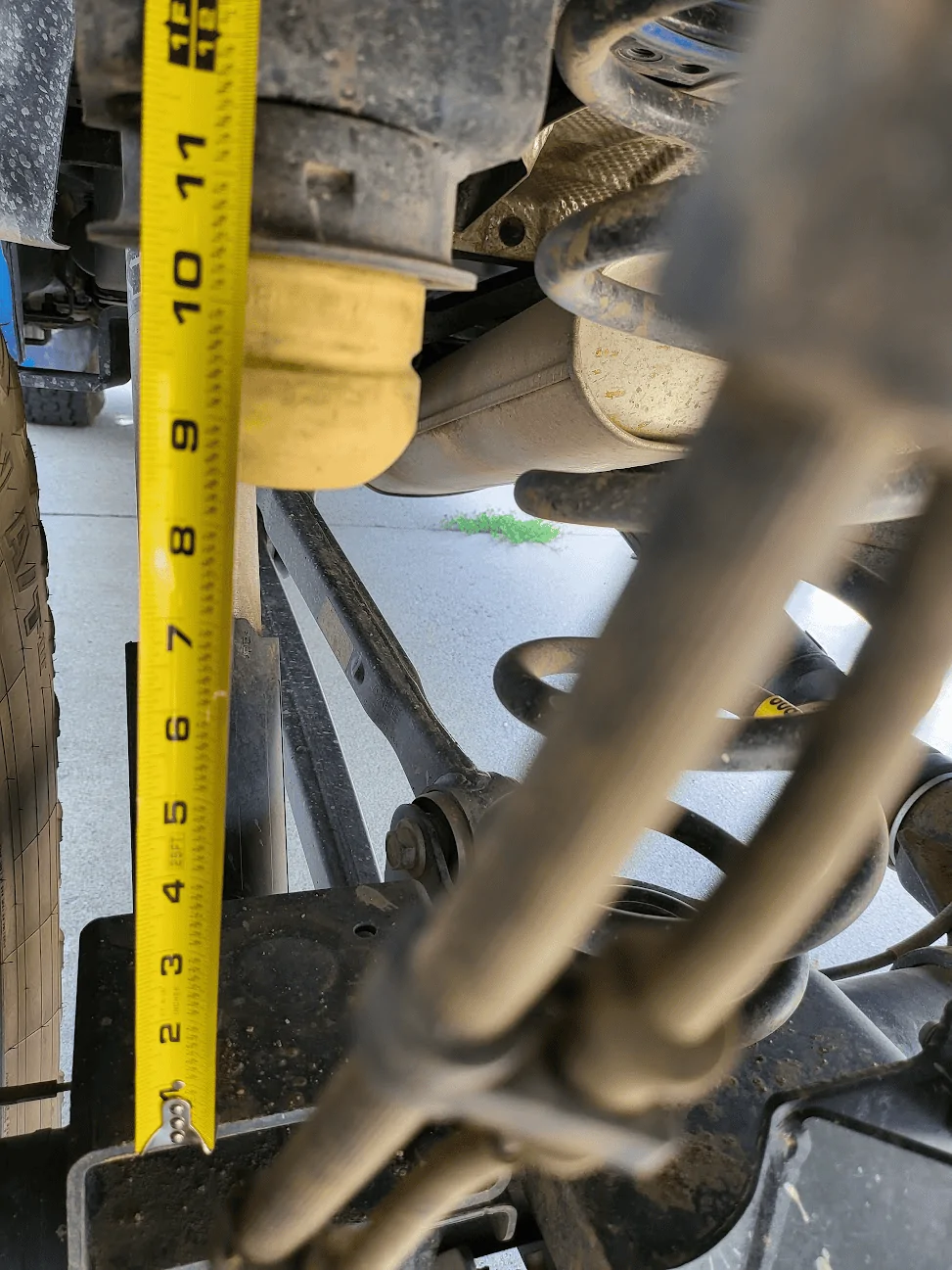

I just went out and got the measurements on mine with the Mopar lift at full droop. I measured it at 10.5 Inches.
Jeep Gladiator AirLift rear bag system - info you need to know 1661452970507
I also wasn't sure if the plate on the bottom was part of the lift or on all Gladiators so I measured it at 2"
Jeep Gladiator AirLift rear bag system - info you need to know 1661453025523
I did not measure it at normal height tho as I have a rack with a tent on it at the moment and that probably skews the measurement a bit.
There ya go.......That's a 2" bump spacer and you could just drill 2 holes in the top of that spacer for mounting. Hard to say what your actual bump spacing will end up without knowing what inside of that air bag.

There ya go.......That's a 2" bump spacer and you could just drill 2 holes in the top of that spacer for mounting. Hard to say what you actual bump spacing will end up without knowing what inside of that air bag.
That would be promising, then an extra space may not even be necessary or they could just make one to replace the existing one I guess.
Awesome, thanks so much for doing that!
I will pass this measurement along to Timber Grove. I have an RSI Smartcap on my Jeep so my "normal ride height" measurement will also be a little skewed. I may just take it and send it over to Timber Grove with the caveat that I have more than stock weight. I would guess that it would at least give him enough info to know if the stock kit will work or if the Mopar lift will require a spacer/mount.
