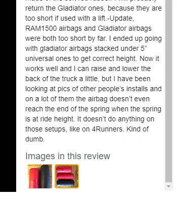

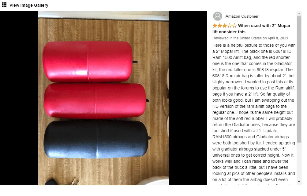

Just saw this review on Amazon:
I wonder how they aired up the lower bag when they stacked them, unless there's a way to get the air line in through the bottom... ?

I’ve seen that review, too. I don’t get the stacking

Also saw that review...stacking doesn't make sense and they seem to think that the bags work by expanding up and down within the springs, which isn't correct as far as I understand it (they work by expanding sideways into the springs).
