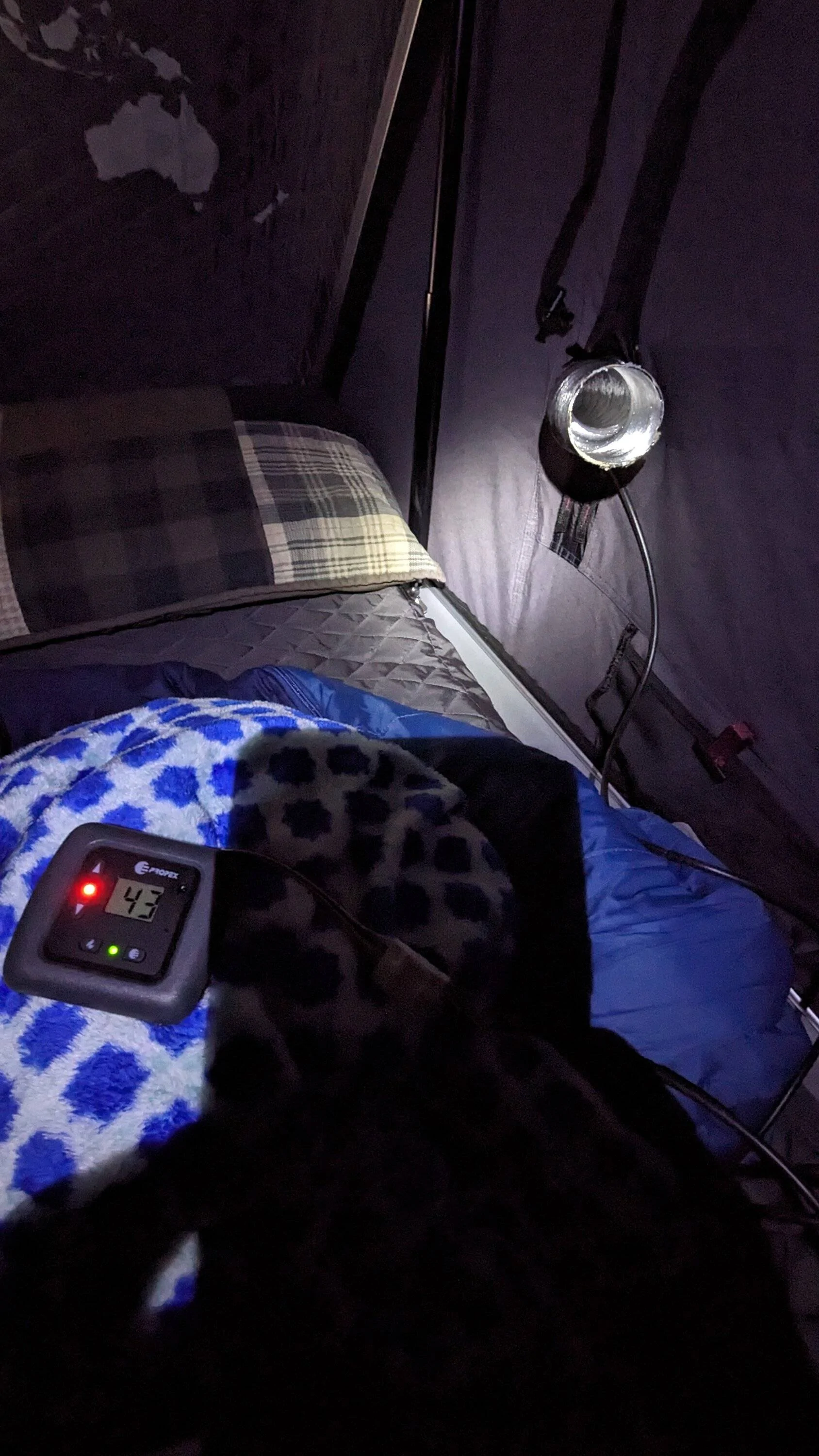

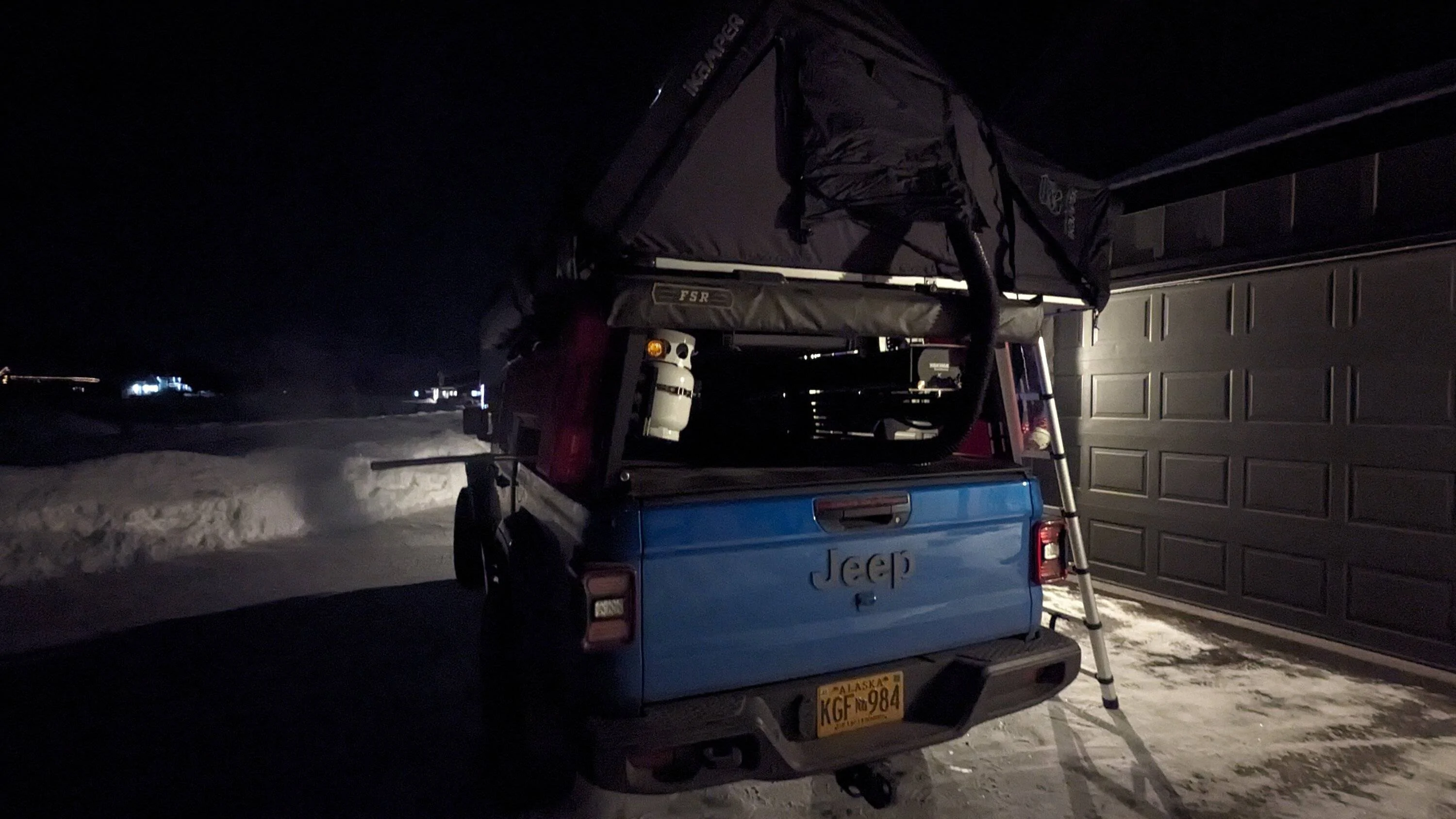

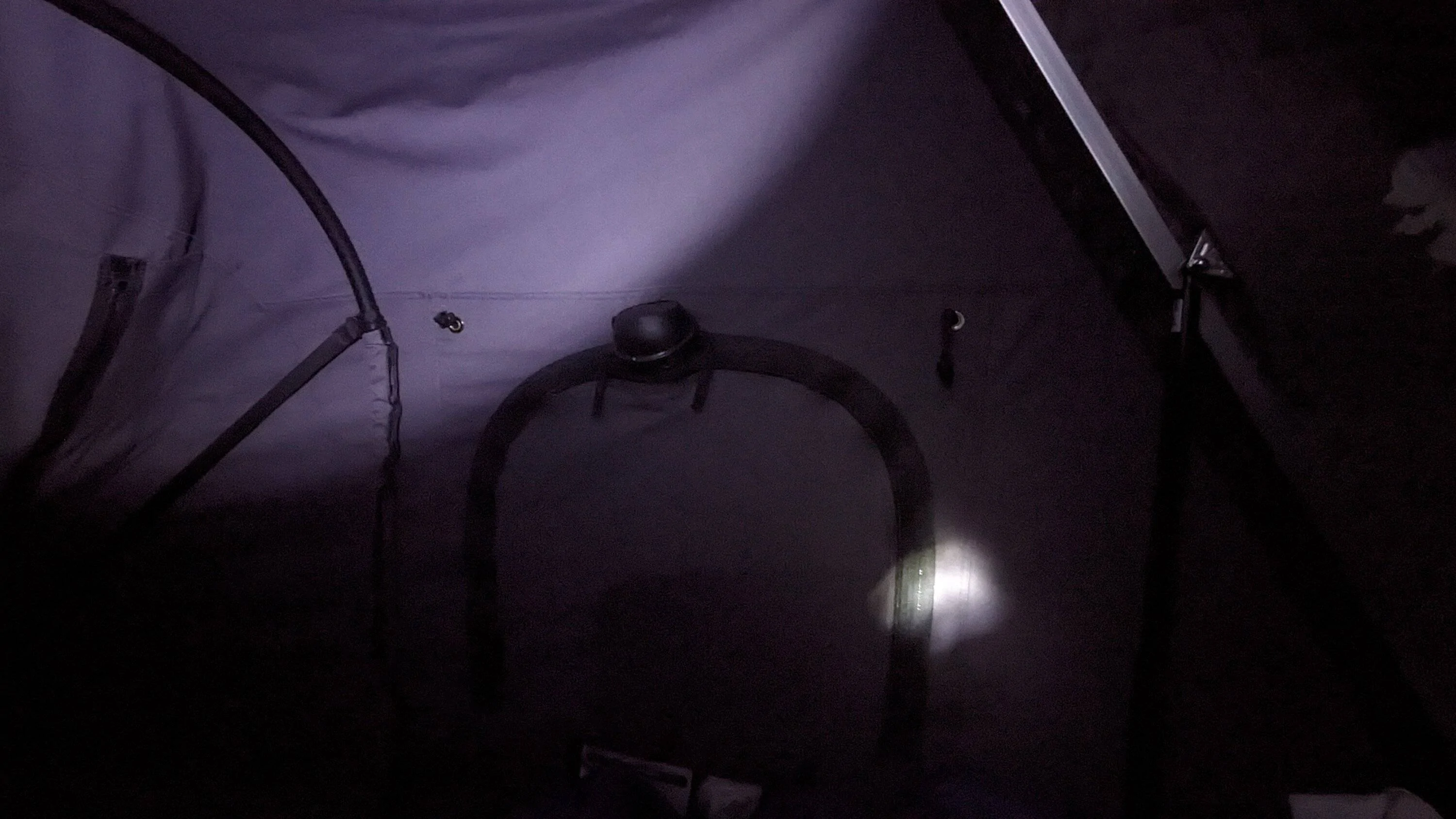

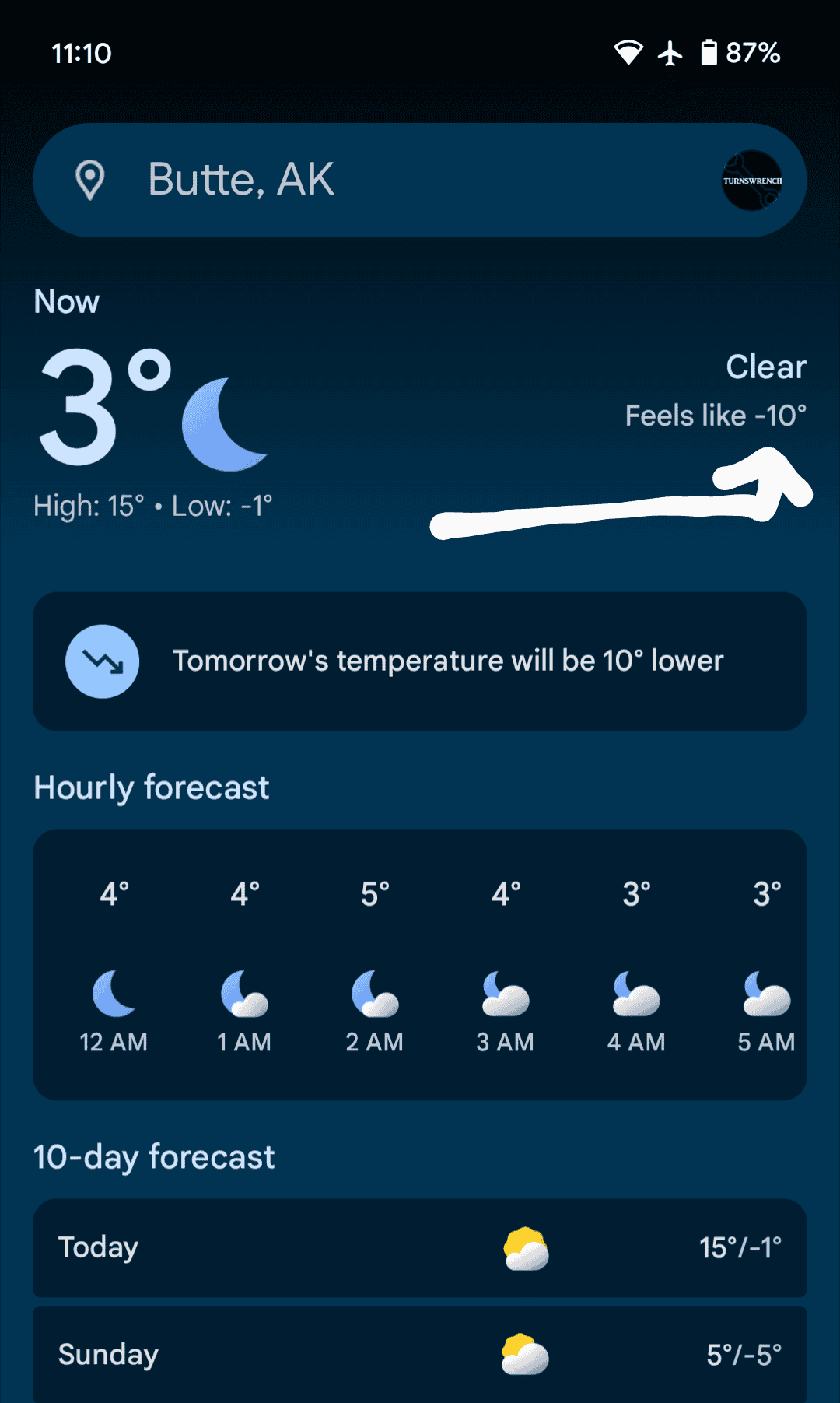

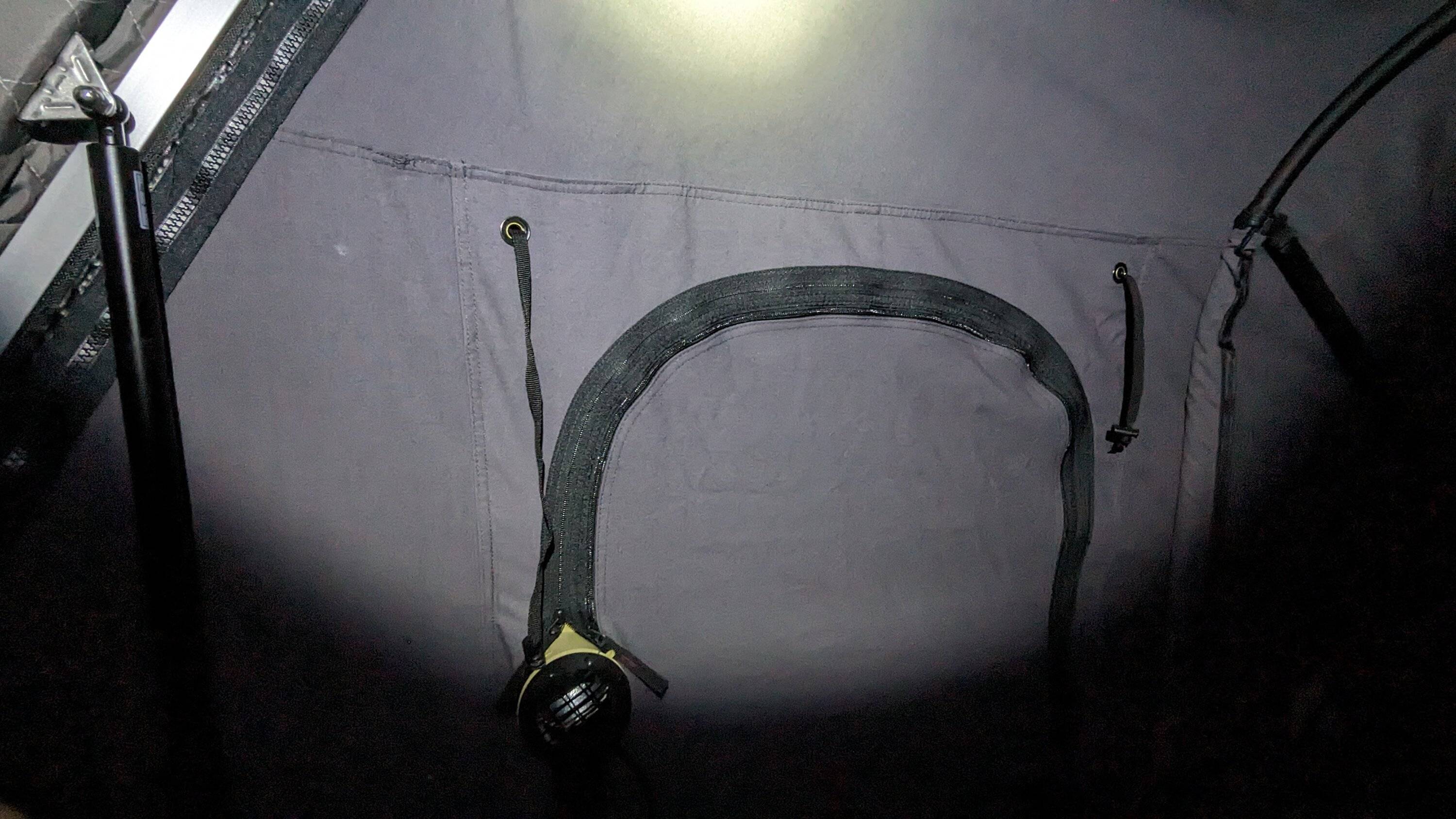

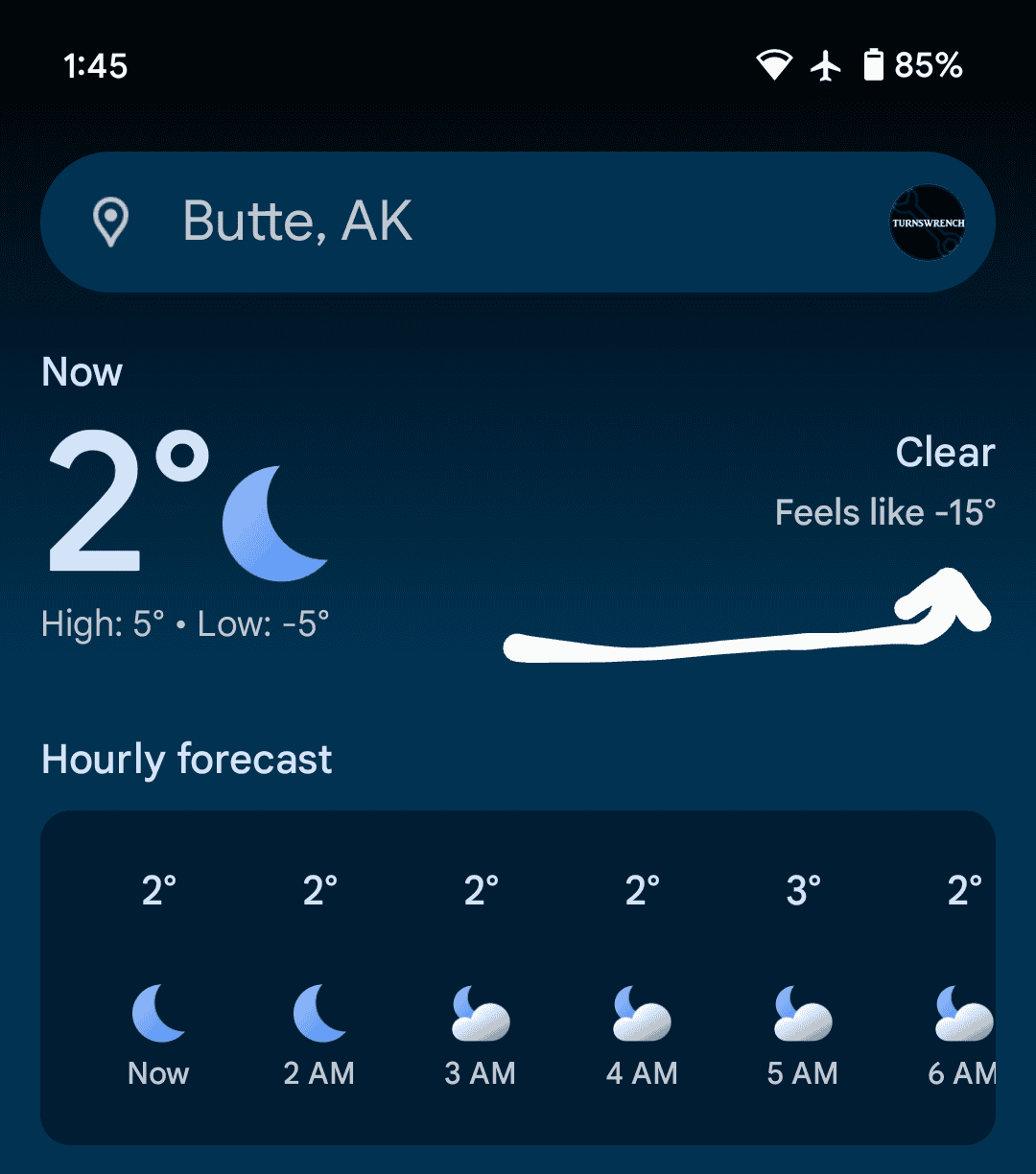

First test of the Propex is still happening ? I'm in the tent, the furnace is running, it's cold outside, but I'm in the driveway so the Wi-Fi is awesome. ?
The wife and I weren't prepared enough to get out on the road this weekend. It was the plan but with some extreme temperatures around, we decided to play it safe and test the setup in our driveway first. Better safe than sorry.
It was warmer at our house than up north, so that's a bonus for a trial run.
Sleeping attire:
Grey sweatpants, T-shirt, wool socks, hoodie/zip up. For Hudson, a sweater.

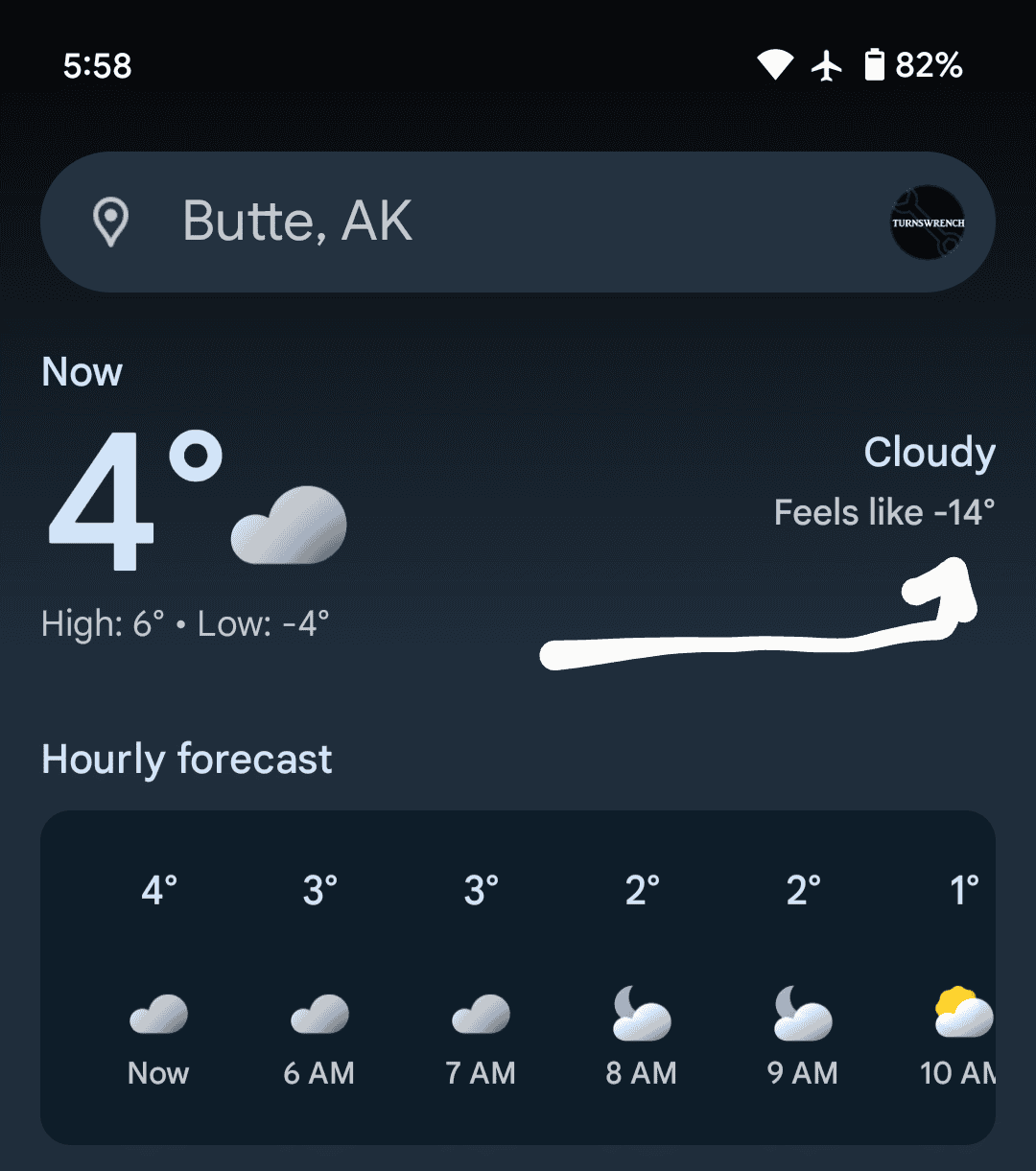

Weather conditions:
2-4° with wind chill down to -15°.
Tent preparation:
Exped dual person sleeping bag, good for 40°. No insulation liner, just the tent. No condensation mat, just the iKamper thin mattress. Large fuzzy blanket for Hudson. Fullsize pillows.
Time of setting up camp:
11pm Alaska time. Tear down TBD since I'm still out here.

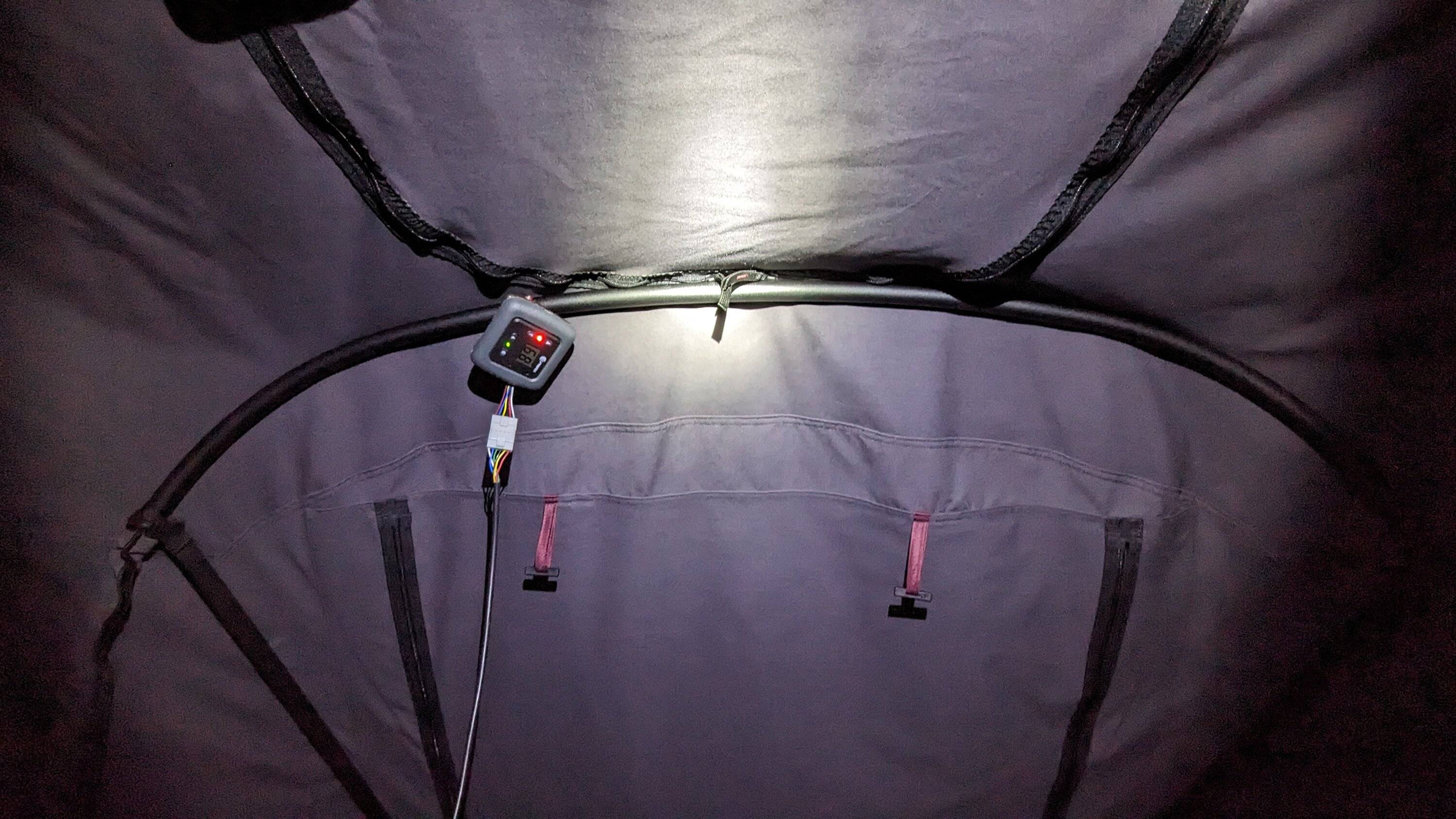

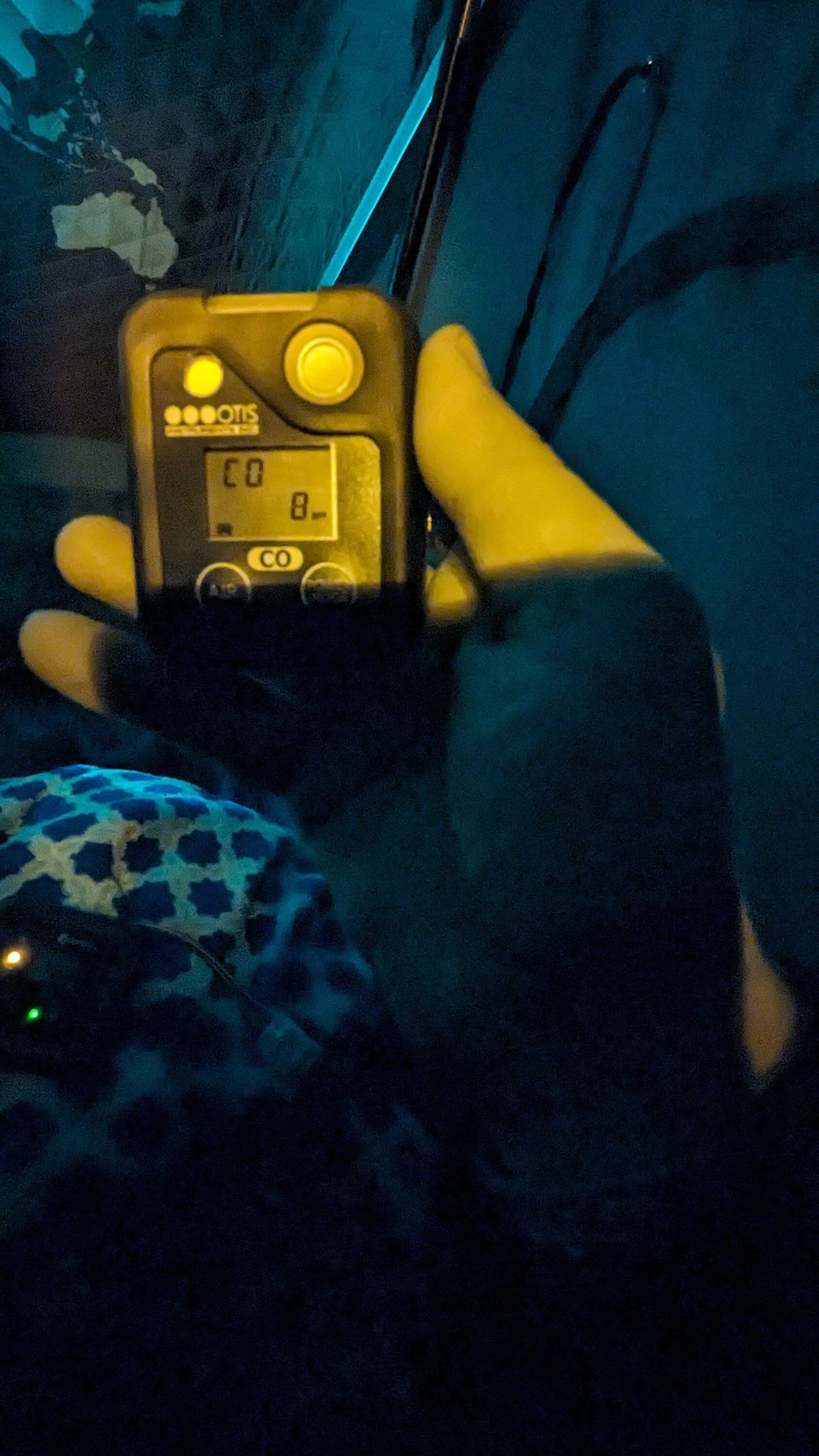

Carbon Monoxide:
The detector read between 2-10ppm throughout the night. No alarms. It was hung center of tent at the top.
Thermostat:
Started with the thermostat at the bottom of the tent near our feet and the main door. Checked it throughout the night and it was showing that we were losing temp. I moved it to hanging over our knee area from a bar and got more stable readings. It was too close to the tent wall previously in my opinion.
Propex heater duct setup:
Heated air coming in through window on one side and the return air heading out the window directly opposite the heat. They are set at two different planes.
Comfort:
I'll sum it up. Feet frozen. Torso okay. Wife and dog left around 6am. The hot air does not sufficiently warm the tent at these temps with no tent insulation. The aluminum floor of the tent is ice, ice, ice cold. The noise it the heater is basically nothing. You just hear the forced air coming into the tent like you do your furnace at home (if you have forced air.) I don't hear the exhaust at all.
The heater has been running non-stop since 11p and it's chilly in here. Right around the heater duct is wonderful, but it never got the sqft warm enough for the thermostat to kick off the heater. The air is hot, dry, and forceful out of the duct. No concerns with the output. It just isn't enough to cover the lost heat through the tent and the freezer floor.
There is no condensation. Zero. This is not a propane buddy heater with wet heat.
Where do we go from here?
  • The floor of the tent needs addressed. Either a coating, flooring, or a better mattress that insulates the body from the cold material. Currently iKamper is sold out of what they say their solution to this problem is, an inflatable mattress.
  • The insulation tent liner should have been installed. This would have cocooned the heat in and kept us much warmer. I honestly believe this may be all that is needed to solve any challenges we had overnight. We own the insulation liner and have used it with great success. I just thought the Propex would be too much heat for the liner. It is not. Now we know.
  • The heat duct needs split. I plan to run the heat into the tent in two places next time to balance the temp across the tent. Propex says you can split it up to 3 times. This will help the toes stay warm. But again, the insulation liner may solve for this.
  • Different or better provisions in the tent. We kept it simple with the blankets and sleeping bag because I was confident that we'd get baked up here if we brought too much. That didn't happen.
This is why we tested things out to learn the boundaries. The tent is in the 60s right near the vent. I'm getting a reading now of the temp at the feet, update, it's 20°.
The amp draw was 2.4-2.5 amps consistently. This is running the heater, the fridge, the switch panel, the Redarc battery monitor, and the heater circuit for the battleborn lifepo4 battery.
I haven't gotten out to check propane, but it's still running non-stop. We're at 8 hours now using a 5lb tank.
Overall I'm still happy with the convenience of this. Once I sort out some details (or simply put the insulation liner in ?), it's going to be the perfect package.
Heading up to bed:
Checking out the Propex exhaust sound:
Getting the tent warmed up:
Okay, let's try to sleep now that the CO detector says it's safe:
We woke up every hour to review everything. It was far too cold for Hudson ?
Note the times and the temps for reference:

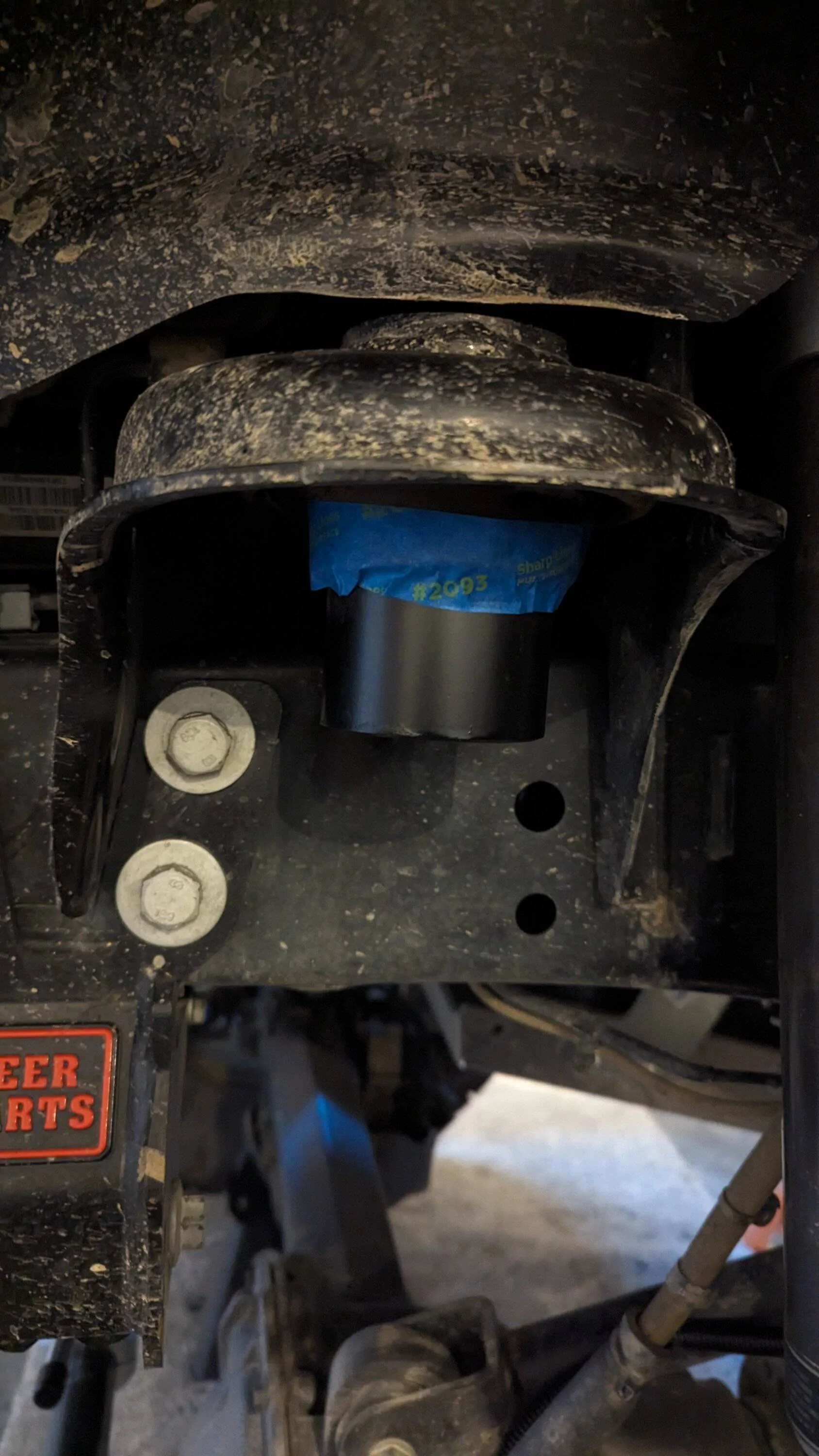

Didn't feel too hot this week. The wife did a great job keeping the house going and me alive ?
We got some garage therapy today though!

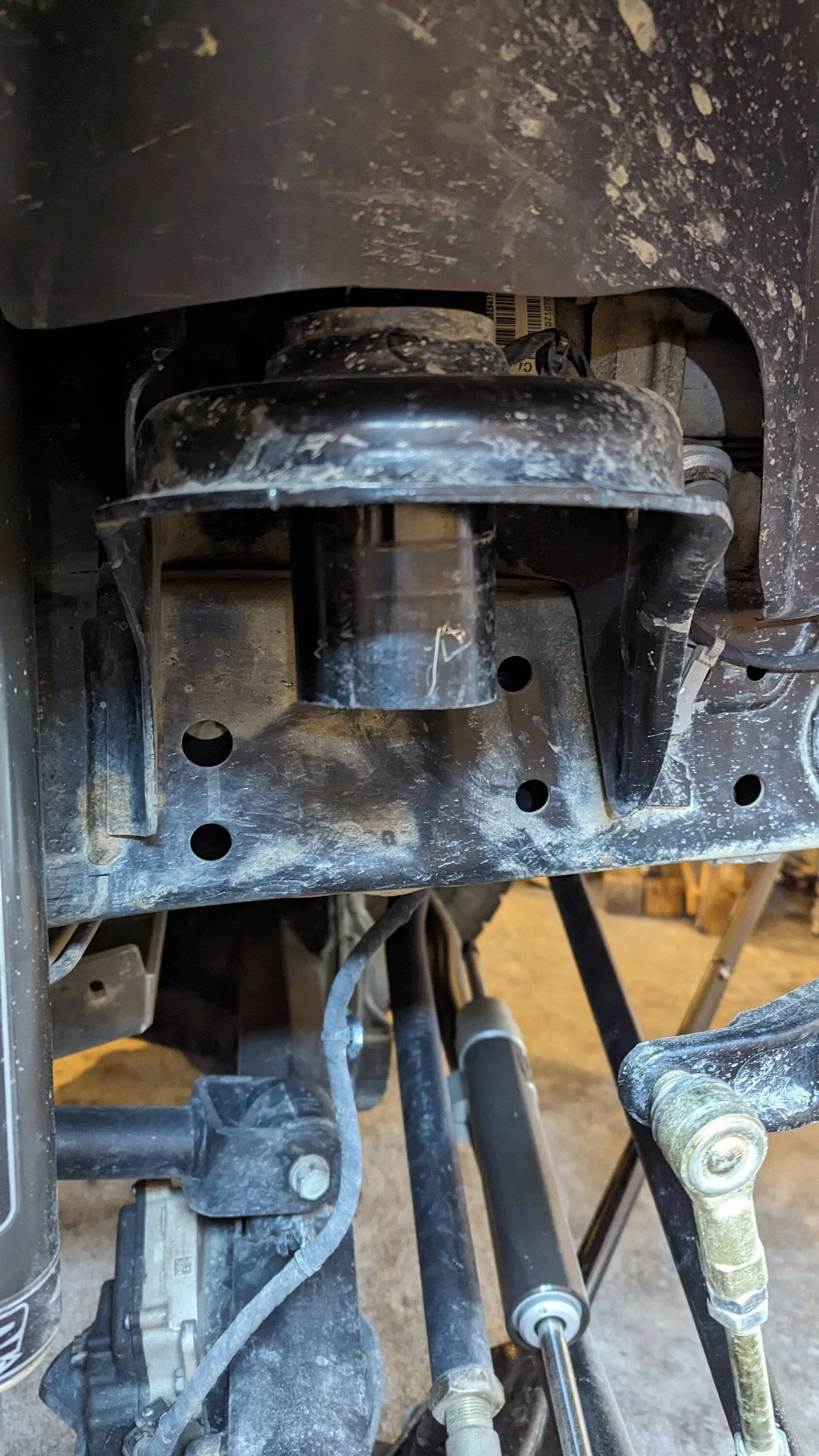

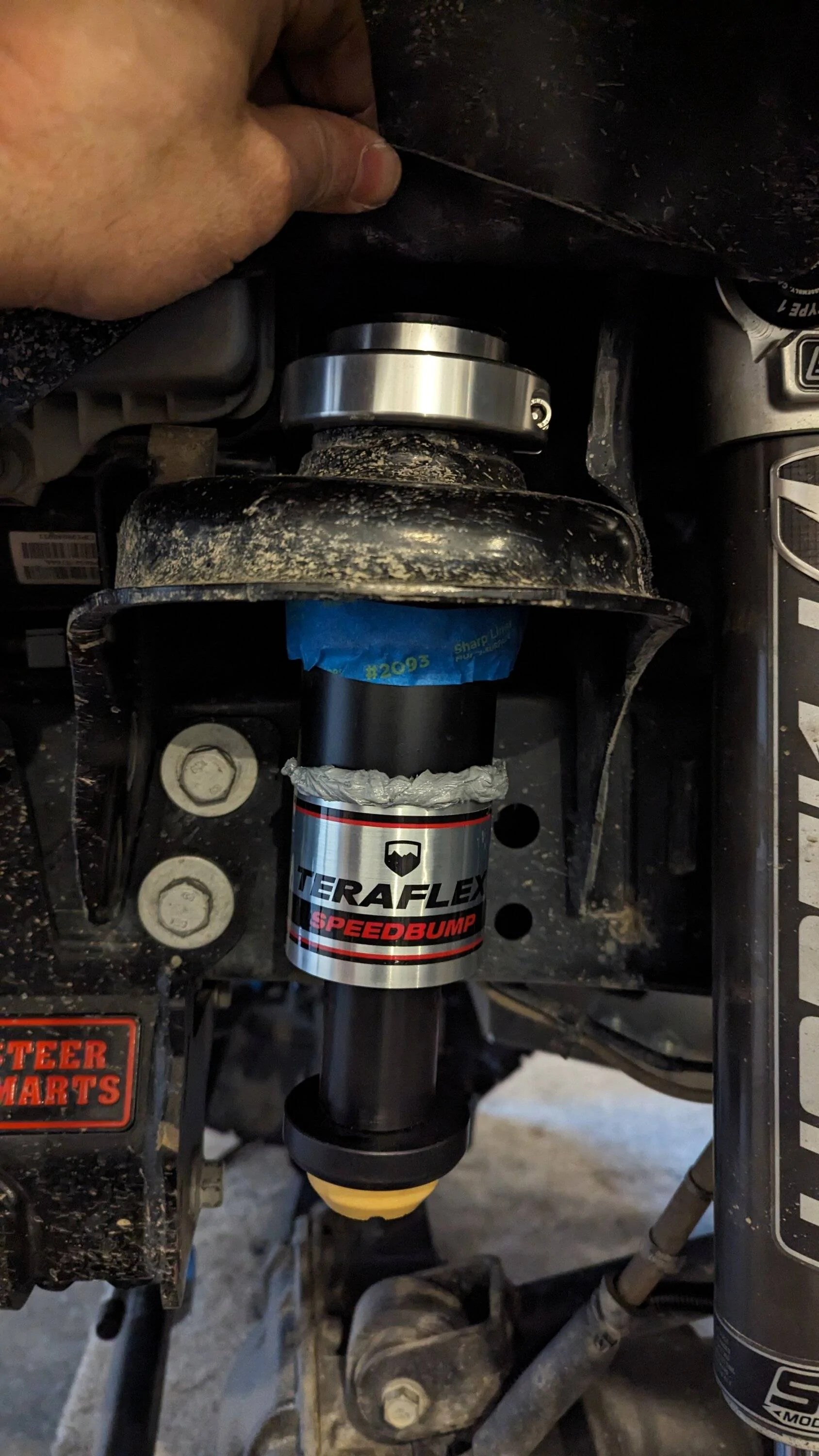

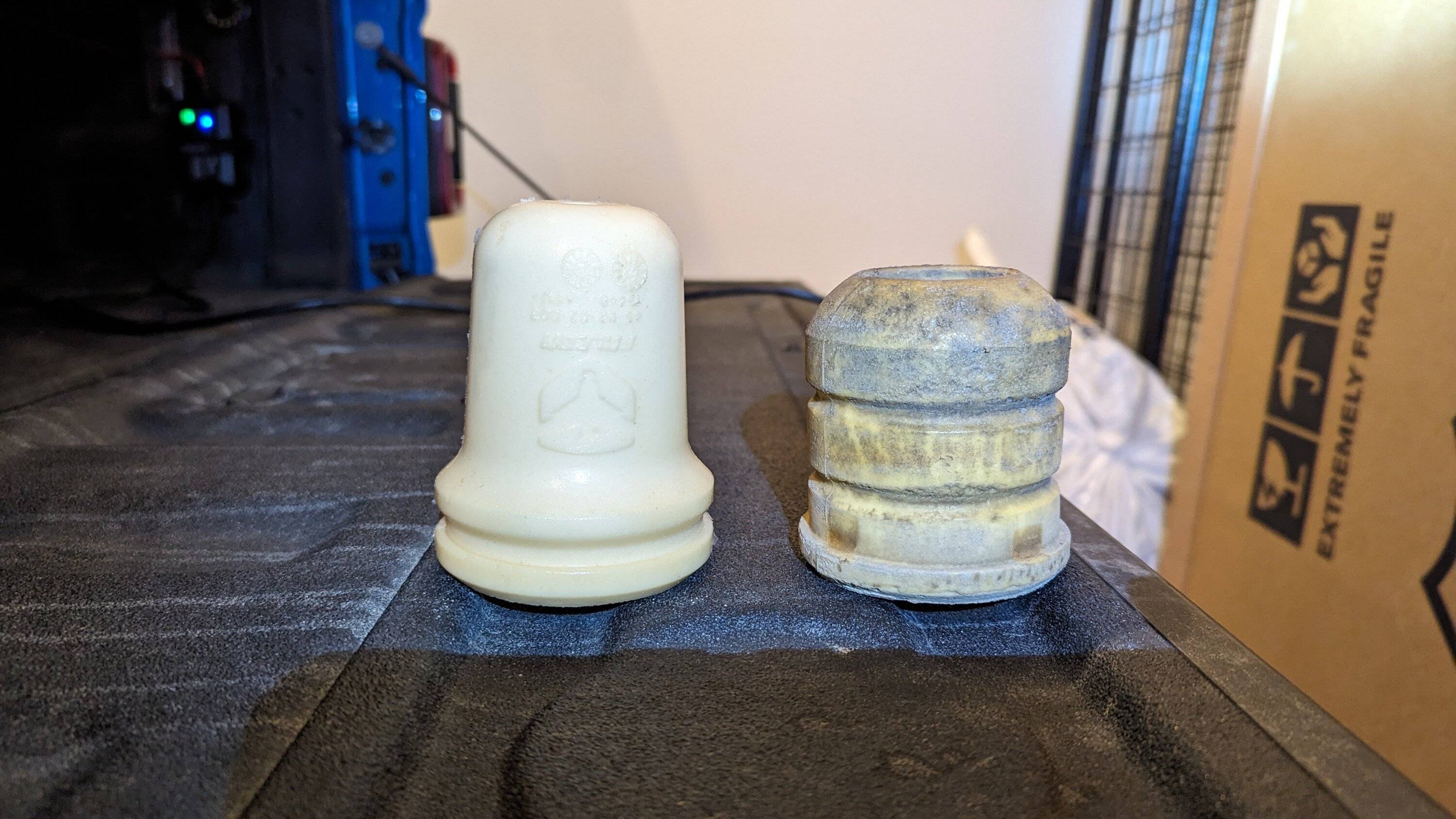

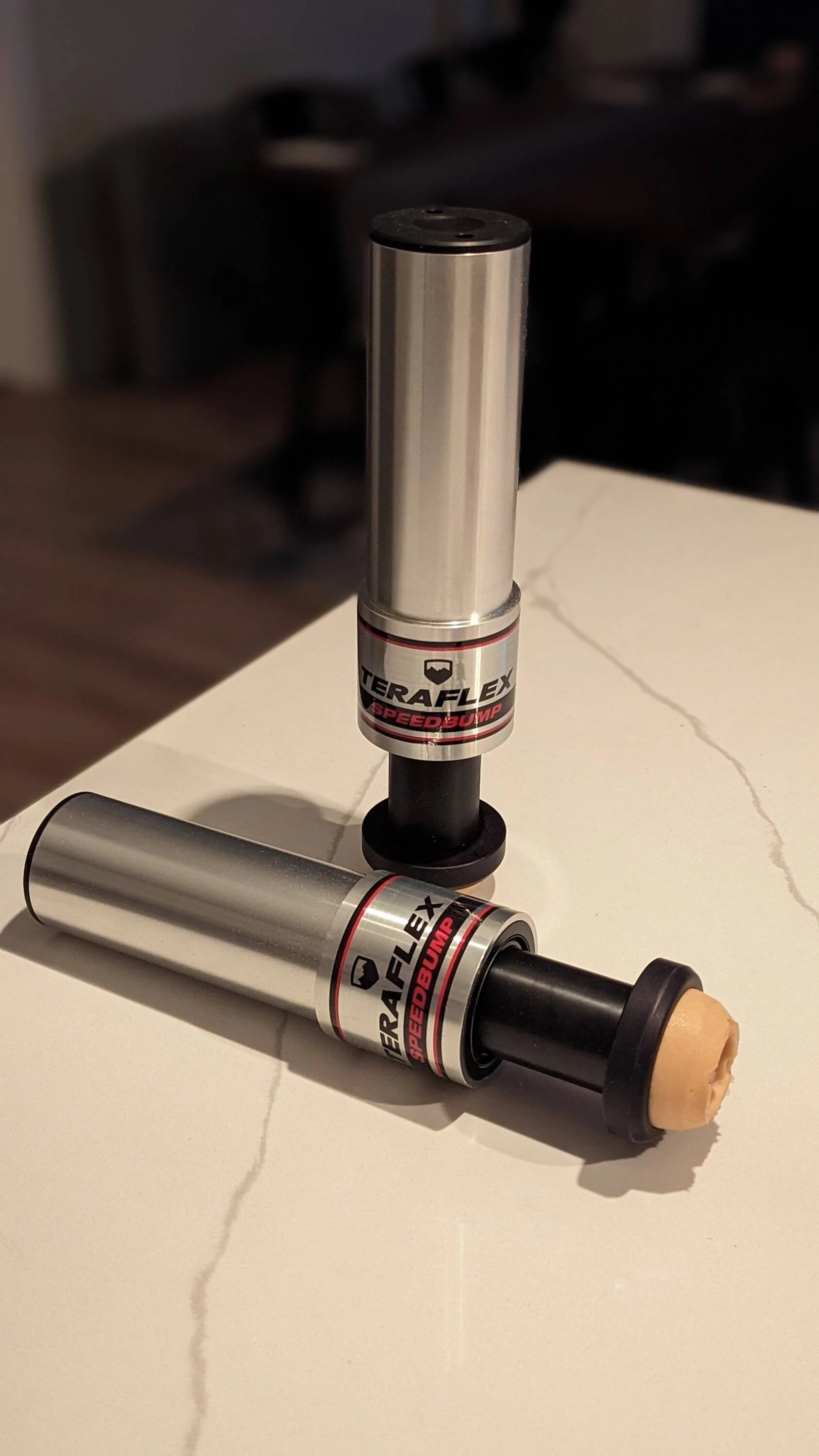

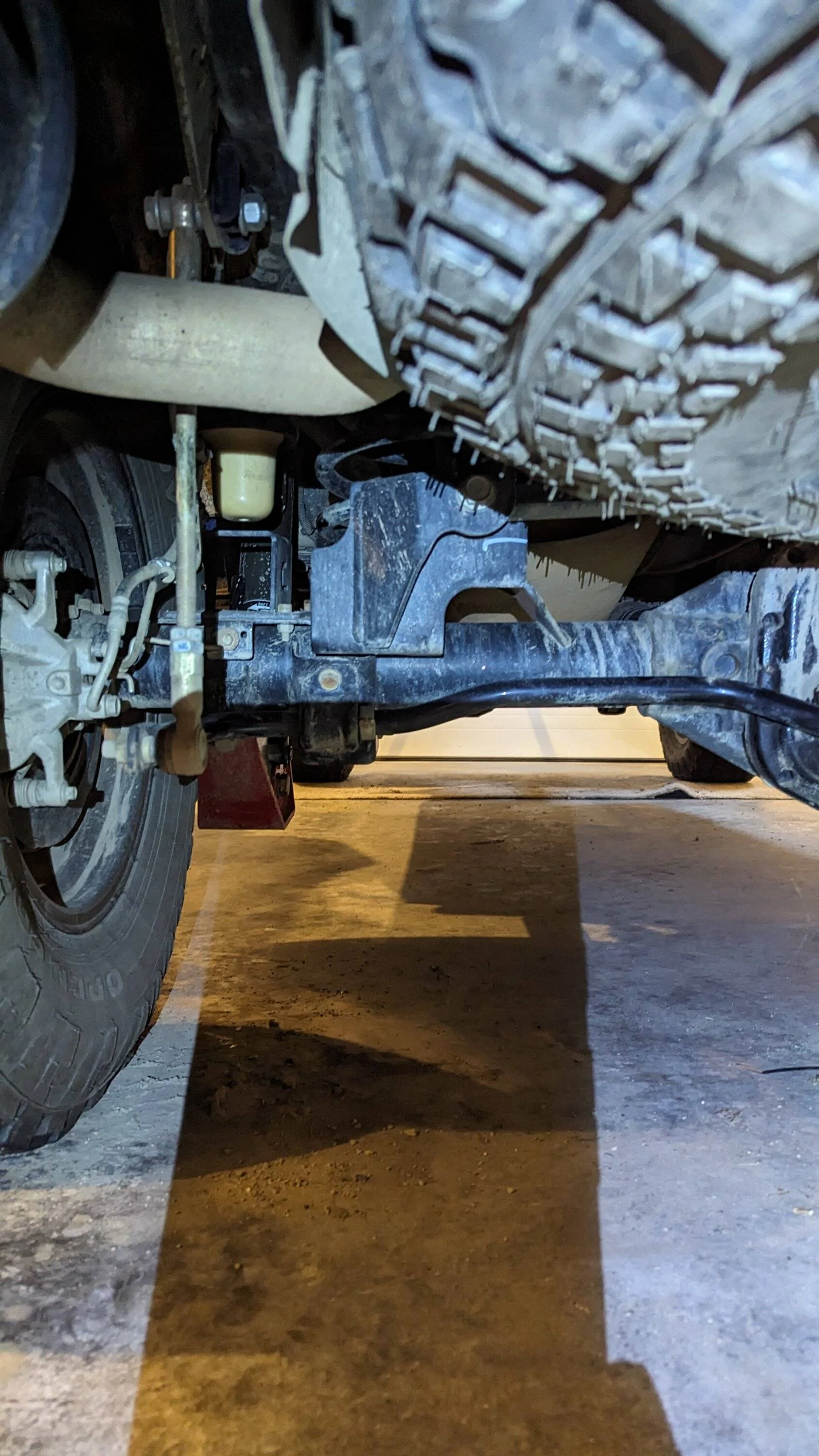

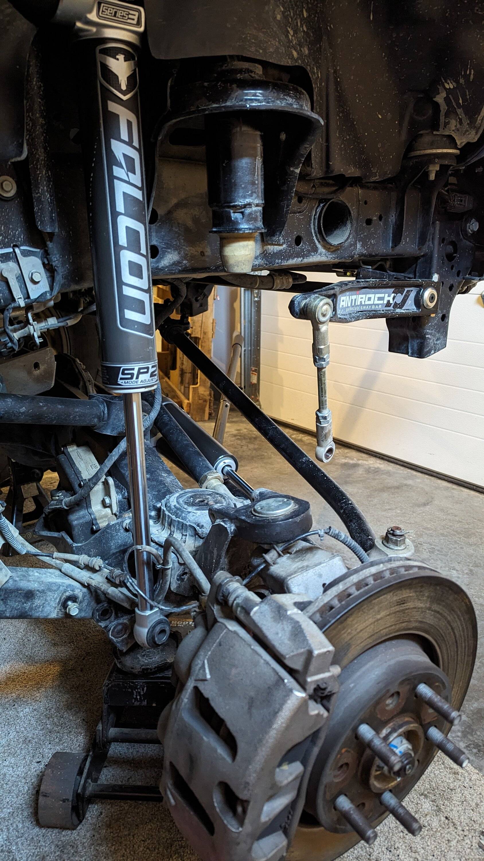

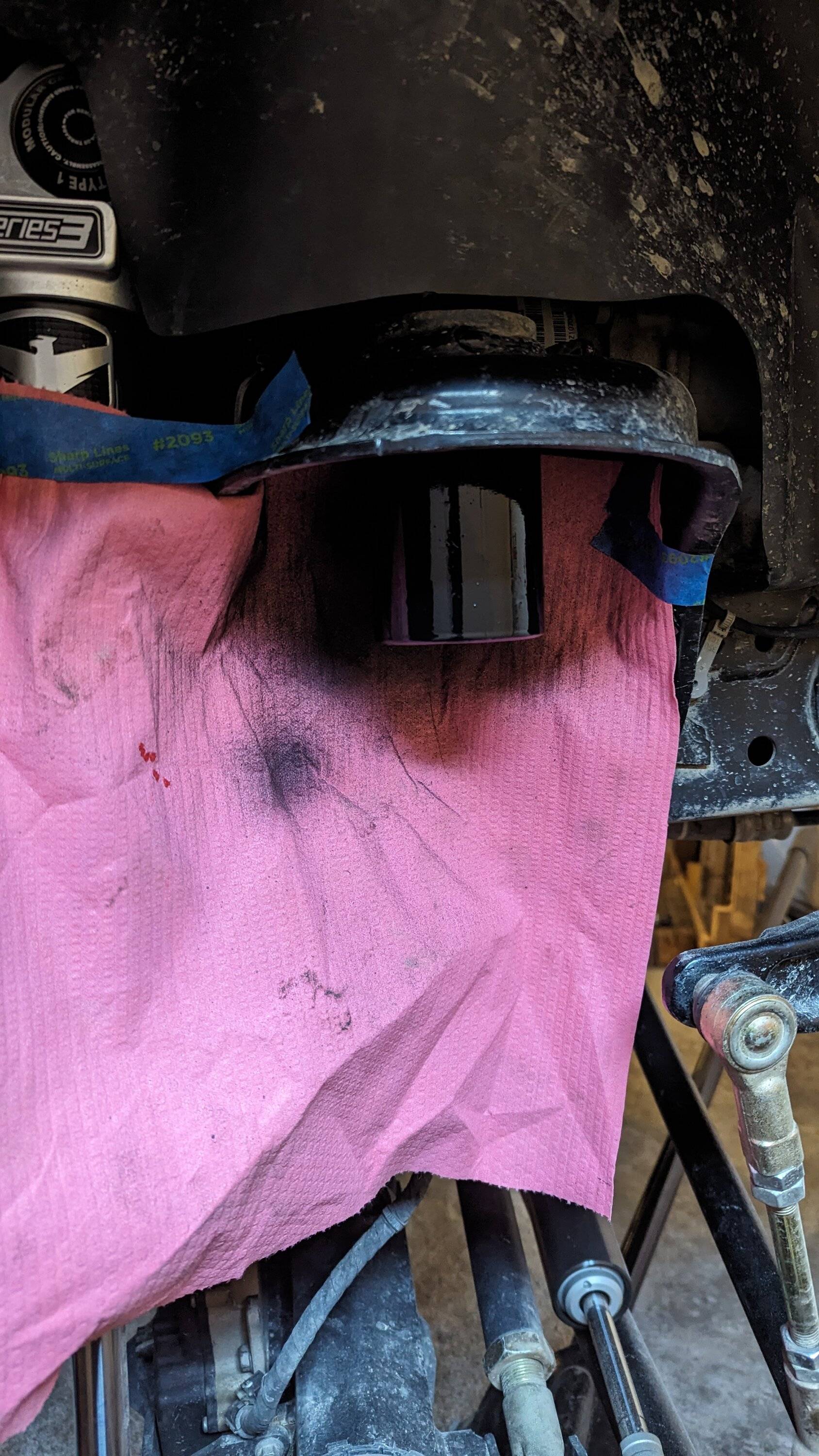

Put the Teraflex Speedbumps in the blue Jeep.
Rears were super easy. Twist out the old, twist in the new. I do need to replace the lower bump stop riser with something shorter.
Jeep Gladiator Alaska Daily Drivers: Hydro Blue 80A and Bright White JTR PXL_20240127_194425133
Jeep Gladiator Alaska Daily Drivers: Hydro Blue 80A and Bright White JTR PXL_20240127_194853063
Jeep Gladiator Alaska Daily Drivers: Hydro Blue 80A and Bright White JTR PXL_20240127_195337212.MP

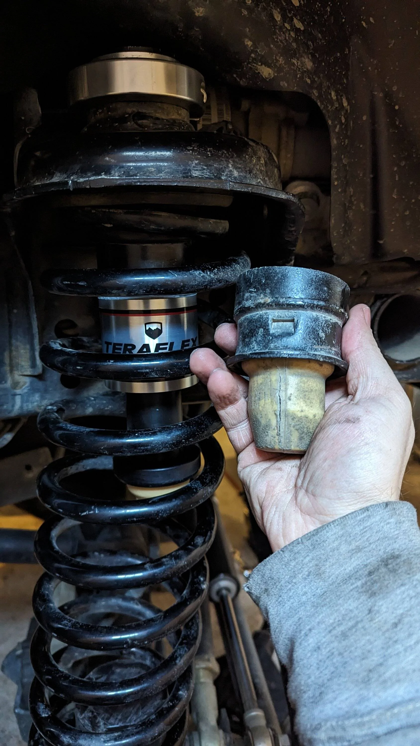

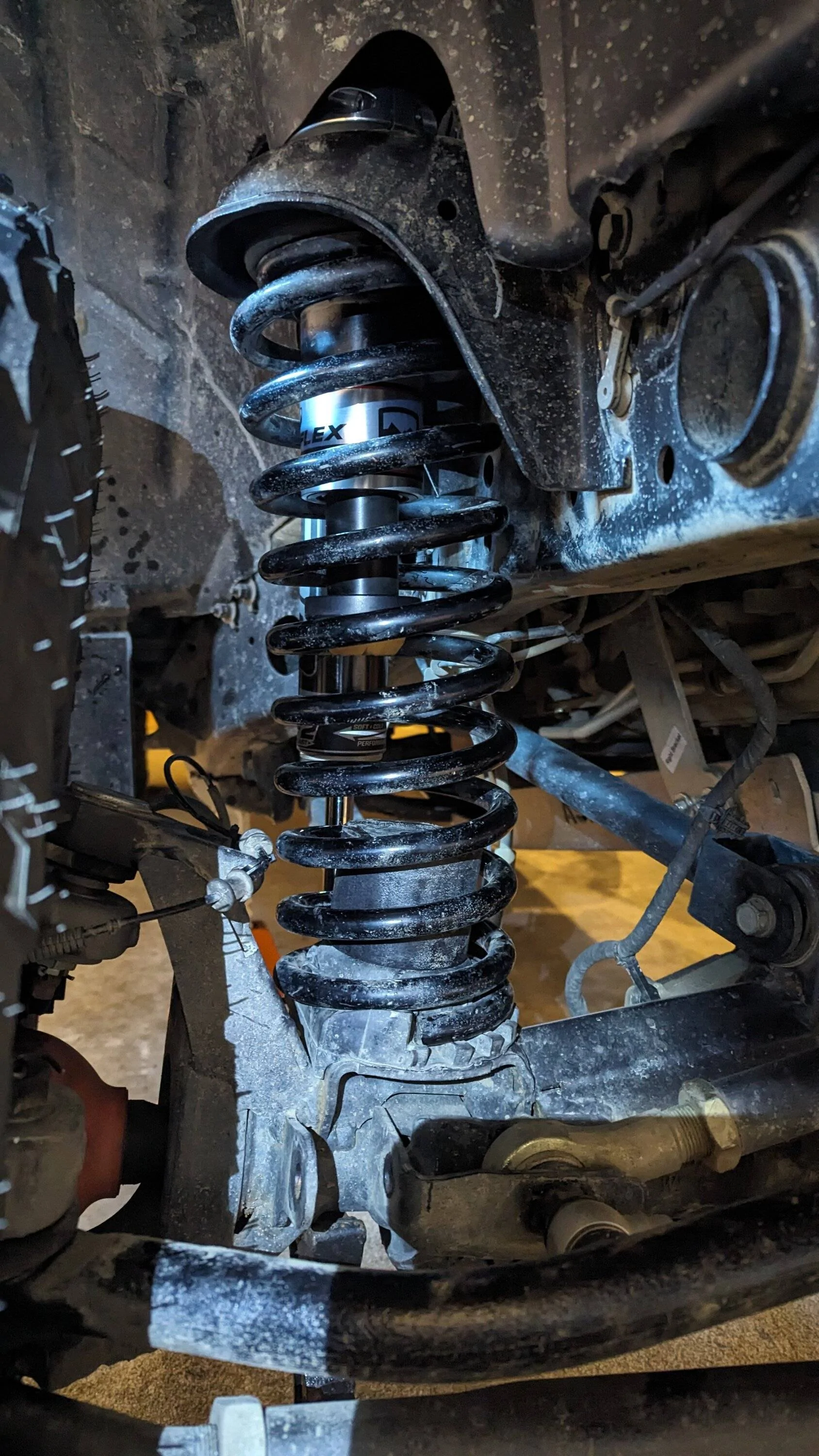

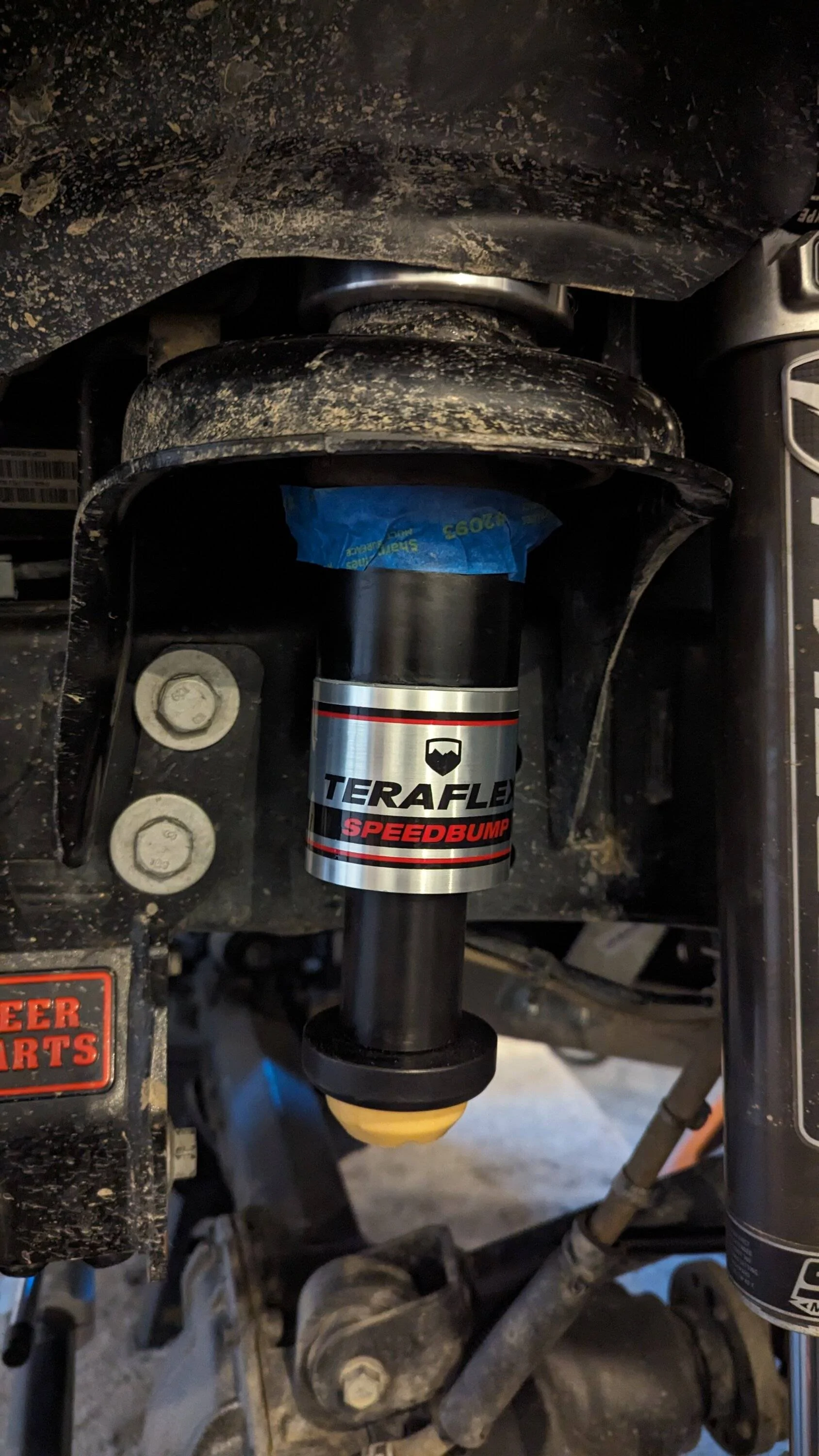

The fronts are more involved, but not too bad. Started on the passenger side.
Yanked the spring:
Jeep Gladiator Alaska Daily Drivers: Hydro Blue 80A and Bright White JTR PXL_20240127_205242700

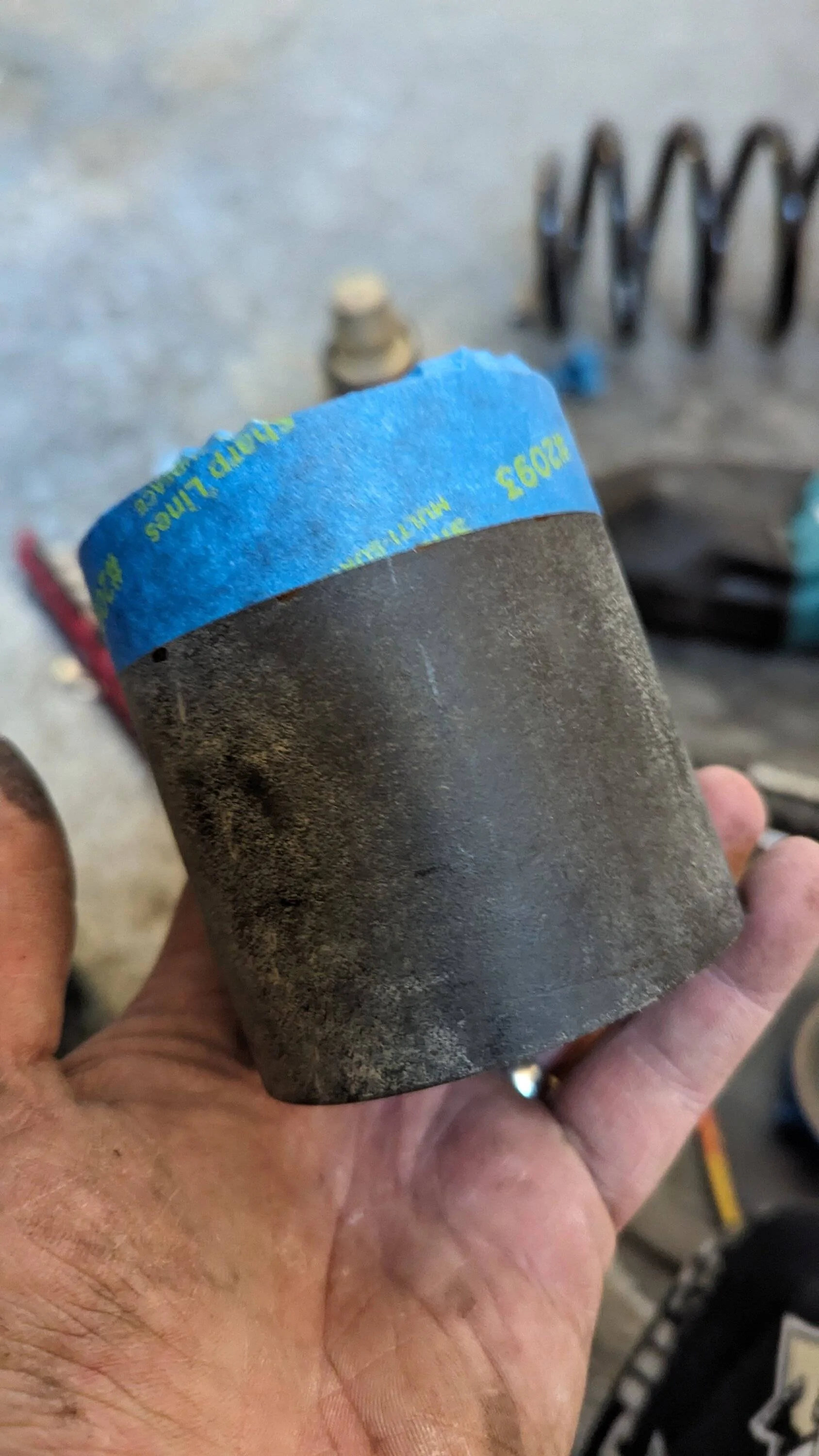

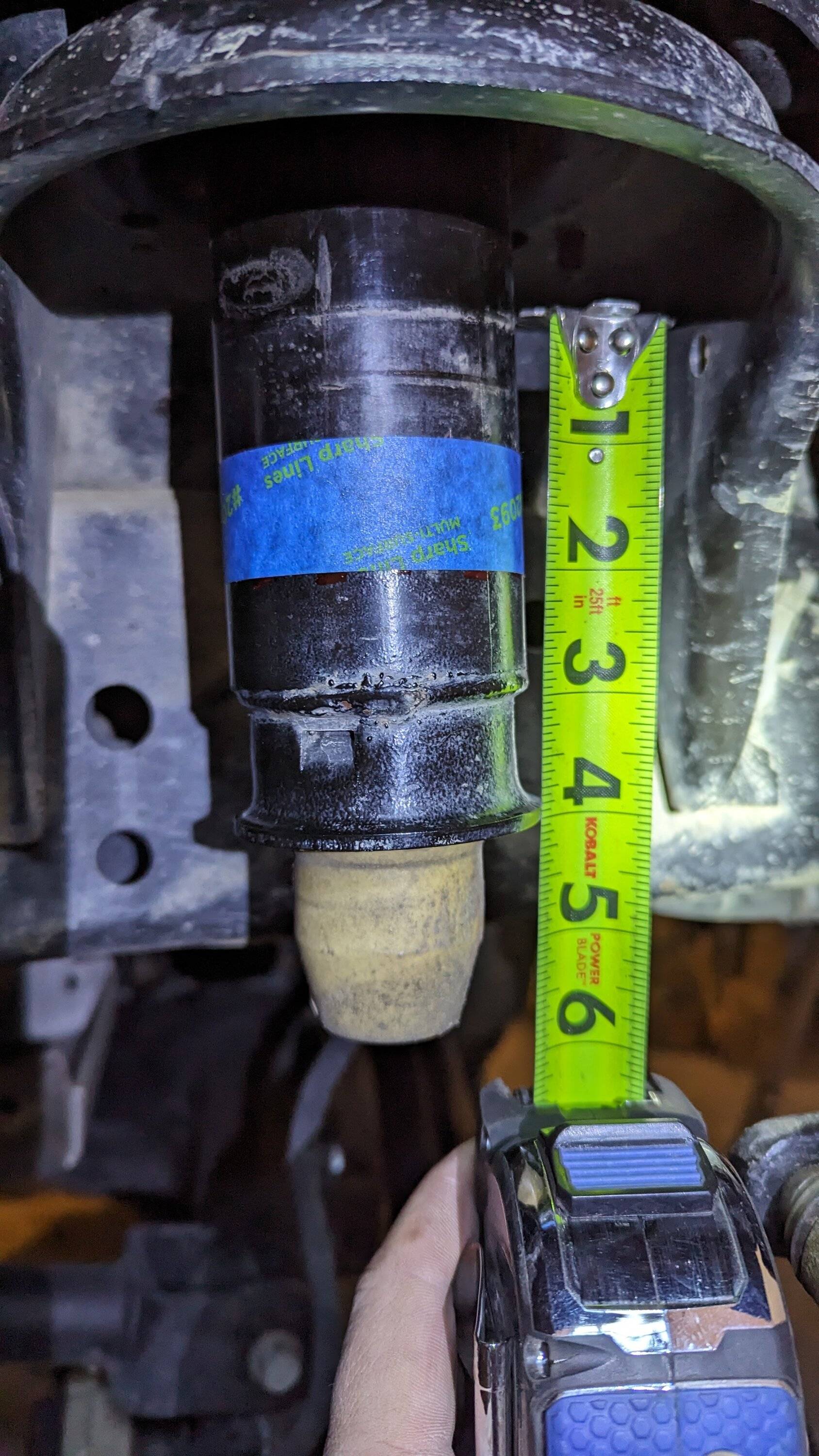

Measured 2" up from the bottom to prepare for the cut:
Jeep Gladiator Alaska Daily Drivers: Hydro Blue 80A and Bright White JTR PXL_20240127_205909926
I used a heavy metal blade on the meat carver for the cut. Cleaned it up with a grinding stone on the angle grinder:
Jeep Gladiator Alaska Daily Drivers: Hydro Blue 80A and Bright White JTR PXL_20240127_210904565
File the cut and paint:
Jeep Gladiator Alaska Daily Drivers: Hydro Blue 80A and Bright White JTR PXL_20240127_214419791
Modify the bump stop risers to work, shaved off .75":
Jeep Gladiator Alaska Daily Drivers: Hydro Blue 80A and Bright White JTR PXL_20240127_220157355.MP
Jeep Gladiator Alaska Daily Drivers: Hydro Blue 80A and Bright White JTR PXL_20240128_001508972

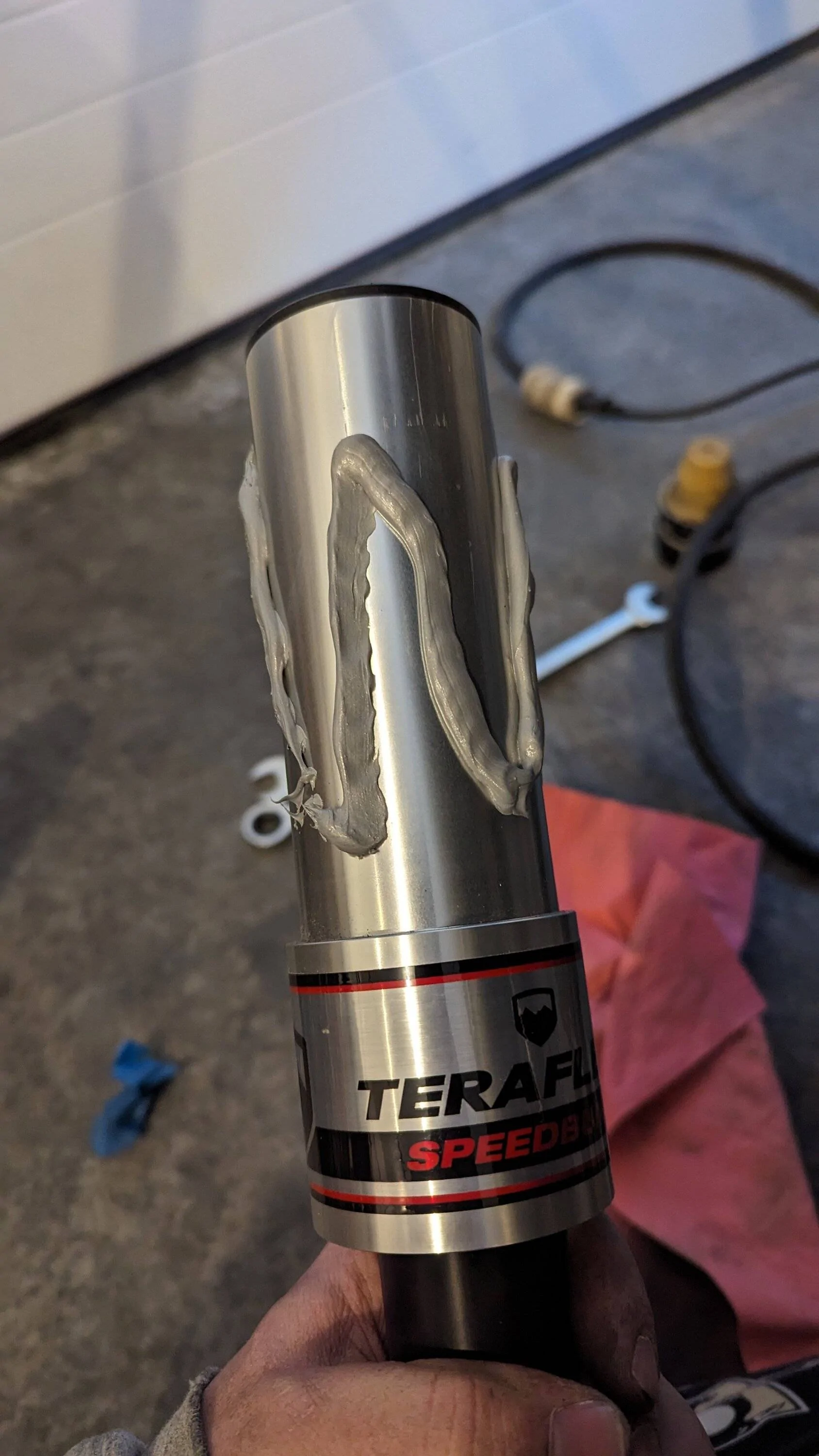

Silicone the speedbump:
Jeep Gladiator Alaska Daily Drivers: Hydro Blue 80A and Bright White JTR PXL_20240128_004528512
Throw it in, clean up the excess silicone, and tighten the clamp up top:
Jeep Gladiator Alaska Daily Drivers: Hydro Blue 80A and Bright White JTR PXL_20240128_004532952
Jeep Gladiator Alaska Daily Drivers: Hydro Blue 80A and Bright White JTR PXL_20240128_004914725
Jeep Gladiator Alaska Daily Drivers: Hydro Blue 80A and Bright White JTR PXL_20240128_005151407
Jeep Gladiator Alaska Daily Drivers: Hydro Blue 80A and Bright White JTR PXL_20240127_225427236
Jeep Gladiator Alaska Daily Drivers: Hydro Blue 80A and Bright White JTR PXL_20240128_000643033
Do the other side and button it all up. Cycle the suspension with jack to confirm clearances.
Not too bad. Looking forward to trying them out.
In other news, additional parts for the Propex heater setup have arrived. More to come on that setup.
11,478
30,575

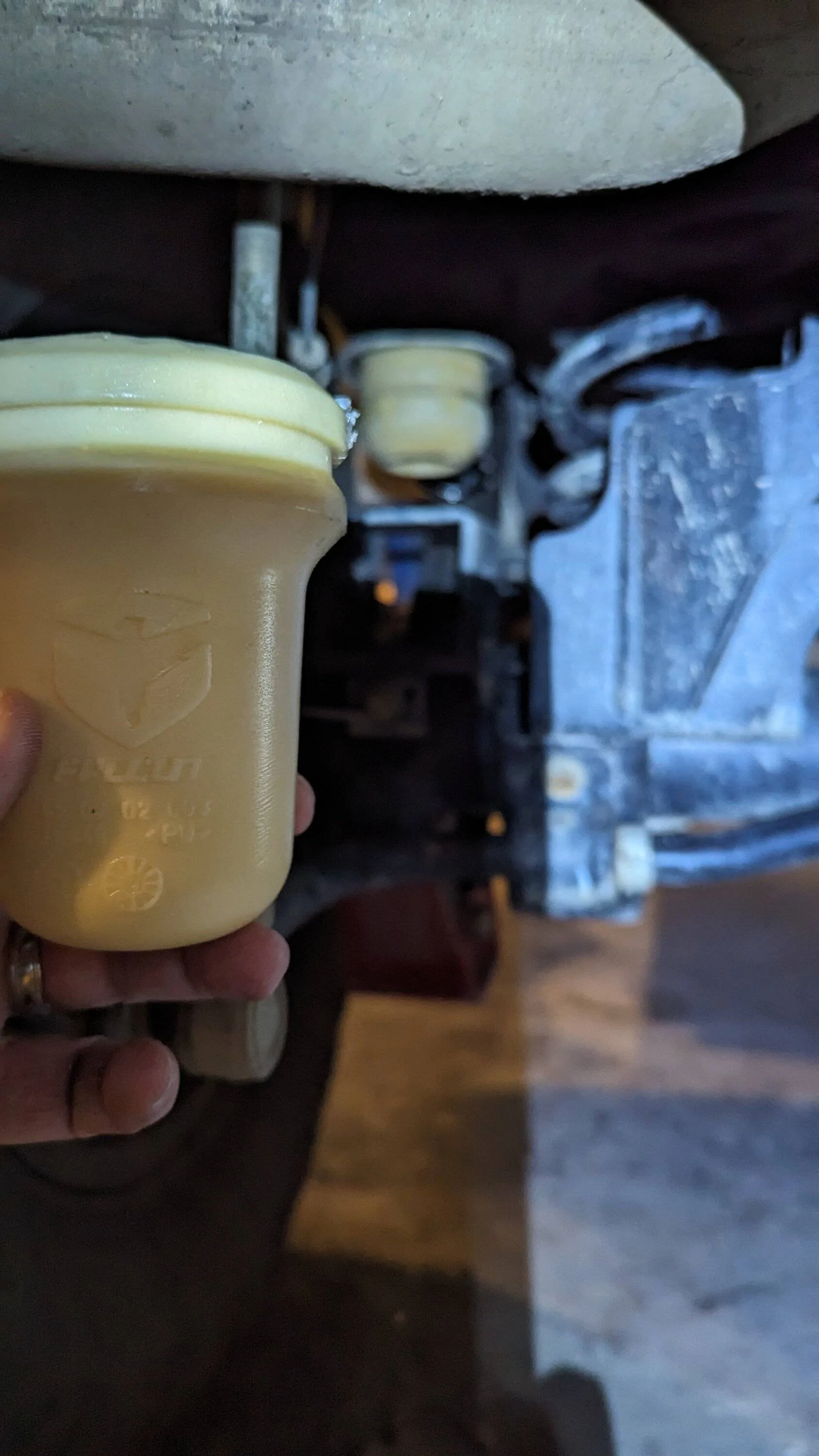

I used the JKS hydraulic front bump stops. They do make a difference over the oem bump stops.
I hope these are as good as hydraulic.

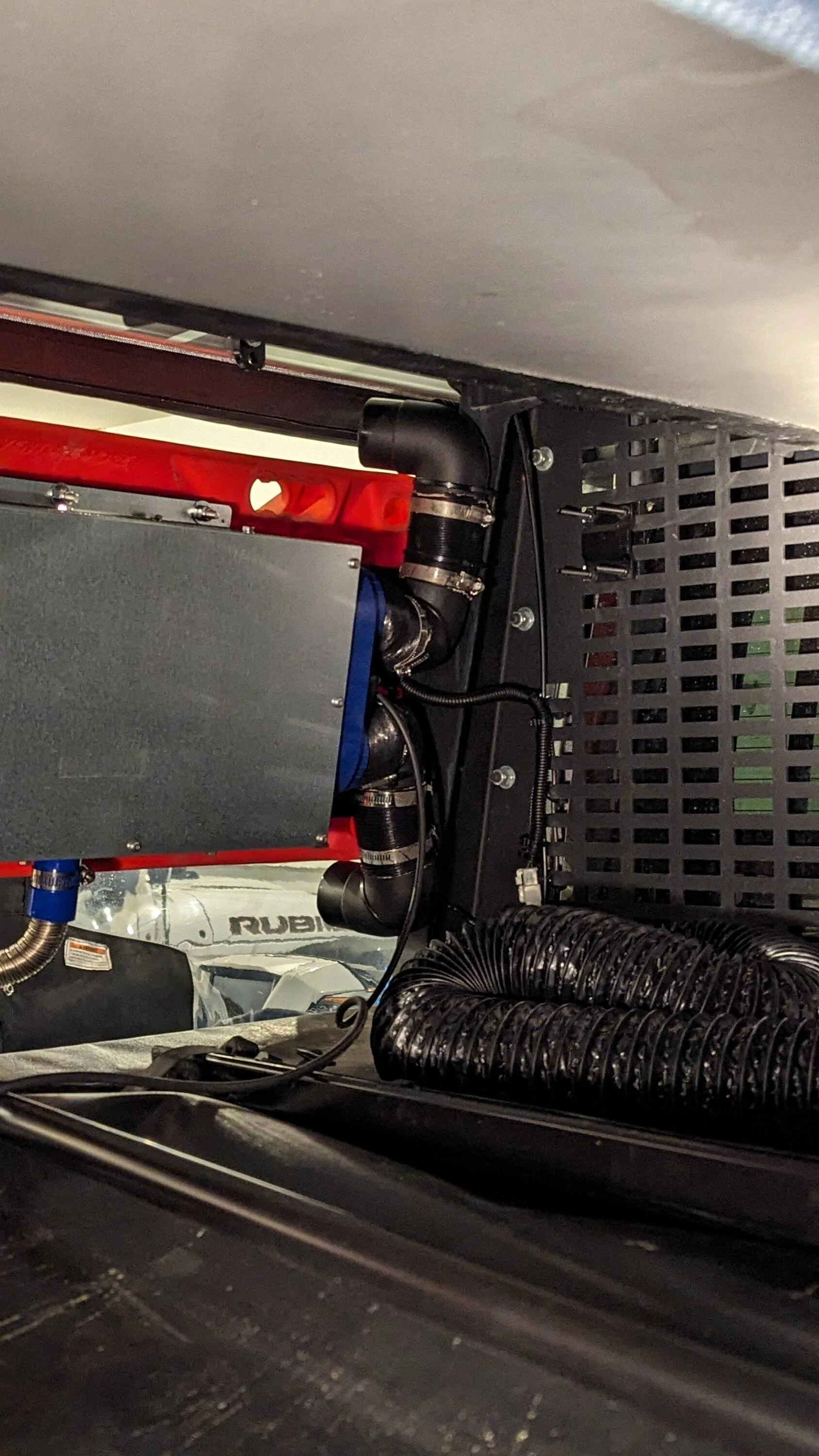

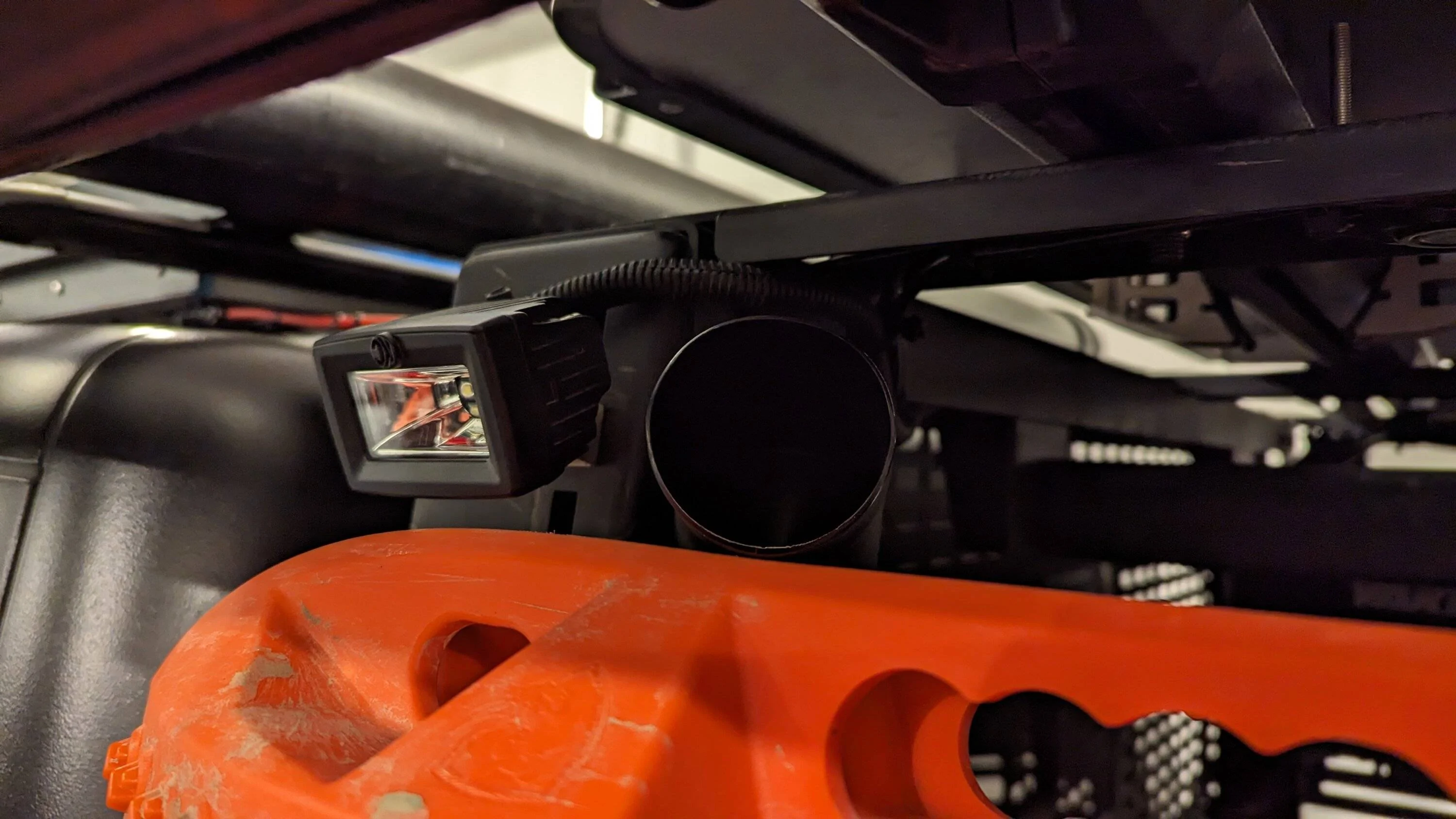

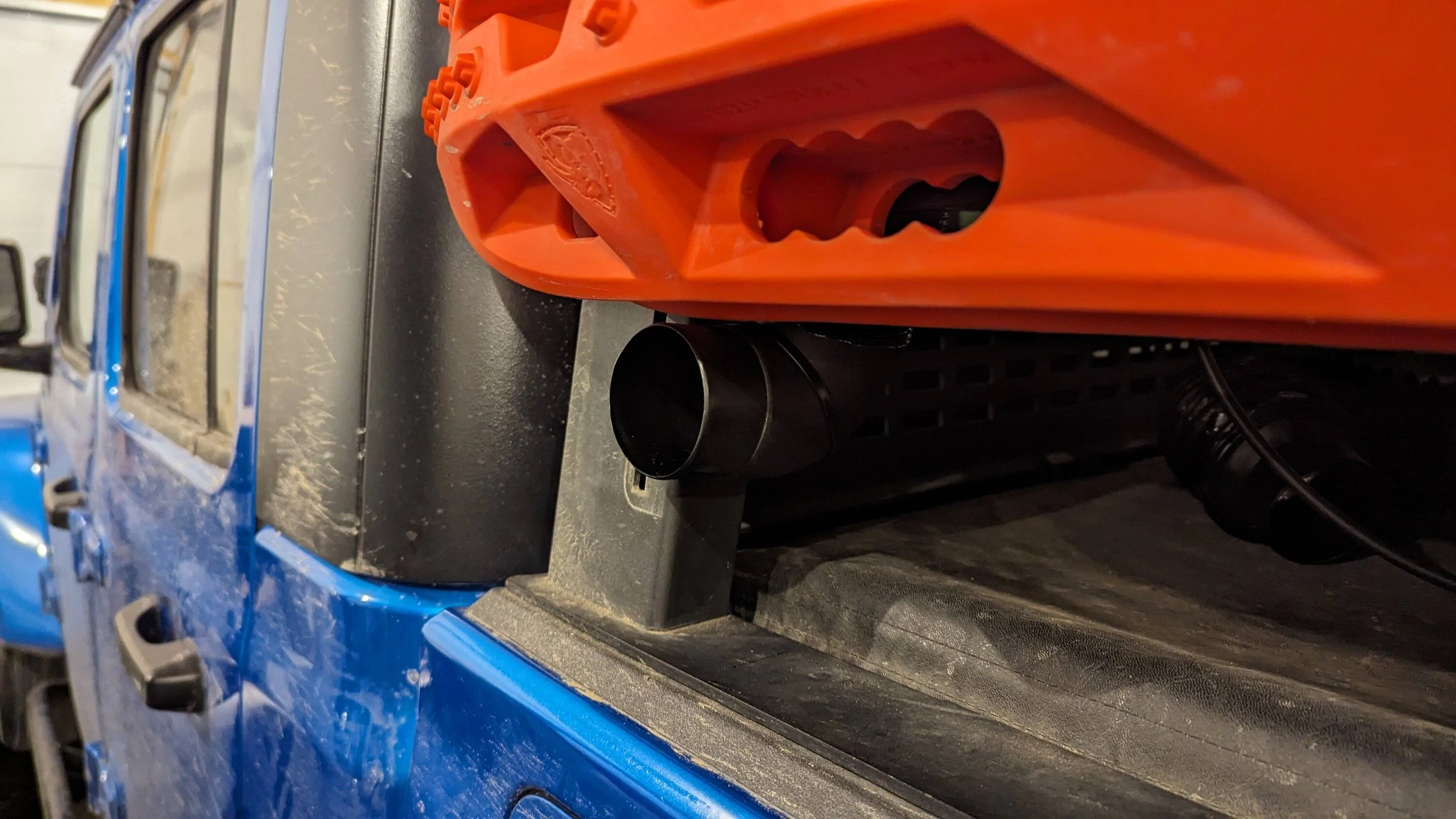

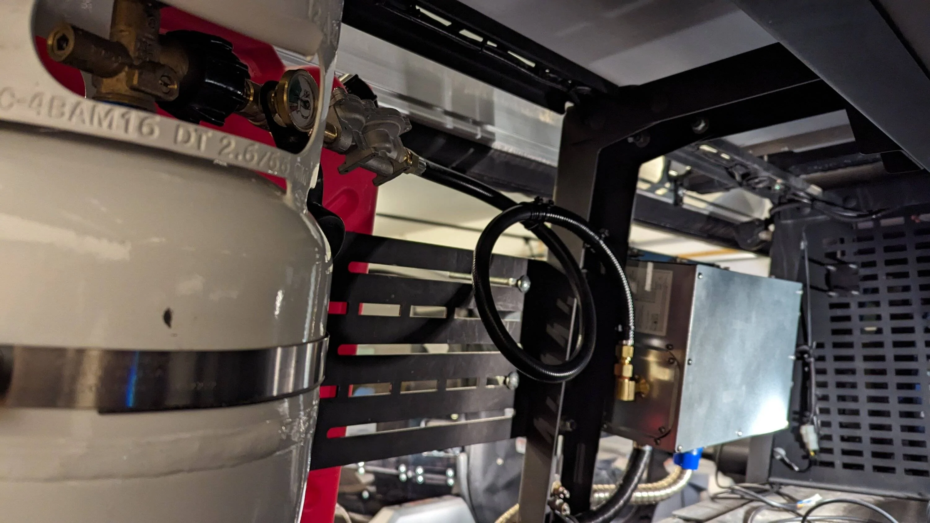

Alright. Some stuff happened, finally.

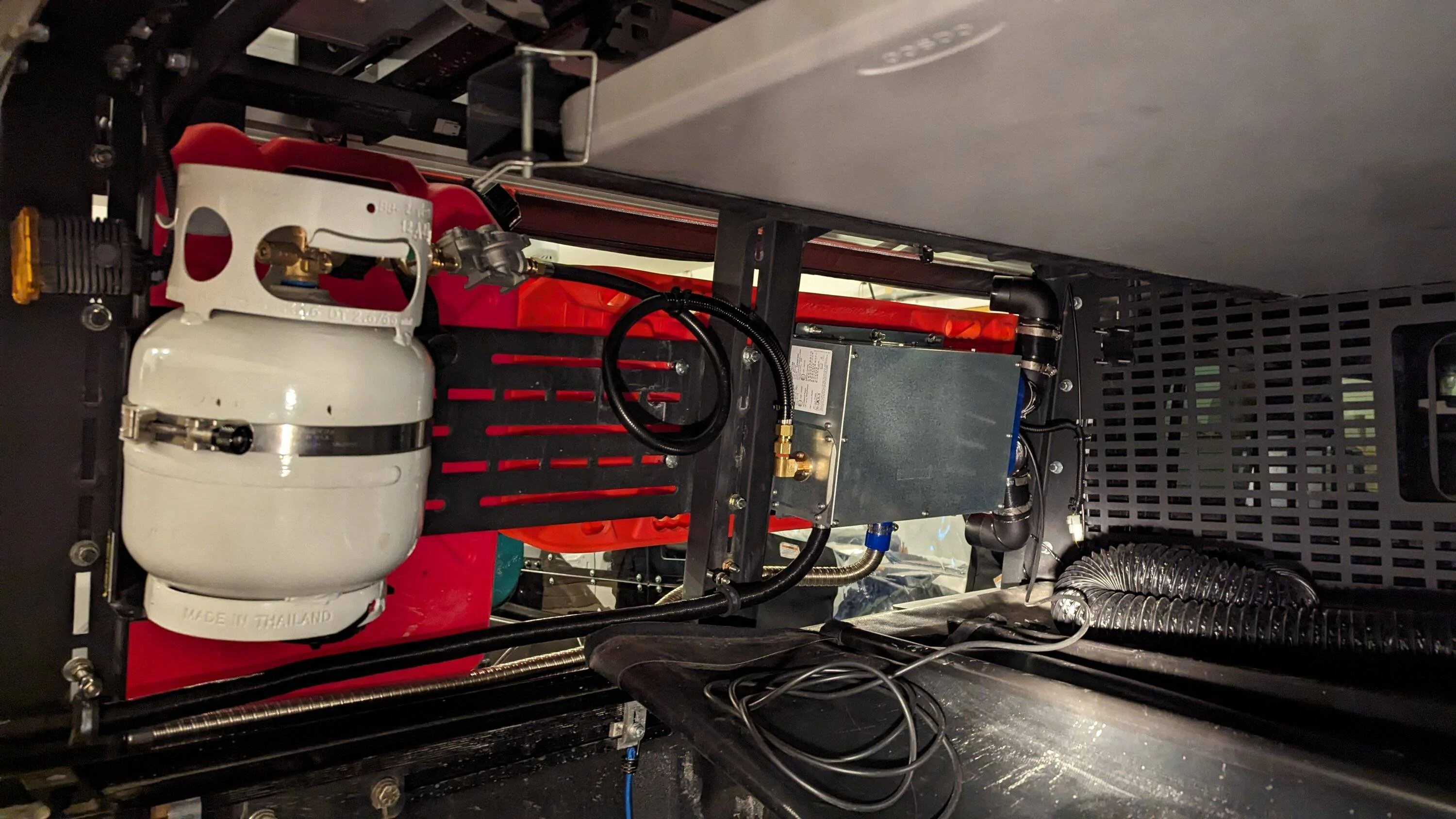

Swapped the copper hard line over to flexible hose. I'm much happier with this and it holds pressure 100x as long as the hard line did. The added benefit is being able to route it to a different propane tank in a pinch if needed. If you Propex, do this instead.
Jeep Gladiator Alaska Daily Drivers: Hydro Blue 80A and Bright White JTR PXL_20240128_221847459.MP

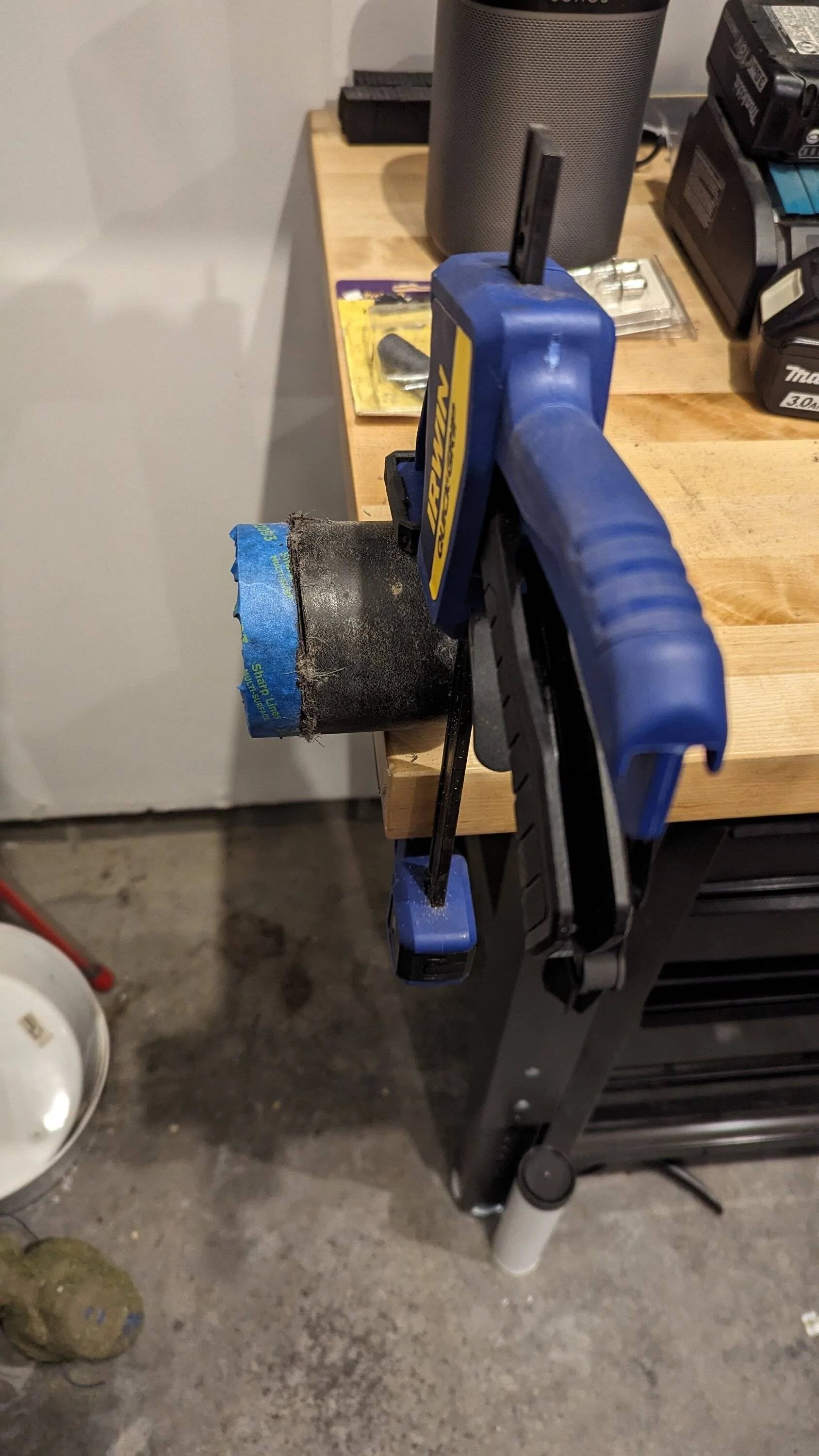

Connecting the ducts to the heater wasn't as easy as it should be. These 90° elbows will make for quick connections at camp. I needed to place another order for some couplers, clamps, and two 60mm rubber caps. Once that order comes in, the "easy to connect the ducts" project will be over.

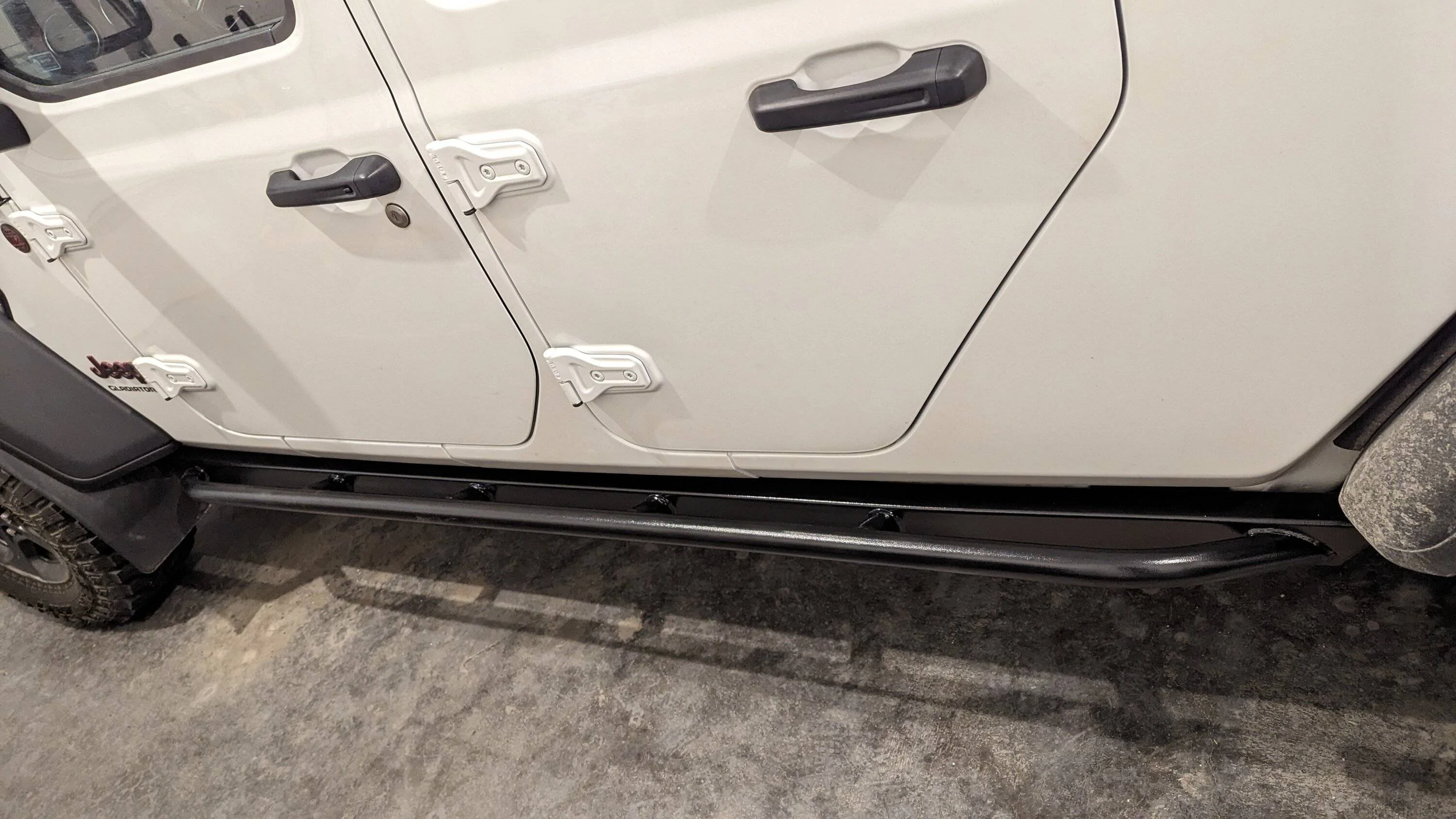

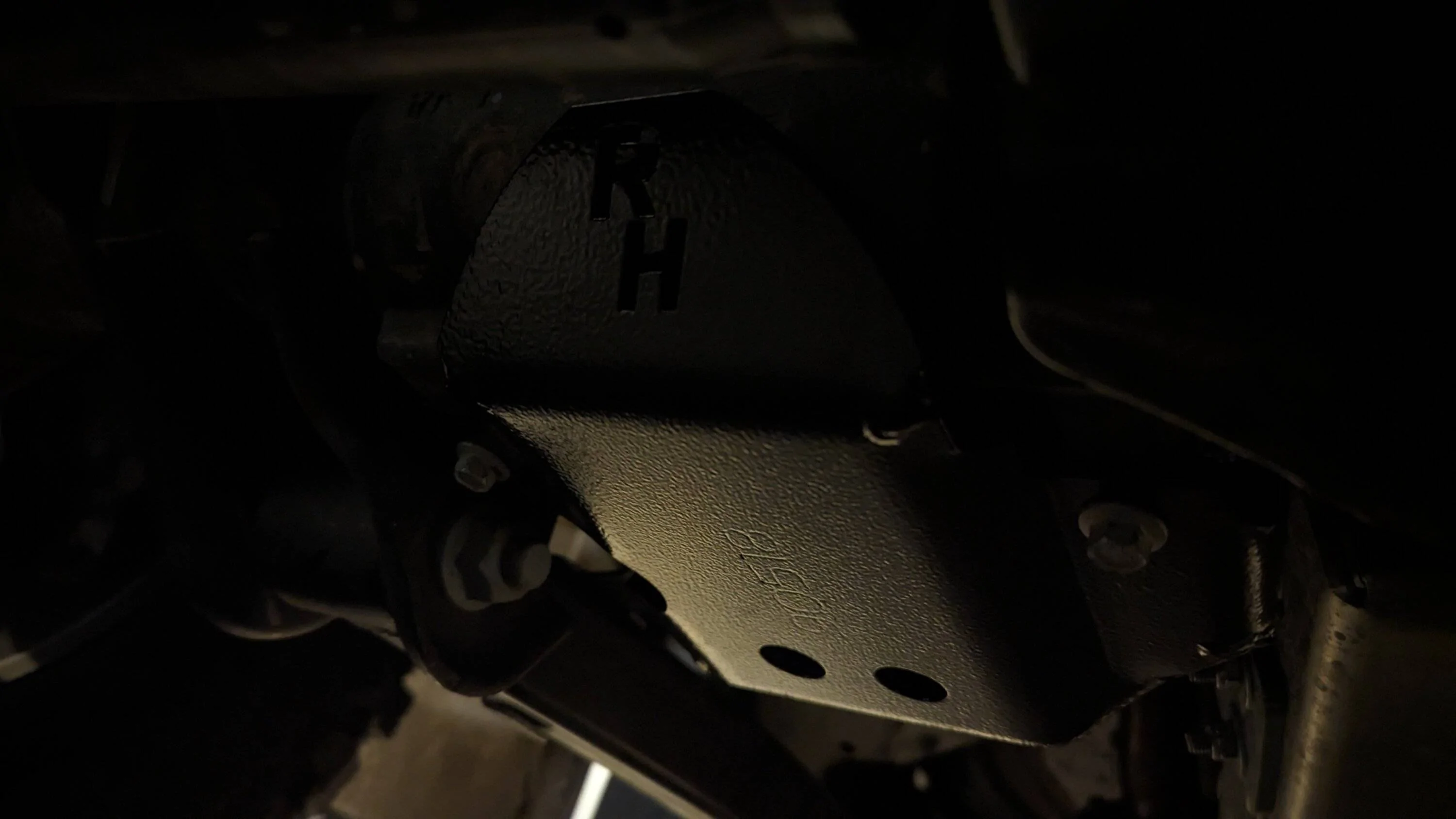

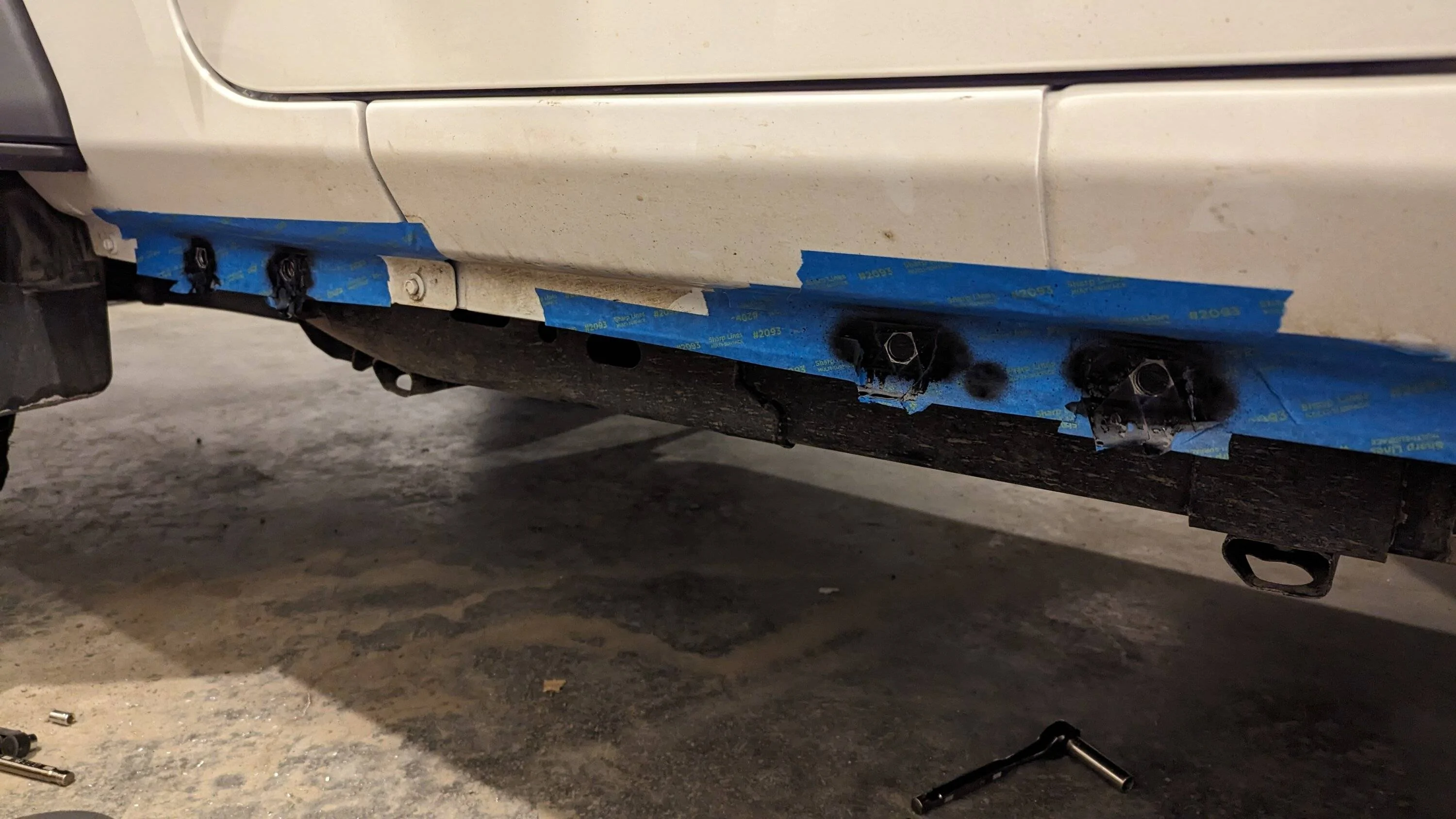

Some work on the white Jeep tonight.
RockHard 4x4 FAD skid and rock rails:
Jeep Gladiator Alaska Daily Drivers: Hydro Blue 80A and Bright White JTR PXL_20240201_005014591
Jeep Gladiator Alaska Daily Drivers: Hydro Blue 80A and Bright White JTR PXL_20240201_012113068
Jeep Gladiator Alaska Daily Drivers: Hydro Blue 80A and Bright White JTR PXL_20240201_030234229
Jeep Gladiator Alaska Daily Drivers: Hydro Blue 80A and Bright White JTR PXL_20240201_042131186
