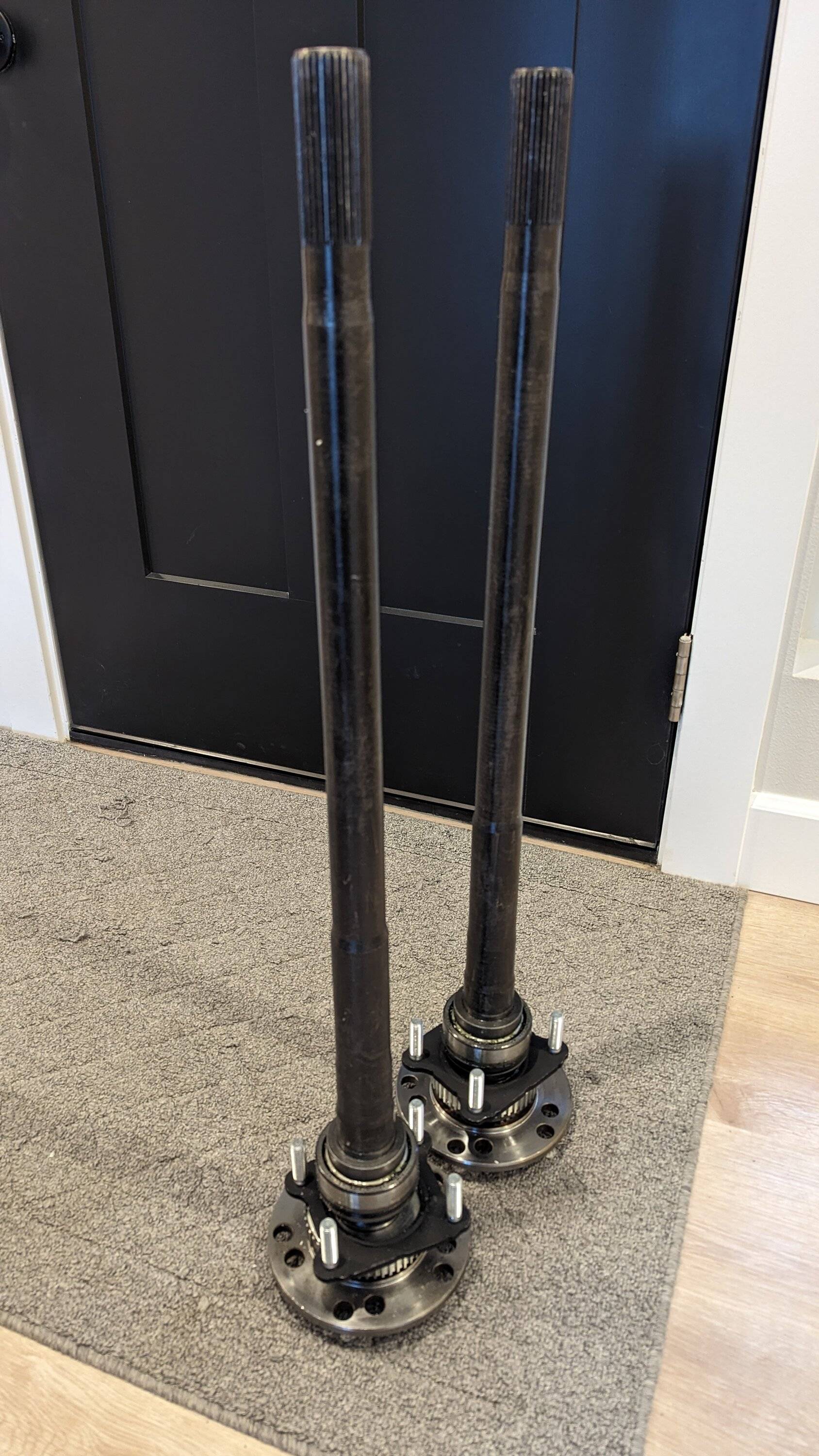

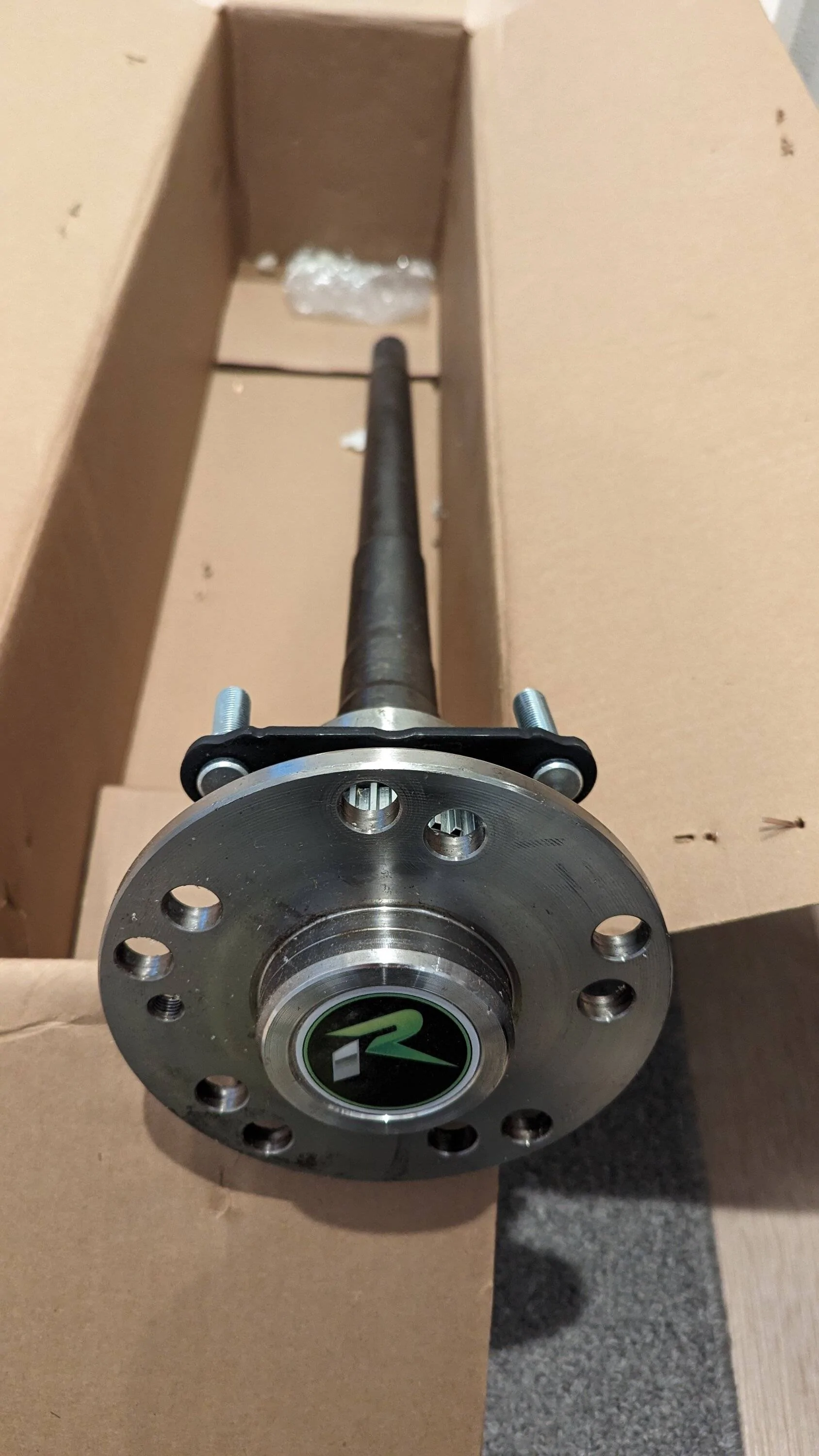

The blue Jeep is heavy enough for me to warrant chromoly rear axle shafts. We don't rock crawl per se, but the right wrong moment can leave you stranded. I'm not interested in that, although you're never in complete control of destiny ? Just giving us our best chance.

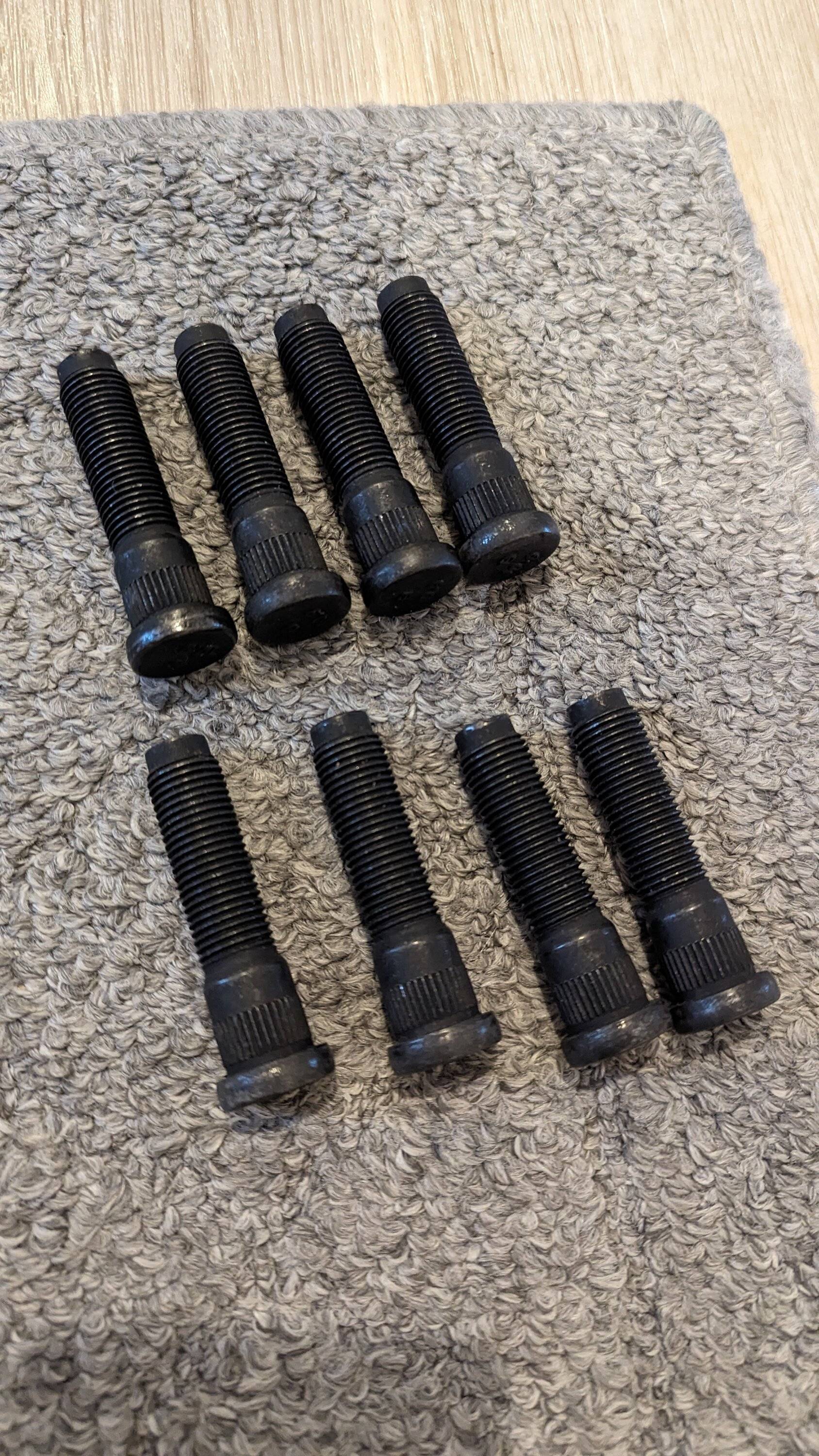

Enter Revolution chromoly shafts and the 8 wheel studs they included ?

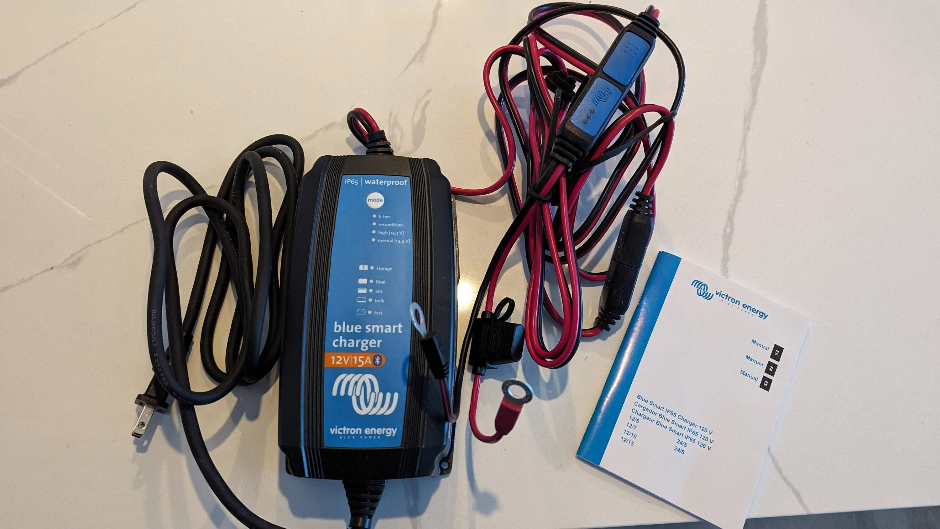

Next up, the replacement charging setup

I thought the rubicon models already had chromoly axle shafts? Thought I read that somewhere here... hmm.. But, those sure do look good.
Really looking forward to seeing how the charger works. I like how it has a 'auto power supply' function. I noticed the other day while having my ctek plugged in it was cycling a bunch while I had something in the jeep going.
Our blue Jeep isn't a Rubicon. It's merely an 80th anniversary edition. So like a souped up Overland model.

8 wheel studs? Where's the other 2?
That's what I said but in frustration until I read the description which said the shafts don't come with wheel studs at all. So the 8 I got were a free gift it seems.

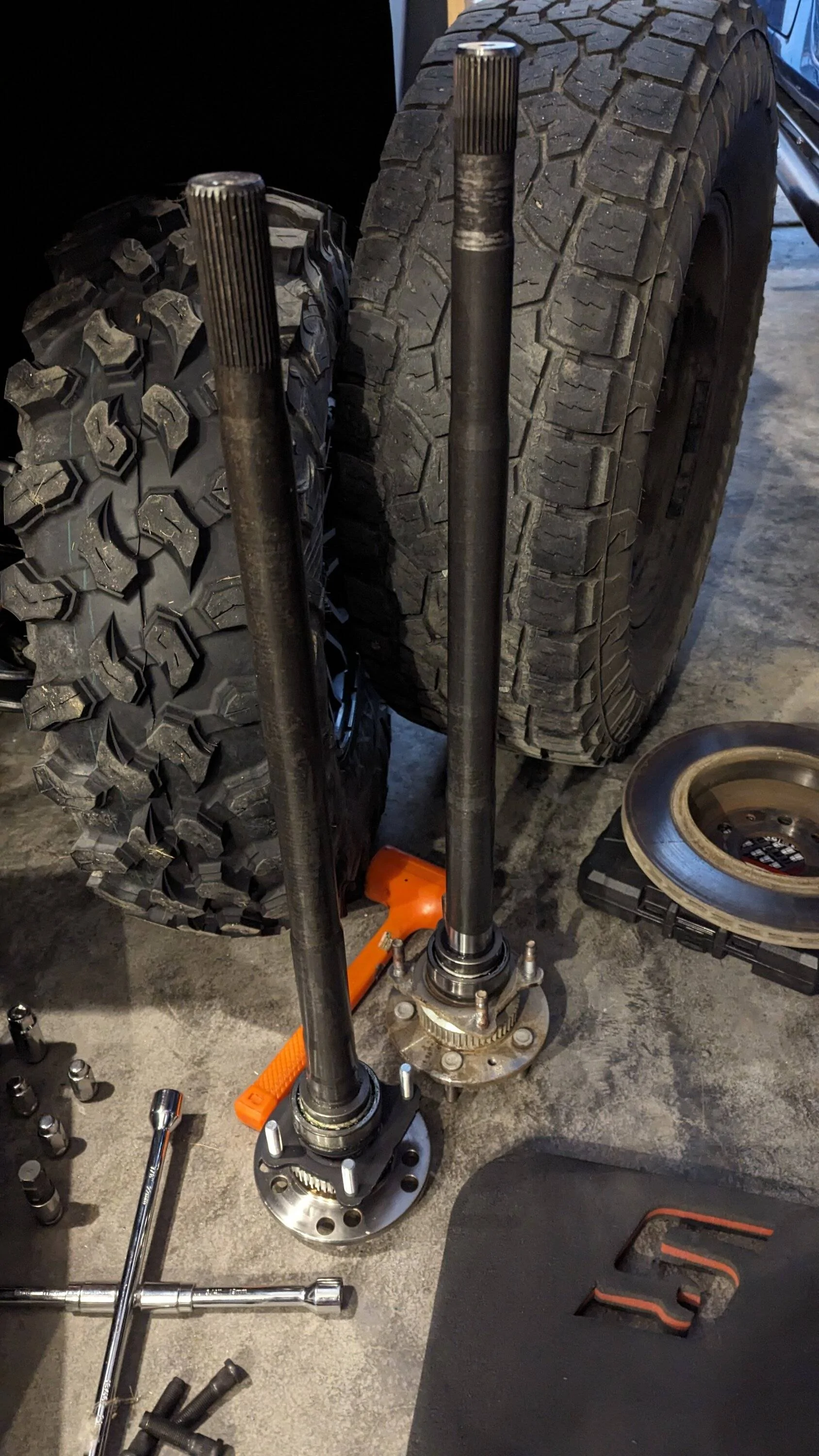

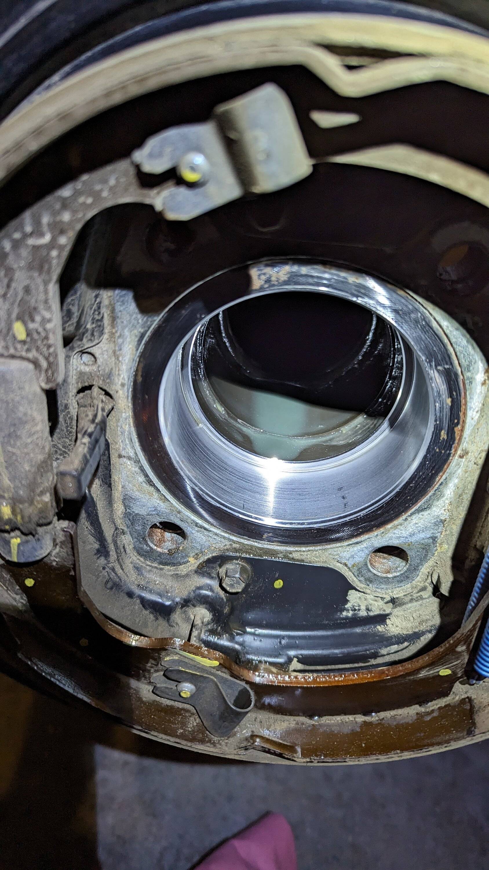

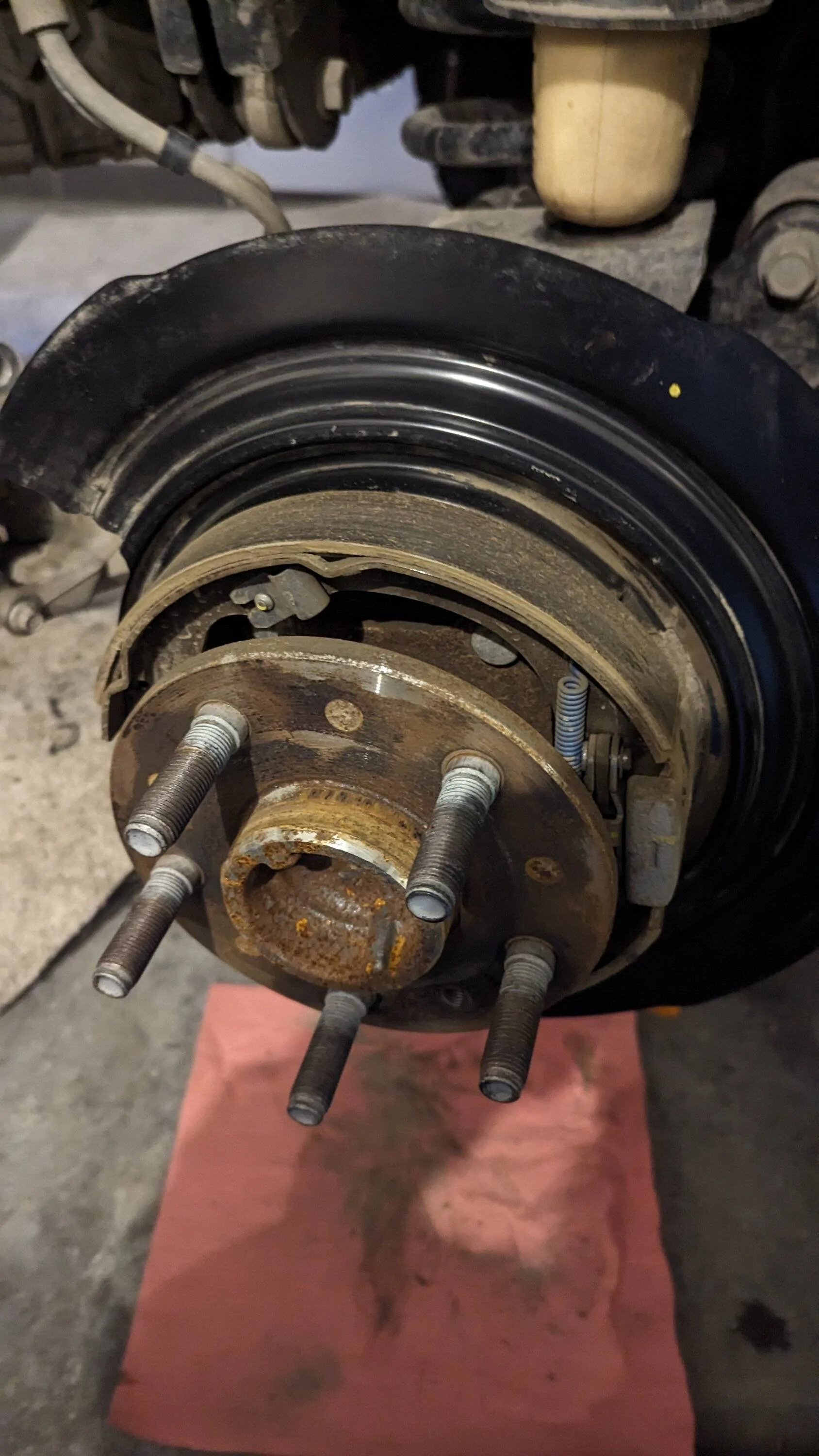

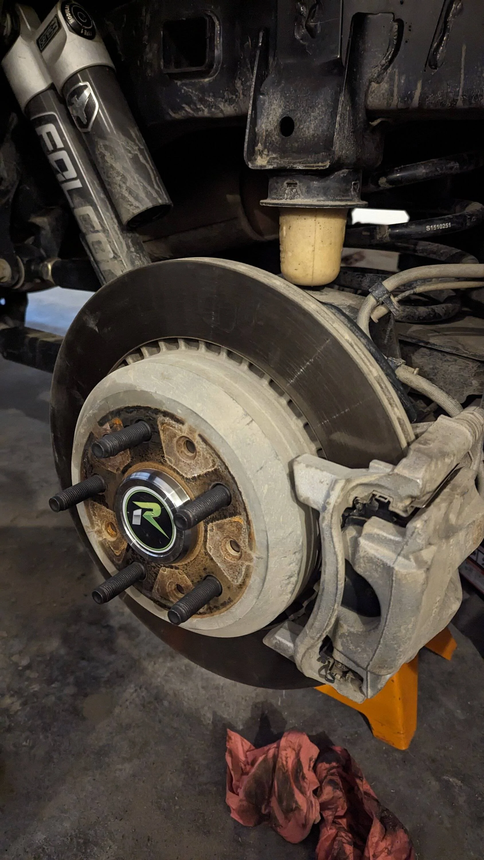

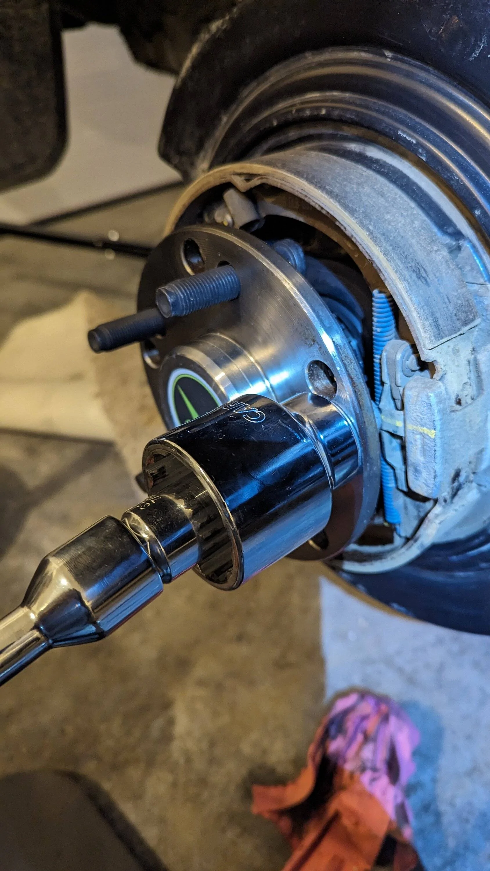

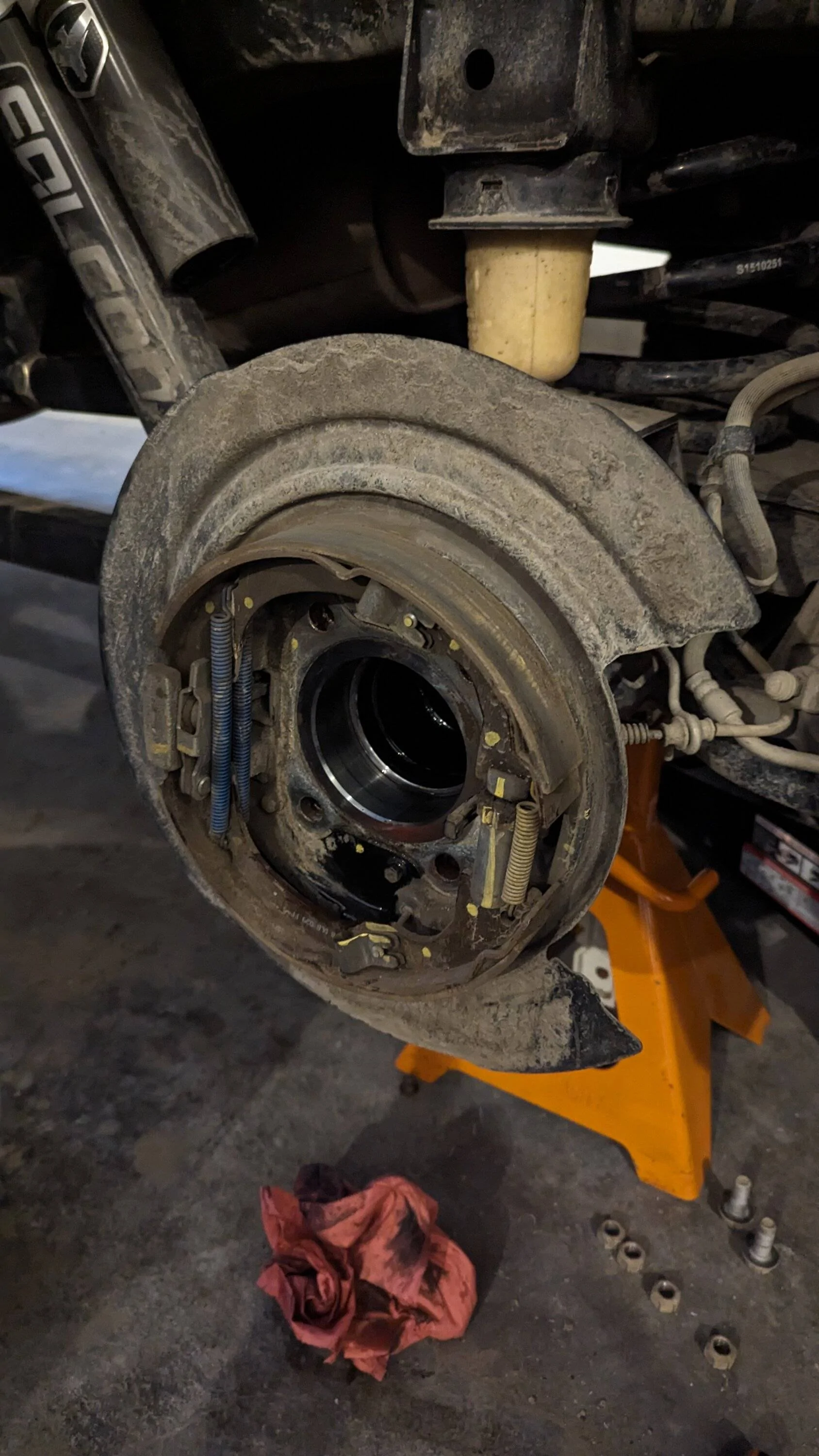

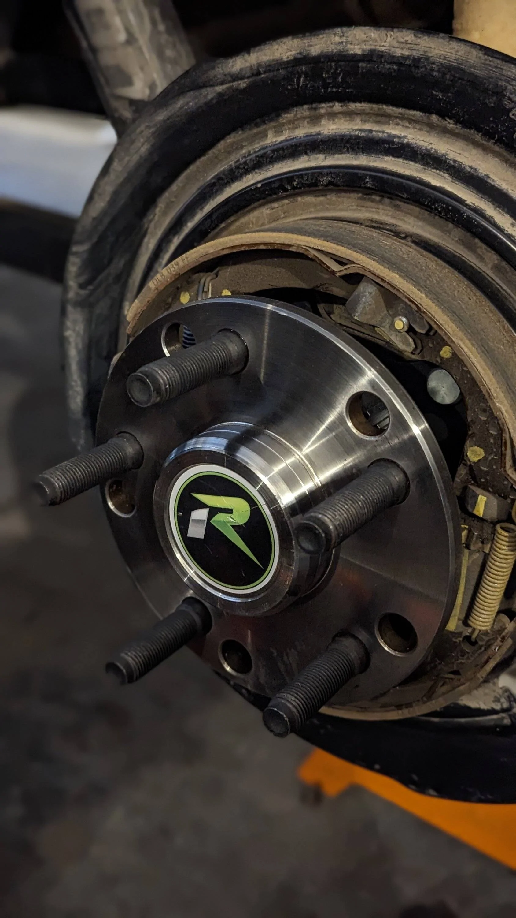

For anyone with a sport or overland model that doesn't have wide track axles, these shafts from Revolution went right in without a fuss. I've got just one test drive around the neighborhood under my belt, but so far so good!
Out with the old
Jeep Gladiator Alaska Daily Drivers: Hydro Blue 80A and Bright White JTR PXL_20240223_025656902
Jeep Gladiator Alaska Daily Drivers: Hydro Blue 80A and Bright White JTR PXL_20240223_030315809
Jeep Gladiator Alaska Daily Drivers: Hydro Blue 80A and Bright White JTR PXL_20240222_235614677
Side by side
Jeep Gladiator Alaska Daily Drivers: Hydro Blue 80A and Bright White JTR PXL_20240222_235608559.MP
Pull in the wheel studs
Jeep Gladiator Alaska Daily Drivers: Hydro Blue 80A and Bright White JTR PXL_20240223_031321571
In with the new
Jeep Gladiator Alaska Daily Drivers: Hydro Blue 80A and Bright White JTR PXL_20240223_002618224.PORTRAIT
Jeep Gladiator Alaska Daily Drivers: Hydro Blue 80A and Bright White JTR PXL_20240223_003936159

So they want you to reuse the wheel studs? As I change wheels back and forth I wonder if there is a short lifespan of wheel studs and I should worry about changing them.
They do say to reuse your factory studs. I ended up reusing only two.

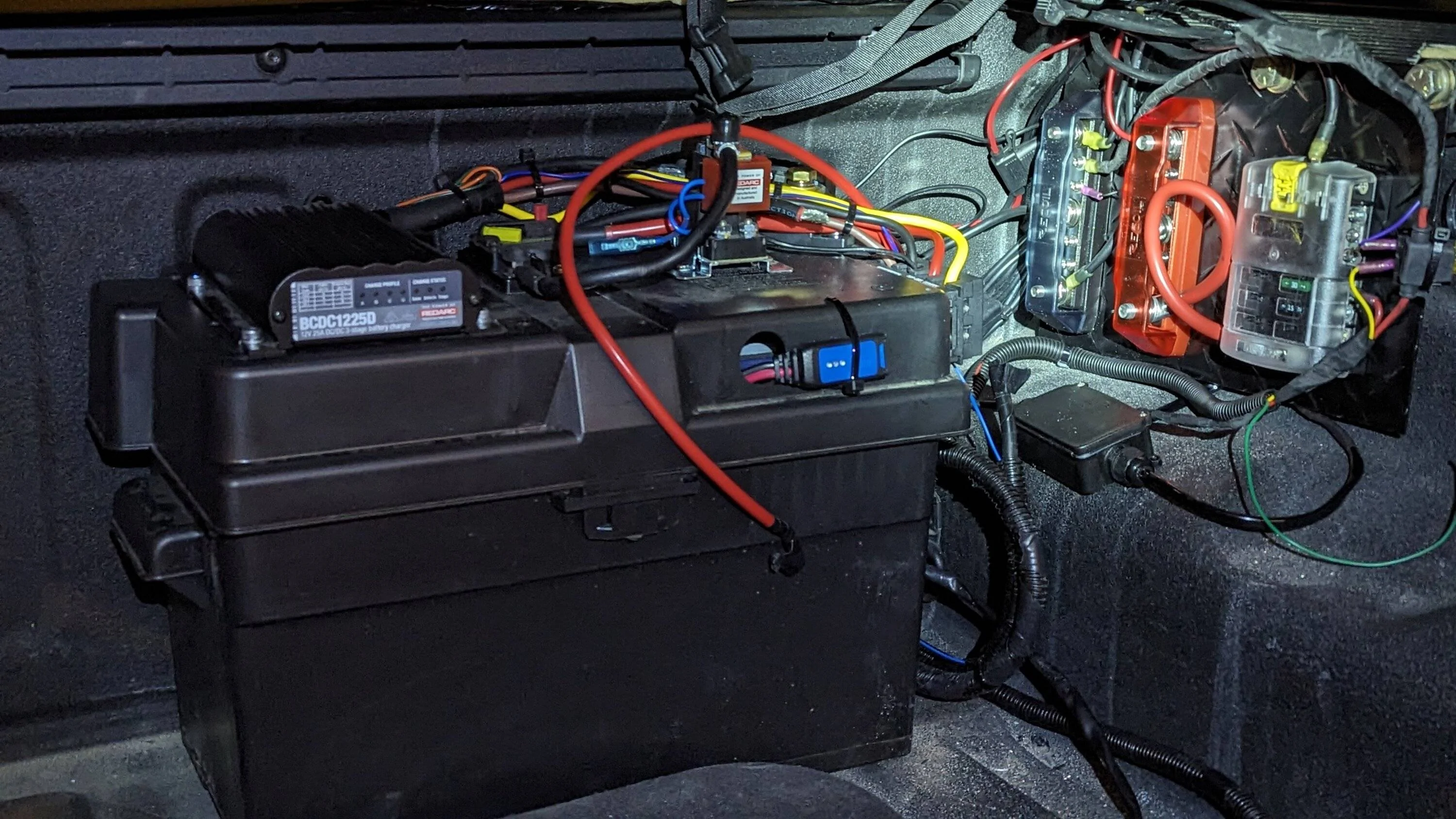

Started integrating the new charger into the house battery setup last night. While the pics aren't good, the work is ?
Jeep Gladiator Alaska Daily Drivers: Hydro Blue 80A and Bright White JTR PXL_20240224_073057059
Cut an aluminum panel from diamond plate to hold bus bars and the fuse block. This will keep the bundle of wires to a minimum and separate the main wiring for the battery away from the auxiliary wiring.
I will need to get some larger crimp terminals to continue which will put the project completion on hold for now. More to come.
