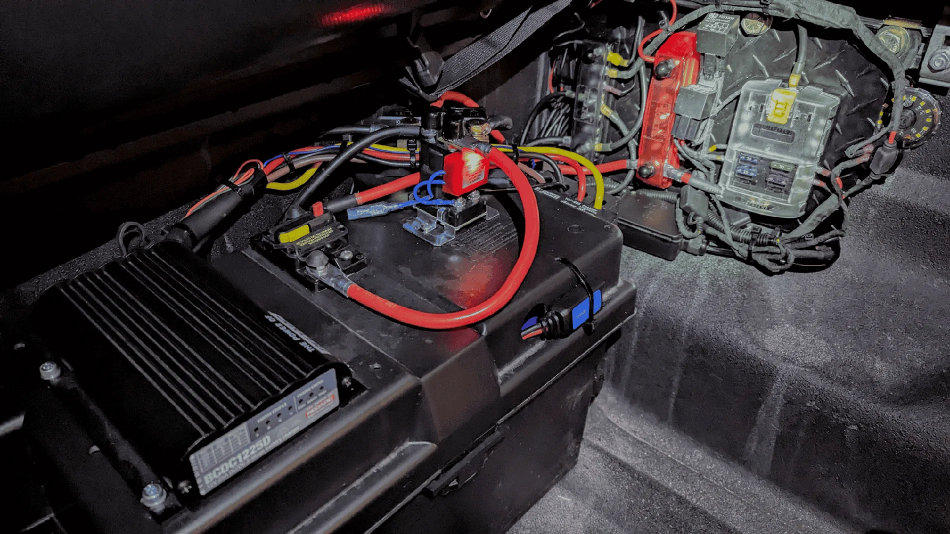

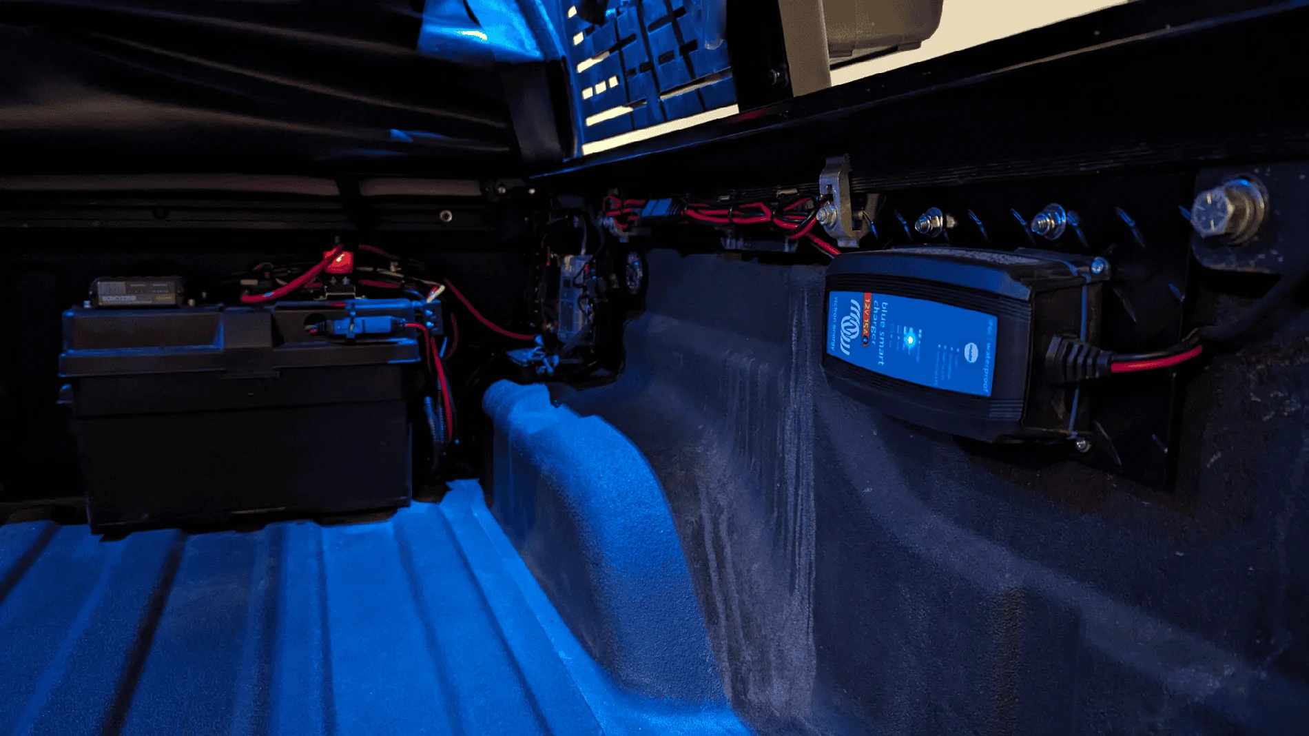

Found some terminal lugs at a Napa nearby and made some more progress on the house battery setup. Haven't even connected up the new battery charger yet ?

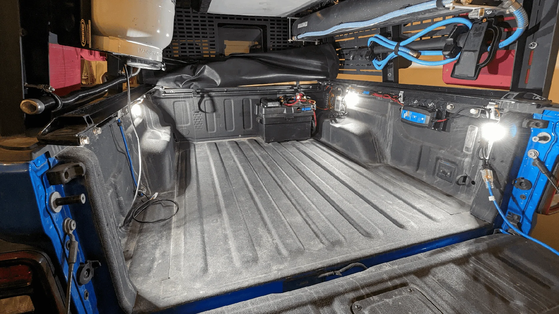

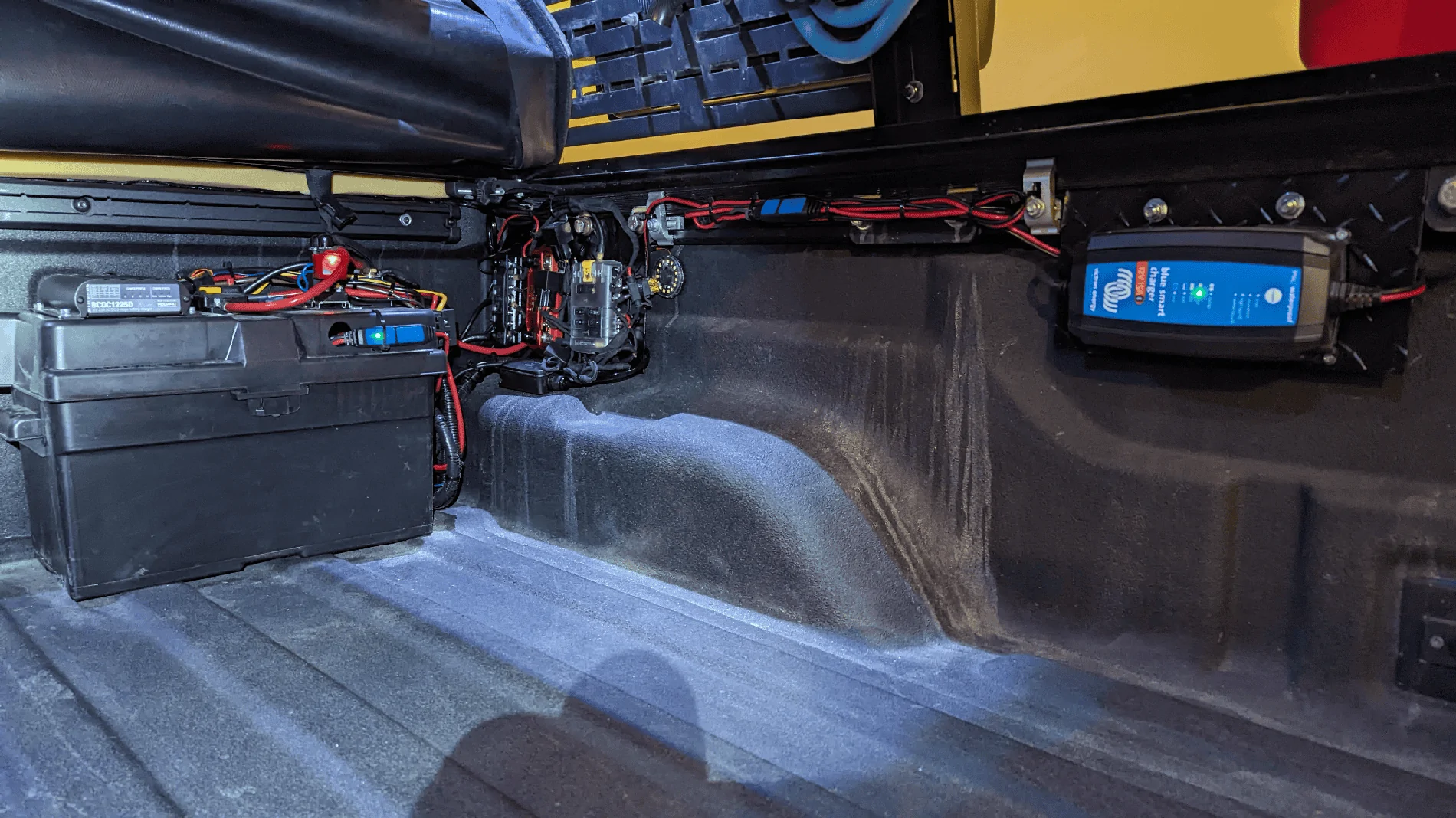

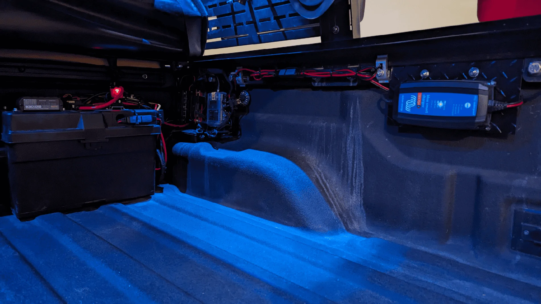

And now for the conclusion...
Jeep Gladiator Alaska Daily Drivers: Hydro Blue 80A and Bright White JTR PXL_20240228_032802380
Jeep Gladiator Alaska Daily Drivers: Hydro Blue 80A and Bright White JTR PXL_20240228_032723456
Jeep Gladiator Alaska Daily Drivers: Hydro Blue 80A and Bright White JTR PXL_20240228_032751639
Jeep Gladiator Alaska Daily Drivers: Hydro Blue 80A and Bright White JTR PXL_20240228_032829040

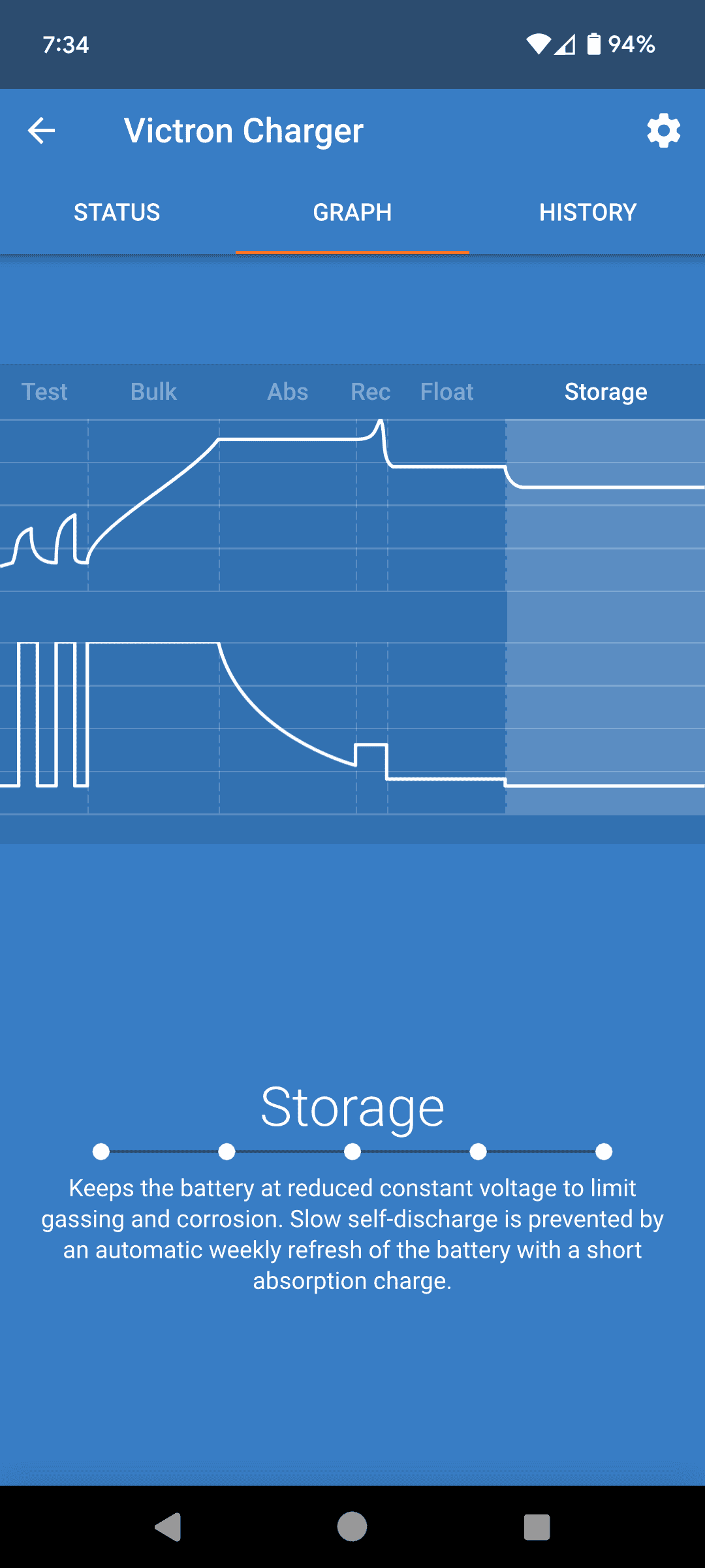

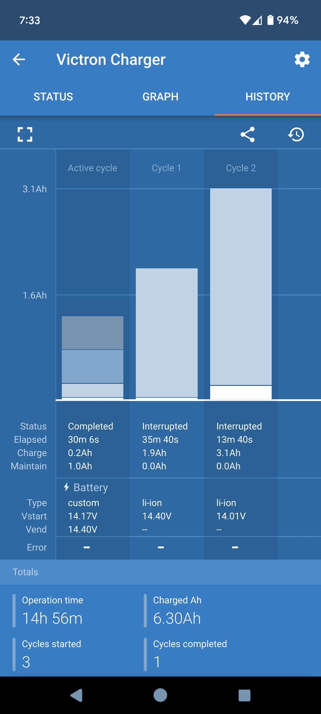

The charger is a billion times nicer than the Noco and configurable. The Bluetooth app is incredible. Victron's app puts Redarcs to shame. Redarc claims to have better accuracy, we'll be testing that. I'm happy with how it came out. I didn't want to eat too much of the limited space but getting the wiring separated helped my anxiety.

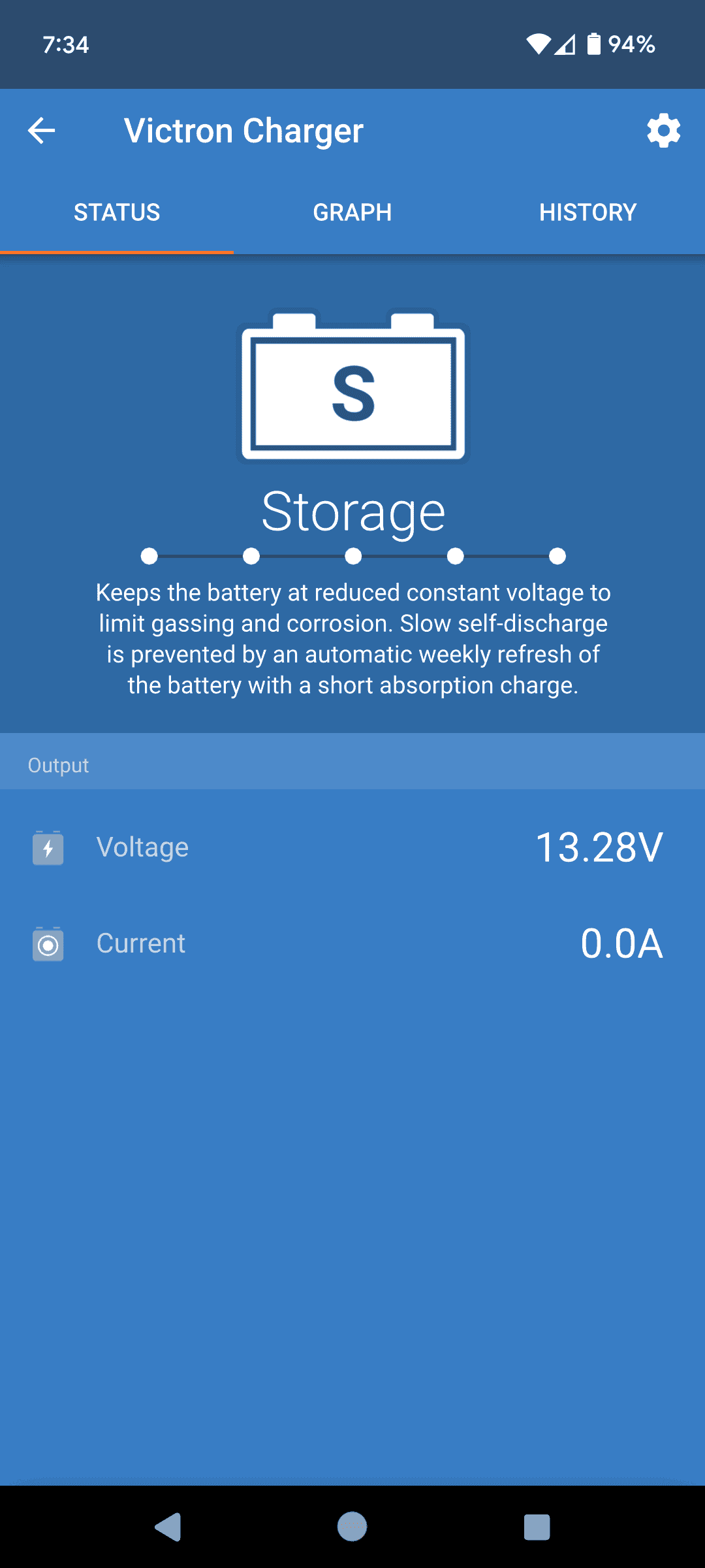

What is it that you can see from the victron charger app? Isn't it just a trickle charger/maintainer?

Woah that's cool, and that's the charger itself? So it has integrated bluetooth? I might need one lol
Yessir! It's pretty incredible.

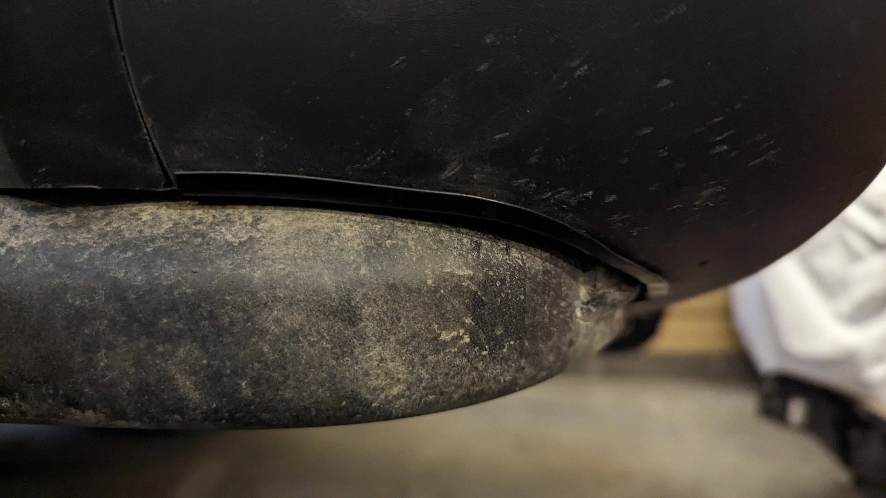

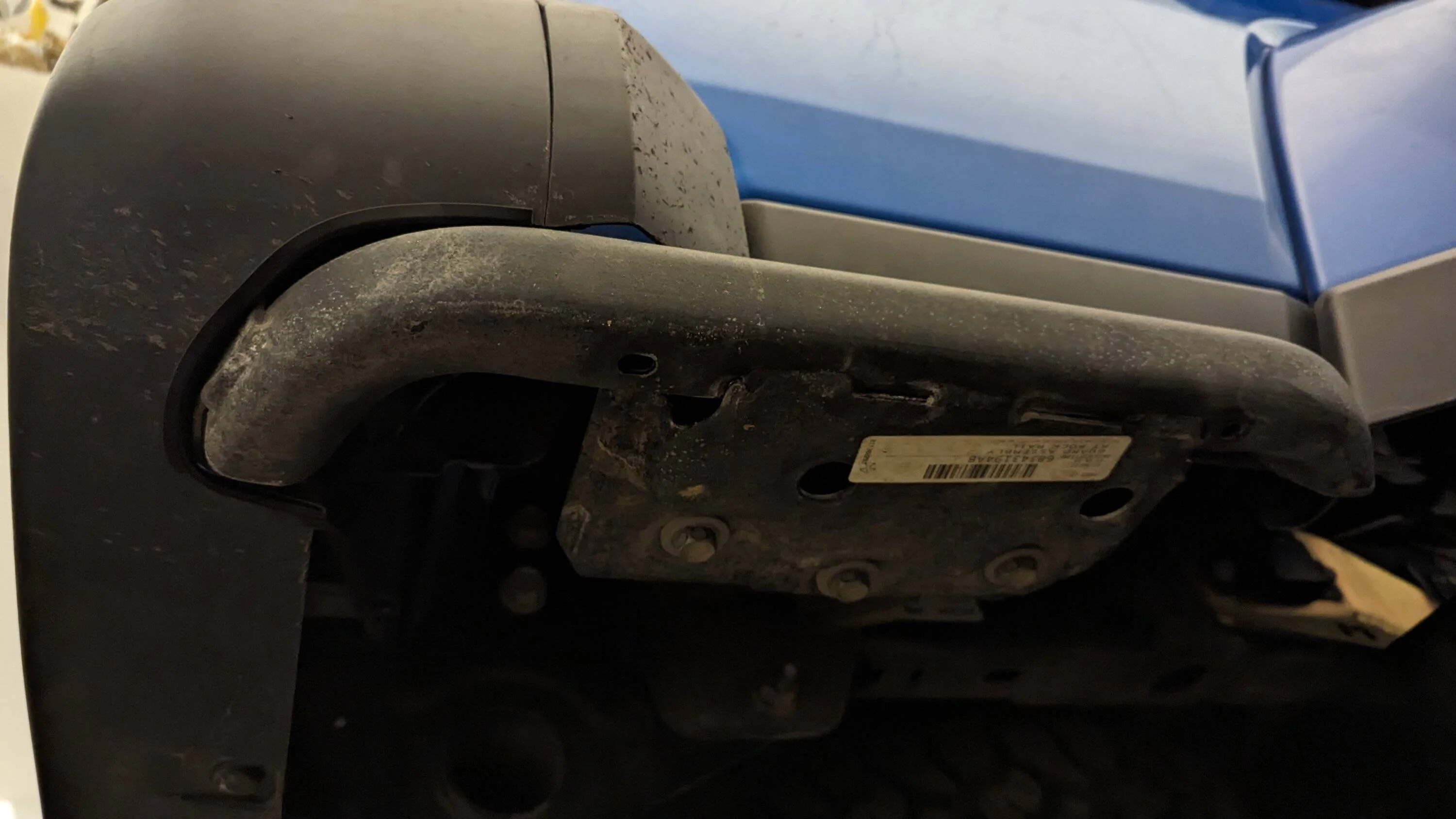

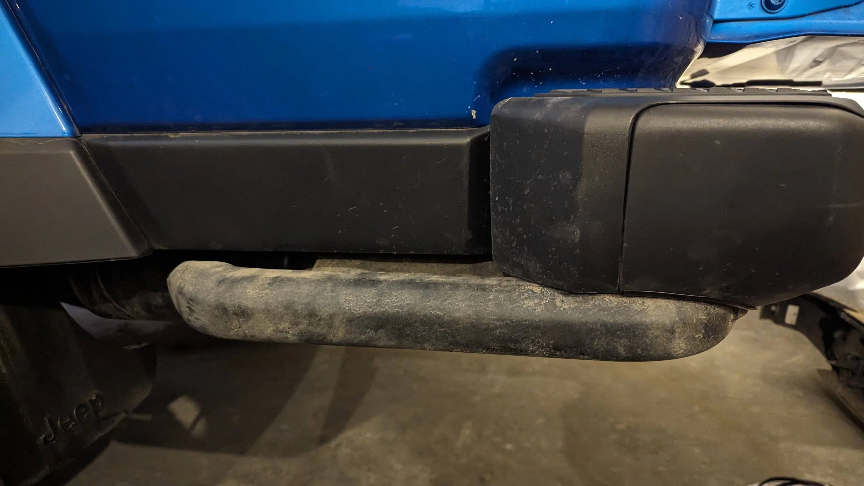

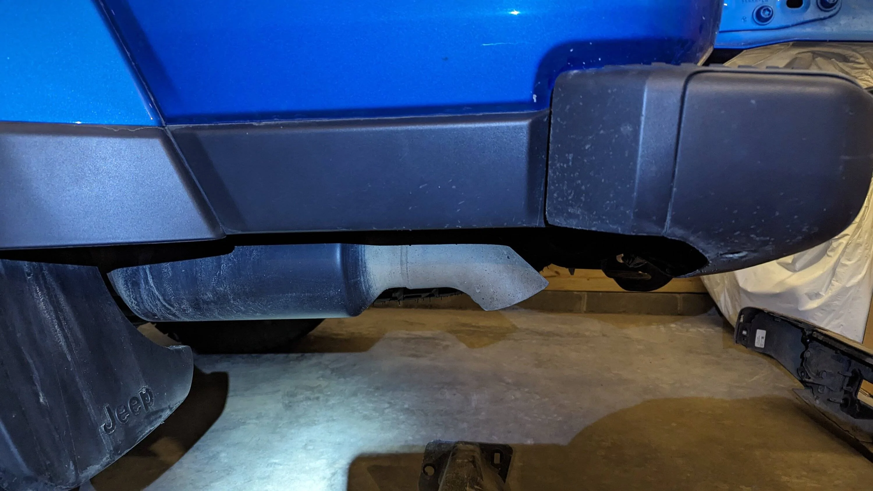

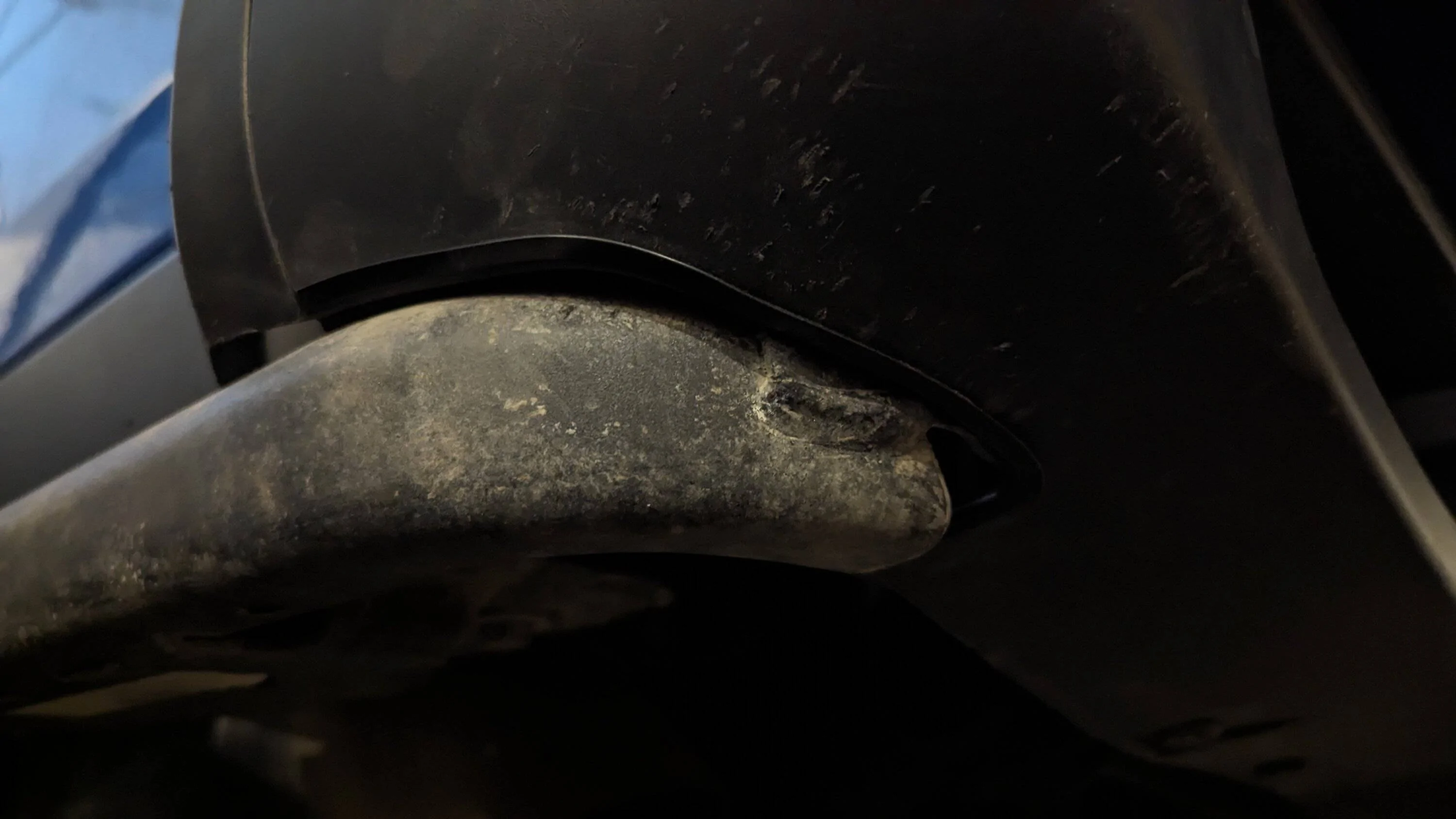

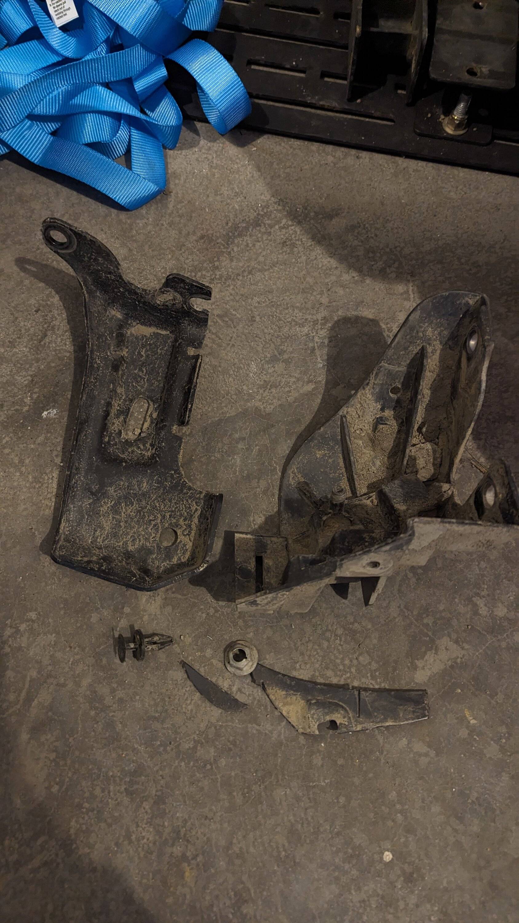

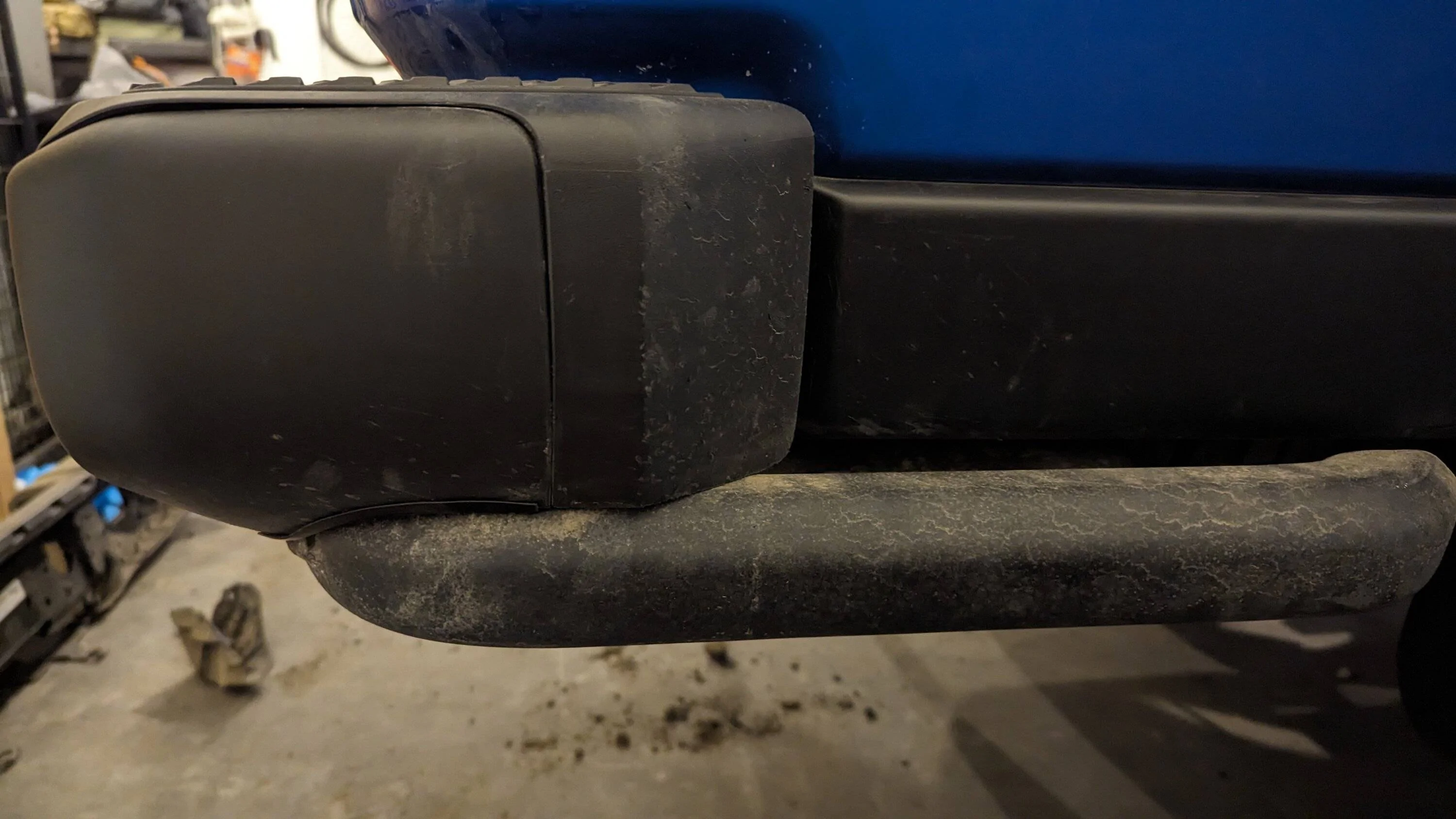

As you may recall, we put a RockHard 4x4 rear bumper on our white Rubicon. This was to step up the quality and to add parksense. This left the Rubicon bed sliders available to be sold or used elsewhere.
Used elsewhere was a great plan since our blue Jeep does not have any bed protection currently.

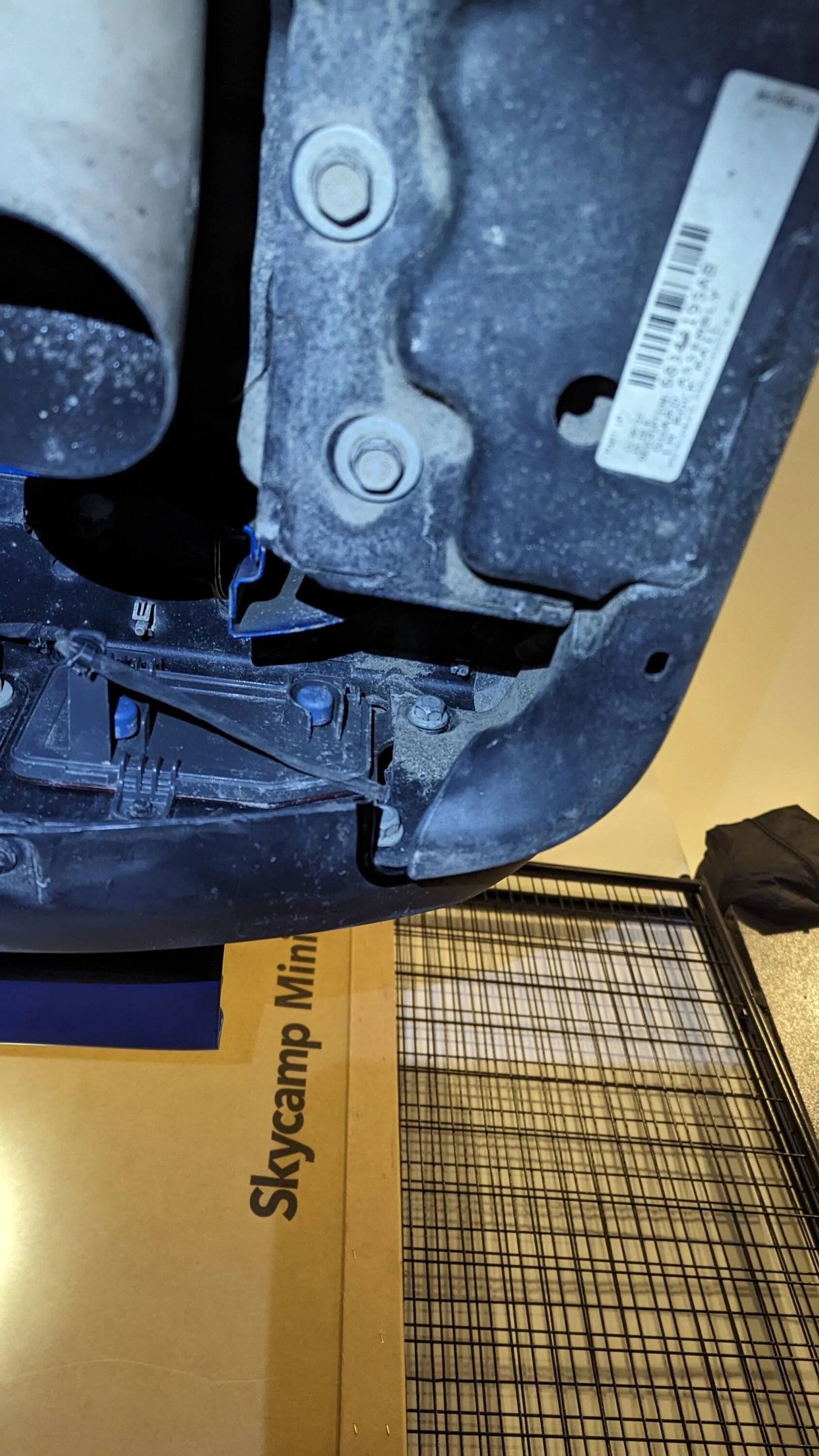

Tonight the magic happened! It requires removing some existing brackets and cutting the bumper to shape around the sliders. You will also need hardware if you don't already have it. Prepare for dirt to fall in your face, tuck your beard into your sweatshirt ?
Jeep Gladiator Alaska Daily Drivers: Hydro Blue 80A and Bright White JTR PXL_20240301_022419363.MP
Before
Jeep Gladiator Alaska Daily Drivers: Hydro Blue 80A and Bright White JTR PXL_20240301_000942779
Remove this stuff
Jeep Gladiator Alaska Daily Drivers: Hydro Blue 80A and Bright White JTR PXL_20240301_011736509
Tape off your desired shape to cut. I cut with tin snips and then smoothed out with a Dremel. Touched up the edges with door trim for that clean look.
Jeep Gladiator Alaska Daily Drivers: Hydro Blue 80A and Bright White JTR PXL_20240301_011542382
Jeep Gladiator Alaska Daily Drivers: Hydro Blue 80A and Bright White JTR PXL_20240301_011554944
Jeep Gladiator Alaska Daily Drivers: Hydro Blue 80A and Bright White JTR PXL_20240301_011604845
Jeep Gladiator Alaska Daily Drivers: Hydro Blue 80A and Bright White JTR PXL_20240301_011708364.MP
Passenger side
Jeep Gladiator Alaska Daily Drivers: Hydro Blue 80A and Bright White JTR PXL_20240301_021955261
Jeep Gladiator Alaska Daily Drivers: Hydro Blue 80A and Bright White JTR PXL_20240301_022012962
Boom success! ?

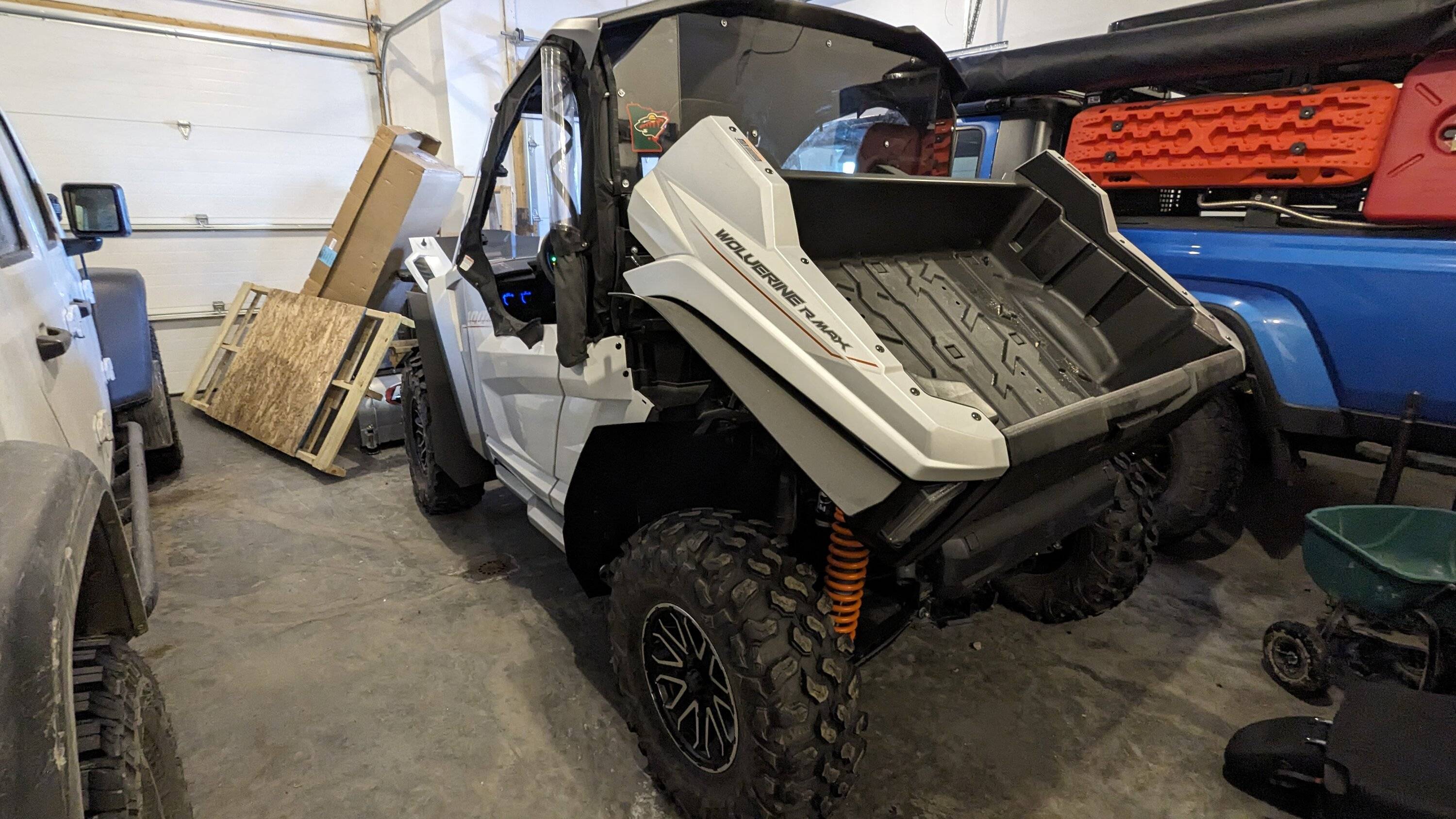

Warning, non Jeep content!

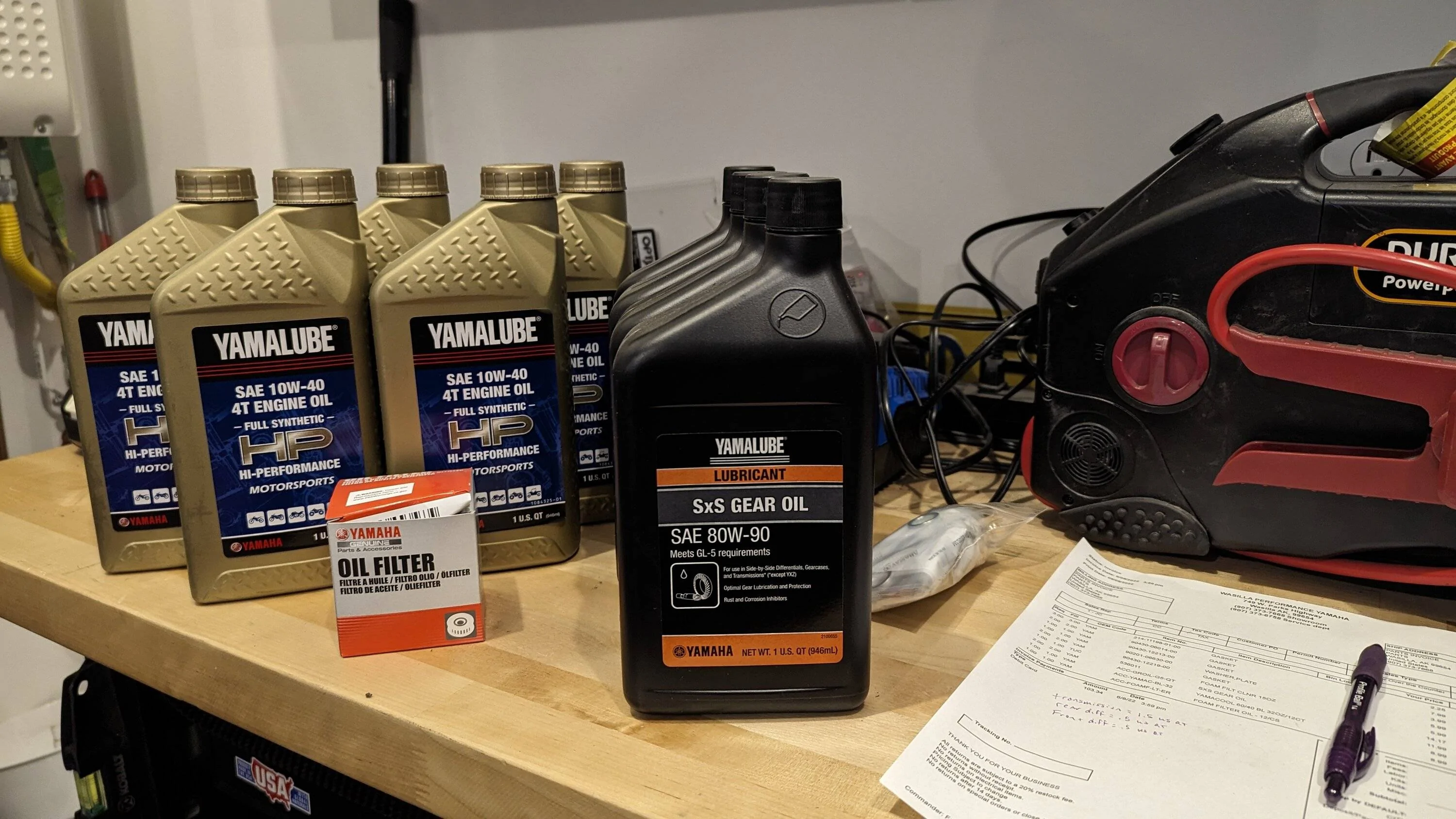

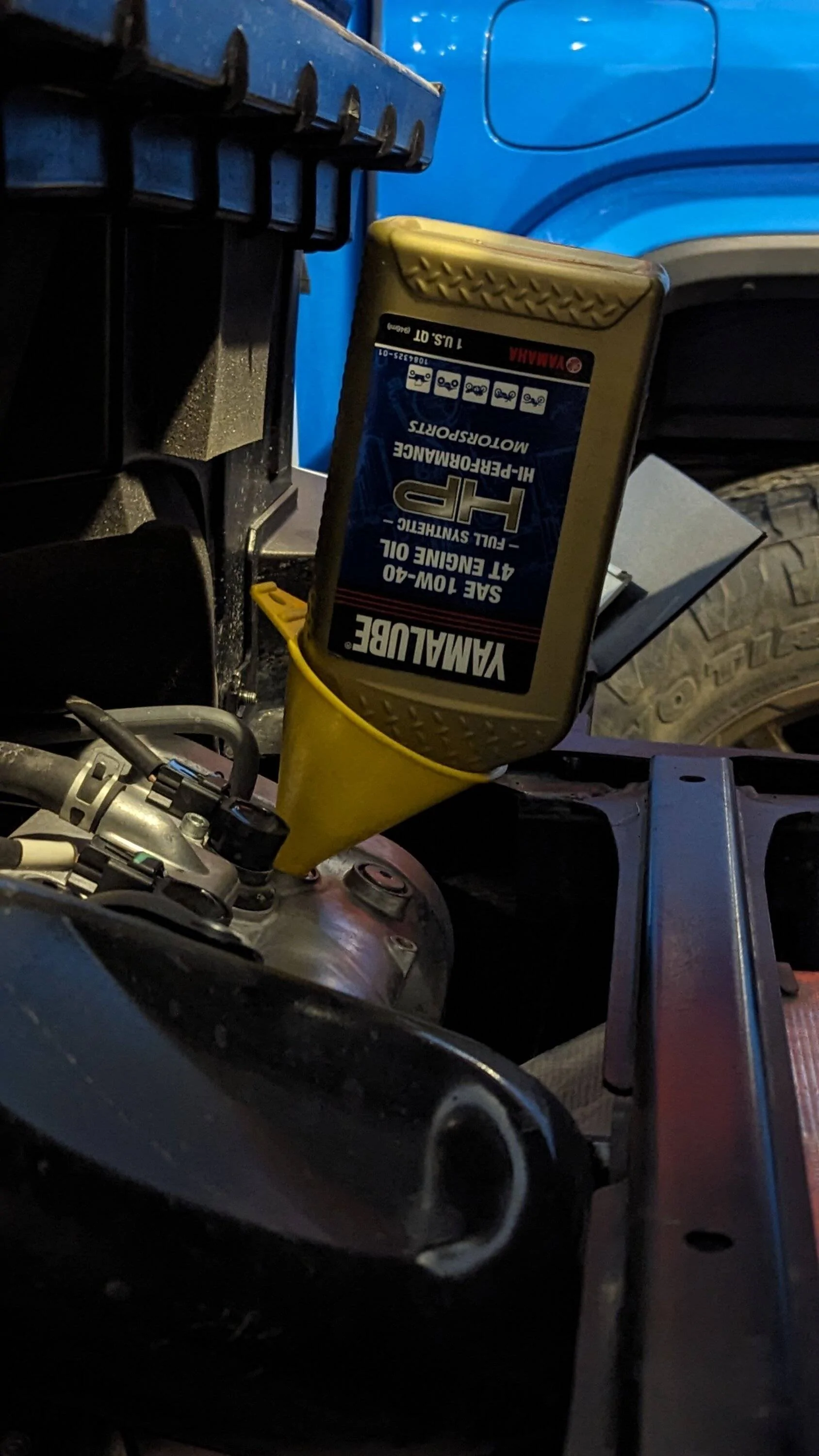

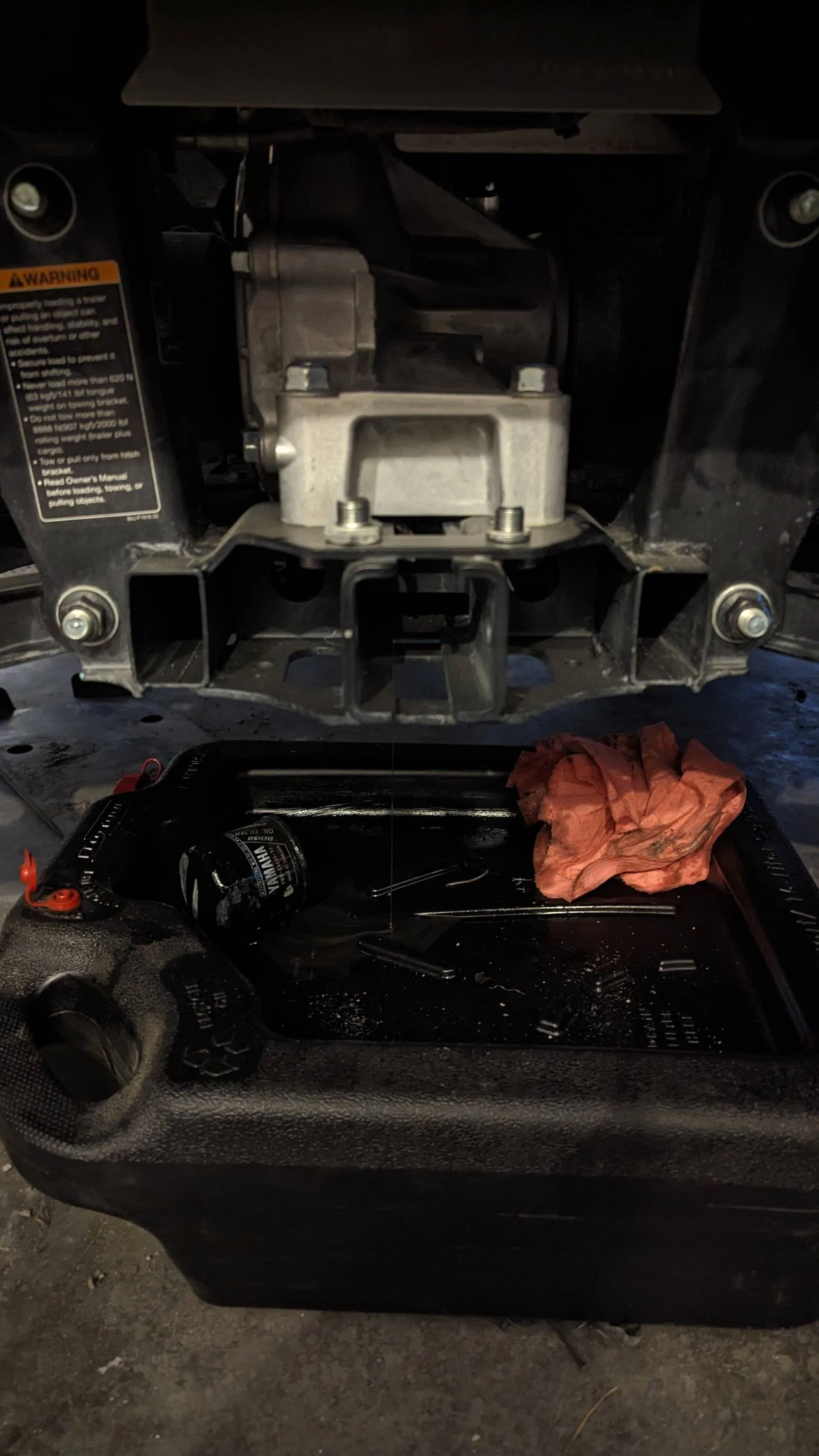

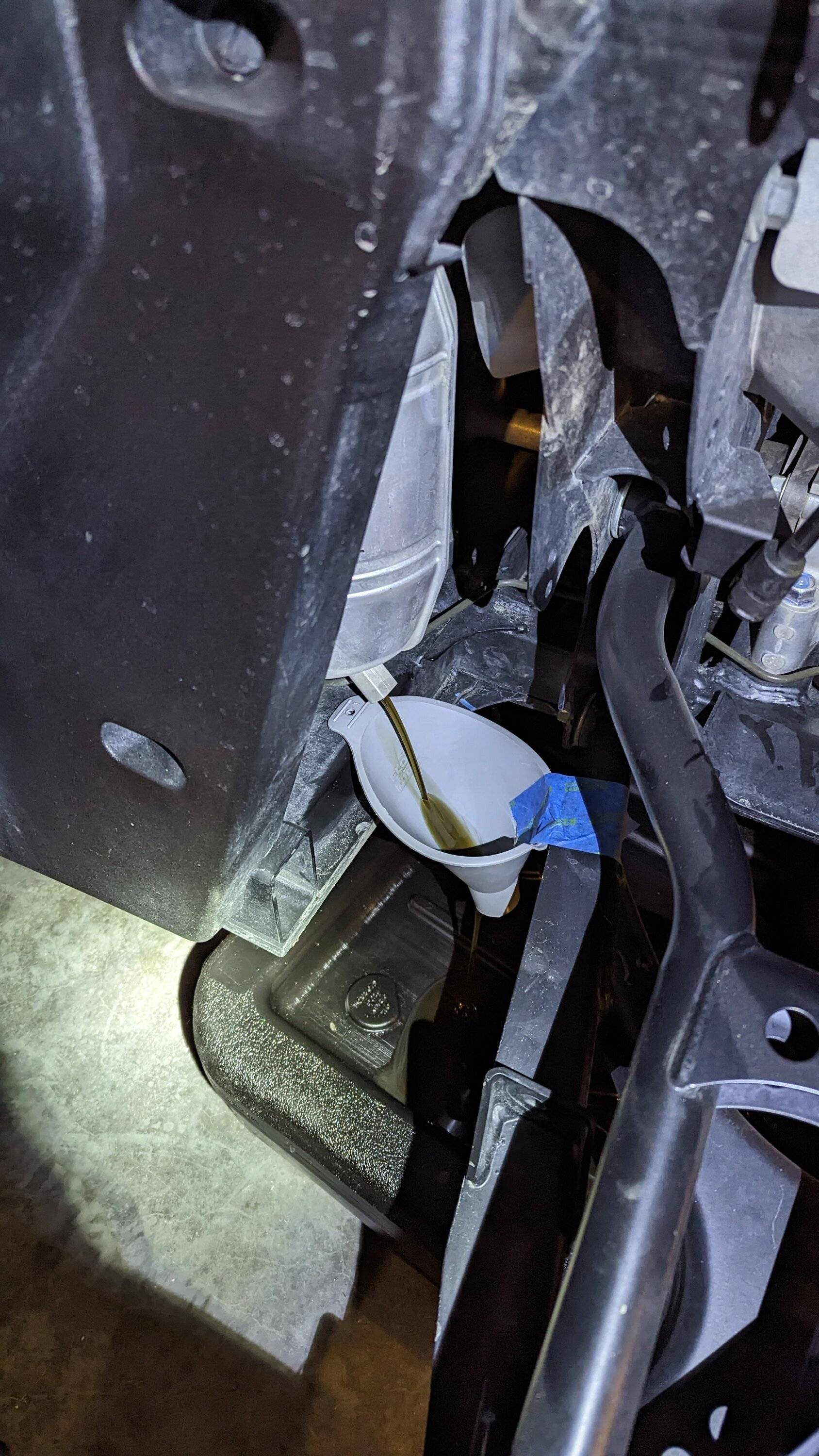

Some days are a lot less sexy around the garage. Today was that day. After two years it was time for some maintenance on the Yamaha rmax2 1000 limited edition. Woof, that's a mouth full. Let's go with sxs.
The oil system is a dry sump. It has 5 drain ports in various places plus the oil filter itself. It takes a good bit of time with one drain pan to move around and get it all. After that, it moves quickly.
Oil, transmission, front diff, and rear final gear fluids were all changed.
The air filter, brake fluid, brake pads, and coolant are all ready to go.
We're hoping this helps spring come ?
