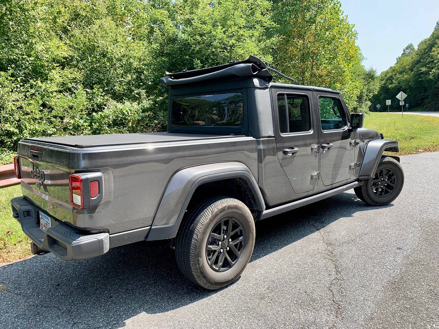

I also upgraded my 245/75/17 for the very common and readily available 265/70/17. This is the tire size that Jeep should have put on the Sport and Sport S trim levels. The diameter is slightly increased also the width is increased noticeably. I went with the updated version of the cult classic Michelin Defenders LTX M/S2. These tires are standard with XL sidewalls with LTs available in certain sizes. I think heavy LTs with Sport gearing would be a mistake. The Defenders are road quite with decent off road performance if needed. Also because the 265/70/17 are close to the stock diameter, the engine and transmission will be happy and acceleration will still be brisk.

I went from the stock highway 245/75/17 to LT-E all terrain 265/70/17. About the same diameter so no adjustment for tire size or speedometer is required, no loss in towing ability. But wider due to 265 instead of 245, and then wider still due to all-terrain tread. About 9" wide instead of 7" even though the same diameter.
I keep them around 50 PSI because I tow and that's what it took to keep the tires cool at 70 MPH in the summer heat. Wear is excellent. Did so on another truck for decades.
About a 10% hit, around 2 MPG. Where I used to get around 22 with the stock highway tires, I now get around 20 MPG.
Good cornering and emergency maneuvers due to being LT tires. Good for towing stability and offroading durability. Survives the rocks. Great for blasting through switchbacks.
Also have Bilstein 5100 shocks, making for a well controlled vehicle. Drives like a sports truck, but you do feel the little bumps. It's not a big deal if you are used to trucks with LT tires, or sports cars.
265/70 17 is a very common size. Available from many manufacturers, and thus probably easy to find a replacement in some small town if necessary.
If I lived closer to the mountains and forest then I'd probably get a larger size, but as it is I have to travel hundreds of miles to get anywhere interesting, usually towing as well, and am lucky to do so once a year at the most. So I'm content to use a practical size of tire and be limited to the mid-grade trails.
I happen to use Cooper Discoverer AT3, but I'm sure other brands would be fine as well.

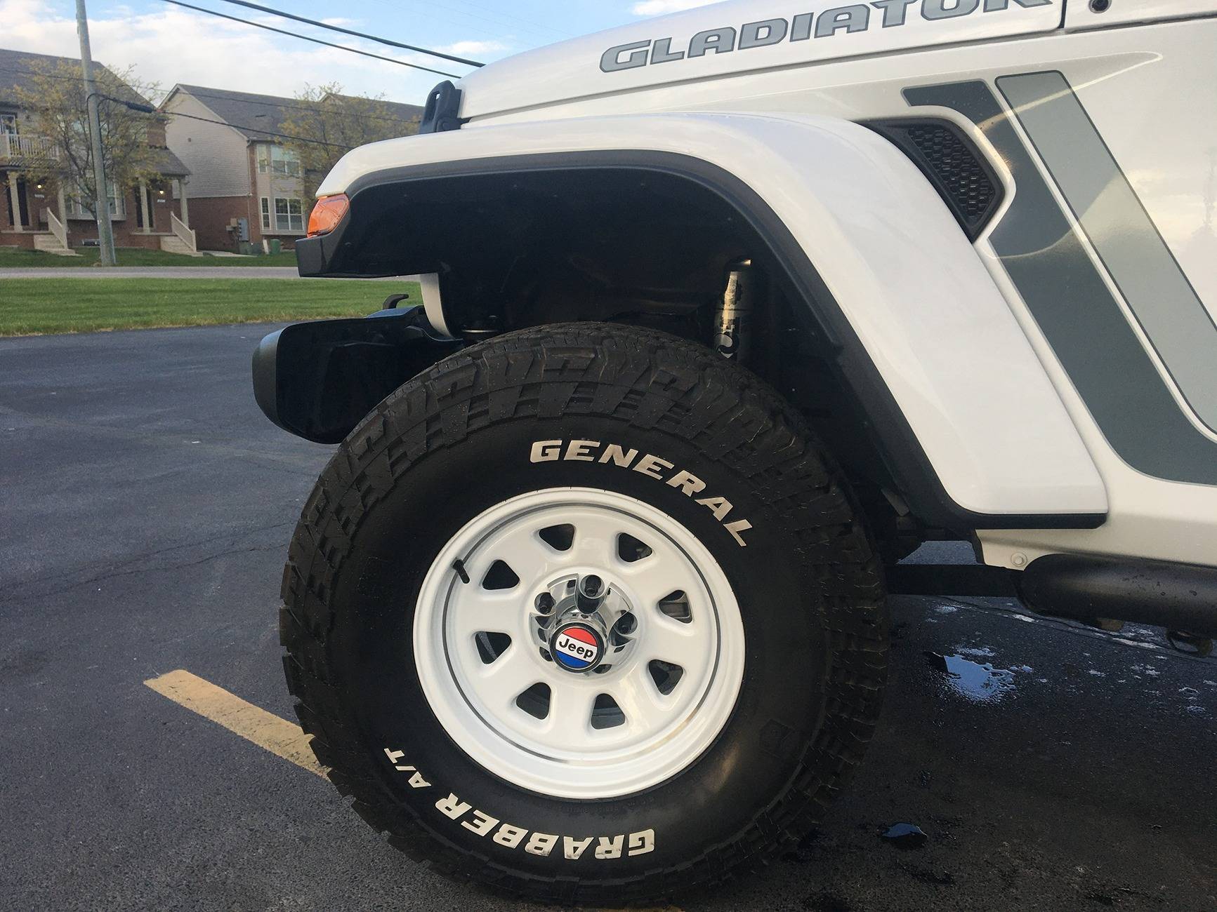

General Grabber AT's. Excellent tire. Good for on off road. Mountain peak snow rated. Rolled 51K and still have lots of tread left

Where in the Sam Hill did you get those Jeep center caps !! And did your rims have the screw holes pre-drilled and threaded ??
I want a set of 4 😂
I want a set of 4 😂
The center caps are from the Quadratec CJ retro rims I have and those are vinyl decals I had a guy print for me.
