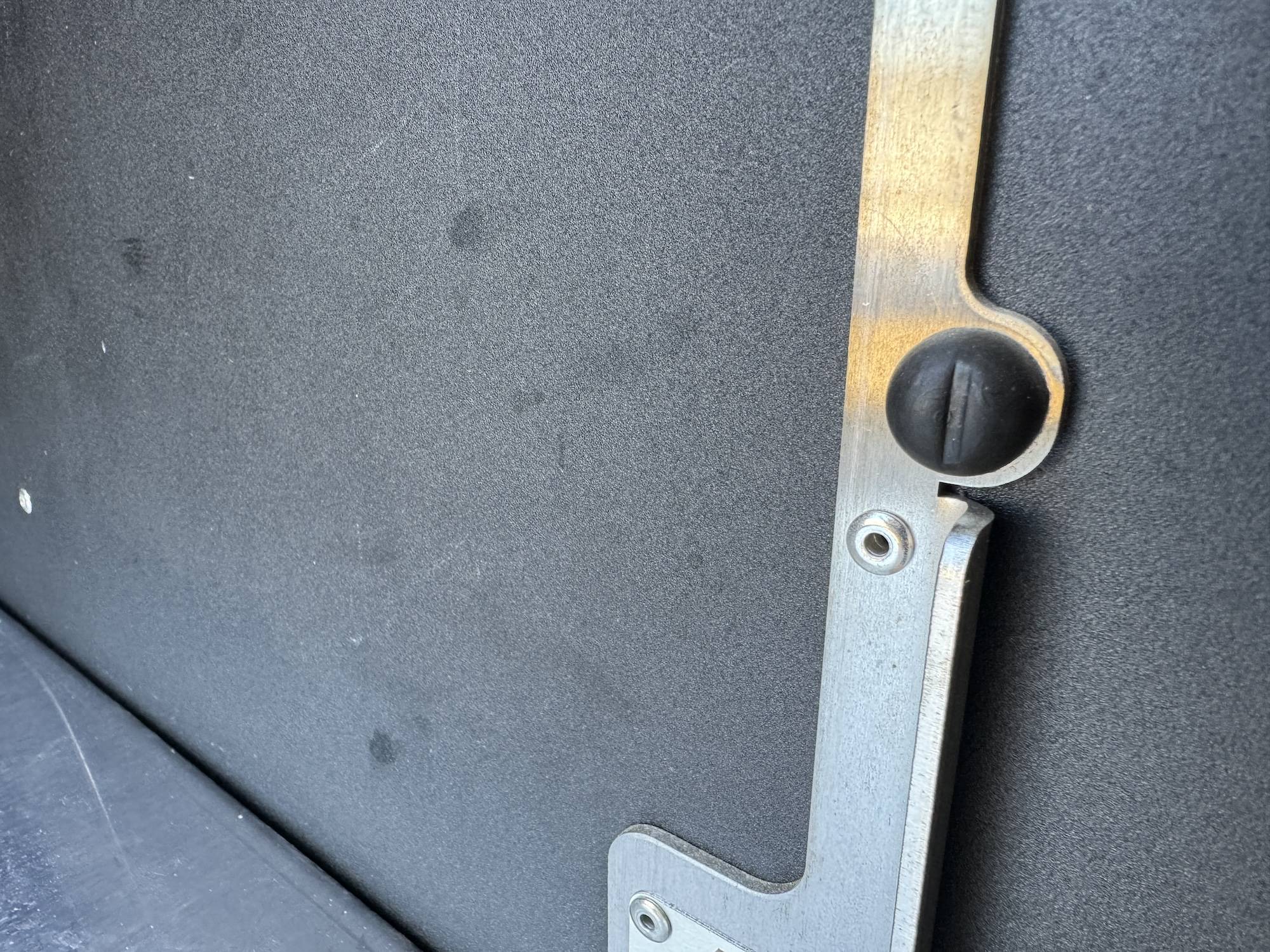

If you have a GP-Factor table on the inside of your camper door (the big table), could get me a side close-up photo of the rubber bumpers the table closes against?
I’m trying to determine whether the bumpers we have are too long …

Hey folks, me again with a request for help …

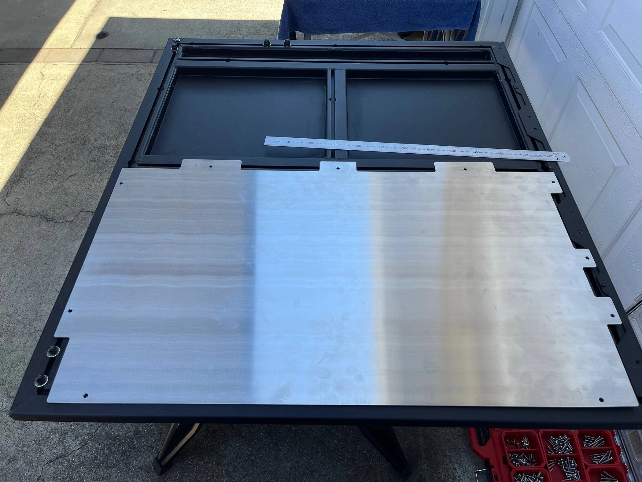

It looks like the rubber is flush with the stainless and the stainless is perfectly flush with the mounting plate. No rubber squeezed between stainless and mounting plate.
We have the mounting brackets loose and need to rivet them to our own backing plate, but the bumpers are sticking out of the back of the stainless bracket by maybe 2mm or so. If I just rivet that on, that’ll create issues. I could trim them a bit, but they are the ones GP-Factor uses, so I’m wondering where the problem is. I don’t think the mounting plate is drilled out behind them.
Do the bumpers come out or are they tight in there?

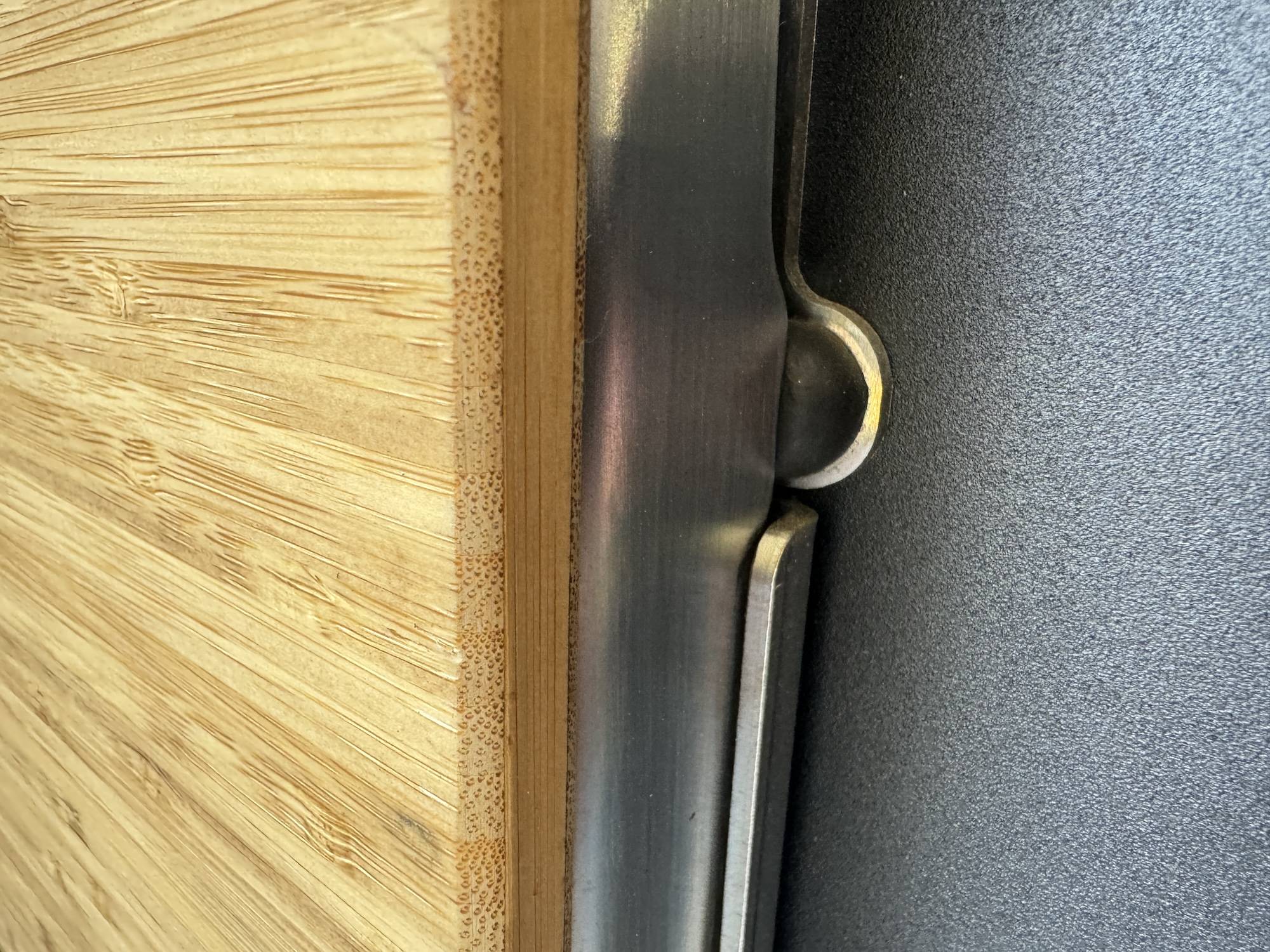

Working on this right now.

It’s perfectly right since we bought the parts from GP-Factor and it’s our own backing plate. We wanted the table to sit lower, since it’ll be our main cooking station and the truck is relatively high.
So, I’m trying to recover from my own stubborn decision to build my own mount. GP-Factor didn’t mention a drilled out hole behind:
So those bumpers usually sit flush due to the backer being on the table assembly. I would take them off and trip them down a bit then rivet them on

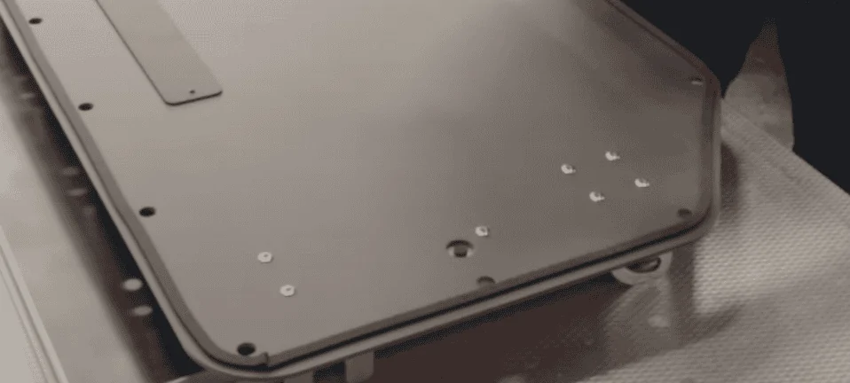

You were correct with your assumption (I thought the same, but just couldn't read this from GP-Factors response to my question about it). Here's a shot from a Grenadier install:
Jeep Gladiator Alu-Cab Canopy Camper Roll Call Screenshot 2024-04-03 at 13.24.00
It clearly shows the cutout for the bumper. Okay. On to riveting this beast to the mounting plate.

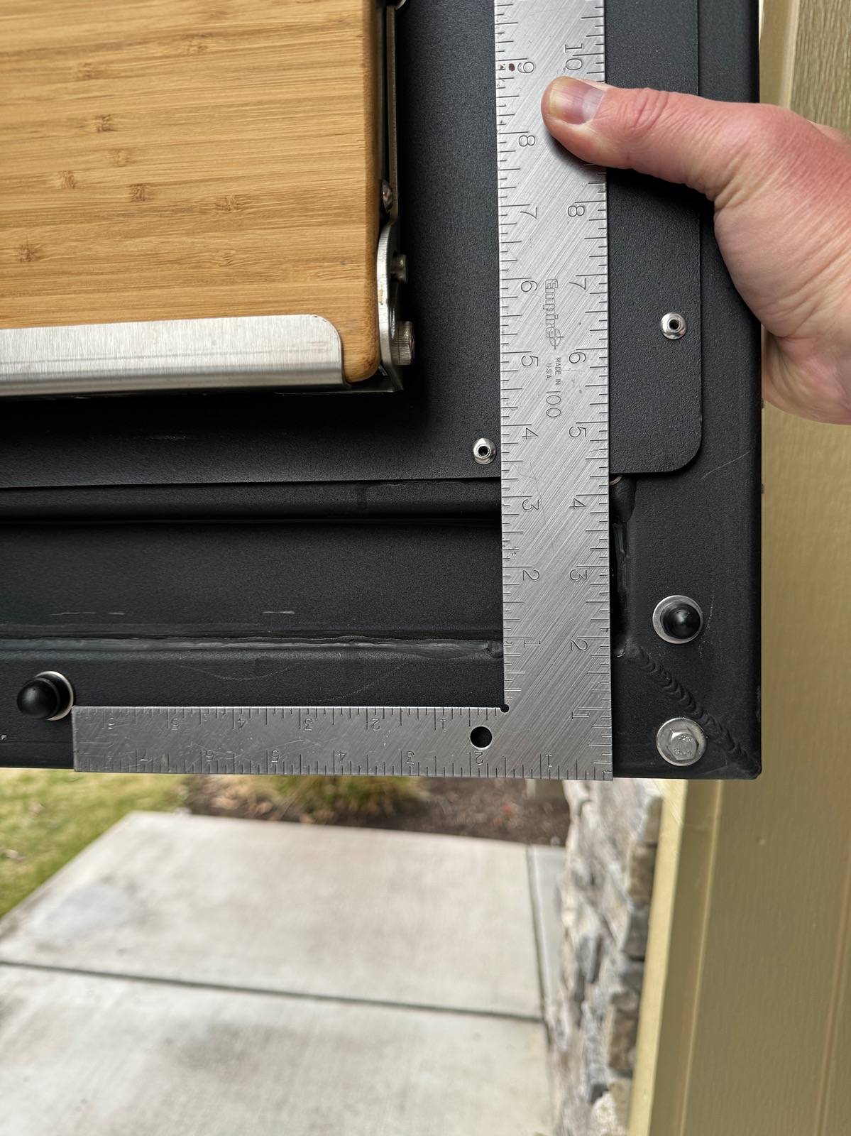

You have a newer style door. Mine, ordered in late spring of 2022 does not have any t-slot. But it looks like your estimate is realistic.
Given what I see in your picture, our's is about 3.5 inches lower. The lower edge of the mounting bracket is 48mm (just under two inches) from the bottom of the door, while your's seem to sit at 5.5 inches.
