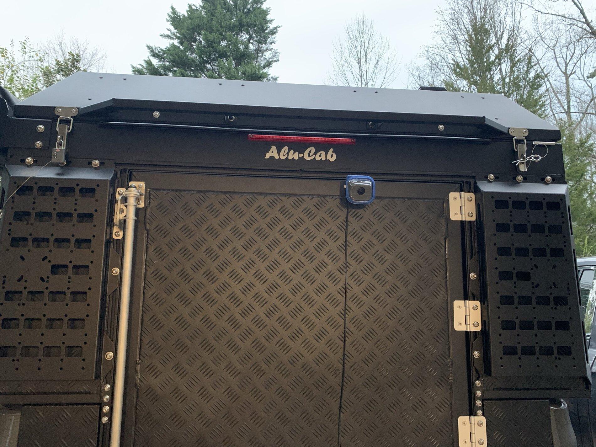

I have the oem camera temporarily mounted in the gap left from where the camera cable came out of the body. I have three ideas for a permanent mount:
-a custom bracket (worried about it not being waterproof)
-putting it in a small Pelican box and mounting to the door or rear side panel. I have cut a hole in a small Tupperware container as a practice piece to see how well it works before cutting into a $22 pelican case, need to play with it tonight.
or
-cutting a hole in the door or rear side panel the same as was in the tailgate and mounting it with the oem brackets.
I like thought of mounting it directly in the door or side panel since it would be the cleanest, but it worries me a little if I ever had to change it. The panel is replaceable, though not easily I do not think.

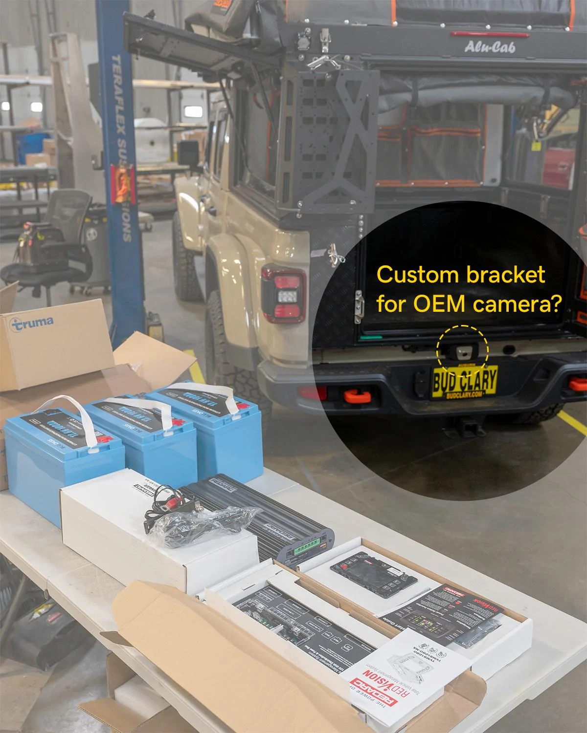

Our customers JT is getting a boost in power. Lithium batteries and the full REDARC Red Vision and Manager 30 system. Plus a Truma propane heater.
Jeep Gladiator Alu-Cab Canopy Camper _Z620424FB-2
Is this the OEM backup camera? If so, how is it mounted?
It is, we have an in-house fabrication team that custom-made a one-off mount.

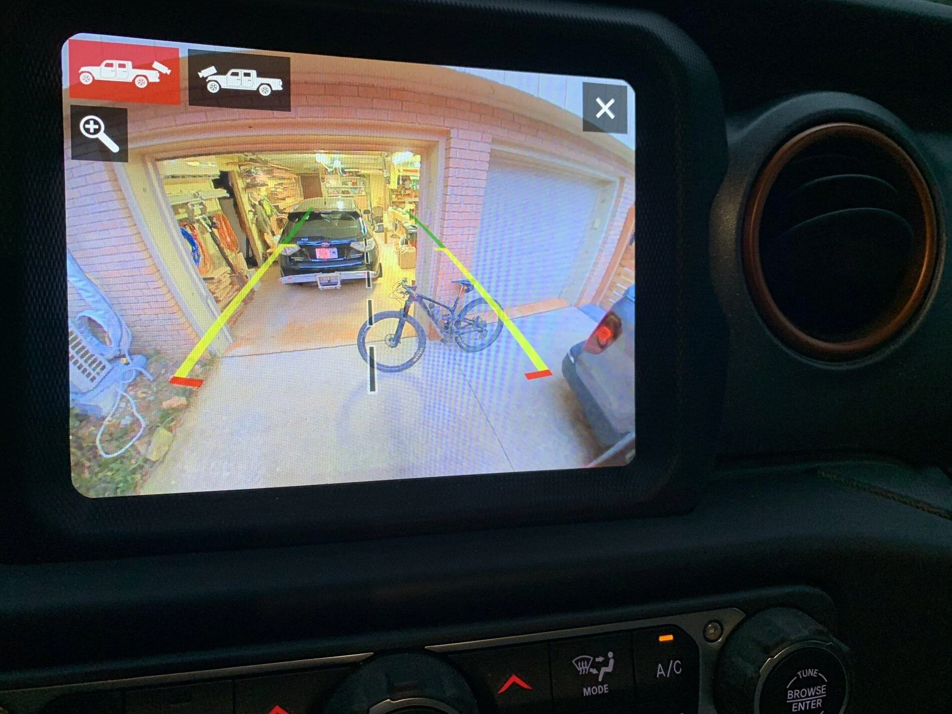

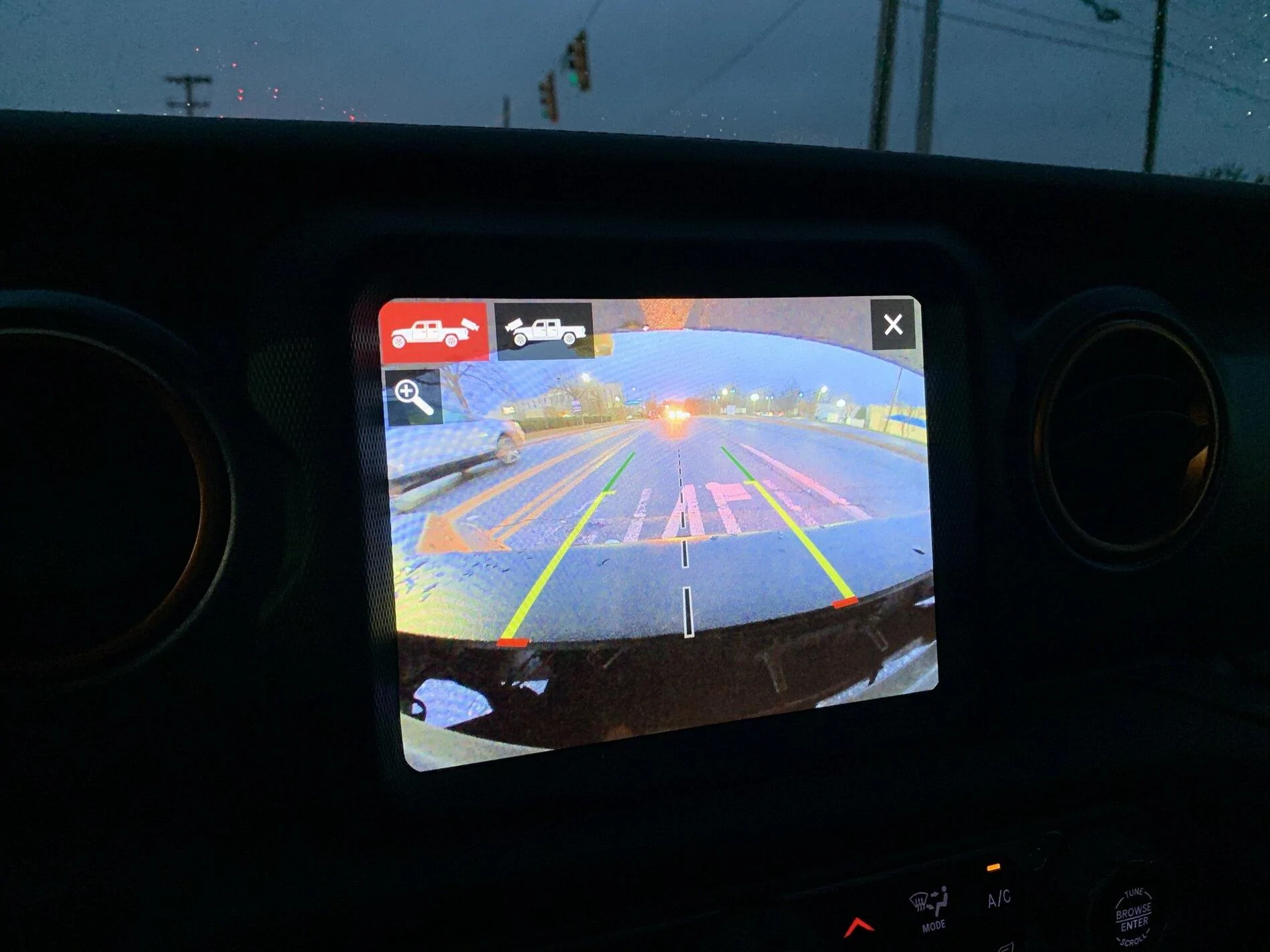

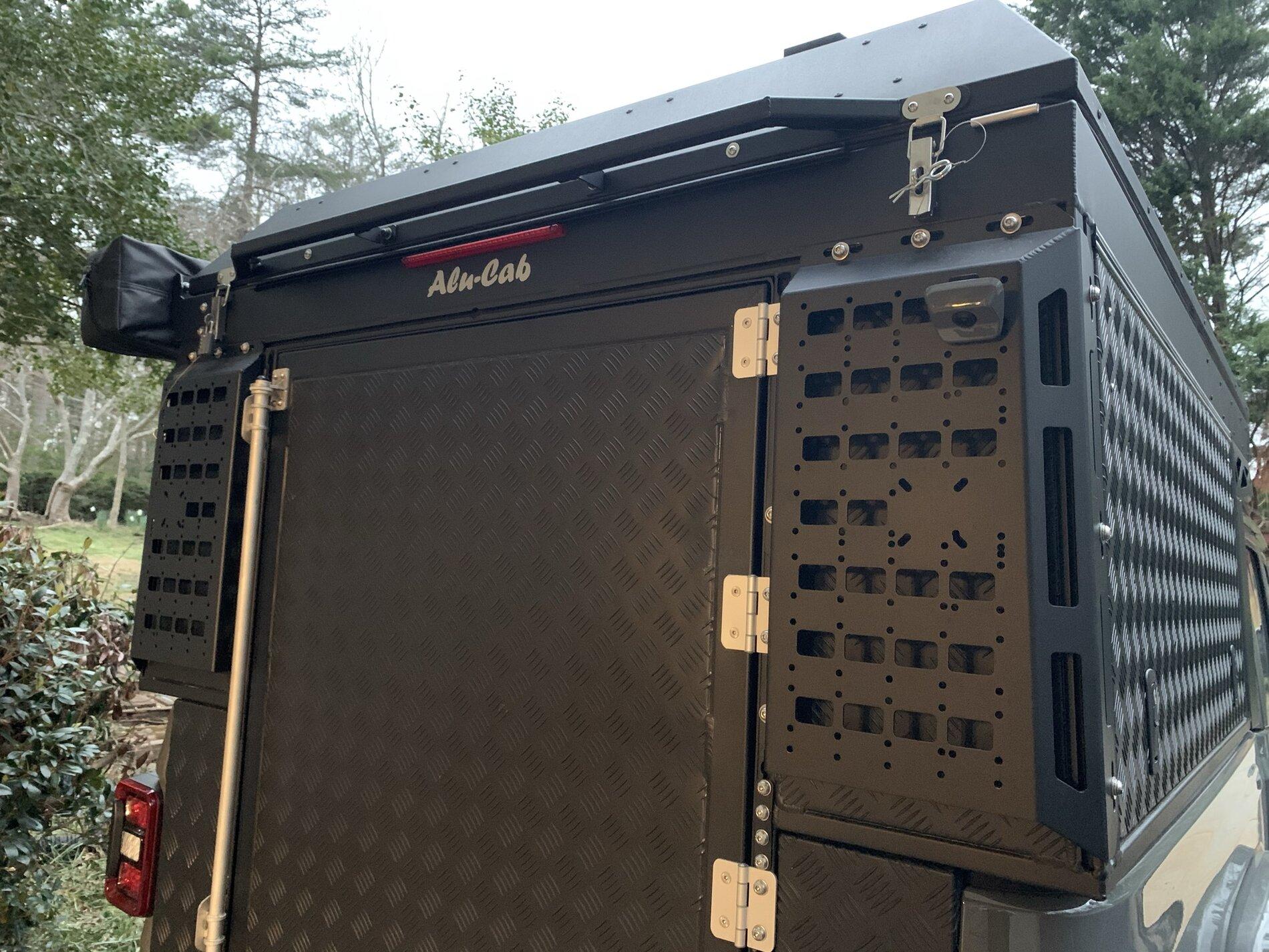

I played around a little last night and mounted it in a Tupperware container (cheap). I really like the view at the top of the door, but do not like the aesthetics. I mounted it to the side to see the view in case I decide to cut the door to mount it (Probably not going to do that)
I tried it on the Molle panel too and it works well overall, but the lines are off. to get it to fit on the panel without a box I will need to cut the panel holes bigger or take the trim piece off the camera, mount it, and glue it back together.

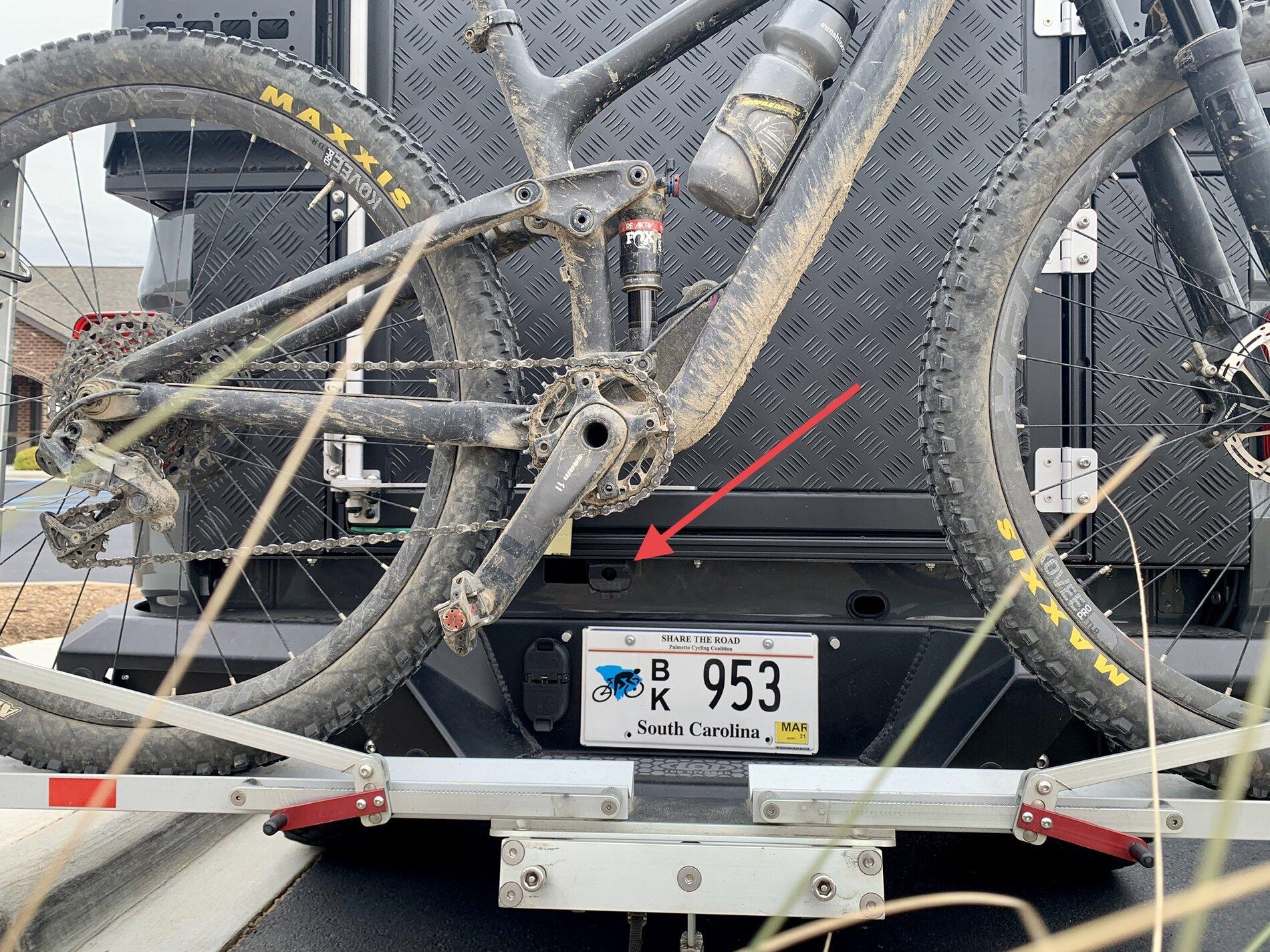

The current camera location, above the bumper, is not ideal because of the view when the bikes are on the back. It works, but not great. (Last image but without bikes)
I am going to give it a few more days and decide.
