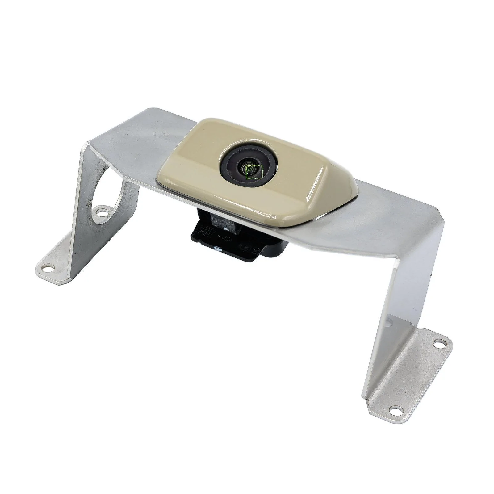

Picked up my ACCC about two weeks ago, we love it.
it gets bags in the rear coils Wednesday to see if it will help with the sag, and then a 2.5“ lift and 35s in the next few weeks if not.
I have the oem camera temporarily mounted in the gap left from where the camera cable came out of the body. I have three ideas for a permanent mount:
-a custom bracket (worried about it not being waterproof)
-putting it in a small Pelican box and mounting to the door or rear side panel. I have cut a hole in a small Tupperware container as a practice piece to see how well it works before cutting into a $22 pelican case, need to play with it tonight.
or
-cutting a hole in the door or rear side panel the same as was in the tailgate and mounting it with the oem brackets.
I like thought of mounting it directly in the door or side panel since it would be the cleanest, but it worries me a little if I ever had to change it. The panel is replaceable, though not easily I do not think.
Might I ask, do you get any dash lights or warnings that the tailgate lock or third brake light from the tailgate is disconnected? What about the camera, is the screen just black when you reverse?
Thanks!
Mtpisgah
Paul
Nov 15, 2020
751
929
Upstate SC
2021 JTM, 2018 JLR
Engineer
Thanks!
There were no warning lights with the camera or third light disconnected. When backing up, the screen was black except for the direction lines.

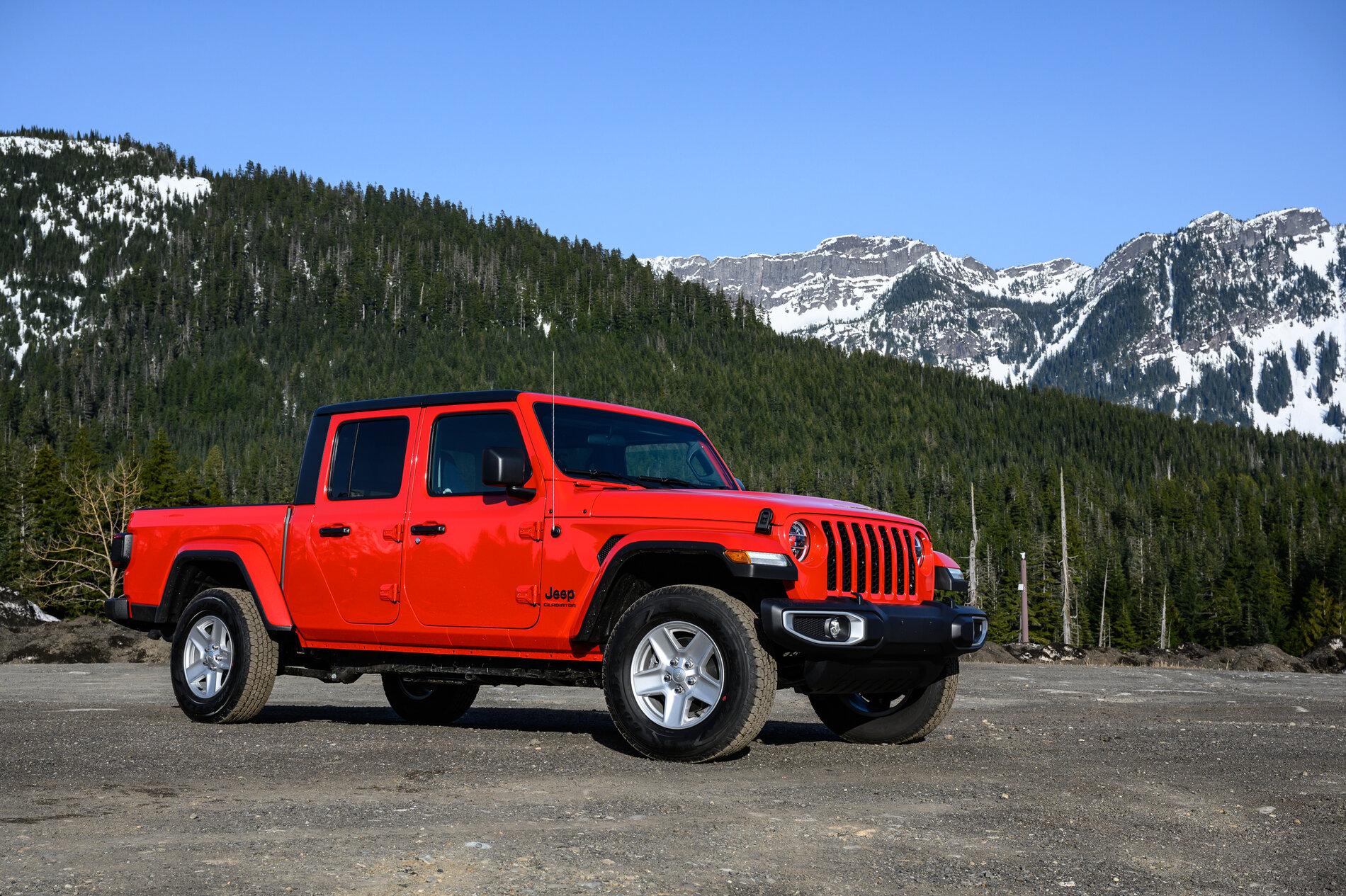

And I have officially ordered my Canopy Camper for my Ecodiesel Gladiator :)
Jeep Gladiator Alu-Cab Canopy Camper 20210406_Gladiator_Snoqualmie_Pass_Stock_19
