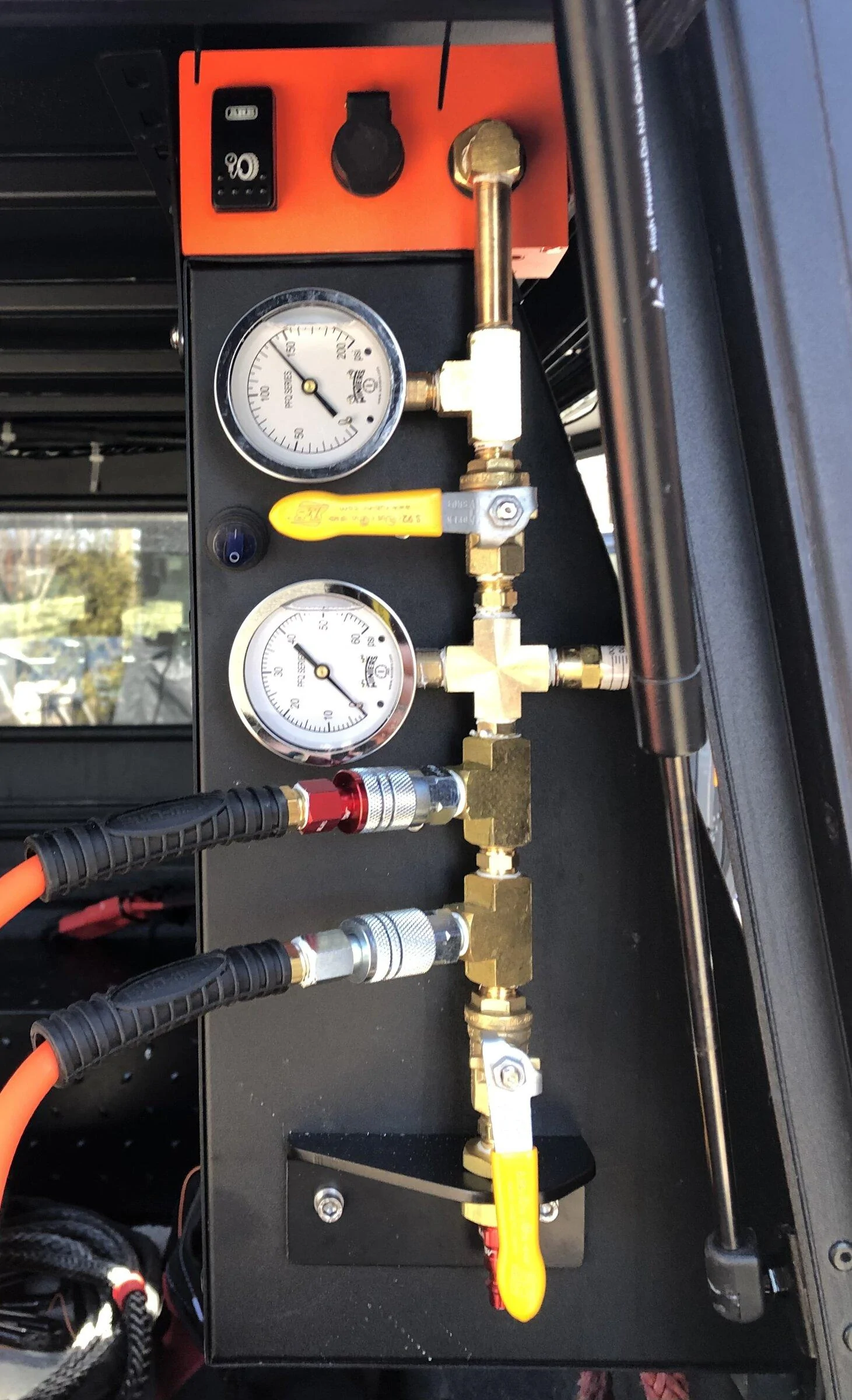

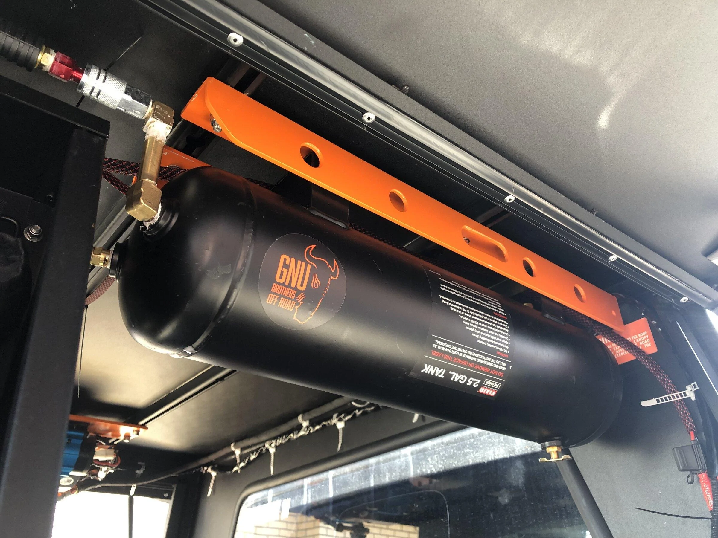

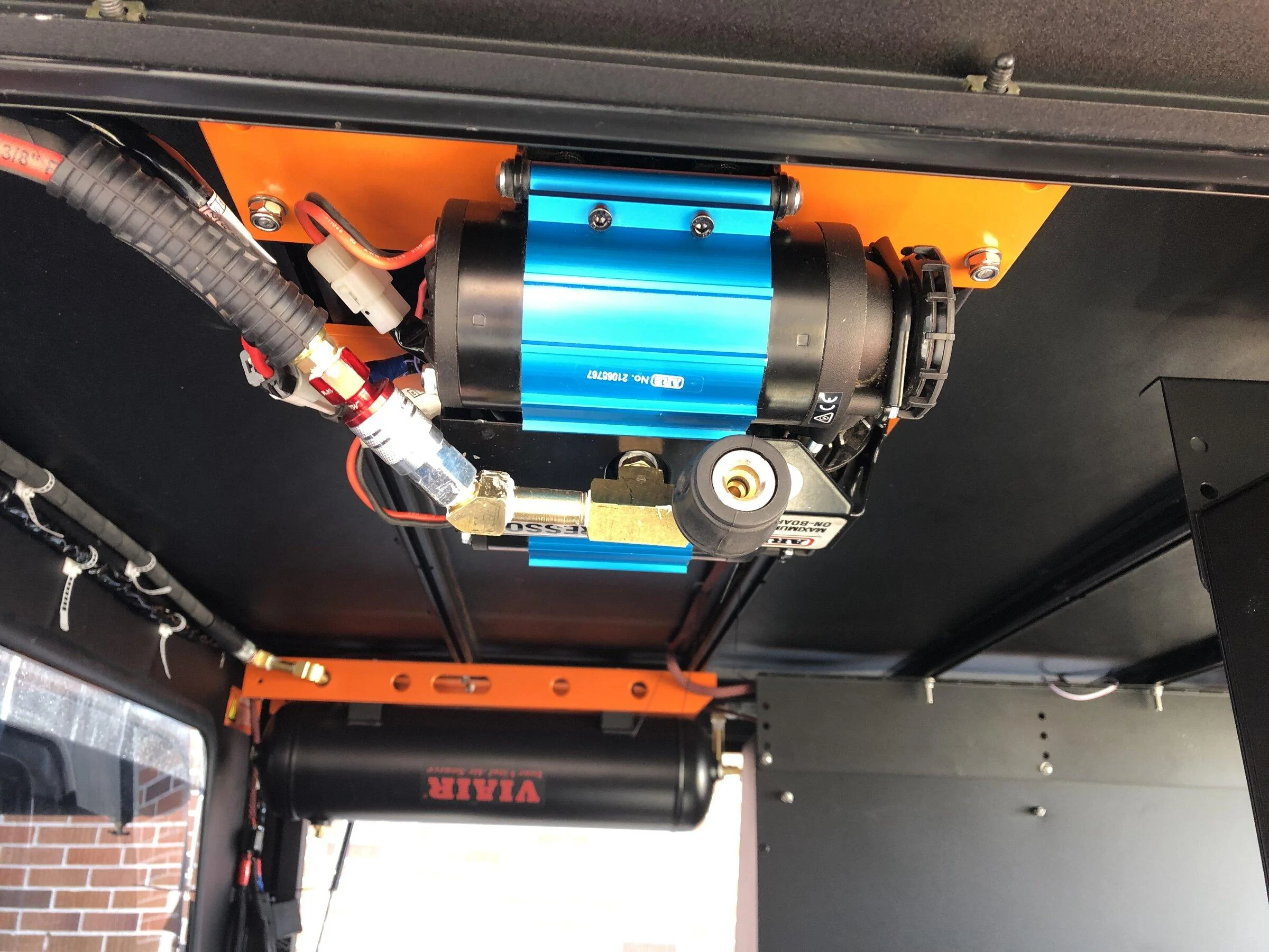

Mounted the ARB Twin and a 2.5gal air tank to the ceiling, and set up a pneumatic stack on the back wall of the port side cupboard. It's powered by an aux battery in the bed, charged by a 20A DC-DC charger.
Jeep Gladiator Alu-Cab Gladiator Bed Cap IMG_6093
Jeep Gladiator Alu-Cab Gladiator Bed Cap IMG_6092
Jeep Gladiator Alu-Cab Gladiator Bed Cap IMG_6090
