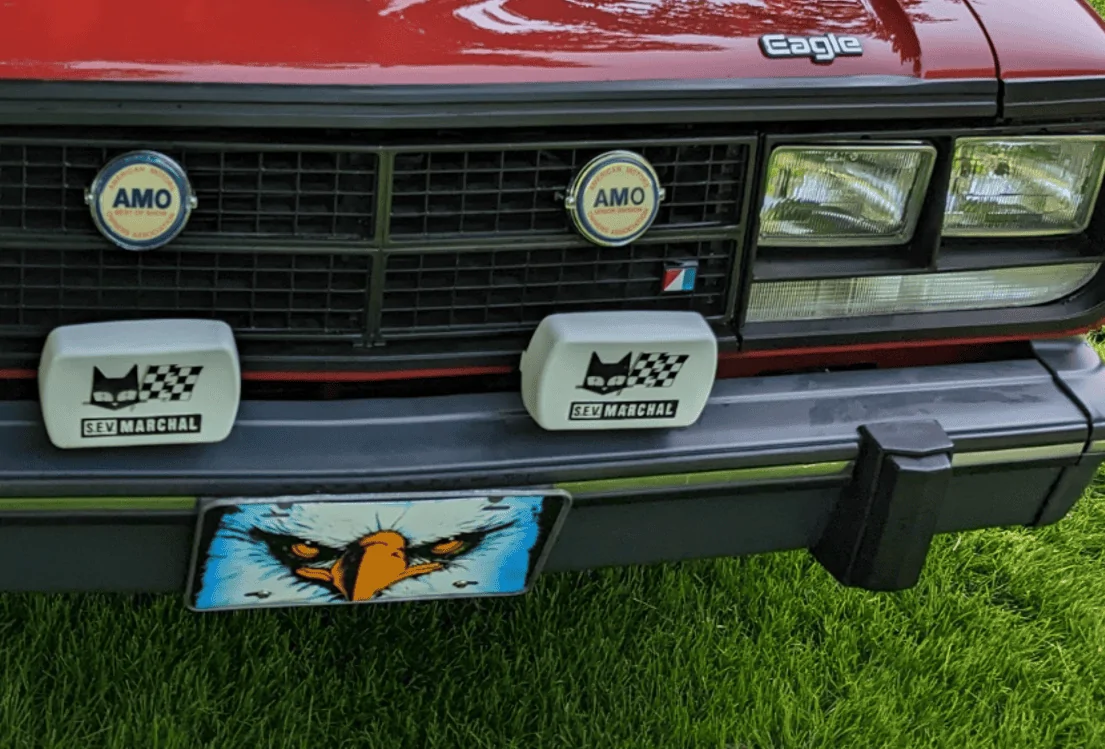

Example of painted aluminum -
front and rear bumpers of all Eagles and Concords, Spirit, etc. are aluminum - painted or non-painted, and they don't bubble - they are bolted to steel brackets -
