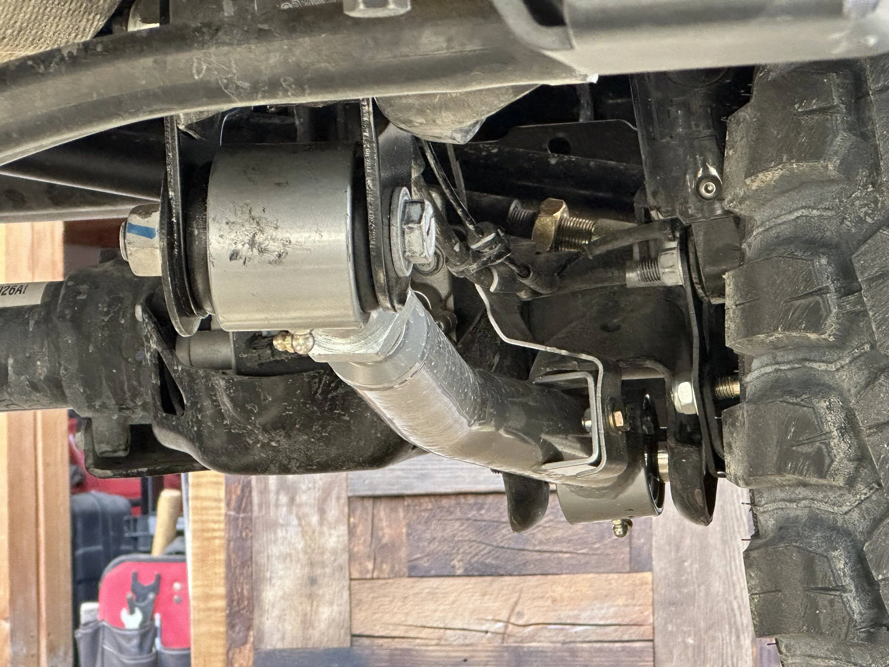

The jam nut on the control arm rod end is also up against the rod end instead of the arm...

I’m not the guy who is looking over anyone’s shoulder. I was a contractor for about 30 years all together and I think it’s a better use of my time to pay good people to do good work. But it is also a good practice to double check any work that may put you, your family or someone else’s safety at risk. So while I was installing my power steps I gave a double check of my undercarriage because I just had a lift installed and the alignment done and I noticed a few things. First picture what little things can you notice that are not quite right?
Jam Nuts are not correct tightened ?

Are those alignment brackets on there along with the adjustable LCA's? Why would you do that ?
the mechanic insisted I order them as he couldn’t make it work without them. You can see the first attempt with the “beat to shit” end of the lower control arm…

What you can’t see is that on the main body of the control arms there is another hole for a grease fitting to go and since it’s at a 90 there is room to get the grease gun nozzle on it no problem. So the fact that they were careless enough to end up on the bottom is just stupidity.
Bingo.
I'm also the sort to have at times drilled and tapped for fittings when the stock location was dumb.
Geometry correcting brackets (if that's what you are referring to) may not put the caster in the range desired. (depending on the lift).
Depends on the bracket (those that put the hole straight down from factory merely return caster to factory), and on other factors.
I can see doing it.

If that doesn’t work you can always just beat the shit out of it and use plenty of Licktite…
