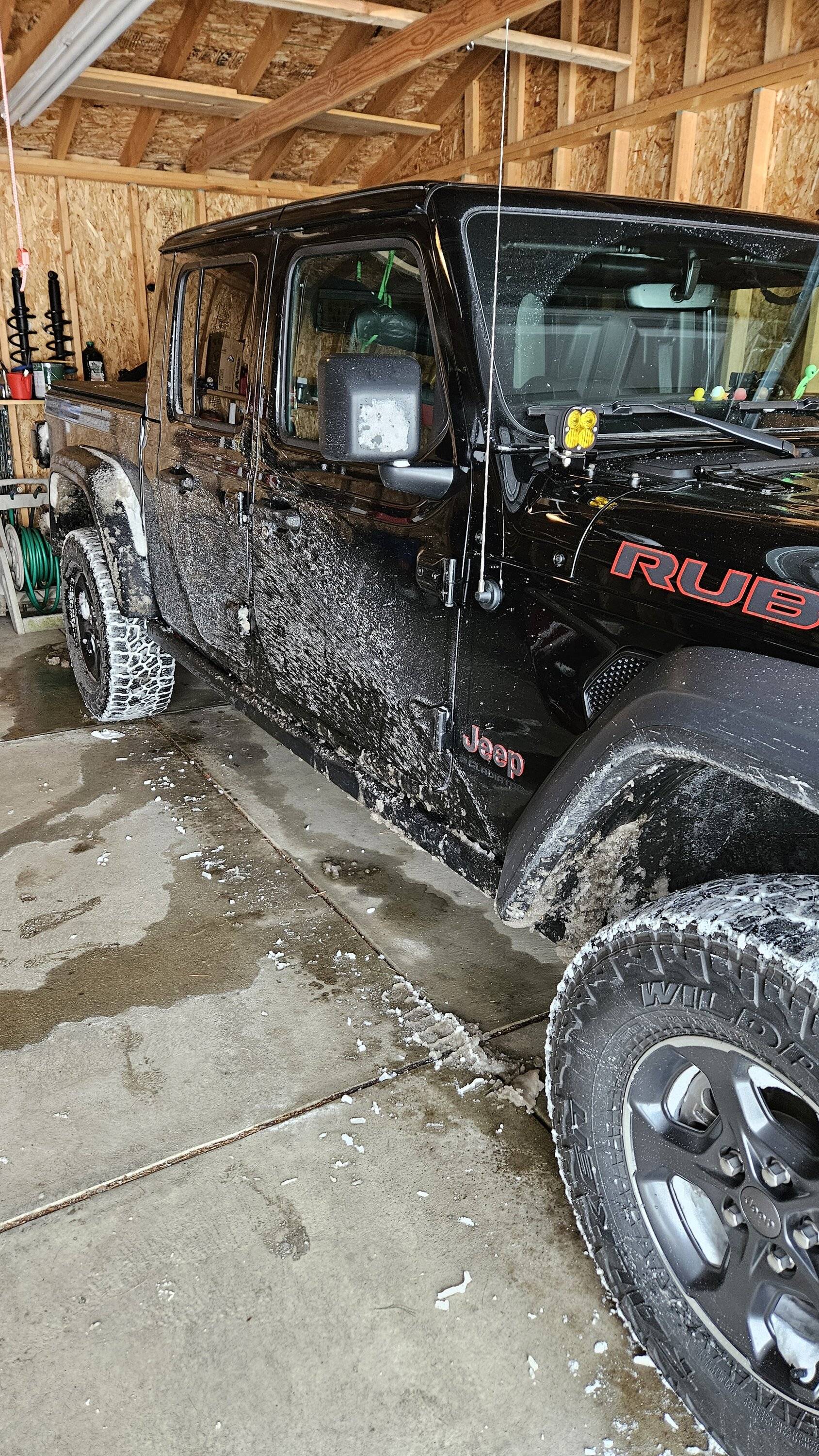

Well here's mine after yesterday's snow storm in Cleveland. Sheeesh, my overland never did this. The running boards blocked way more then I thought.

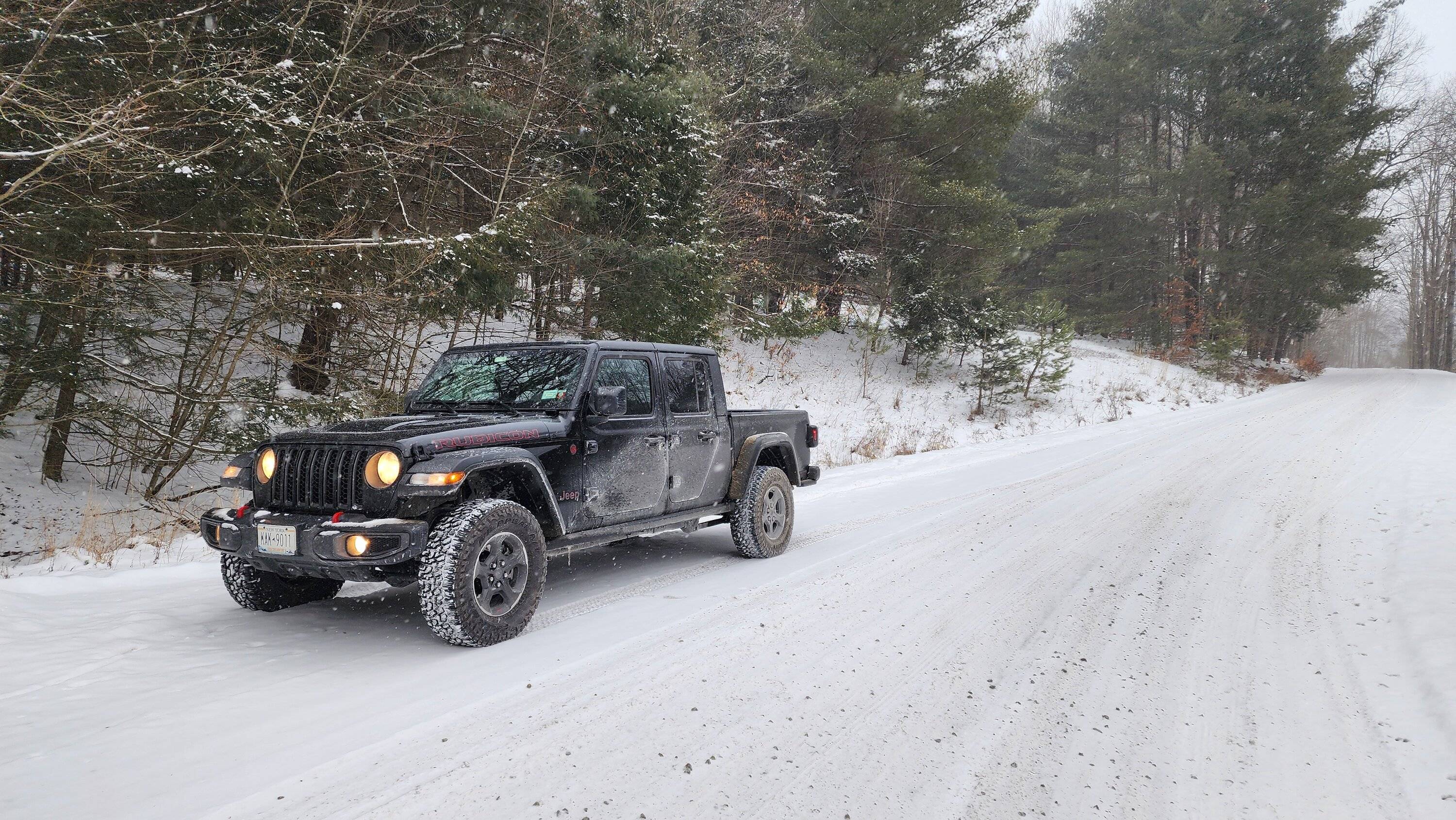

Today it was 9 degrees out and some awesome snow. I purposely went out and found a snowy back road, yanked her into 4 wheel and enjoyed some rural winter scenery.
Keep it in the garage and it will last a bit longer but you'll miss out on all the fun in the snow. These things thrive in the winter snow and you're missing out big time!
