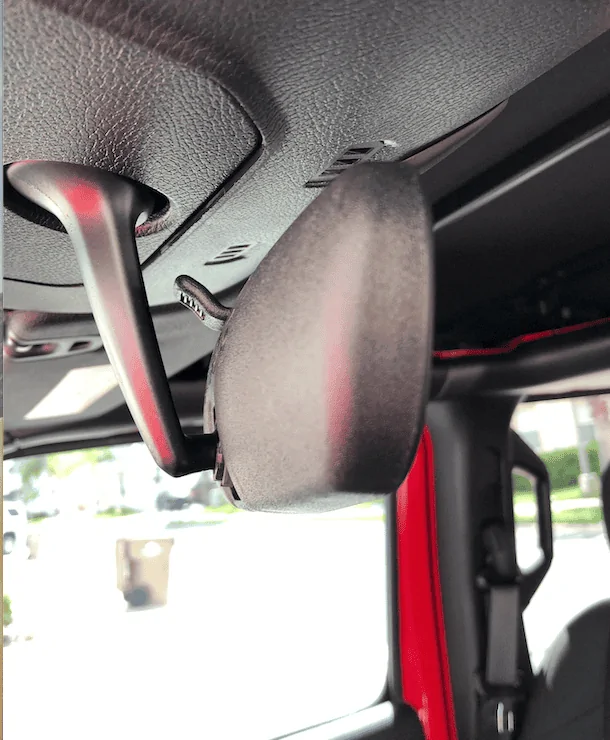

I am 6'2" but pretty long torso. - the only modification I have had to deal with over the years is in relation to mirrors.
1. The side mirrors do not seem to go 'high' enough. But they are not worth the mod.
2. The review mirror is a different story. The JL and now the JT have a very long stem (more than needed). The good news is that you can flip the mirror upside down and gain back about 1.5" in visibility. It actually makes a big difference.
You can see by the photo (from the back) how much it moves the mirror up...

+1 mirror flip ,seat tilt, and if you have the cash replace the seat and move it back but mind the center of gravity, length of ownership, age and health. Comfort matters, but driving a Jeep will always make you smile...

Wow, clever!!
