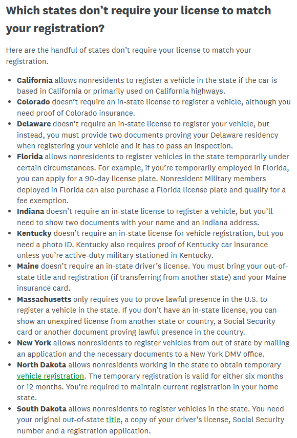

Not sure if this is the route you want to go but, here is a list of states that allow nonresidents to register their vehicles. I am not sure how this affects your car insurance, but it may be a legal work around. DISCLAIMER: I am not a lawyer, just an ordinary jeep gladiator owner trying to enjoy my jeep without the government telling me how to enjoy my jeep. Good Luck!
Massachusetts and South Dakota seem to be the best options.

Register in Montana?
You CAN. But as the post below said:
Then you have residency, insurance, and other issues.
Residency is cured via a UPS mailbox, but you didn't hear that from me. Same for insurance, they don't actually check the address you give them, as long as it can receive mail. "Other issues" refer to corrupt/uneducated police/courts, local laws, and some DMVs that refuse to comply or educate themselves.
In NY if you wanted to swap a less-than-25-year-old vehicle, you had to get the DMV to reregister the VIN as the vehicle the powertrain came out of so when you get an inspection it matches the ECM parameters for emissions. Kinda what CARB is doing, just not as much of a Nazi about it in NY.
This is wrong, NY ABSOLUTELY requires you to register your vehicle, obtain NY insurance, and a DL within 30 days of moving to NY. They WILL profile you for this, and so will California. I worked with a guy in AZ who drove to CA and back every day for work, and he got stopped almost every day before he quit his job there and vowed never to drive into CA again.
While this IS legal under he 14th amendment (right to travel) and Harvard and NHTSA both got a bill passed during 21-22 era, states generally do not recognize this and when you get pulled over will call you a "sovereign citizen" for exercising this right.
This is also why "snowbirds" generally don't get hassled.
