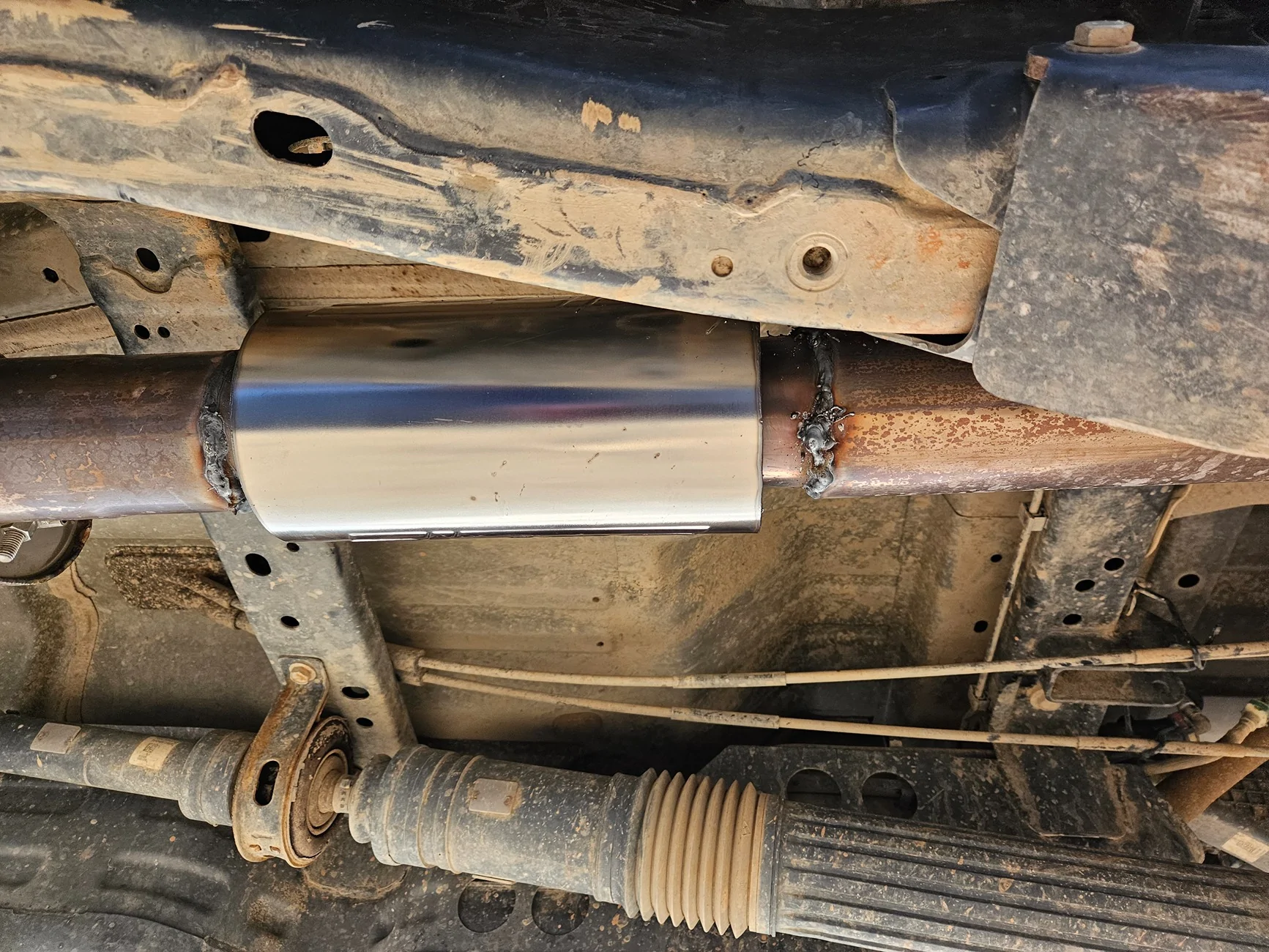

If y'all do go with this conversion, the exhaust is 3.5," not 3." It sounds awesome but is definitely over the top in my opinion. I ordered a Borla universal resonator (told and ordered wrong 3" size but they made it work) and now it is absolutely perfect. Still sounds bad ass, especially when getting on it, took out the drone and doesn't sound like an explosion when I start it in the morning. $125 on Amazon and well worth it.
Jeep Gladiator AMW 425 5.7L HEMI installed by Rubitrux 20251018_091354
