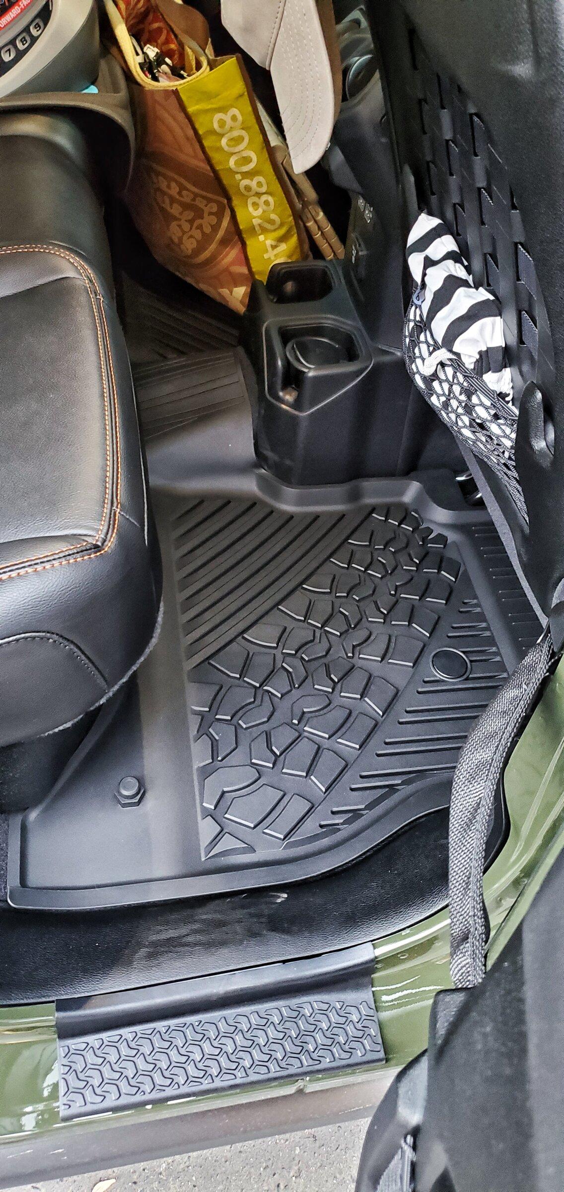

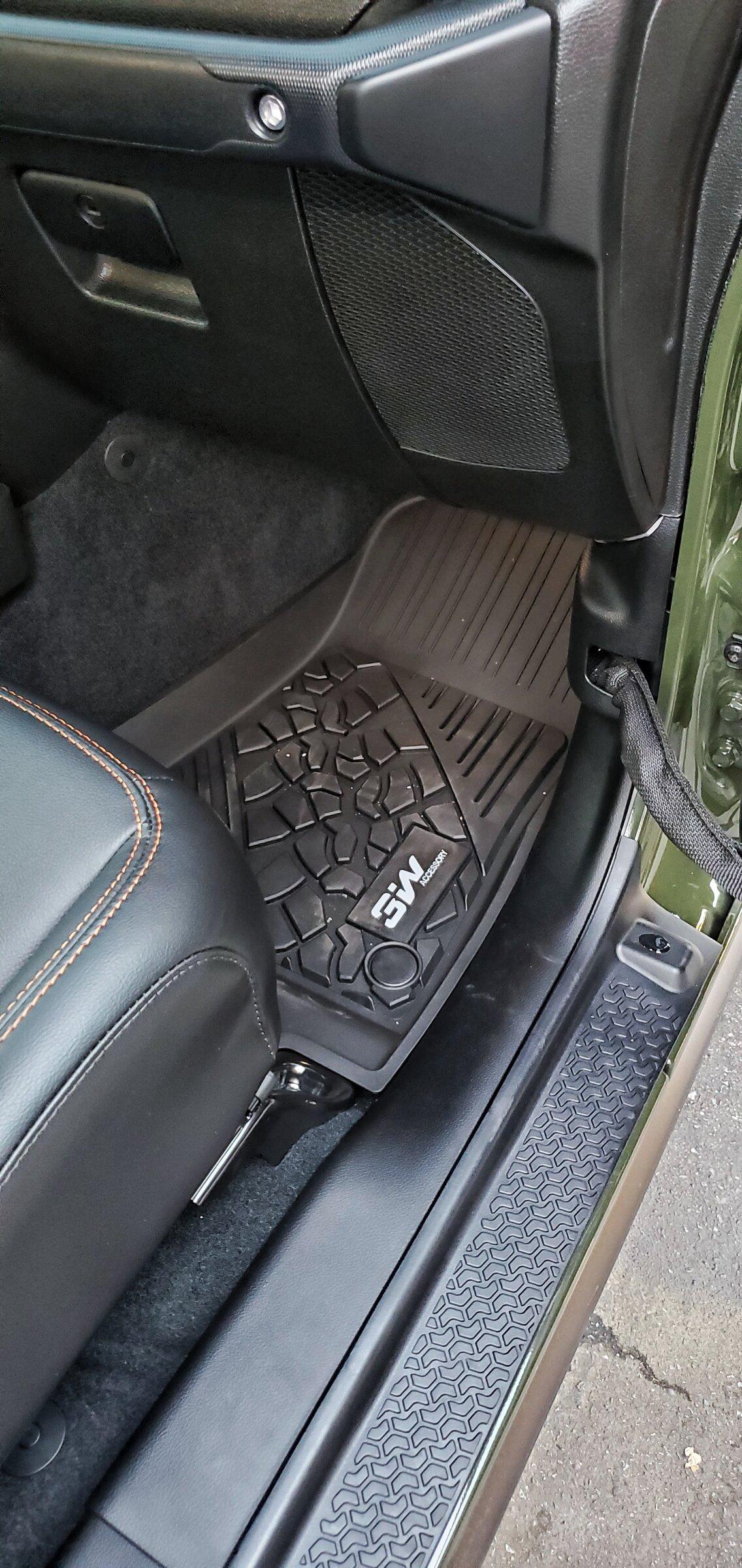

3W all weather floor mats came in. The fronts fit the contours very well. On the rear, the transmission hump coverage could be a bit better but overall I'm happy with them. Seem durable and have decent grip to them.

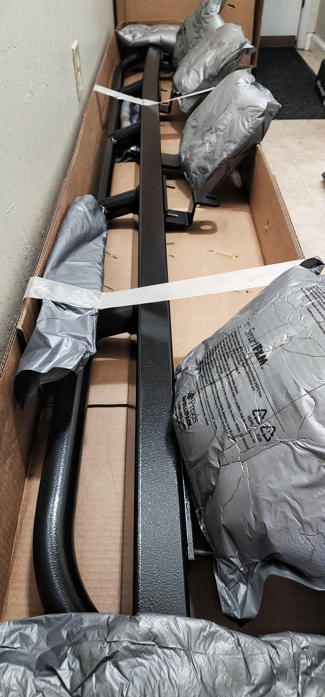

Rock Hard Angle Down Sliders came in this week. The look extremely well built and stout, exactly what I was looking for in a slider. Hoping to put these on this weekend.

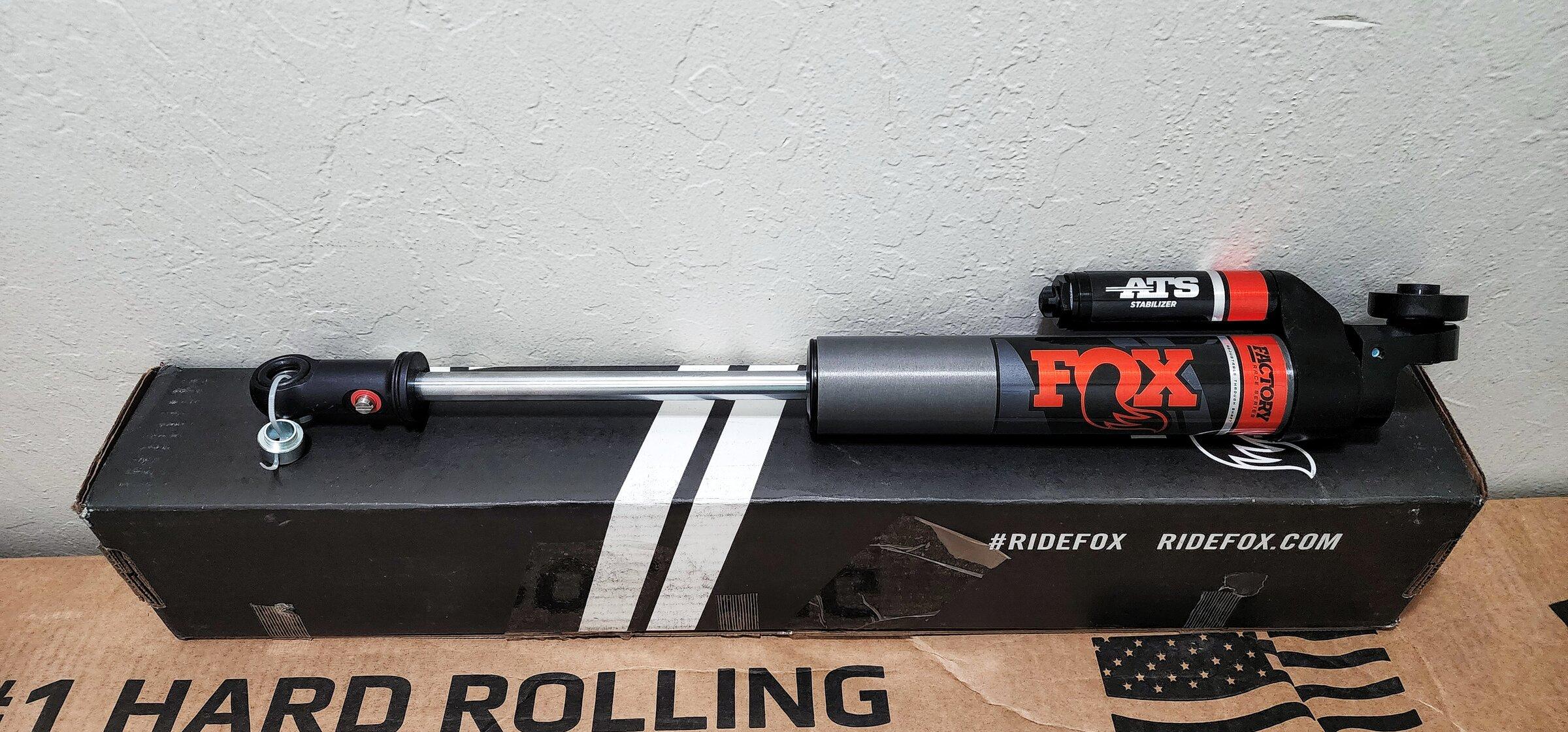

I kept going back and forth on it, but I also caved and bought the Fox 2.0 ATS Stabilizer (983-02-148). Although I don't really have any steering issues, others who have installed them seem pleased and I like the idea of adjusting it exactly to how I want it to feel. Went with Fox over Falcon mainly because they match the Fox shocks already on the vehicle. It is also more adjustable, but I think 3-5 points of adjustability is more than enough (the Fox has 23 I think?).
Also, since my vehicle is a 2021+, it requires purchasing the older 2020 bolt for the Stabilizer (the one on my vehicle won't fit). In case anyone is wondering, this bolt is the OEM Part Number - 6510774AA. I ended up purchasing it at the dealer but they didn't have any in stock and made me order a set of 5. If anyone else needs one after I get this installed, send me a message!

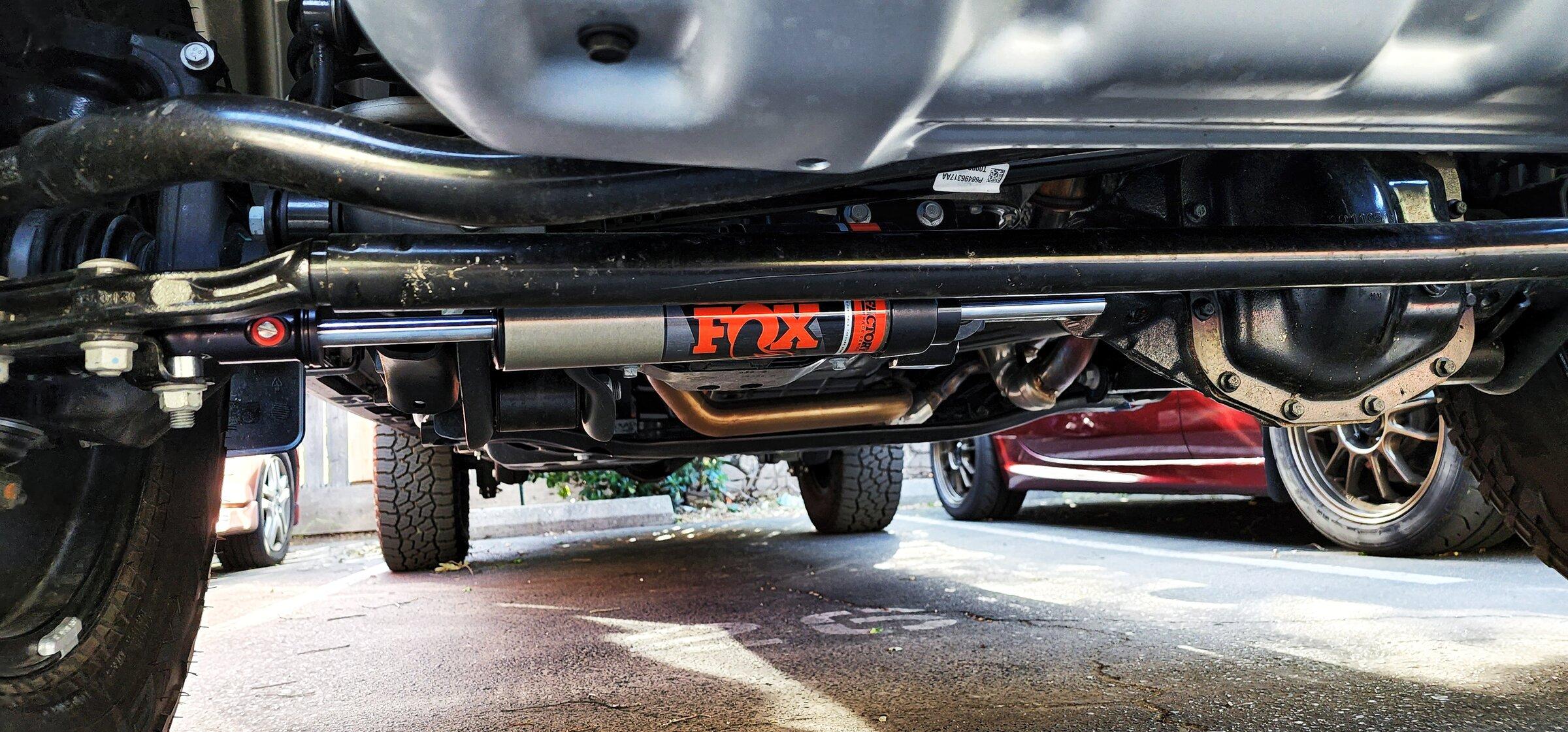

Put in the steering stabilizer today.
Jeep Gladiator Andrew's 2022 Sarge Green Mojave - Northern CA 20220409_170314-01
Overall, pretty happy with it. In retrospect, I'm running the adjustable one close enough to center (9 from stiffest) that I'd probably be just as happy with the cheaper non-adjustable one. I guess if I change tires or add a lift in the future I can see myself re-adjusting it.
For me, I was expecting a larger difference from fully soft and fully stiff. The bigger difference (which is the reason that its worth it to me) was how much it reduced the center play in the steering wheel while driving. Mine wasn't bad before (felt better than all the ones I test drove before purchasing) but it did make a noticeable difference to where minor adjustments in the ~ -5 to +5 degree range on the steering wheel feel more immediate.
Also, when I say play, it's hard to describe. I don't really want to call it a dead spot because it isn't. With everything stock, if you make a minor adjustment, even small, the vehicle will slowly slightly drift towards that direction. It's so minor though that I think many people think it's a dead spot when it isn't. What the stabilizer seemed to do for me was reduced that "play" area so that those minute changes are felt more immediately/significantly.

Got my Rock Hard sliders on today. Pretty happy with them. Planning to add grip tape to the top to make them work better as steps. Excited to try them as sliders at some point.

Wow, those look great, looking forward to putting ours on. “Pretty happy.” Is there something you were on the fence about? How did the body bolts treat you?
Some minor nicks in the powdercoat when it arrived. Rock Hard worked with me and gave me a bit of a discount because of it. I took their suggestion of using nail polish to repair and to be honest that worked surprisingly well for an option I already had lying around (my wife had some black nail polish already). Being that I expect to use them as rock sliders at some point I know I'll scratch up the powdercoat eventually anyways.
Regarding the body bolts, the drivers side was easy but the passenger side definitely gave me trouble. The hardest part for me was getting the bolt to actually come out. On some I had trouble getting them not to freespin when they were almost all the way out. Having one person pulling to create tension and the other wrenching seemed to work the best. Getting them to catch also proved troublesome. I ended up using an impact with pressure ONLY to get them initially to catch a few threads and then manually tightened from there.
