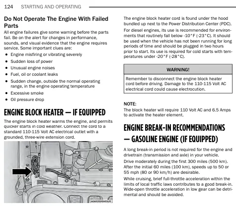

I don't believe I have an owner's manual with mine (2021 as well), I've only had the digital one.
2021 Jeep Gladiator Owner's Manual
And that ^^^ isn't on those pages.

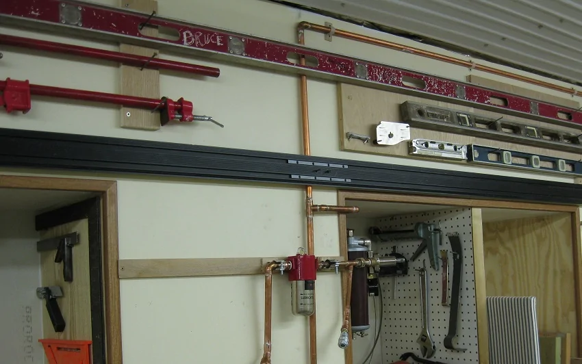

One of the first things I did in mine was run air lines with multiple drops on three walls in the car shop area and two upstairs in the wood shop.
He has similar and multiple reels with ⅜ & ½ line it so freaking nice.

Yeah, two hose reels as well as the quick couplers in all of the other drops.

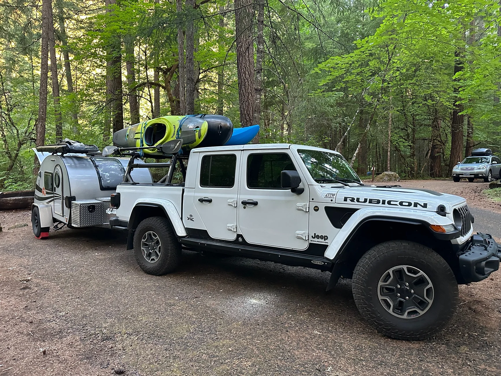

Nope, babied it as per break-in instructions and after that used it for its intended purpose. Like you, I am in California so always going to the mountains and with the grades rpms are going to go up. When I was sure this was occurring, I was on a 45 day trip up in Idaho, Montana, and Oregon towing my 1500 lbs teardrop. Once I leave California, I am towing at 70 mph. During this trip, can't tell you how many mountains I crossed, but definitely up and down many grades. I really feel that I was sold a broken vehicle. The follower was probably screwed up from day one. When my 2014 JK went bad a few years back, I heard the moment the rocker gave out and drove 500 miles home and did the repair. The cam had very little material removed. This cam, on my 2024 Gladiator, had tons of material removed in comparison, in my opinion 7900 miles worth. It was not throwing codes at this point, but was not many miles from the point where the cam lobe would have been worn and the valves would not have been opening and closing as they should.
I'm amazed at how quickly it goes... Wonder if there's a database out there tracking earliest failures, just to get an idea of how many miles it takes to get to the center of the tootsie roll pop.

Since everyone else is just gonna ignore it - how long is that level???
That may be a floor beam 😂🧐🤭 dang I sorta missed what that was seen it didn't zoom in 🤦😂
