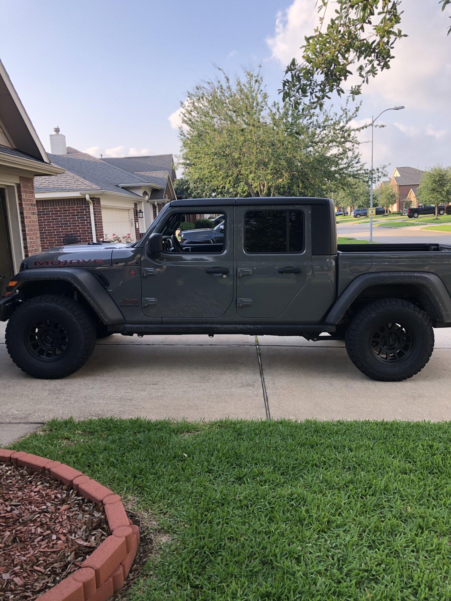

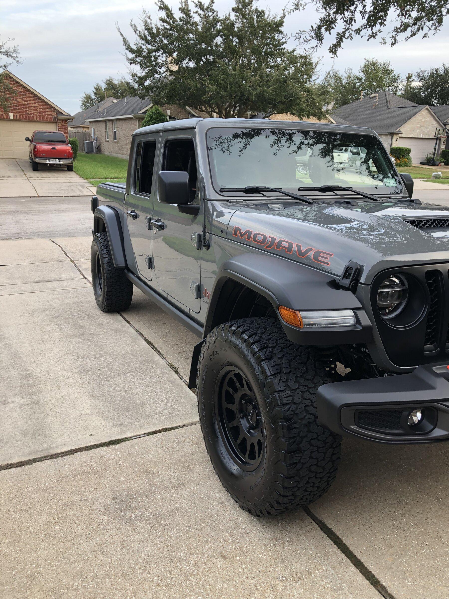

Toyfrog
James
Sep 4, 2020
603
697
Houston
2021 Mojave
Here is a 35x12.5x17 on a stock height Mojave. Wheels are 17x8.5, no rubbing issues. Wheels are zero offset so they stick out a tad more than a stock would, but you should be fine.
