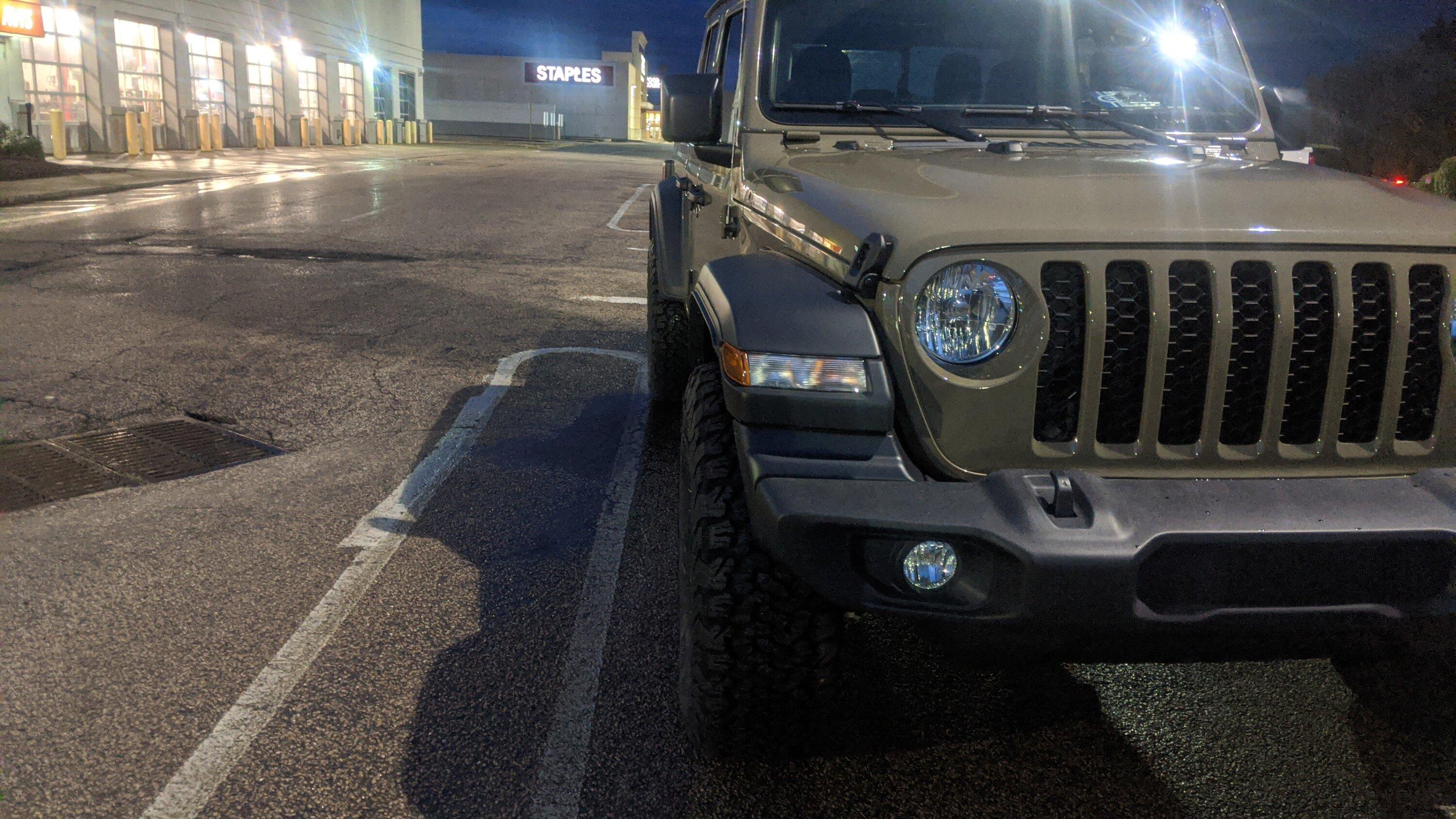

Roughly what it's going to look like poke wise to give you a idea
Without spacers on 35's no lift
Jeep Gladiator Rubbing on 35’s and stock wheels- Spacers? MVIMG_20200213_182816
With 1.75 inch wheels spacers 2.5inch lift
Jeep Gladiator Rubbing on 35’s and stock wheels- Spacers? 00000IMG_00000_BURST20200619193653437_COVER

When I went to 0 offset, I lost some highway mpgs too. Now I get worse mpg on the highway than in the city
Yeah these things are all over the place with how the MPGs can be affected. A slight change can make a significant difference.
I don’t mind the poke actually. Can always take them off if I hate it after a while.
As far as mpgs go, doesn’t bother me much. Difference between 16 and 17mpg is about $2.60 per fill up for me.
Yeah I'm fan of the poke as well. Just throwing out some data, but yeah I'm the same way, if I like how it rides and drives, I'll pay for the gas.
