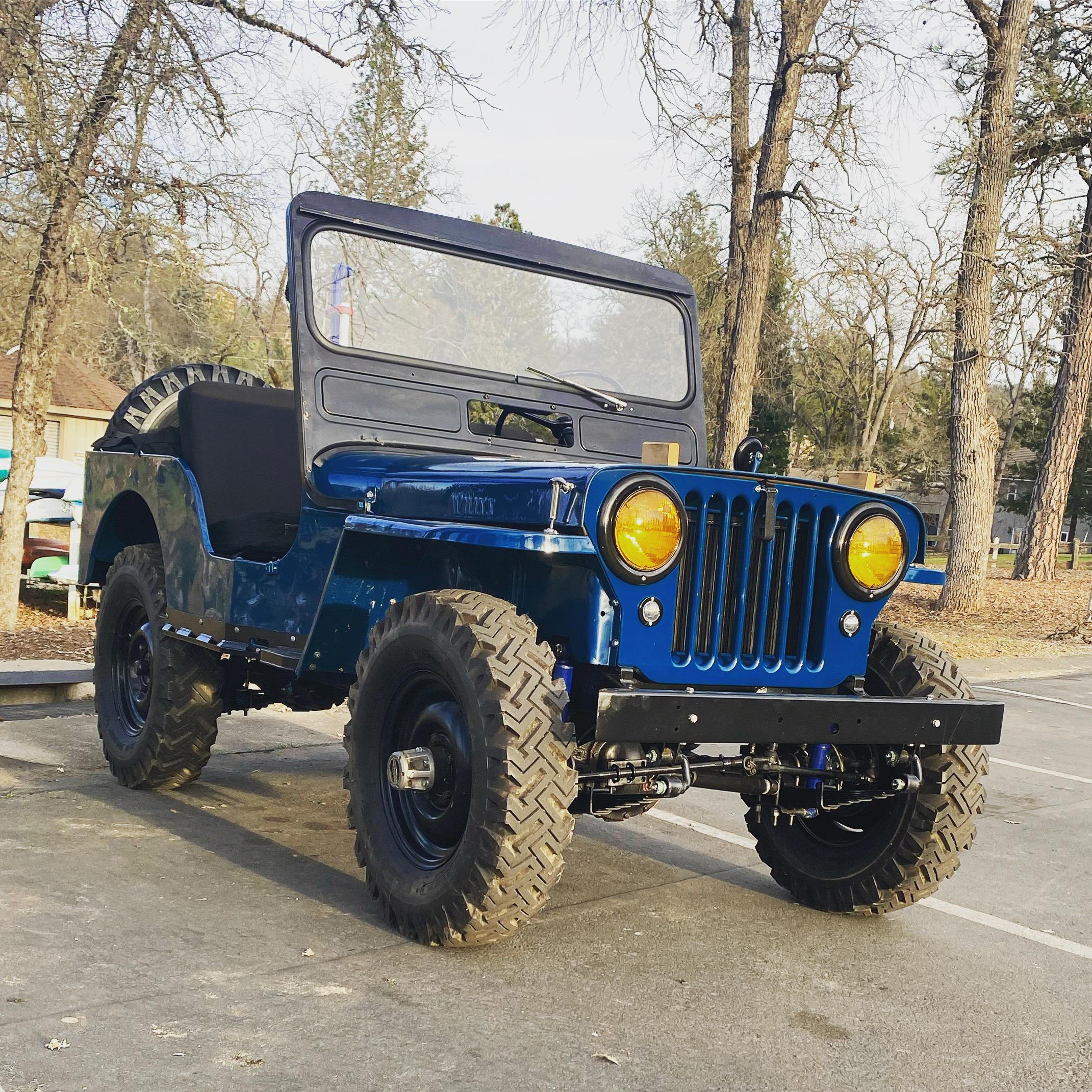

How about a 7.5" on a 4" tube rim without safety bead.
a 12.5 will work on a 7.5 just pinches the contact patch slightly so requires less tire pressure to get a flat patch.
I ran 35x12.5r17's on my sport s max tow for 40k no issues. Also aired down to 5 psi when stuck in the sand and didnt lose a bead.
Jeep Gladiator Stock wheels and 35’s C1CA51FF-B127-461F-9ED7-D20E7F6CCF24.JPG
That's a beautiful 2A. Did you restore it yourself?
Yes its a 20 footer. Did everything myself but the tub was actually painted by the previous owner (was sitting on the ground outside).

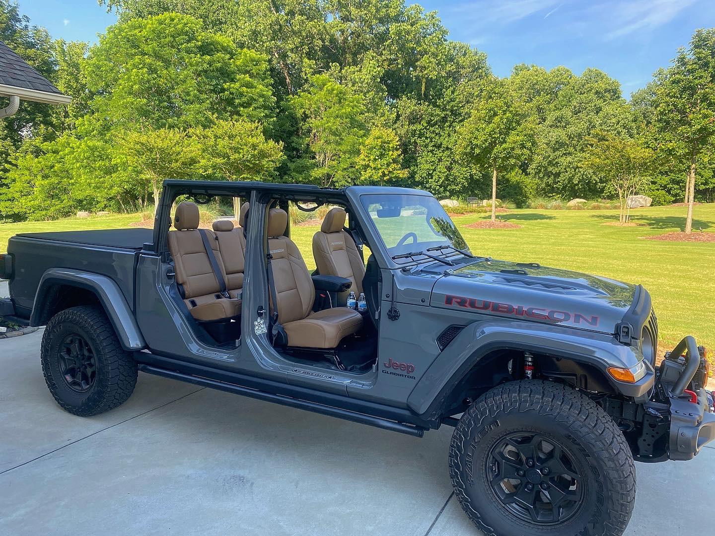

Here is a set of 35x12.5R17 Falken WildPeak A/T’s mounted on a set of OEM LE wheels that are only 7.5-inches wide. I wheeled them until I upgraded to 37’s and a set of 9.5-inch wide Black Rhino Rapid wheels. I liked the extra protection on a smaller rim. Would have liked an 8.5-inch wheel. Happy with what I have now, but they were my third choice. Only ones I could find in stock….
Jeep Gladiator Stock wheels and 35’s 7FACA527-7EC7-4754-8B5B-6DB033B43FC2
