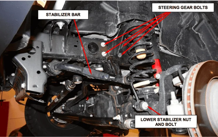

The first thing would be to check torque on the track bar, and also the steering box bolts. The bolts came loose on my aluminum box at about 5,000 miles. If those are both ok, I think if you added a good adjustable track bar and centered the axle, things would be better.
When you speak of the steering box bolts are you referring to the four on the top of the steering box?
Should be these four
Got these bolts torqued down. It made a ginormous difference. Now I’m down to just a tiny bit of wobble between 47-52 mph. No where near the death wobble as before. Thanks for such a descriptive picture!
