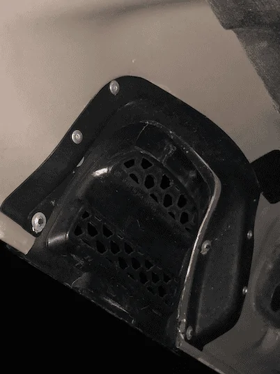

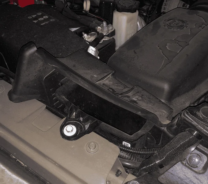

@NJMAXX Sorry 5:45am here so these pictures are not great but I am hoping they help. The hood cutout has a hard plastic flange for lack of better words on the inside. You will then see the air intake portion of the kit that is mounted to the inside of the passenger fender well. The hood cut out also comes with a cover (not shown in the picture) so if you are worried about rain/water you can cover the intake hole. If/when you do this it would obviously be like not cutting the hole in your hood at all.
As for performance. IMO I did not gain nor lose any performance by installing this CAI kit. That means nothing for you as my setup is most likely completely different and the beauty of owning these damn things. My Rubi is a 6-speed manual, I am running heavy 37" rubber on 18" wheels, I have gone from 4:10 to 4:88 gears, I have installed the Mopar performance exhaust and I could go on and on. Back to my point....I do not think I see any performance difference with this installed. Power feels about the same (could be me being hopeful but I may have felt a little gain in low gear, high RPM ranges), gas mileage still sucks (I avg around 14.5mpg). I like how it looks as I have not seen another one in my area and coupled with the performance exhaust I like how it sounds.
More than happy to crank up a quick facetime/video call and let you see/hear it if that will help. Shoot me a PM and I will send you my number.
