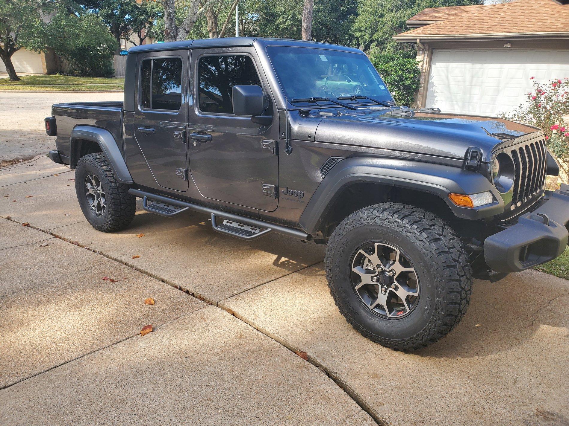

I have a base Sport with Max Tow package and just got the JKS 3.5” lift installed the other day. Purchased the Fox shock option and the JKS j-flex arms. Rides great and sits really nice. Had the shop throw on some 315/70-17 General Grabber ATX tires with it and I couldn’t be happier all around.
That looks awesome, I am looking at the same kit and debating between the LCAs or the relocation brackets. I am running 315/70 with a 1.5 level right now, got any shots from the side? I would like to see how they look in the wheel well.
I think the control arms are a good option if you have the extra bit of cash to spend.
Attached a couple of shots from today. Seems to me that the gap is just right for around a 35” tire and plenty of flex space.
Looks awesome! And a little familiar....

Jeep Gladiator Sport Base
Very familiar indeed. Same step bars and even antennae. You won’t regret the JKS kit. I’ve loved it so far. Just as an FYI, I’m running the General Grabber ATX and really like how they’ve handled everything so far, just in case you haven’t settled on a tire yet.
