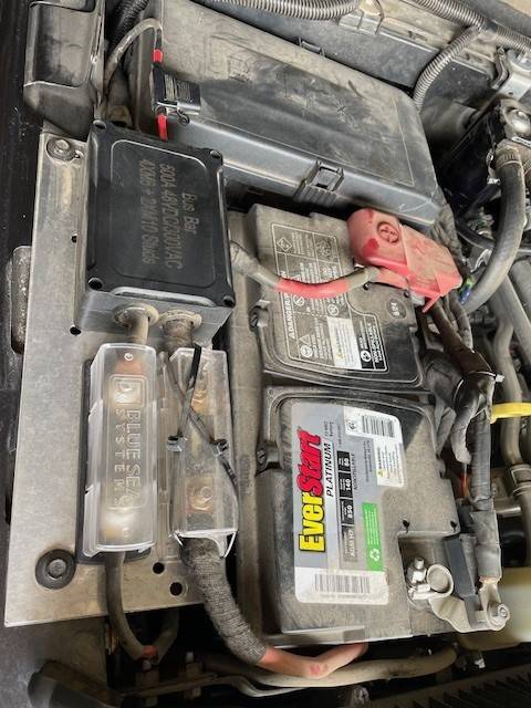

Not an ARB, but I mounted mine in the bed. No need to drill any holes, just put a hole through one of the rubber grommets at the front of the bed.
To simplify my accessories, I used a bus bar near the battery. From there, you can take power to the ARB, a winch, lights, GMRS, etc. I prefer to add an inline fuse for each right after the bus bar. The aluminum scrap I used for the mount looks a bit jenky, but it works.

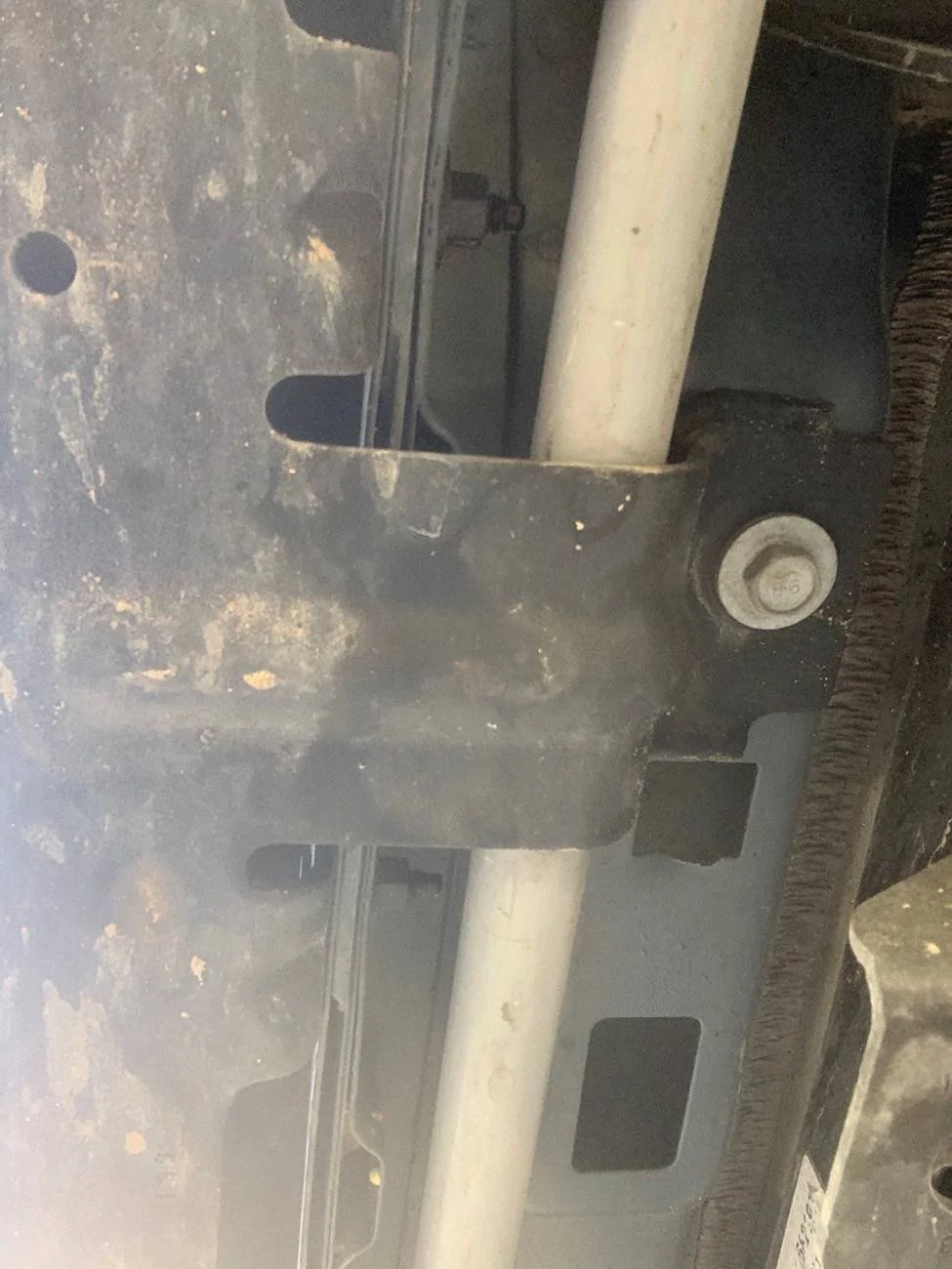

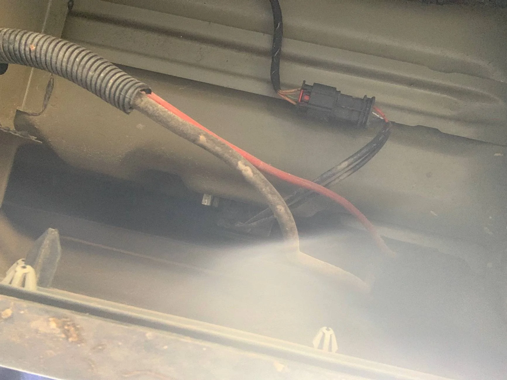

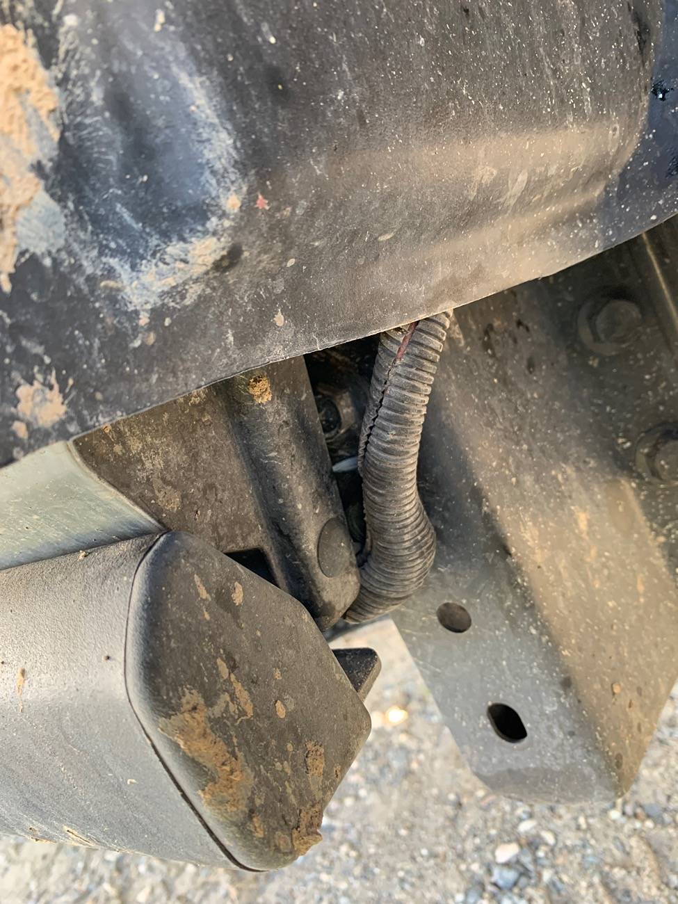

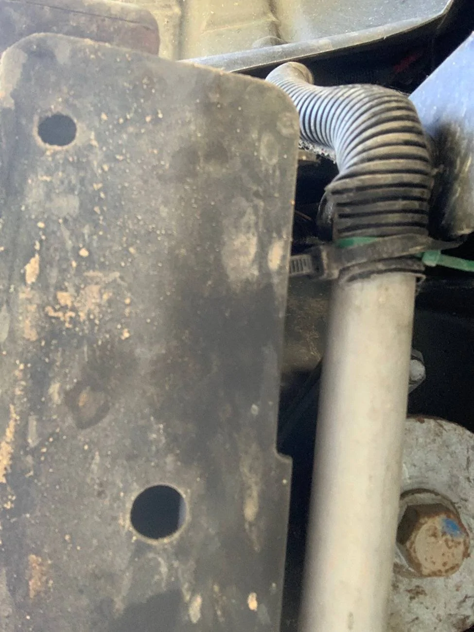

I ran my wires (fused positive) from the battery down behind the rt frt fender liner in flex wire wrap where it was exposed. Then into a solid plastic conduit tucked above the rock-rail brackets. Then up over inside the ft rear fender liner, again protected where it is exposed. From there, to the back right corner of the bed and through the hole near the tie-down. The plastic conduit is flexible enough to guide above the rock rail brackets. Tha most difficult part was fishing the wires over the rear fender liner. On my previous JT, I fished the wires through the rt frame rail, but that was a real chore. Why I went to conduit. If you have an aux switch bank, you could tie into the 40a circuit instead of directly to the battery, However, this will only have power when the ignition is on.
