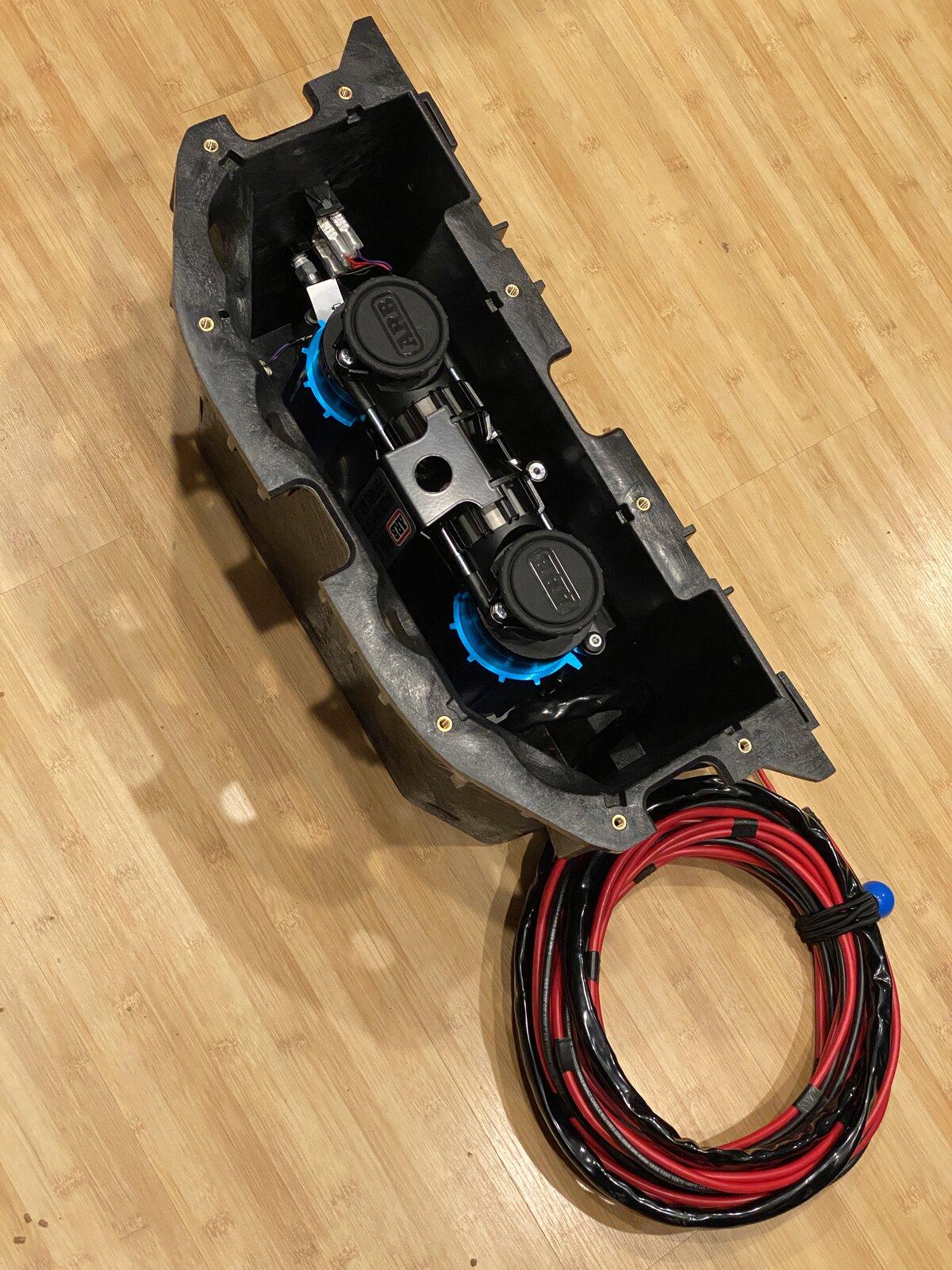

We have a few solutions. We offer a bolt-in aluminum enclosure for the bed that may be something that would work well for you. Plenty of ventilation, 15 rocker switch locations and 3 air coupler locations along with four 30mm holes for 12V accessories. Under the bed you would need a custom bracket, I don't know of one on the market yet but have seen a few mount them under. I think under the bed is going to be one of the most harsh areas to mount one. There are a couple solutions out there for under the rear seat. What we offer is the full Under Seat Storage Bin. The Full MOLLE version has plenty of ventilation and also have air coupler / rocker switch locations on each side of the Bin. Plus, the has seat brackets to secure the lower parts of the seat to the Bin. Our Behind the Seat mount is the most hidden/out of the way mount. It is best to drop the rear seat back when using it for good ventilation, but it works well and you can lock the rear seats. Our Under the Hood mount sits higher than the others on the market but all will be exposed to heat. The benefit of our mounts is that they are all aluminum and simple to install. The hardest part of any install using our mounts is the wiring of the compressor. Installing the compressor and mount only take 5-20 minutes for all that we offer.
Take a look and let me know what questions you might have.
https://www.813fabrication.com/prod...-enclosure-for-arb-single-or-twin-compressors
Very nice and I will be contact your team eventually. If I put this on the right side, would it use the plug in as the power source or would it be better to run a power line to my rocker switches inside the cab; save hassle of other flipping the switch on when I am in a packing lot somewhere.

The Bed Side Enclosure can be mounted on Driver or Passenger side. You would need to run +/- wires from the battery or Aux switch. I have my switch on the enclosure so I can flip it on and off when I use it vs going to the cab to turn it on and off. Plus I didn't want to use one of the Aux switches, I use them for other gear. You can mount the rocker switch on bottom or either side of the enclosure if you are worried about gear hitting it. An option, but you can also wire to the Aux switch if you want.

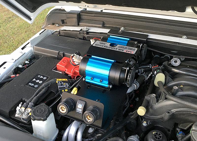

I am waiting on availability of body parts for the hybrid JL, when they are available I am going to get the driver side cowl piece for the plug in and modify it to accept the quick connect for hose and the rocker switch to run the pump. Will have to wire it up somehow so that the rocker switch is dead unless ignition is on.
Haven't decided on a tank, or where I will hide it.
At that point I will be getting the 813 under hood bracket and running a twin ARB.

I am also waiting to snag one of those. I was going to try and design a new backer plate to hold the switch and Air coupler
I don't have my JT yet but I've been reading everything and watching every YouTube video I can get a hold of. If you are able to figure out cowl placement I think it becomes my go-to choice for the coupler if it is a clean look. I like what I've seen from your products so I am sure it will be.

I think it will be fairly easy. Trim out the guts of cowl into a square opening, make backer piece with switch plate hole, possibly 2 quick connect holes, drill 4 holes, aluminum or plastic rivets.
I need to get a hold of one so I can see how much room there actually is, because it could be a good place for intake filters.... deeper box with flanges to mount to cowl piece.

If you talking about the plastic black box it is part of the Decked System he has in the bed. For under the hood, we have a mount that works under the hood for Twin or Single ARB compressors.

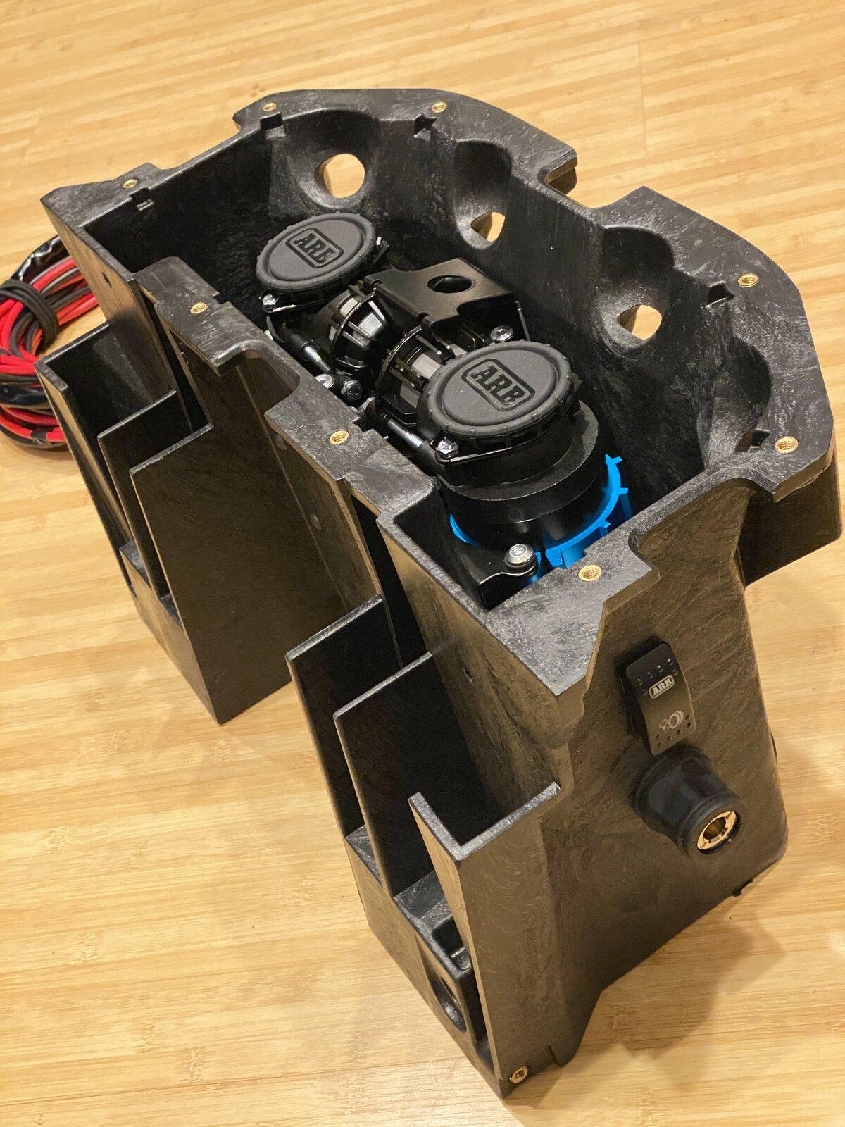

I have installed my twin behind the rear seat with the 813 kit.. Everything is wired up and working. So far so good. But now I am wanting to run a tank and need a place for the hose connection.
I don't want the hose connection under the hood. Same reason I didn't put the compressor there. Open to the elements, heat and having to open the hood every time I need to use it.
I am wanting the tank under the Jeep. Out of site out of mind. It will also dissapate the heat from the compressor to the connection and I can add a filter and separator if needed.
Anyone have any good setups like this and how they did it?
P.S. I tried a search to no avail! ;)
TIA
Jeep Gladiator ARB Twin Setups.. I need ideas!! option-1-d
I installed mine under my passenger seat, ran a splitter to the corners of the passenger seat and the driver seat for quick plug in and its awesome 4 tires up and down at the same time. Check the video on my youtube www.youtube.com › ExfilOffroad. The kit is sold on https://innovativeatproducts.com
