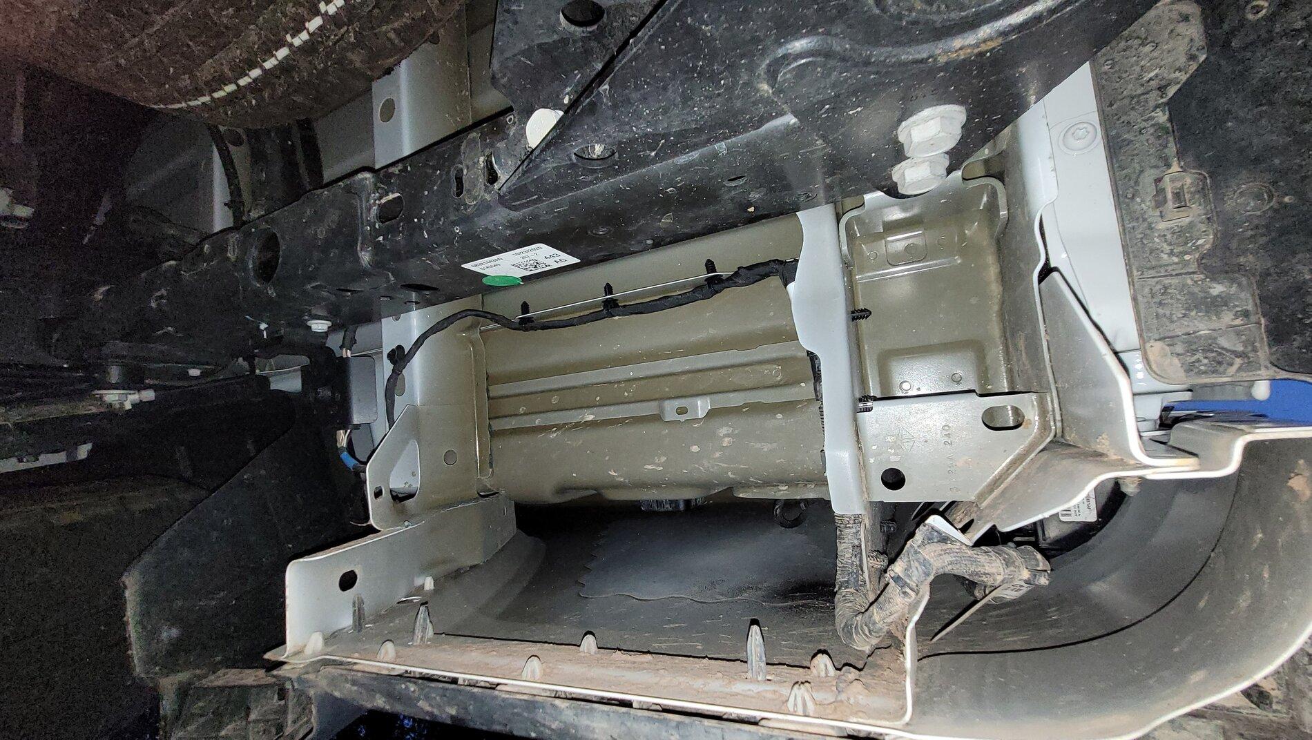

Has anybody looked at installing the compressor in the empty space between the right side of the bed and the outer fender, with the chuck installed next to/instead of where the 110v outlet is installed?

Jeep Gladiator ARB Twin Setups.. I need ideas!! 20211008_185205
In this spot.

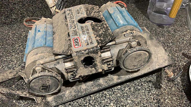

I'm sure a mount could be made to fit the area. I see several spots that could be used to bolt onto. But, I also see a good amount of mud in the area already. I would be very concerned that the area would get too much mud and water. For me, it's the same reason I don't design anything for behind the wheel well like some of the other mounts on the market. Here is a pic from a customer. His ARB twin was mounted behind the wheel well and died due to the elements. The front has inner fenders to block mud, the rear location does not. It would have helped if the filters were relocated. You would need to relocate them if mounted under the bed also.
Jeep Gladiator ARB Twin Setups.. I need ideas!! toast

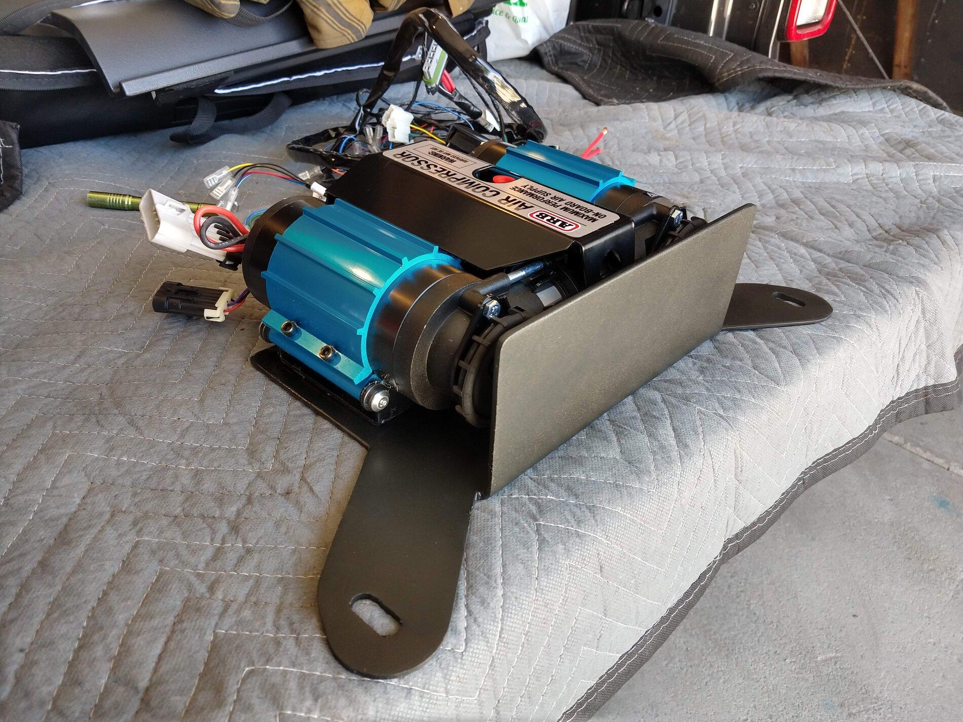

Jeep Gladiator ARB Twin Setups.. I need ideas!! IMG_20210516_125006511_HDR
I ended up making a simple mount a few months ago to place mine under the driver seat. I couldn't find anyone selling a mount to do this, probably because there is very little clearance. However, I am extremely happy with it and was able to retain all the storage space behind the rest seats which is pretty nice.

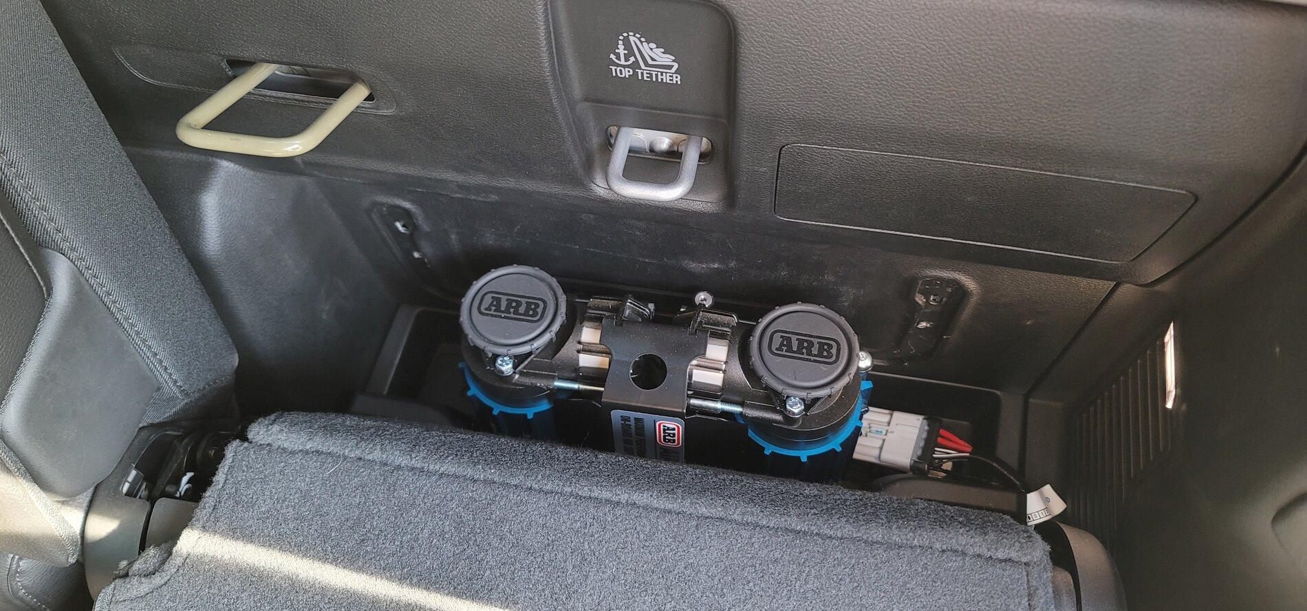

I have installed my twin behind the rear seat with the 813 kit.. Everything is wired up and working. So far so good. But now I am wanting to run a tank and need a place for the hose connection.
I don't want the hose connection under the hood. Same reason I didn't put the compressor there. Open to the elements, heat and having to open the hood every time I need to use it.
I am wanting the tank under the Jeep. Out of site out of mind. It will also dissapate the heat from the compressor to the connection and I can add a filter and separator if needed.
Anyone have any good setups like this and how they did it?
How is your bracket working out. i just picked up the same compressor and i am thinking of mounting it the same way. How hot does it get and have you had any problems with the mount? Thanks

That space is to the side of the spare between the right rear fender and the bed.
