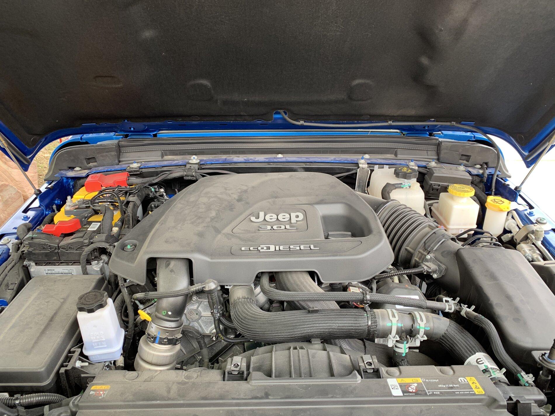

From what I seen... no but I have not seen under the hood without the engine deco cover.. still think now but I will try and post a pic later.. still feel shunned from the aftermarket retailers.. been 6 months and hardly nothing is available ..oh well..
edit to add photo
Sorry, the diesel is a completely different setup so it would not work. I'm not sure I could get one to work. By looking at the photo there is a lot going on in that area, I am not sure there would be enough clearance.

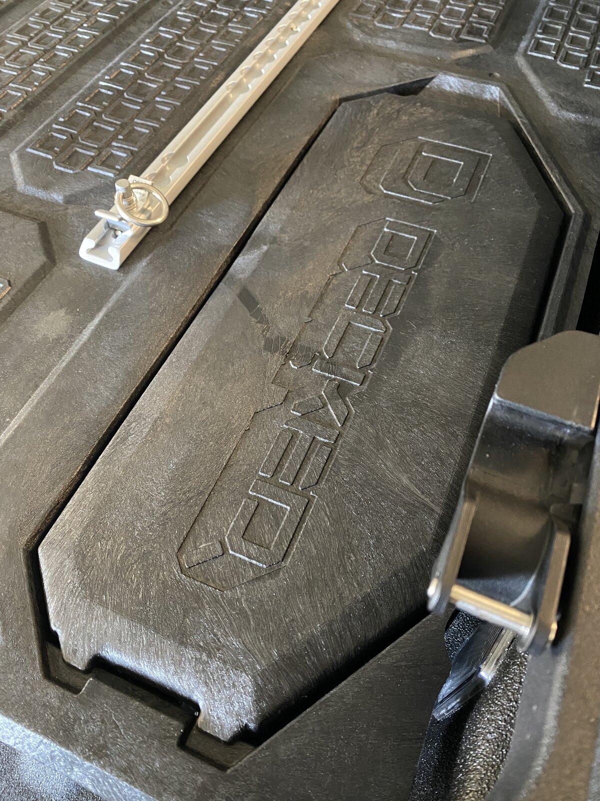

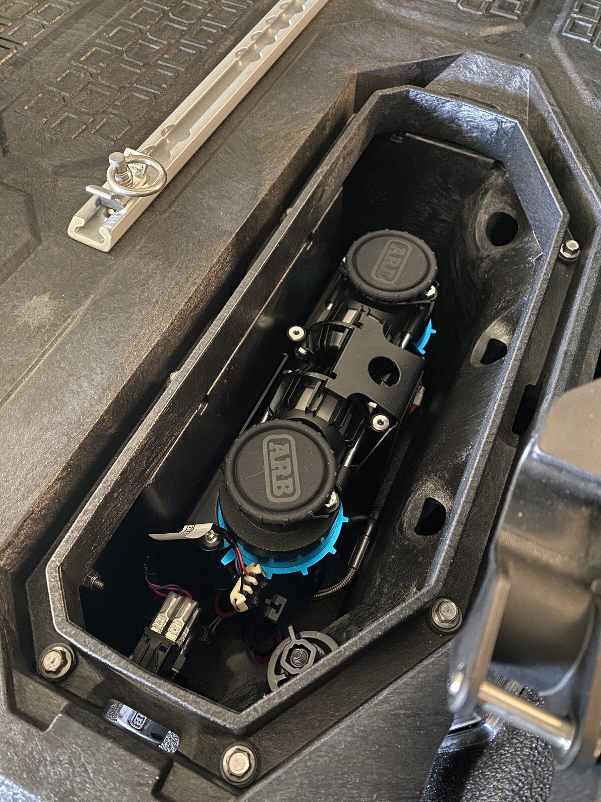

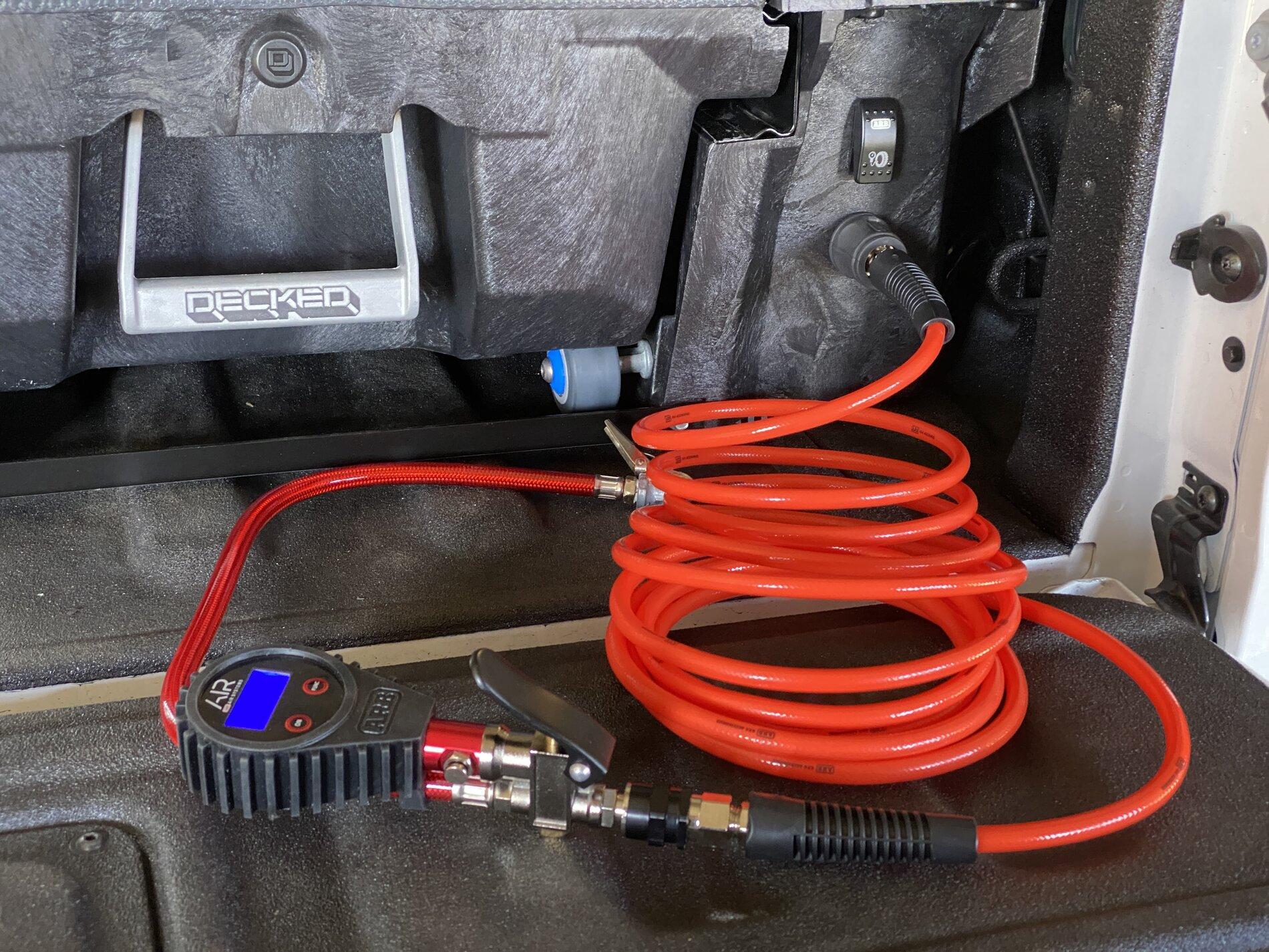

Can someone tell me what the container is he installed in the bed? He called it an ammo can( I think). What is it and where can you get it?
I like that idea or maybe use the bed bracket/box idea..since these won’t fit in the engine Bay Area (so far)..
Thanks
These are the Ammo Cans, well DECKED's version of an Ammo Can.

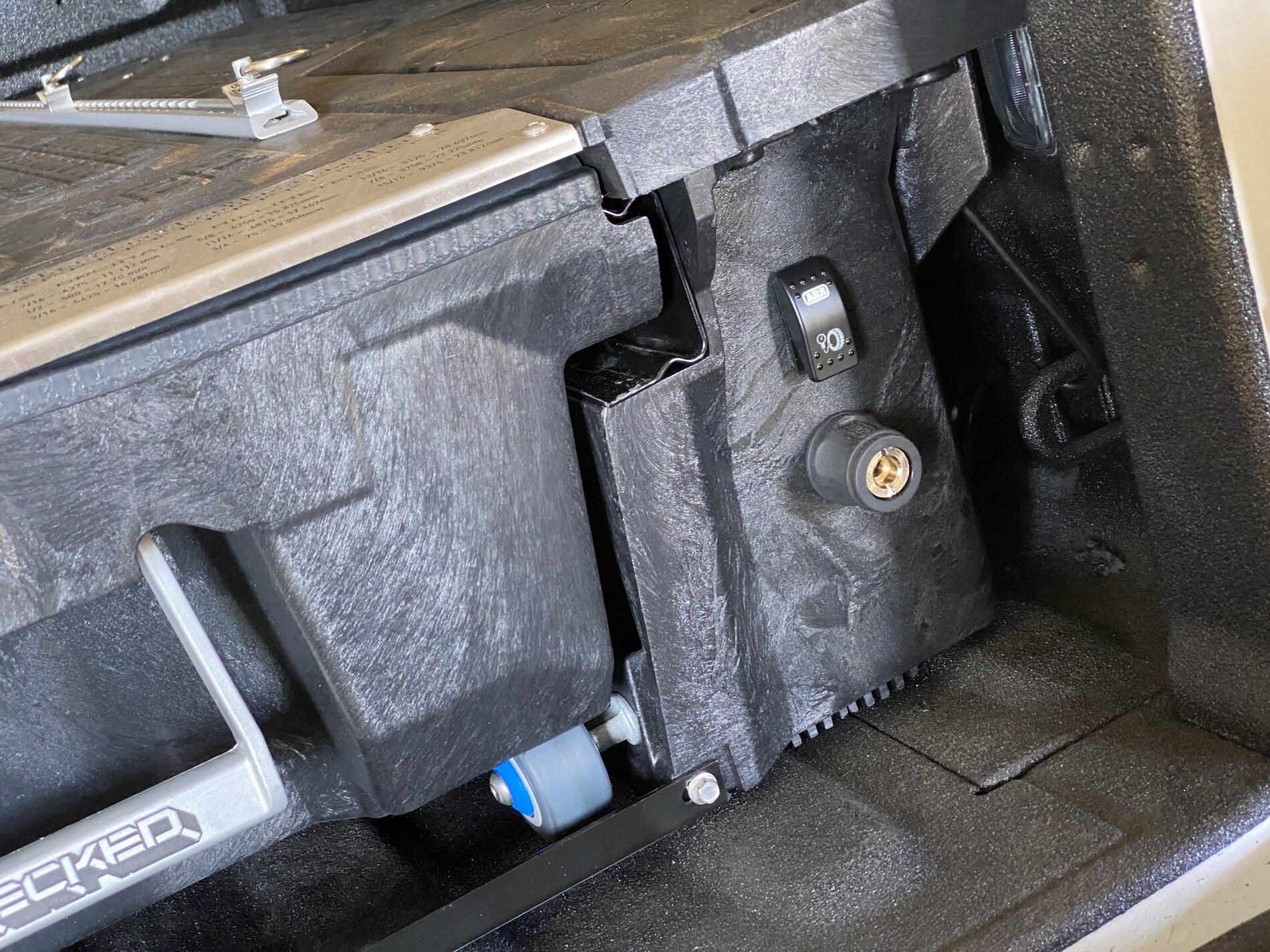

Finally finished the install this morning.

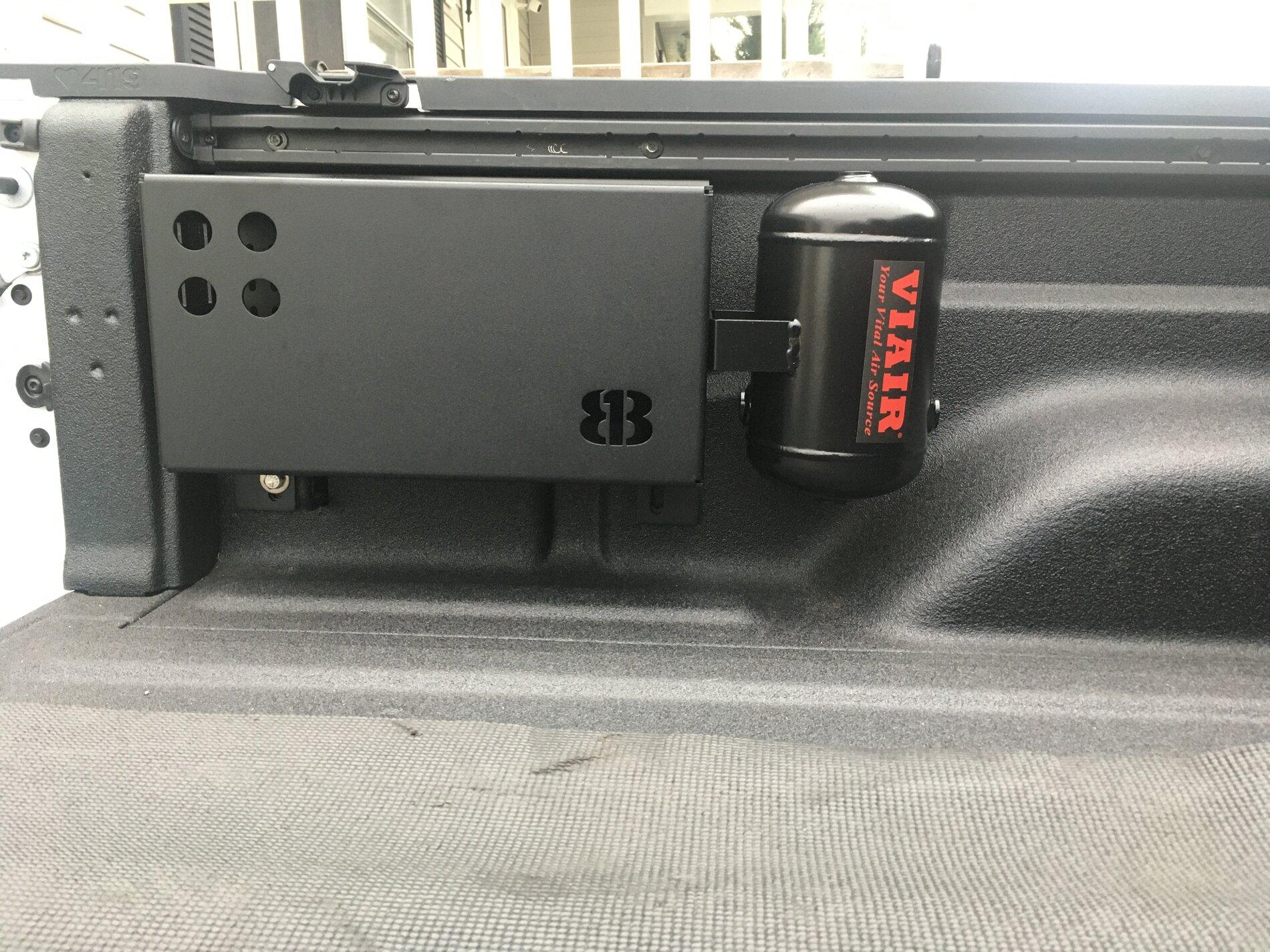

Does anyone make a mount or have a suggestion on the best place to mount a 1-gal air tank? I'm pretty sure I'm gonna mount my compressor on the top of the motor but cant figure out a place to put the air tank. My plan was to run a line from the tank to the gas filler door and one line to air horns.

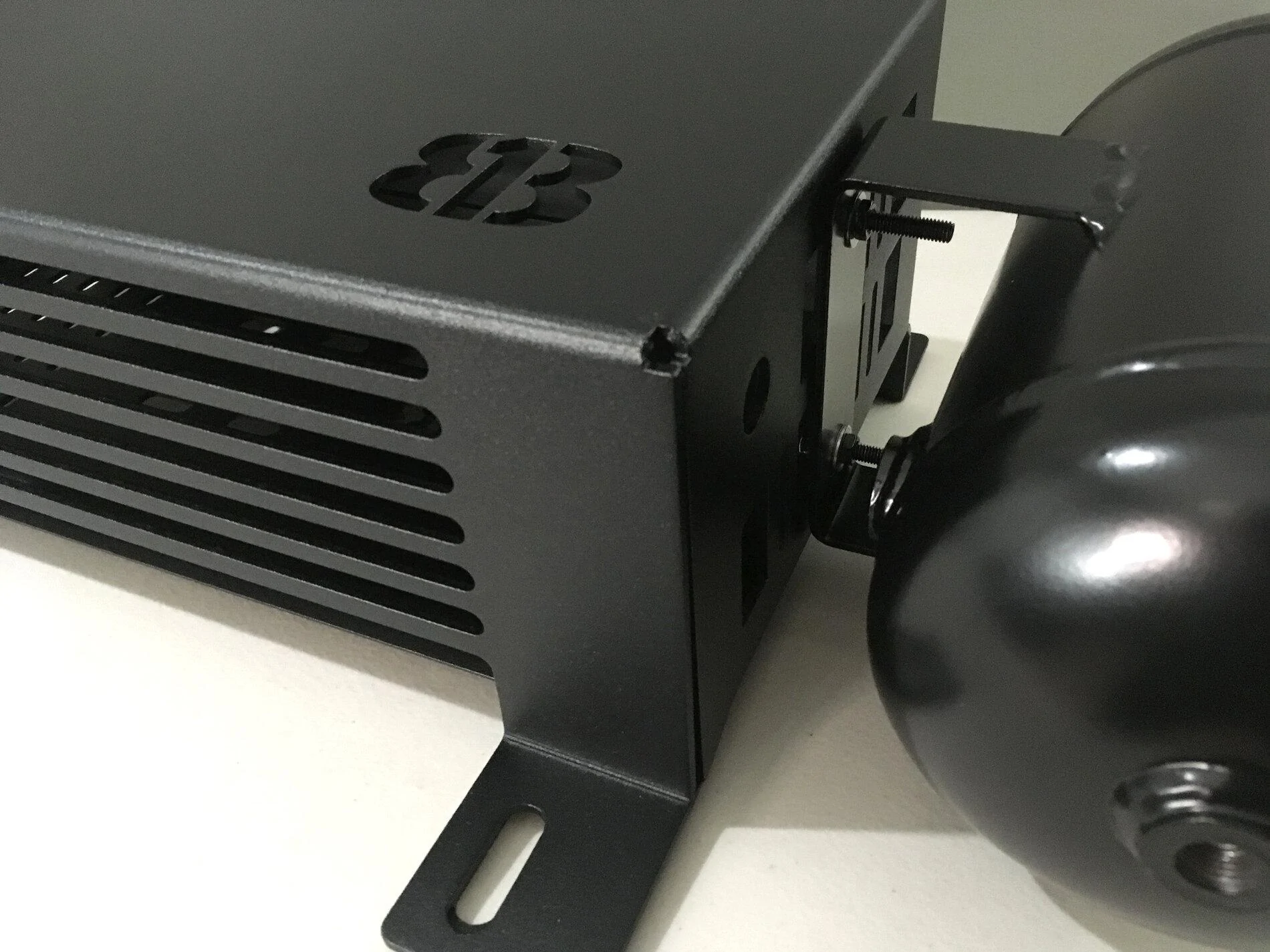

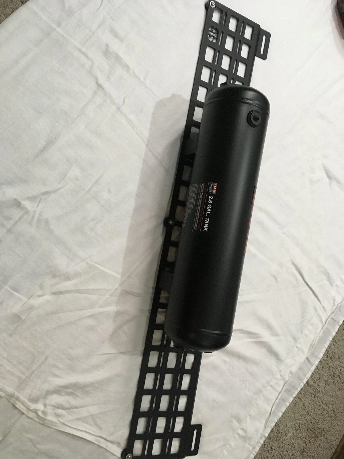

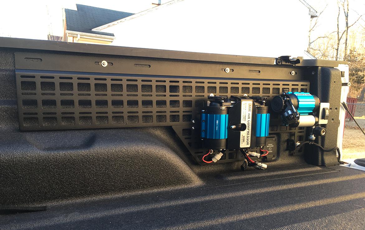

Not sure if the bed is a location you would want to go with but we have been testing different tanks mounted in the bed that work with our Bed Side Enclosure. The Enclosure fits the ARB Twin or Single compressor and has room and mounting location for the ARB locker manifold as well. I was testing with the ViAir tanks.
Thanks for the reply! I'd like to have it hidden, ideally somewhere in the engine or under the truck. I'm planning on using your mount that goes over the top of the engine. I've seen an ARB 1 gal tank mount for the taco's that mount it in front of the airbox.
Gotcha! I have seen one of the small tanks also mounted under the brake booster. Eventually I will see what other ideas I can come up with for the tanks.

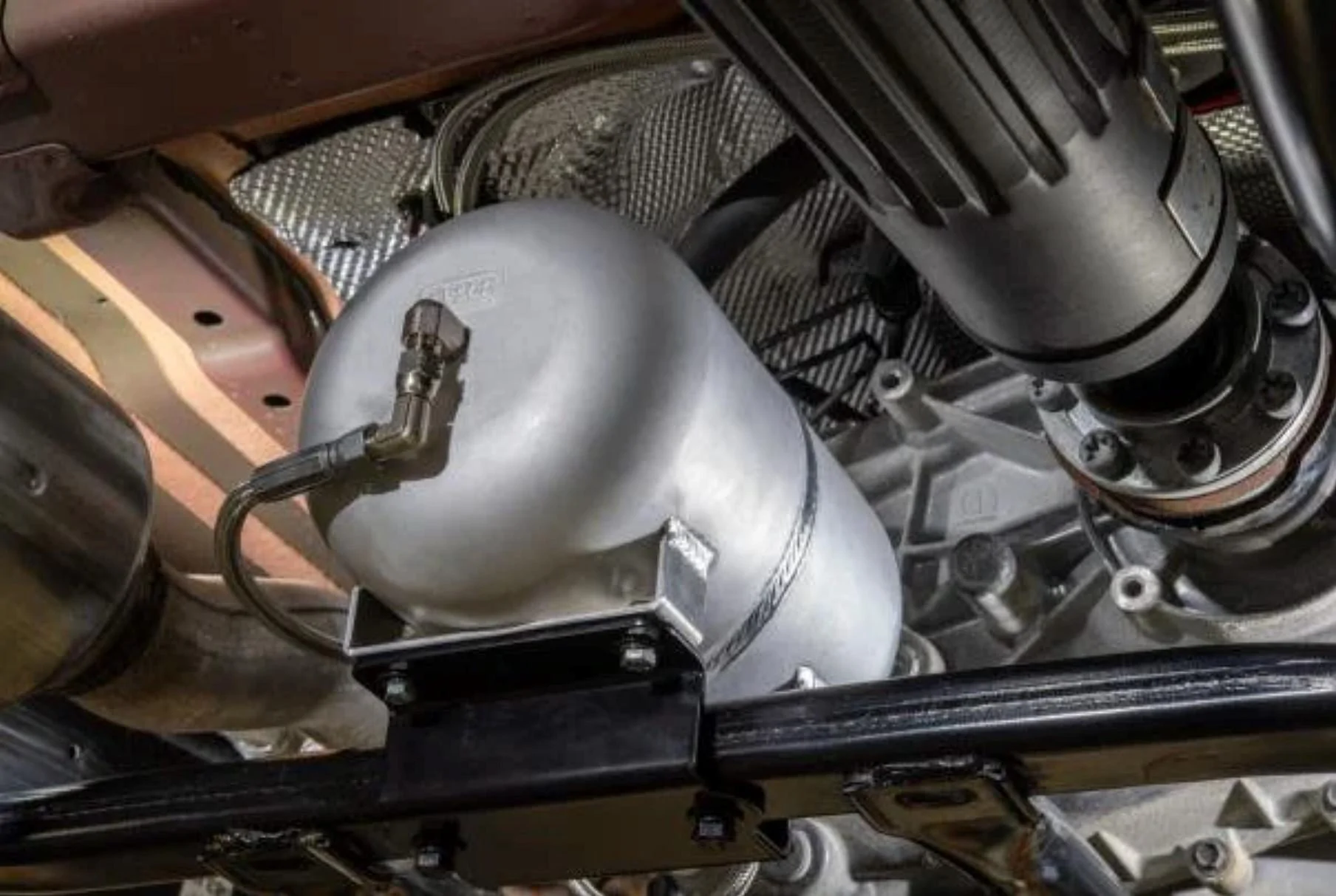

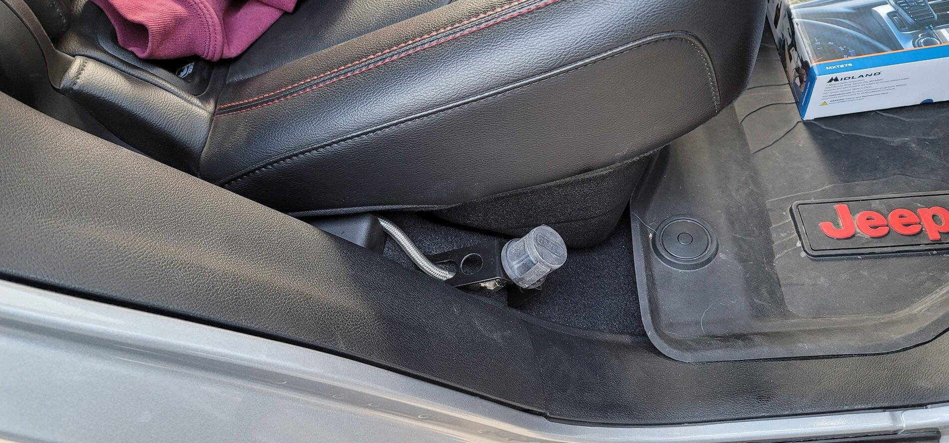

You can buy a bracket that mounts the tank underneath the cab. I actually considered this since my original plan was to mount it under my DECKED system, but the tank was too big.
There's is actually quite a lot of room under the cab.
https://www.quadratec.com/p/arb/twin-air-compressor-mounting-bracket-jeep-wrangler-jl-3550220

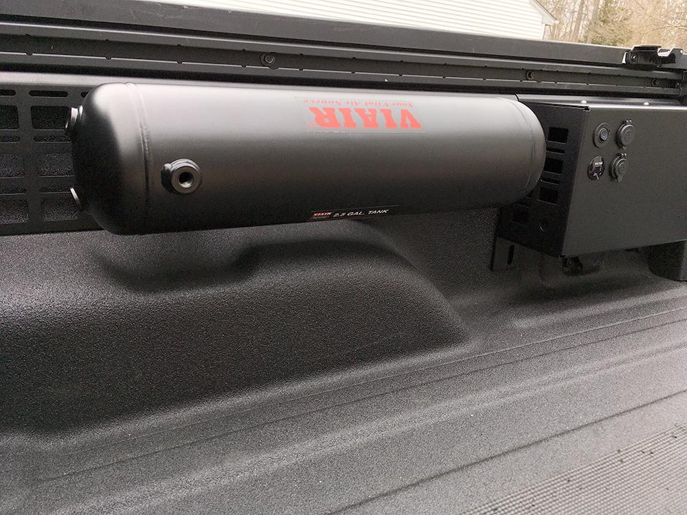

I am running with 37s, is the ARB Twin Compressor a good compressor for those size tires?
Thinking of going with the Bed Side Enclosure with the ARB Twin Compressor.
I have With regards to the storage tank location, what size tank is in the pic?
Curious if you can put a larger tank there or if it would be needed?
Yes, it will work well for the 37".
The small tank mounted on the enclosure is the 1 gallon ViAir tank. It is the same size as the ARB small tank but heavier. The ARB tank is aluminum and much lighter, but, the ARB has two legs vs 1 leg on the ViAir. I have not tried mounting the ARB tank.
