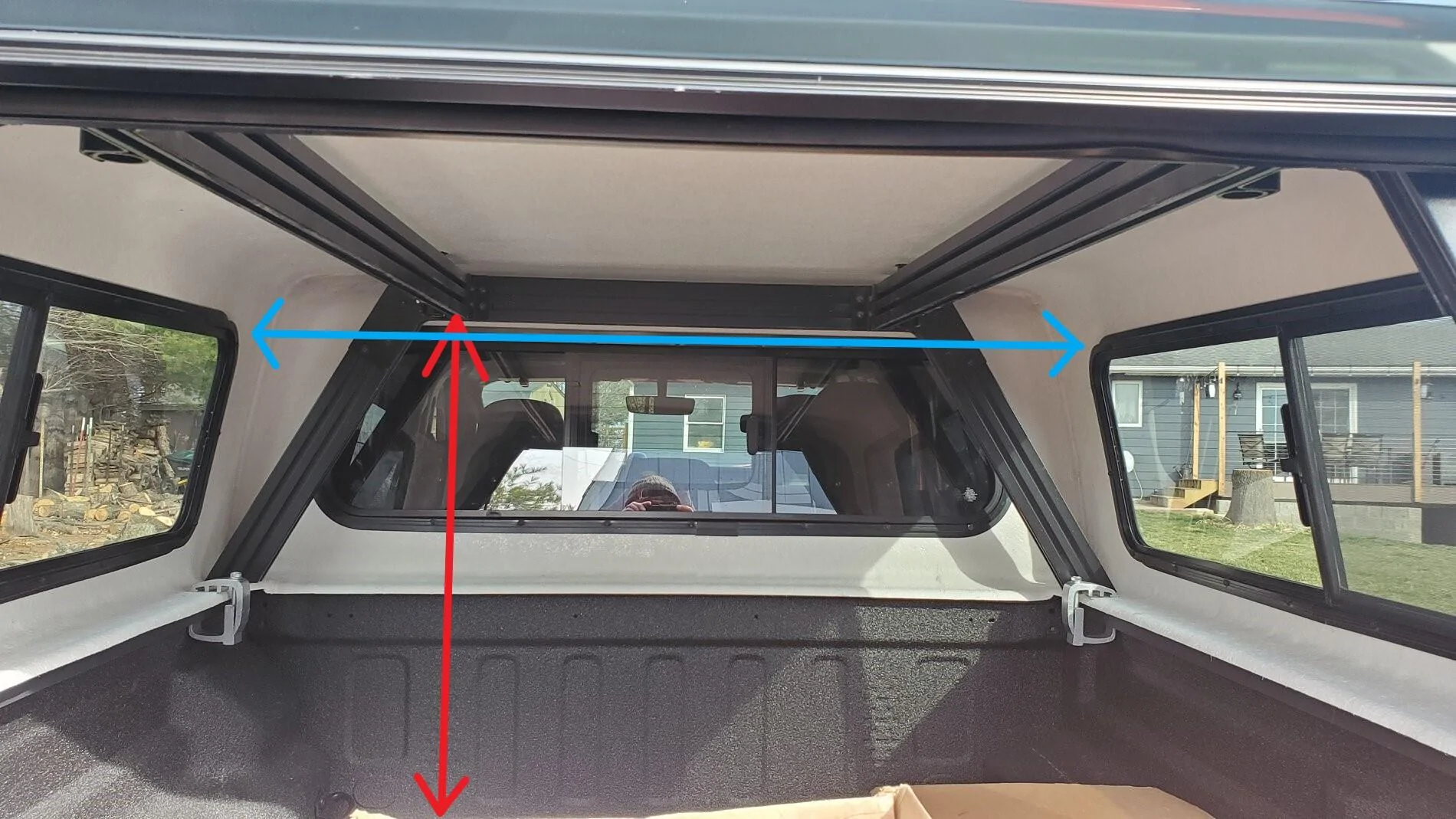

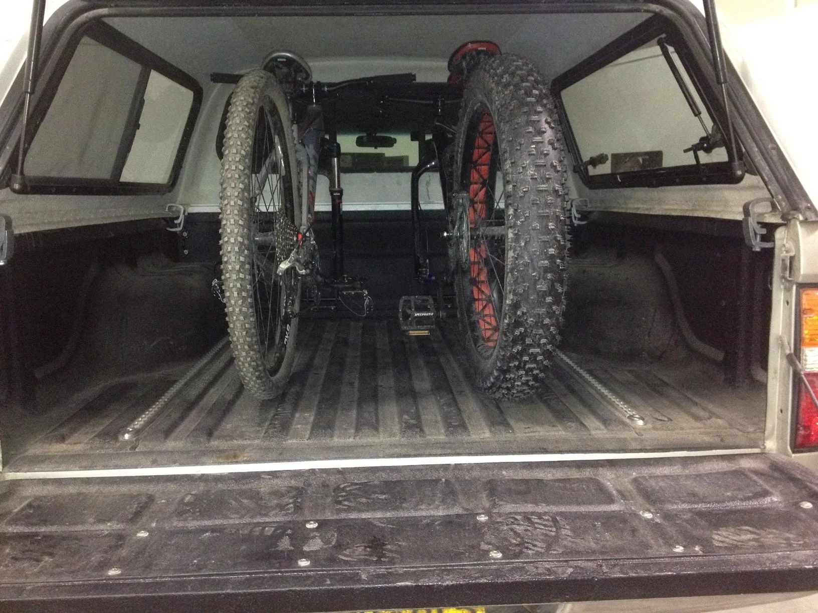

Well my ARE topper finally arrived! Check out the pics and let me know what you think. All in all I'm happy with it, and disappointed in the small details for a item that is this expensive.
Sorry for resurrecting an old thread but I had a couple questions for those of you who have ARE CX HD caps.
I currently have a CX on the back of a 1st gen doublecab Tacoma. One of the big things I use it for almost daily is hauling bikes around. It keeps them somewhat securely locked up and keeps the road salt off. I'm planning to upgrade to a Gladiator with a CX in the next year or two. I'd love to go HD.
What is the dimension to the bottom of the support bars (red arrow) and what's the width of the topper (blue arrow)?
Jeep Gladiator ARE CX HD ARE CX With Bikes

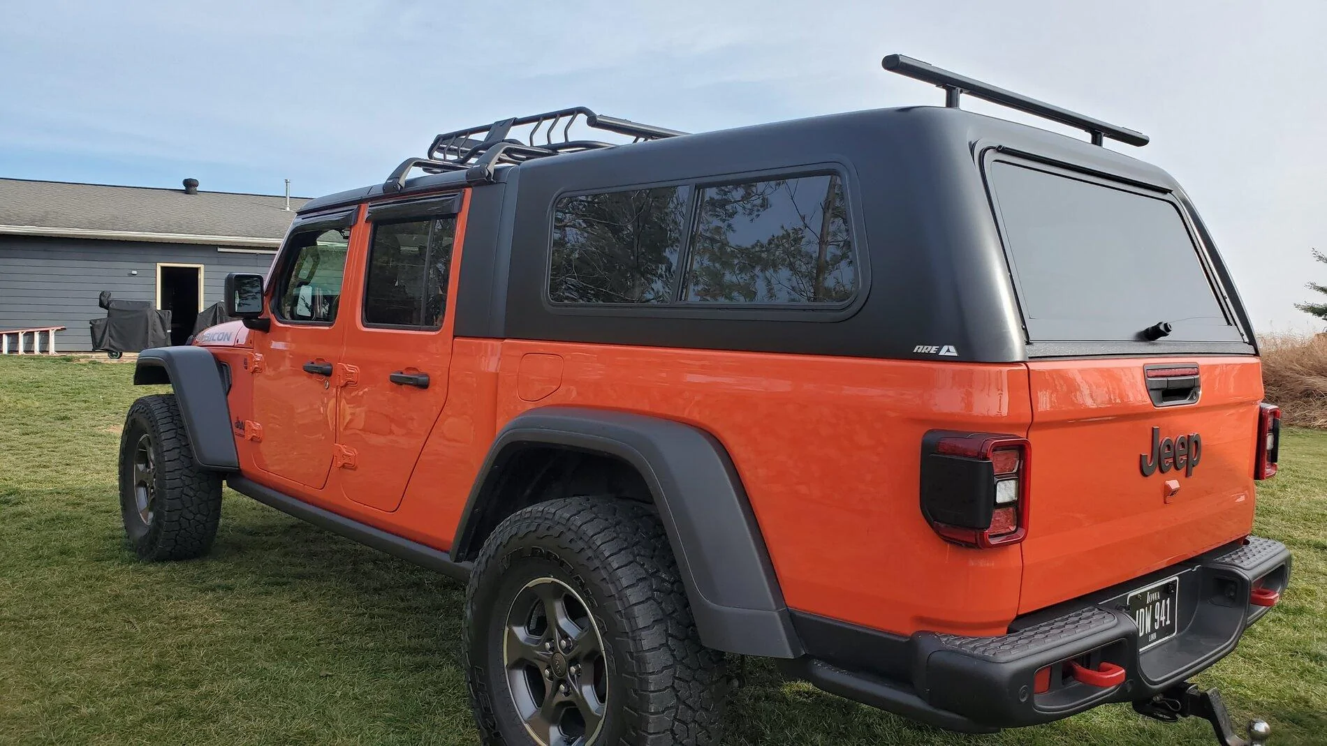

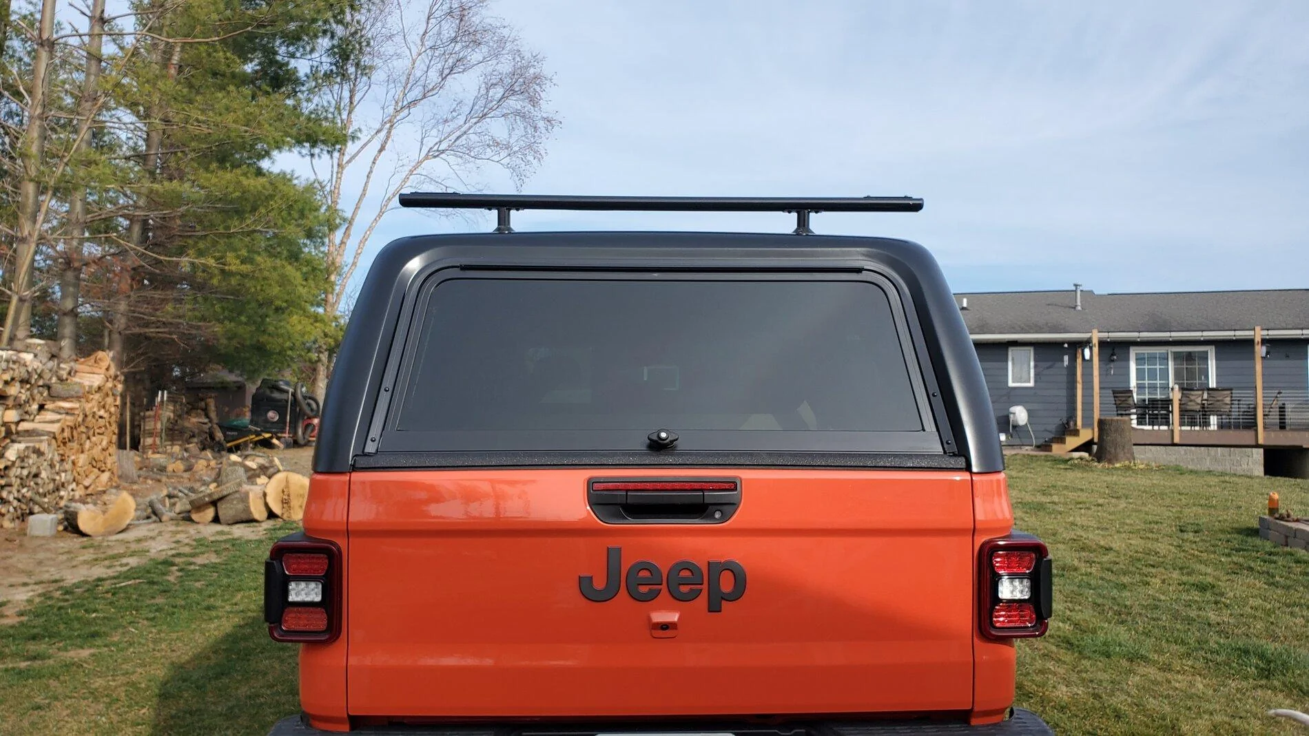

I've got mine put away for the summer so there is no good way to get the measurements for you. If you search bed width and subtract 2" you would be close to your Blue line. I can say with decent confidence that the Red line would be about 18" above the bed line. The HD bars do take up a lot of space!!
Jeep Gladiator ARE CX HD 2C4797A9-3C8F-4452-9375-ECD1F2D55FB5
Jeep Gladiator ARE CX HD 73B20FE5-D12D-4FD0-AB1F-0320FAA2CD84

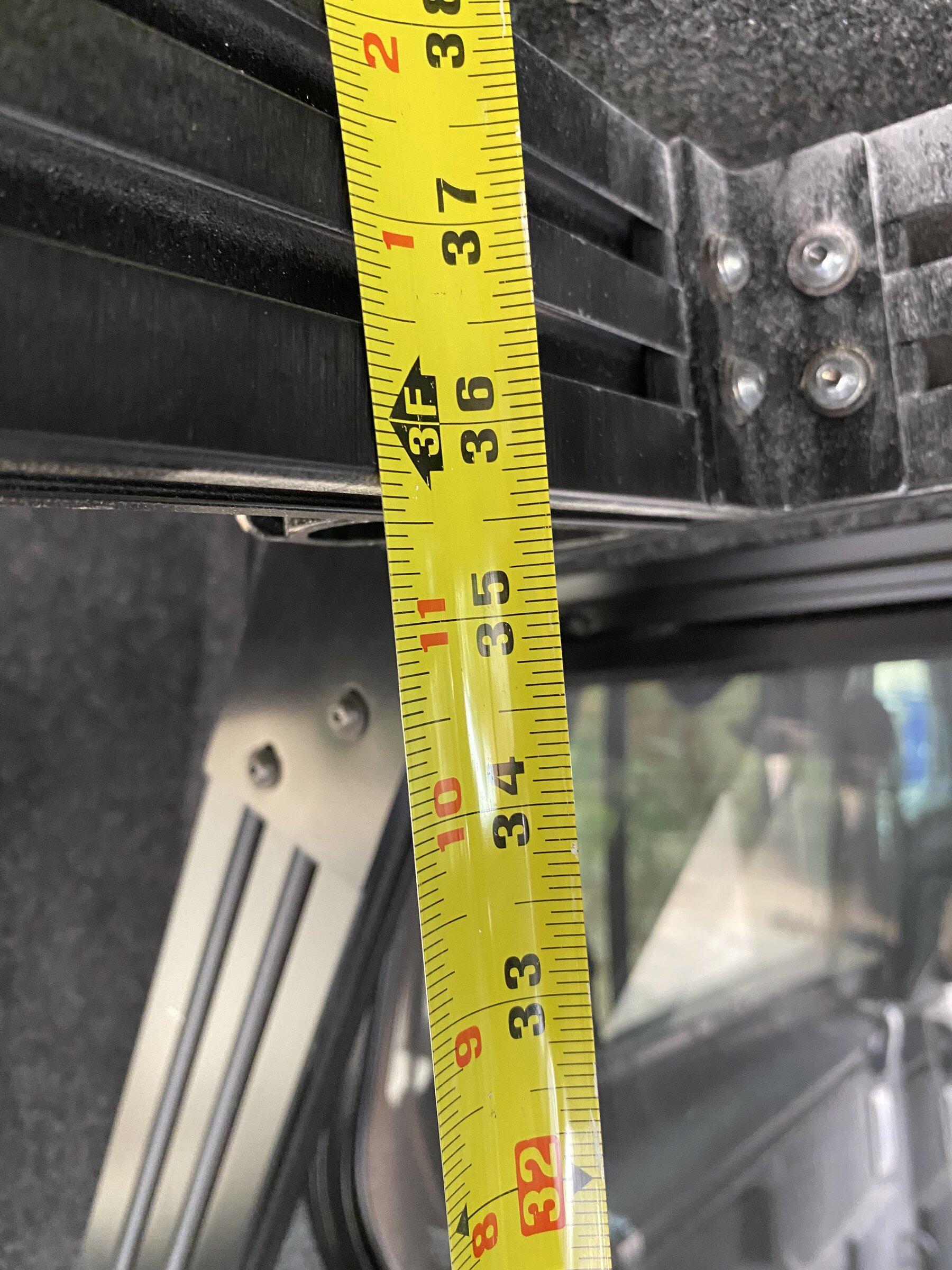

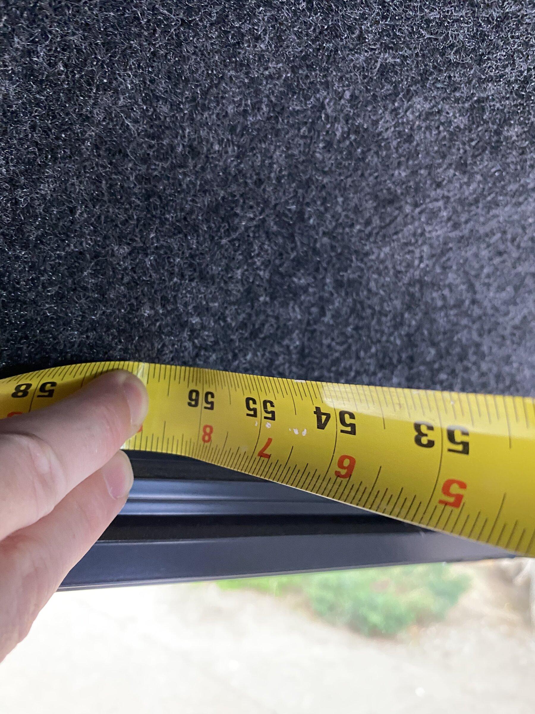

Sorry the last photo wasn’t great but the width is 56.5”

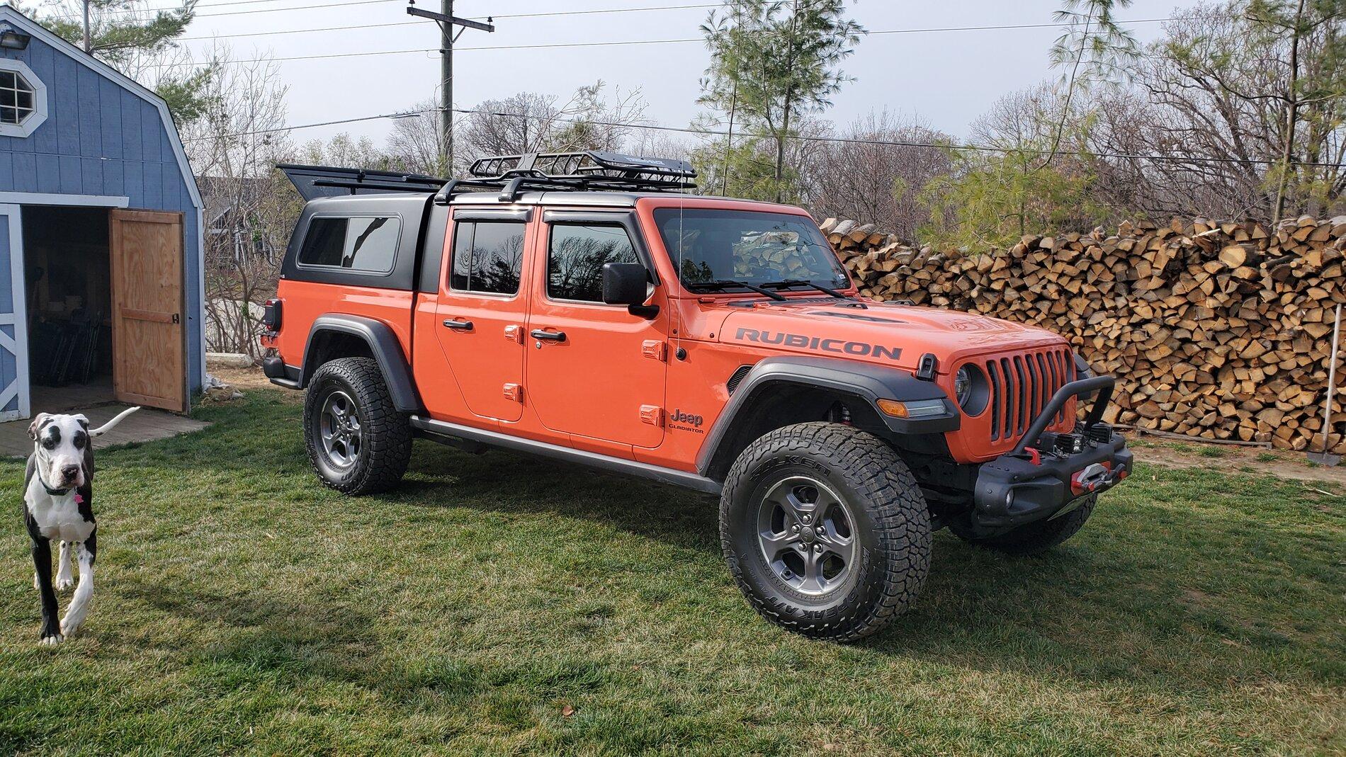

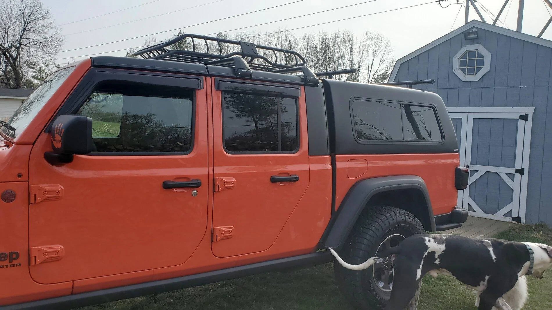

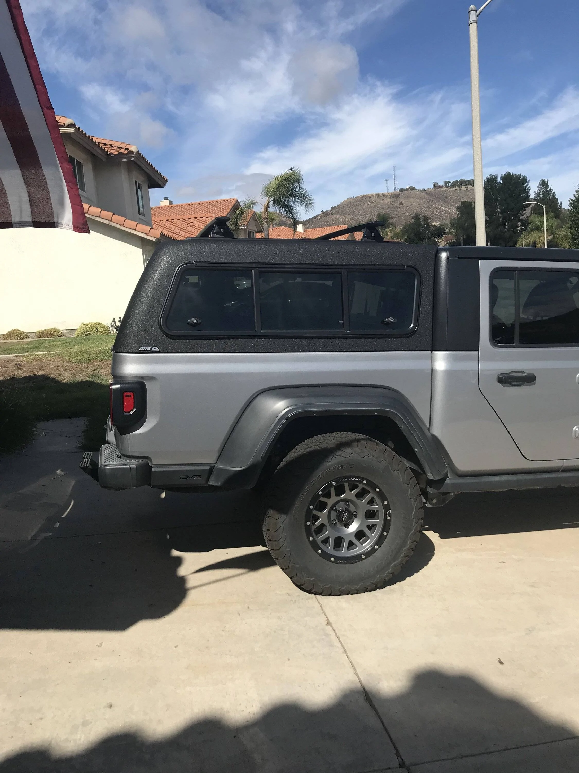

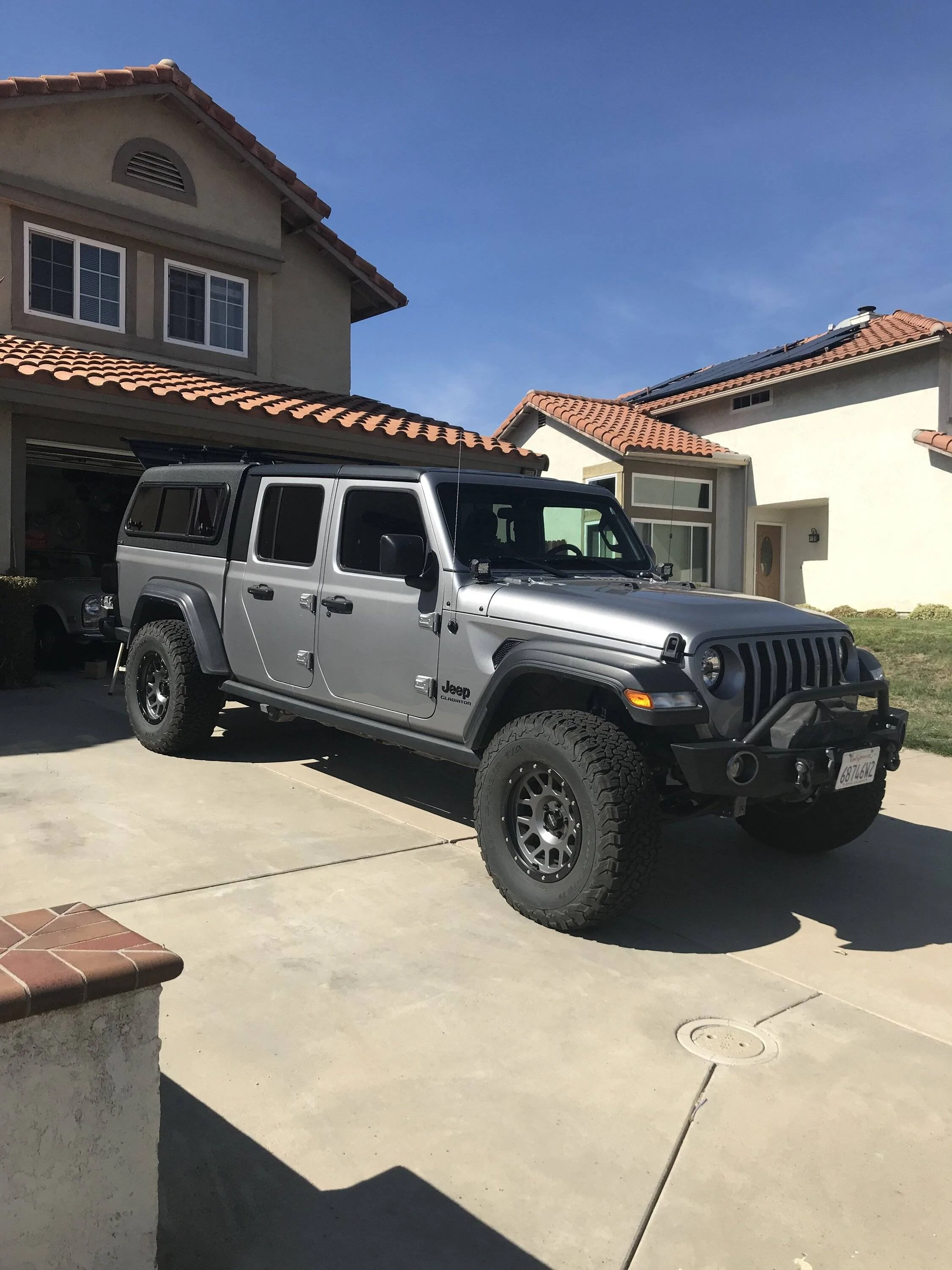

I have the OTR...it is more textured then the Jeep Roof but that's ok as it is real tuff..I am happy with it..here is a couple shots of it...weight wise probably 20 lbs+- more than a painted cap
Jeep Gladiator ARE CX HD IMG_1334
Jeep Gladiator ARE CX HD IMG_1345
