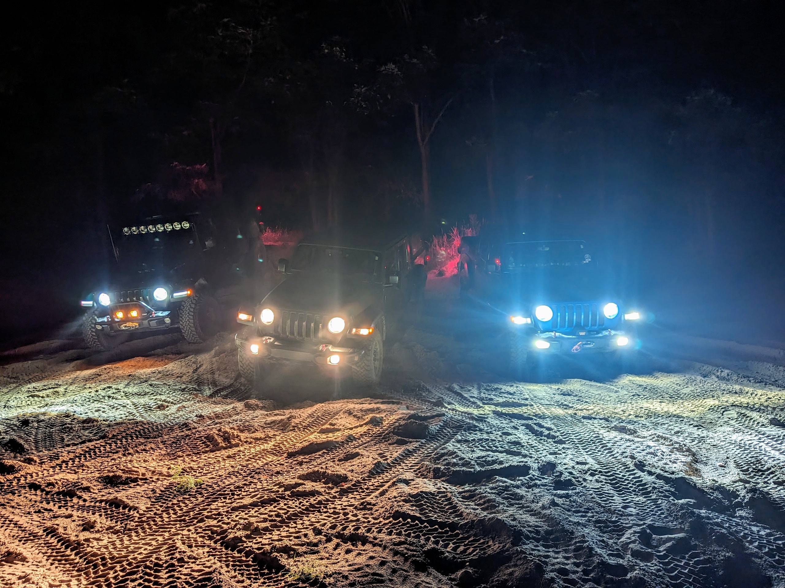

They don't though. The construction and location of the diodes never mimics filaments. They can't. LED bulbs by their very nature have a completely different light dispersion pattern than halogens. No way around that.
Right, if you look at my picture you can see that the LED bulb in the reflective housing on the right has a large saturation area.
This is a bad picture to use for that. Each Jeep is on a different angle, and the the factory LED one doesn't have as many lights on as the other two. That alone can impact the "saturation" difference you see. It's hard to see the actual differences between each here because of the difference in pitches, angles, and number of lights between them all.
It's a neat picture no doubt, but as I said before, I'd be interested in a better version of this picture as this one isn't good for comparing objectively.
That photo doesn't prove anything because we don't know what LED bulbs are in that particular Jeep. The light pattern they throw is VERY dependent on the way the bulb is constructed. There are some out there now that exactly mimic the halogen filament position, size and thickness. Those cast a very nice light pattern that is nearly identical to the halogen bulb. Any variance in that changes the light pattern significantly.
