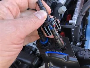

My aux battery failed after 3 years which is lame. Dealer advised that I should replace both batteries but I only replaced the aux battery. It will auto stop start one time per key cycle, but it will not tell me why it isn't ready. I guess it doesn't like the main battery. I'm not replacing batteries every 3 years because the ECU is too picky about them...
For the record, I replaced the battery from the top because I don't like messing with those plastic rivet things. It wasn't too much hassle, and I bet I can do it in 10-15 minutes next time.
