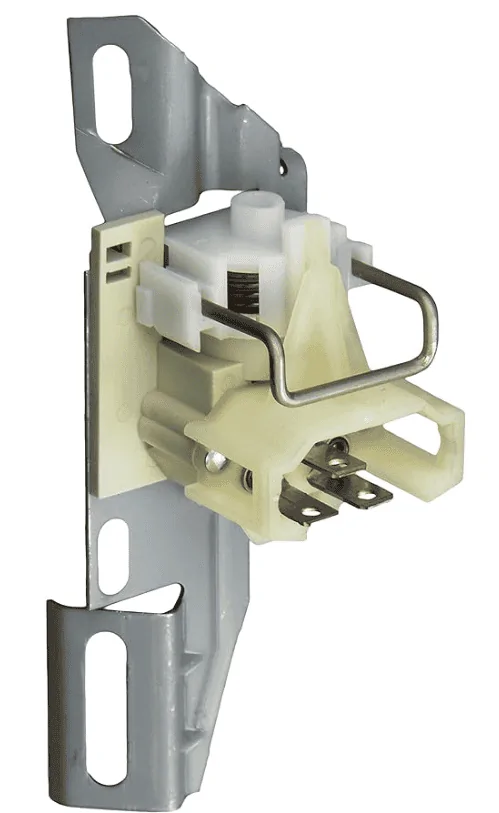

Try living in places where salt is used in the winter and not being able to get rusted bolts out of the floor to remove the switch and then fighting oxidized connectors to disconnect the floor dimmer. They just plain sucked in places like where I live. Don't know anyone around here who misses them
These were a ton easier than floor switches -

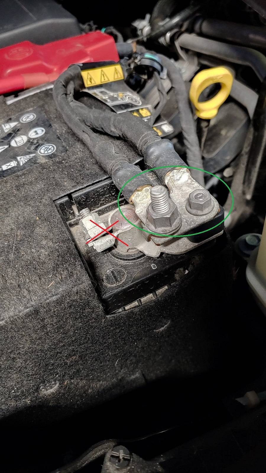

Just curious if you hook a battery tender up to the main battery, does it keep both batteries topped off?
Yes, as Bill said. Best to do independently when possible but a tender on the main battery can do both.
Also as mentioned - be sure to connect above - to the top of the IBS and not to the battery negative post directly.

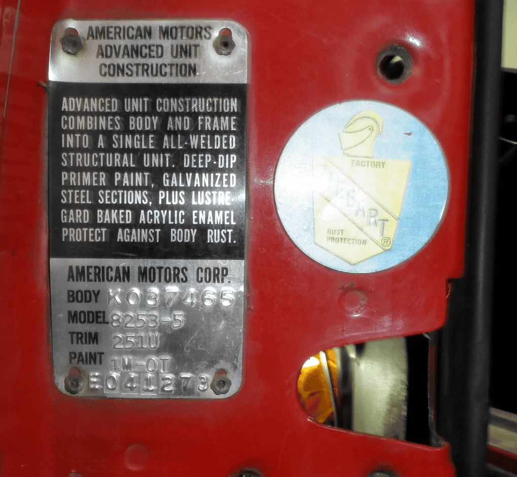

Jeep Gladiator Auto stop, worst idea ever just got worse. 1701537867504
Yeah, that's one of my cars before repaint and restoration. (I'm still trying to find someone who can duplicate those decals or knows of how to get any new ones - that's the one thing I'm missing for the door areas)
