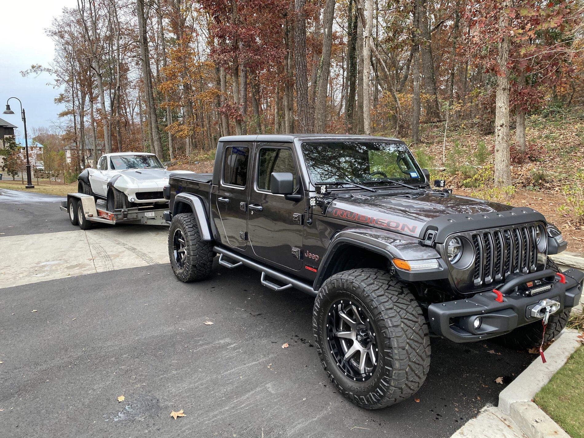

Why does the Mopar lift suck?
Iā€˜m quite happy with mine.
