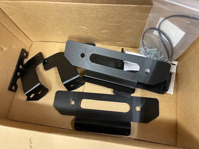

I’m still waiting to install my Apex 12k. My MP Concepts bumper’s winch plate is garbage so I ordered a Warn winch plate. It arrived yesterday and was literally missing the winch plate. It had everything in the box minus the winch plate itself. I have another one coming Tuesday. This is what came in the box.

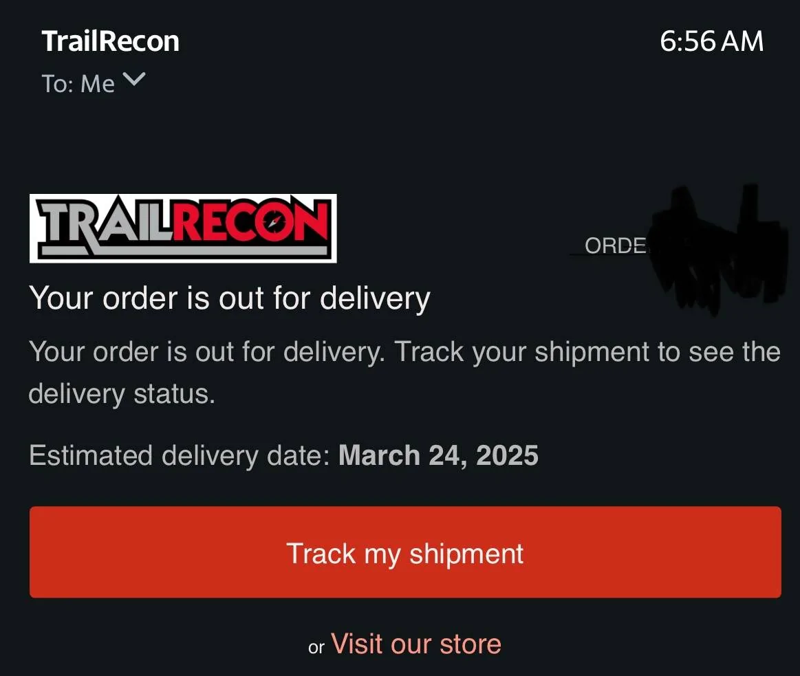

I ordered
Mine a couple weeks ago. They are actually waiting for some more pieces from manufacturing so they can get their batch to powder coating. They could not give me a day when it’s shipped.

Thanks. I just emailed them to ask for an update. This actually makes me feel better than if they just lost my order or something.

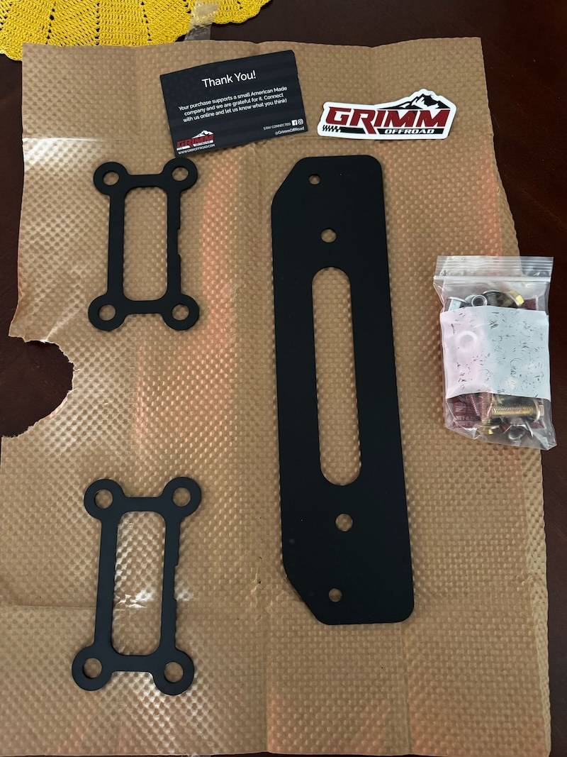

Finally home and able to open the box. Noticed I had a additional UPS package with one small plate. Looks like they knew one was missing and sent it. Great company.

Will see if I can tackle this over the weekend.

The same thing with me.
the spacer came about a week later. I didn’t end up needing it but was still impressed they knew and shipped it out separately without me having to ask or wonder why I only had 1!

Good to know that it was not needed for your install. So that might be that same for mine. Cool.
