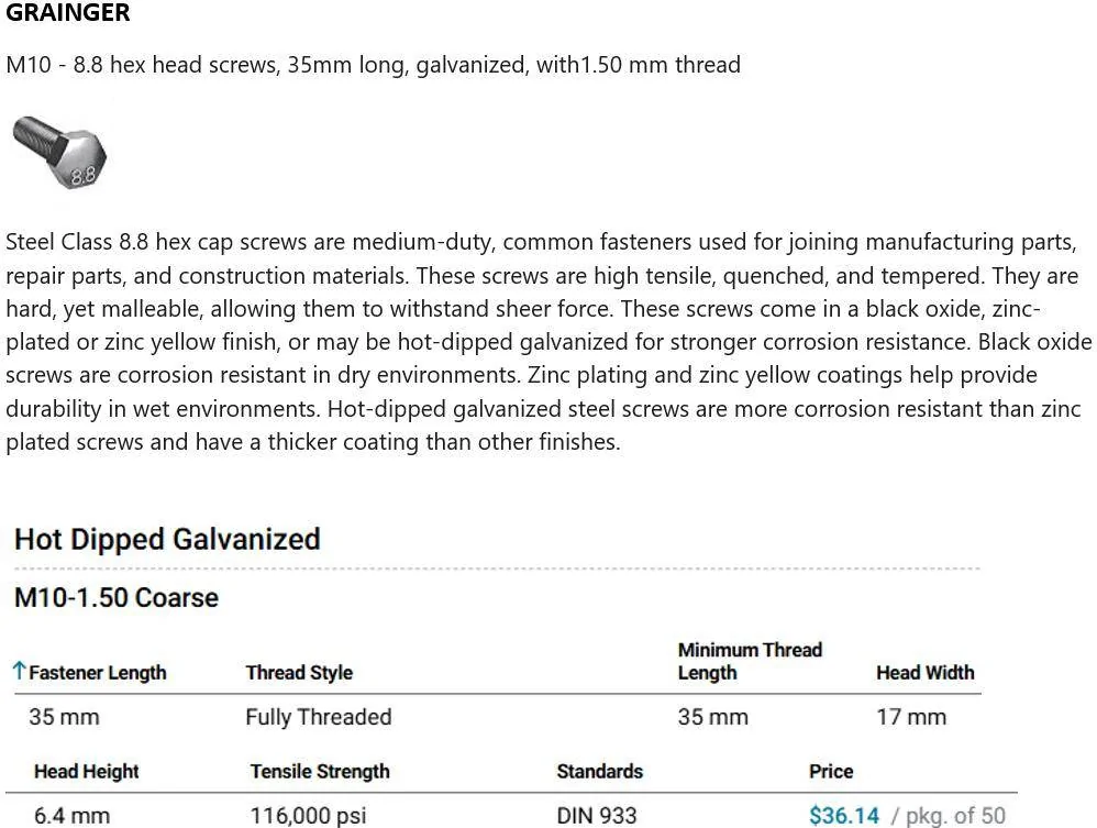

I’m installing the Badland winch on my new aluminum RockHard4x4 bumper and I’ve hit a roadblock with the mounting bolts. The provided bolts are M10, 25mm long (I believe), galvanized (I believe) grade 8.8 hex head screws with 1.50 mm thread pitch. Unfortunately, the 25mm mounting bolts Harbor Freight provided that go into the square nuts are too short for this bumper and I need to source longer 35 or 40mm ones. The provided bolts appear to be galvanized but I’m not totally sure.
I have several questions and hopefully someone on here can help me out.
  • The texture and appearance look like they are galvanized. Can anyone confirm this? I’m having a tough time finding galvanized M10 bolts that will match the provided square nuts.
  • Where is the best place to source a longer replacement bolt with the same characteristics as the provided bolts?
  • Is it more advantageous to switch to imperial grade 8/metric grade 10 steel? Or is galvanized better for this application (outside, salty/wet/snow/muddy environment)? I know stainless steel will gall up unless I use anti-seize. If I do this, I’ll need to source a matching grade flat washer, spring washer, and square nut. This may not be worth the extra effort?
I’m somewhat of a noob at this and maybe I’m overthinking it but I don’t want the winch to rip off the bumper because I used improper hardware.

Hi Aleph,
I'm in the same position you are. I plan on putting my Apex 12000 on my new Rubicon JT and have read about possible issues with the length of some of the the bolts. Based on your comment, I found these on Grainger. If these work, just keep track of half of the pack(s) of whatever you are buying and I will split it with you. The ones I found are hot dipped coarse galvanized but they have zinc plated ones and fine threaded ones. I'm in no way an expert on this stuff but I'm sure someone knows more about this than I do.
