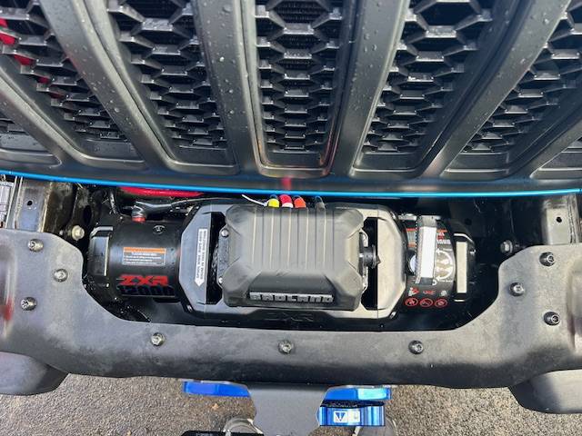

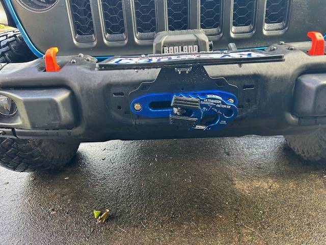

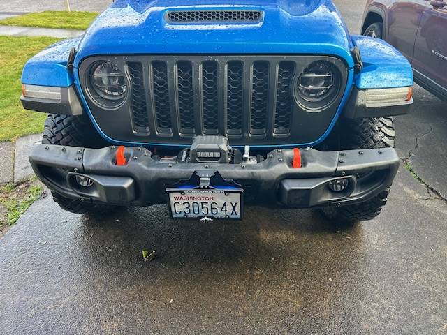

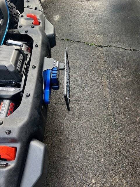

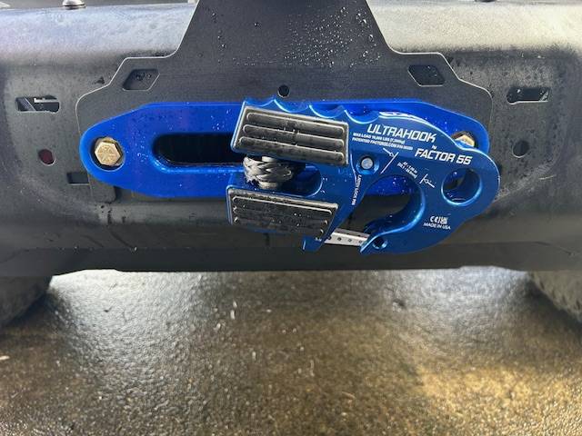

Update: Installed apex ZXR 12000 lb winch this past weekend. Used the warn winch plate. I took off the JTM plastic bumper and installed a OE Wrangler steel bumper and OE black steel front skid plate.
Issues:
Either the steel bumper was tweaked a bit or the frame was tweaked a smidge from the deer that committed suicide on my plastic bumper, but it was a little difficult getting the bumpe to mount easily, had to kinda work that out; kinda geantly’ish but it went on.
The skid plate from the Mojave did not fit the new bumper. The black front plate with the steel bumper fit but had to elongate 2 mounting holes that went to the bracket on the truck.
Other than those 2 issues, it was fine and will look great when I fabricate some covers to enclose the openings around the winch.
