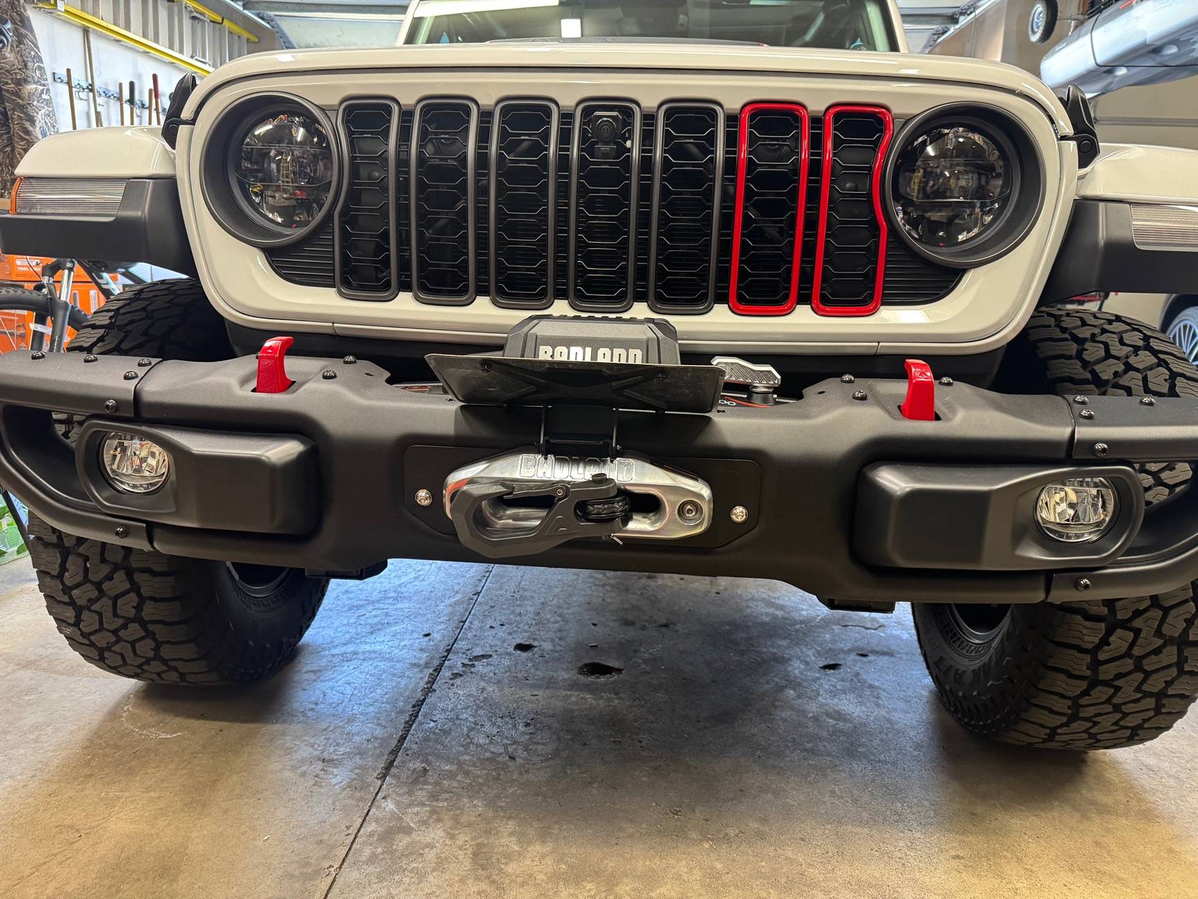

I also installed the Grimm Offroad Winch Plate with the factory steel bumper and Apex Badland winch. It was completely plug and play with no need to cut, grind, or drill! I posted a bunch of pics here:
https://www.jeepgladiatorforum.com/...tock-2024-rubicon-x-bumper.88723/post-1515937
Nice job. I already did mine also. Plug and play is music to my ears. No cutting or grinding. I just had to wait for the two parts that were missing in my kit (the fairlead cover and one of the spacers) for about two weeks but they arrived and all is well. In my case, I did buy longer bolts as some others had mentioned since the ones included were, IMO, just slightly short by a couple of millimeters. Other than that, it was fine.

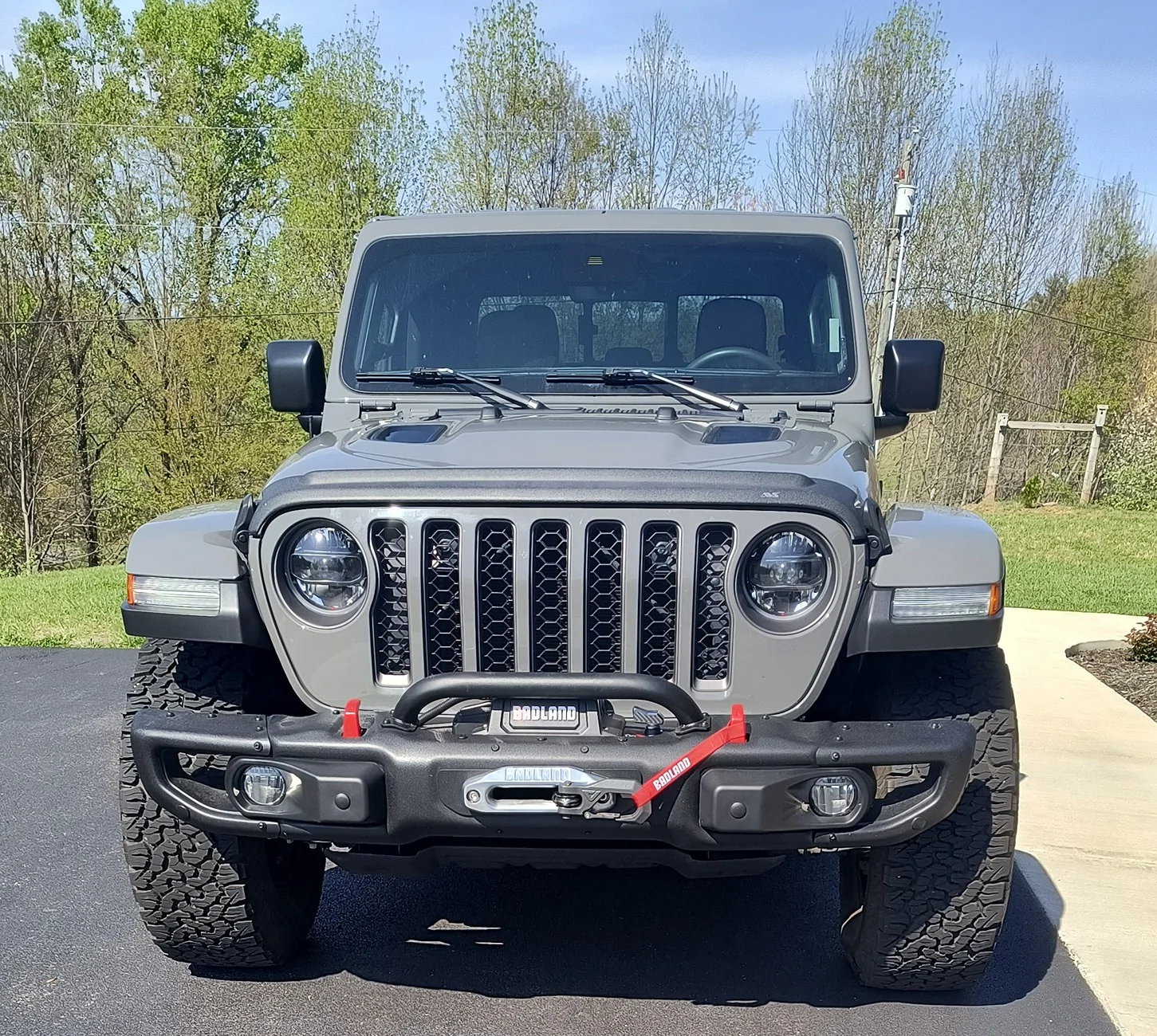

Spacers were not needed for my installation…
Only wiring left to hook up.

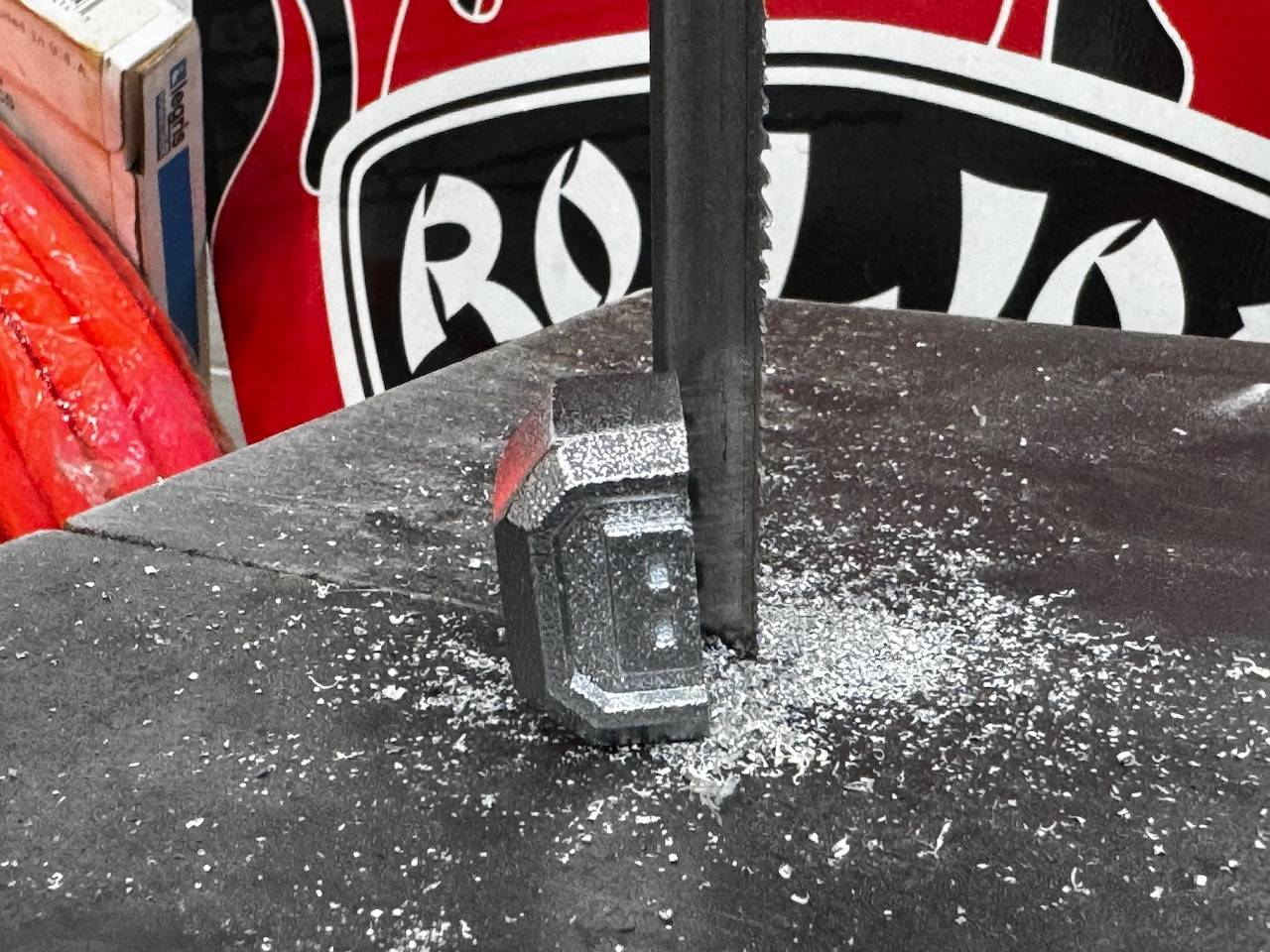

Had to cut the knob to clear the hoop.
What knob is this? I am thinking about getting the winch and adding the hoop to mine.
The one that the winch comes with. You remove it (easy, just one locking set screw) and cut it so it clears the hoop.
40,504
54,031
Hack saw, band saw, or grinder. Did the same on mine..

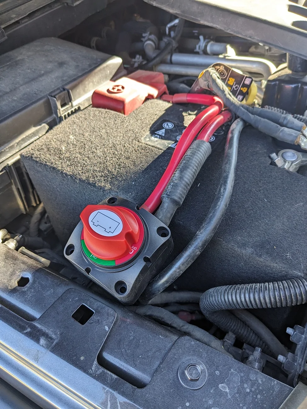

Update: Did the Adventure Labs disconnect mount. as suggested by Mightytalldude:

How long did it take to come in after you ordered it? I just ordered one and I'm curious, I'd like to start using my shiny new winch.
It sounds like it's taking a bit of time. However, you can put the cutoff in place, just loose until it arrives. Mine was a few weeks from order to delivery, but that's also a few years ago.
Thanks! I just opened the box the switch comes in and it looks like the guts are pretty well insulated. Now I just have to wait on the cable insulating jacket to come in then I'm good to go.
I will plug the disconnect mounting plate from Center AK (thread). $29 and I received mine two days after placing my order.
It didn’t take too long. In the interim I attached the cutoff switch with a couple of zip ties.
