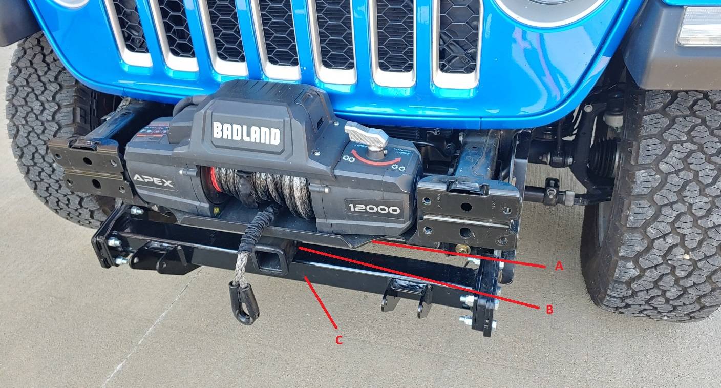

I've had my Apex winch on two Gladiators so far. In a month or so it will be on a third.
I used the Bulldog winch plate and love it. Super heavy, the ears go behind the frame end flanges - nice for when pulling a bumper off to do other stuff, the winch and plate pretty much stays put.
I have a whole lot of stuff up front in the summer - the winch (A is winch plate)
B is the 2" receiver and C is the snow plow mount I remove in the summer (takes off about 30-40 pounds?)
It will be very interesting to see how it all fits on a Mojave - likely a lot of messing around relocating the shock reservoirs and so on.
I may want to space the winch up about 1/4" as well - at least on THIS bumper and truck combo, the line sort of sits low in the opening. The winch could sit just a tad higher to make things better.
