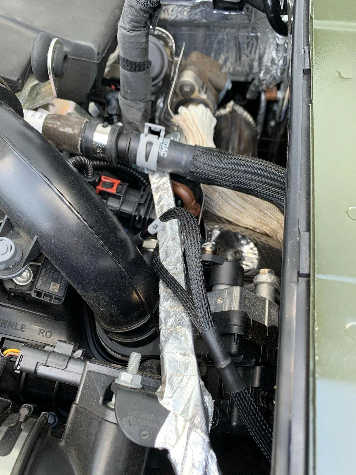

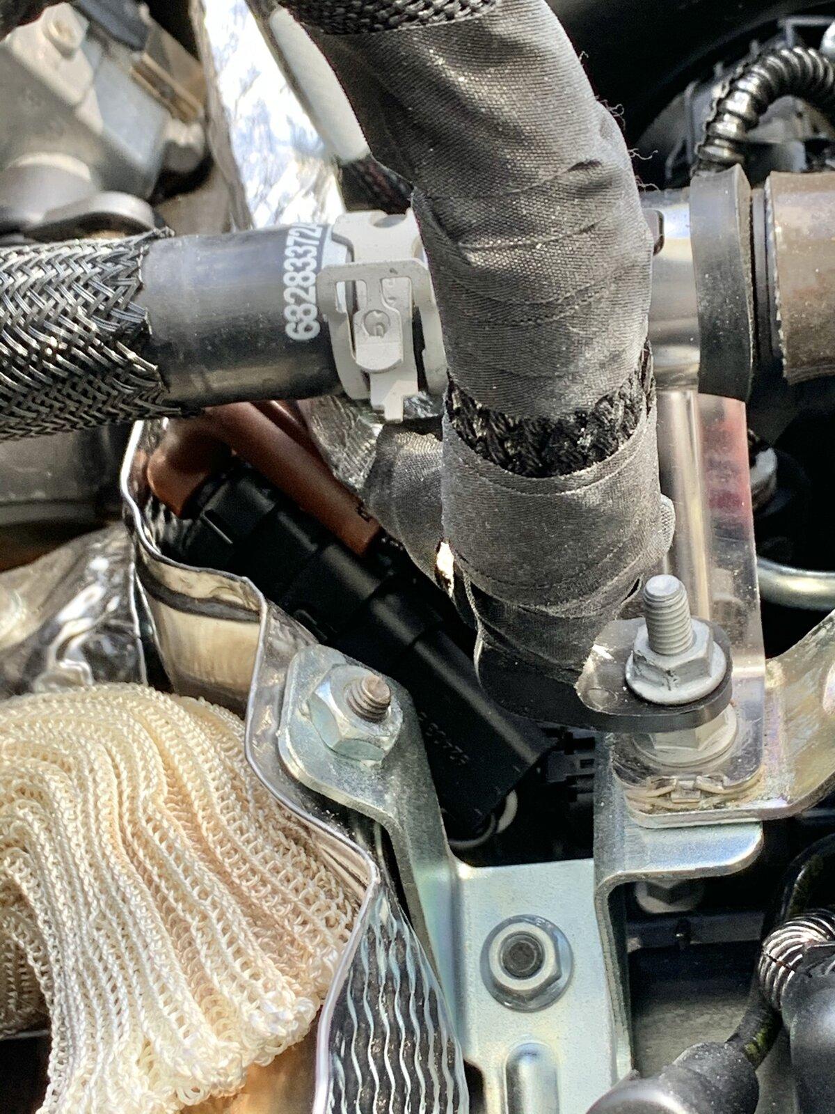

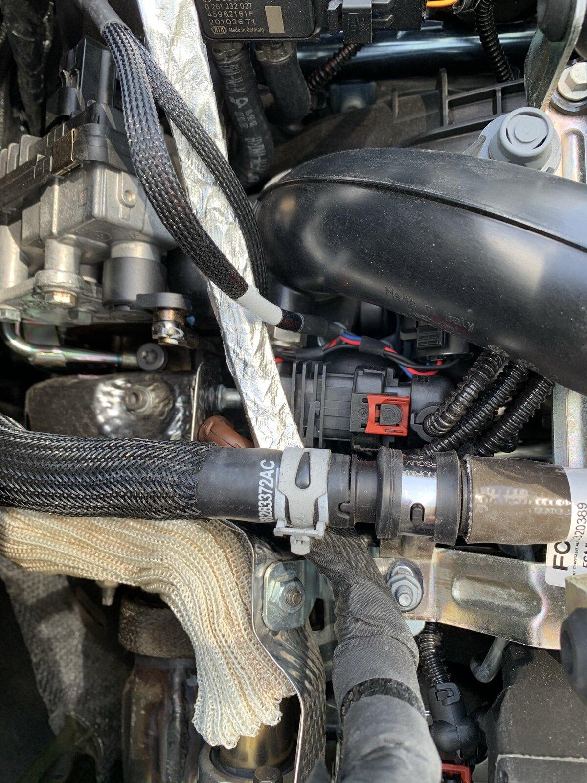

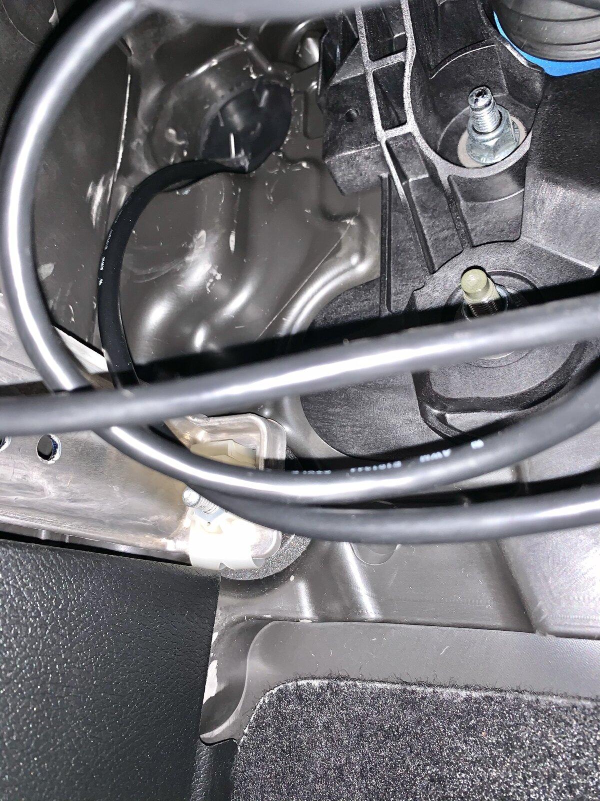

Any pictures of where they tie in at?
JDawg11
Apr 20, 2021
53
127
SlOcala
2021 Gladiator Rubi Diesel

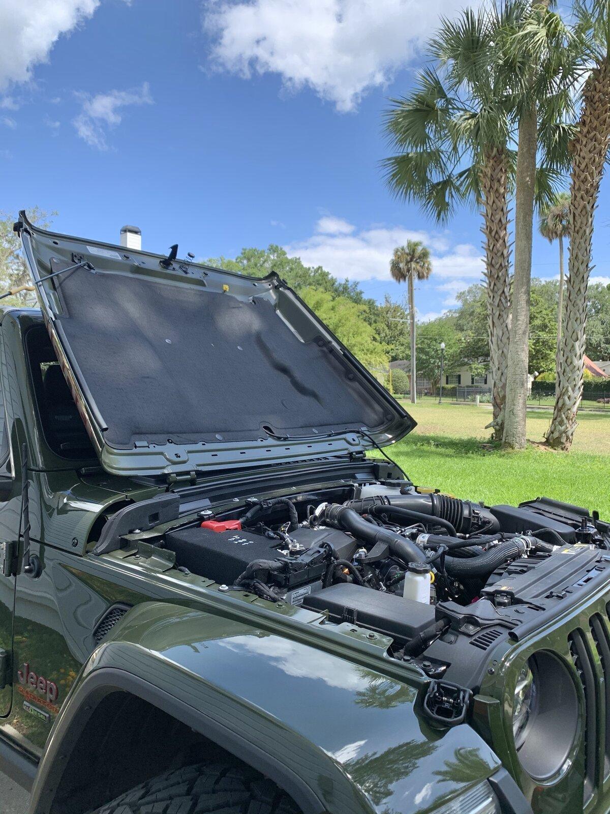

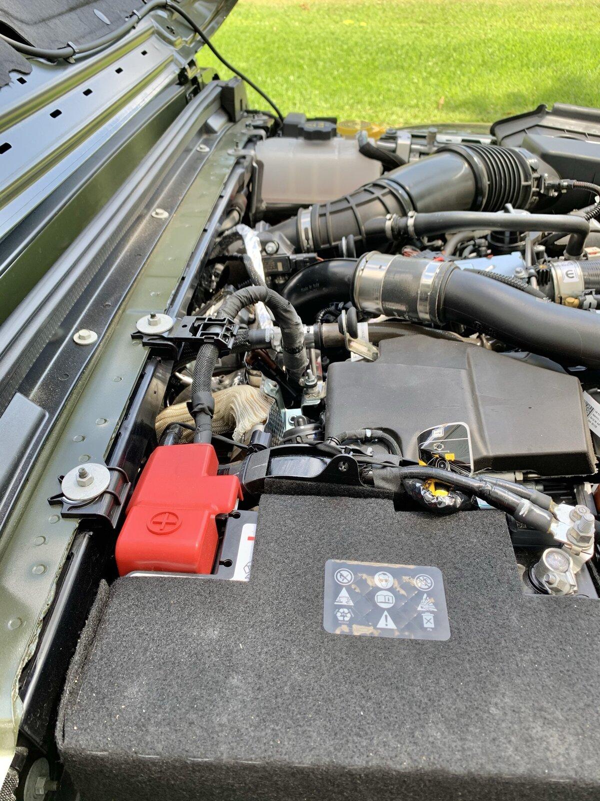

No need to remove turbo or anything. Helps to lean hood agains windshield for access. It is pretty painless. I absolutely love the performance. Just need to get Tazer mini. I hate the start/stop. Hope this helps

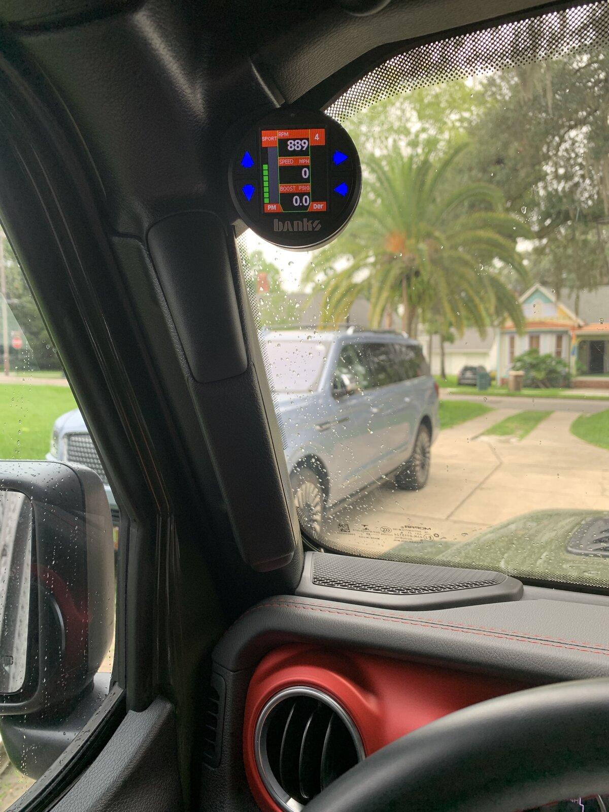

Mine is Sarge Green as well!! Is that the A-piller mount? Or the suction cup?
JDawg11
Apr 20, 2021
53
127
SlOcala
It is the A pillar mount. Nice and clean. I had the suction cup and hated it
