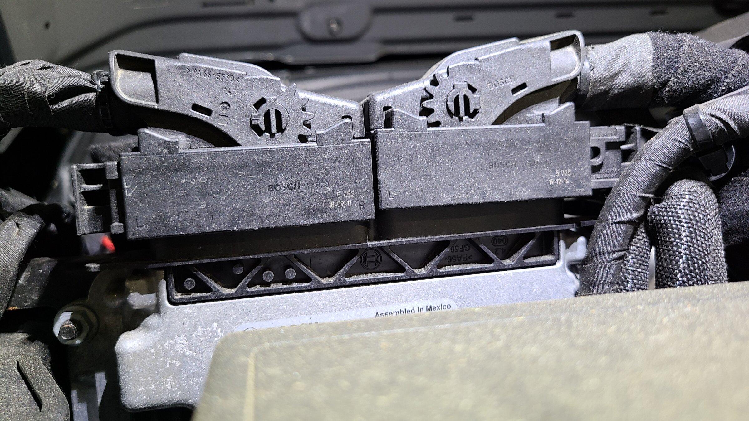

Guys, makes sure to check every fuse and that your PCM is fully secured as well. I had a few random CELs with my diesel jeep and it turn out my PCM wiring harness was not fully connected... my brother had some issues on his JL with loose fuses.. It doesnt have to be by much either. Picture below of my pcm harness. You can see the right side is particularly disconnected from the factory.
Jeep Gladiator Banks Tuner, iDash, Pedal Monster with Taser 20211101_191423
