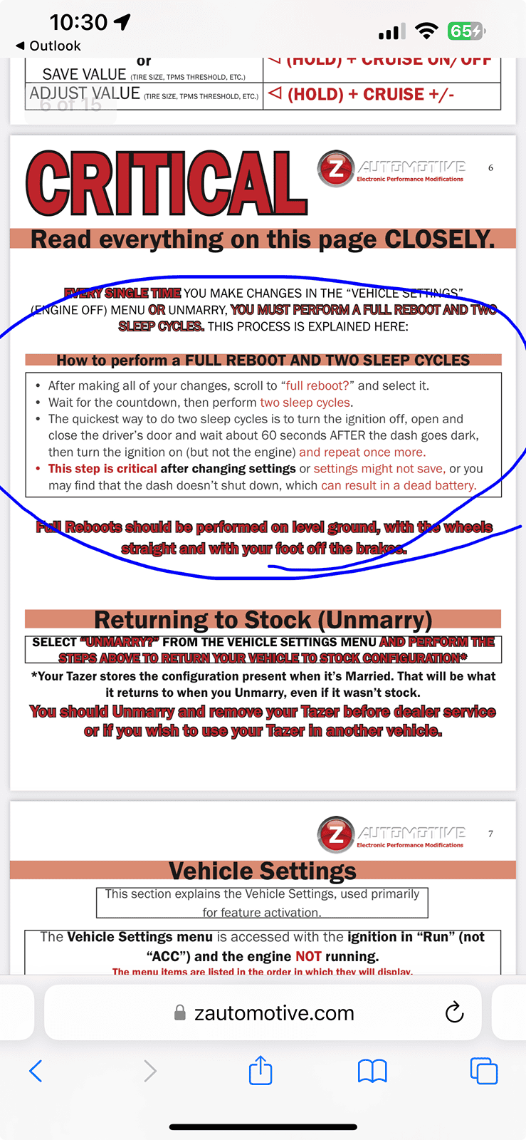

There were issues with Tazers draining batteries. They did a firmware update for it. I’m going reset tazer firmware and settings for good measure. The “critical” steps at the end might have messed up last time.
