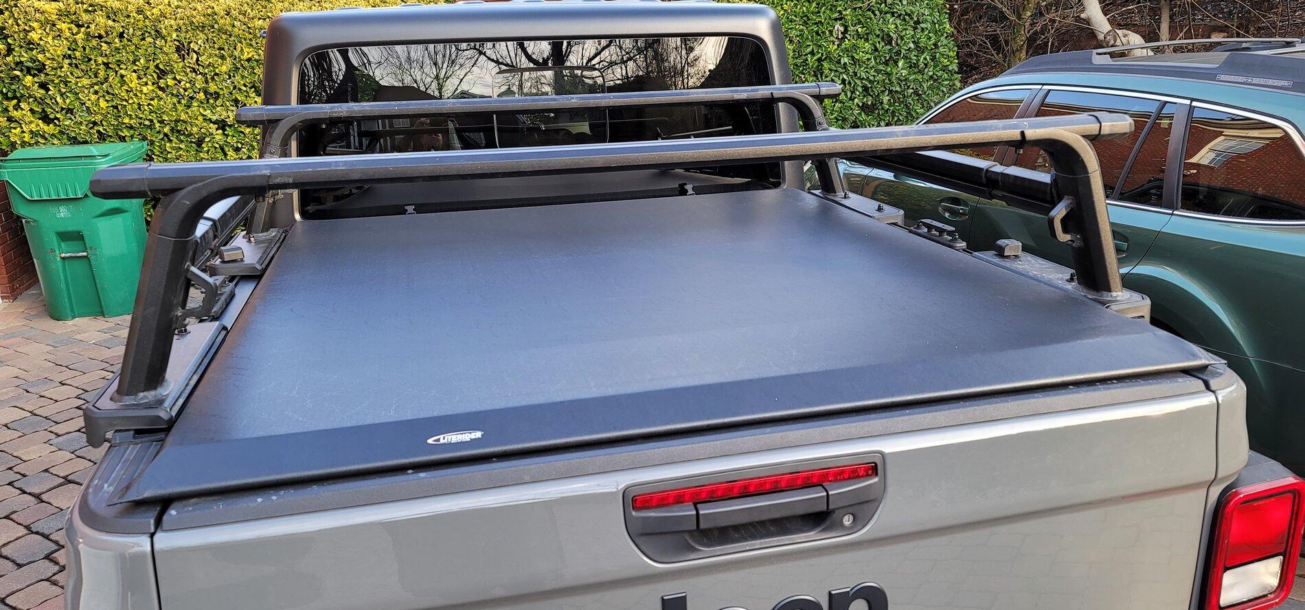

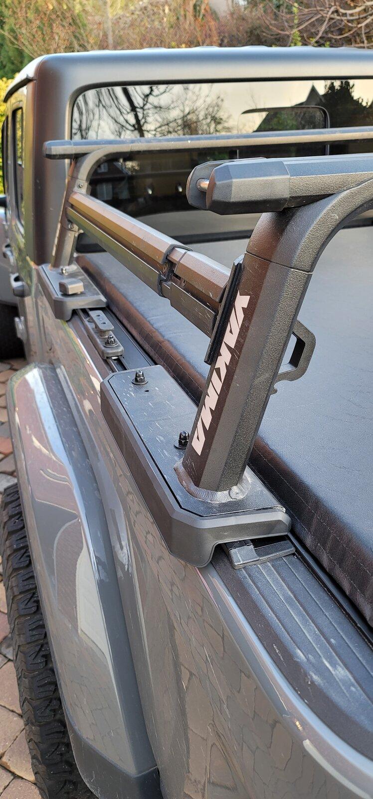

Finally was able to find a solution for my Yakima Outpost rack and tonneau cover. Used a combination of Elevate Rails with the Literider tonneau cover. Perfect fit and feels very secure.
Jeep Gladiator Bed cover with rack 20210227_173128
Jeep Gladiator Bed cover with rack 20210227_173049
Jeep Gladiator Bed cover with rack 20210227_173042
That looks nice. I've definitely considered the Yakima route.
I think I'm going to pull the trigger on KB Voodoo 10" Max Modular rack and just accept my tri fold will only be able to partially open in the last section.
Wow super intriguing... I have the elevate rails and
Wow super intriguing. I have the elevate rails and a truxedo lopro tonneau as I’ve been waiting for tuxedo to re-release the elevate rack. A few weeks back I decided to give up and I bought the Yakima overhaul HD because I’ve liked the looks of it. I’m recalling older posts where I believe folks attempted what you’re showing above. Did you achieve this with the Yakima tonneau adapter kit? I’d like to try this since I seem to have everything in my garage. Though I don’t have the Yakima tonneau kit.
