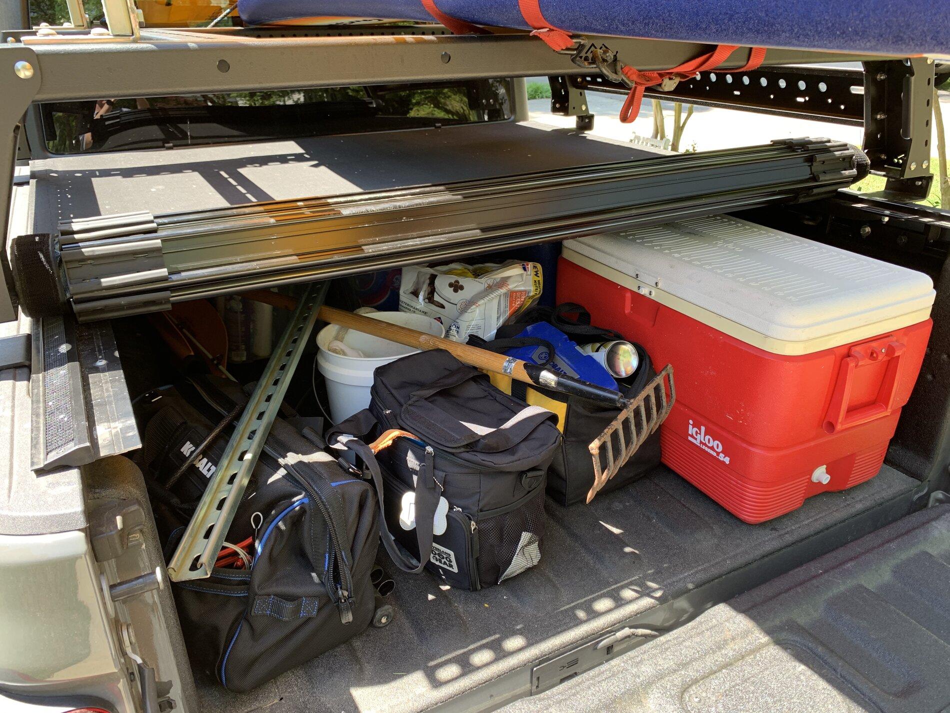

I took a chance on the 10 inch Max-Modular- hoping I would still be able to roll open my Rugged Ridge hard rolling tonneau. Well... success! The build quality of the Max Modular is fantastic and I’m able to roll the tonneau almost all the way open. See photos. The “riser” is a super strut fab I put together so that I could clear the roofline for longer items like the SUP in the photos.
This is exactly what I’m looking to do. I have the Rugged Ridge Armis hard tolling cover installed (without cargo rails). Love it. Want a bedrack and it looks like this will work and allow me to roll up at least part-way.
Do you have the cargo rail in there? MOPAR, Builtright, other, or none? And which parts did you order from MAx Modular? The 10” rack yes, did you add the tonneau adapters (I think so)? Anything else? Any extra foam or gasket?
