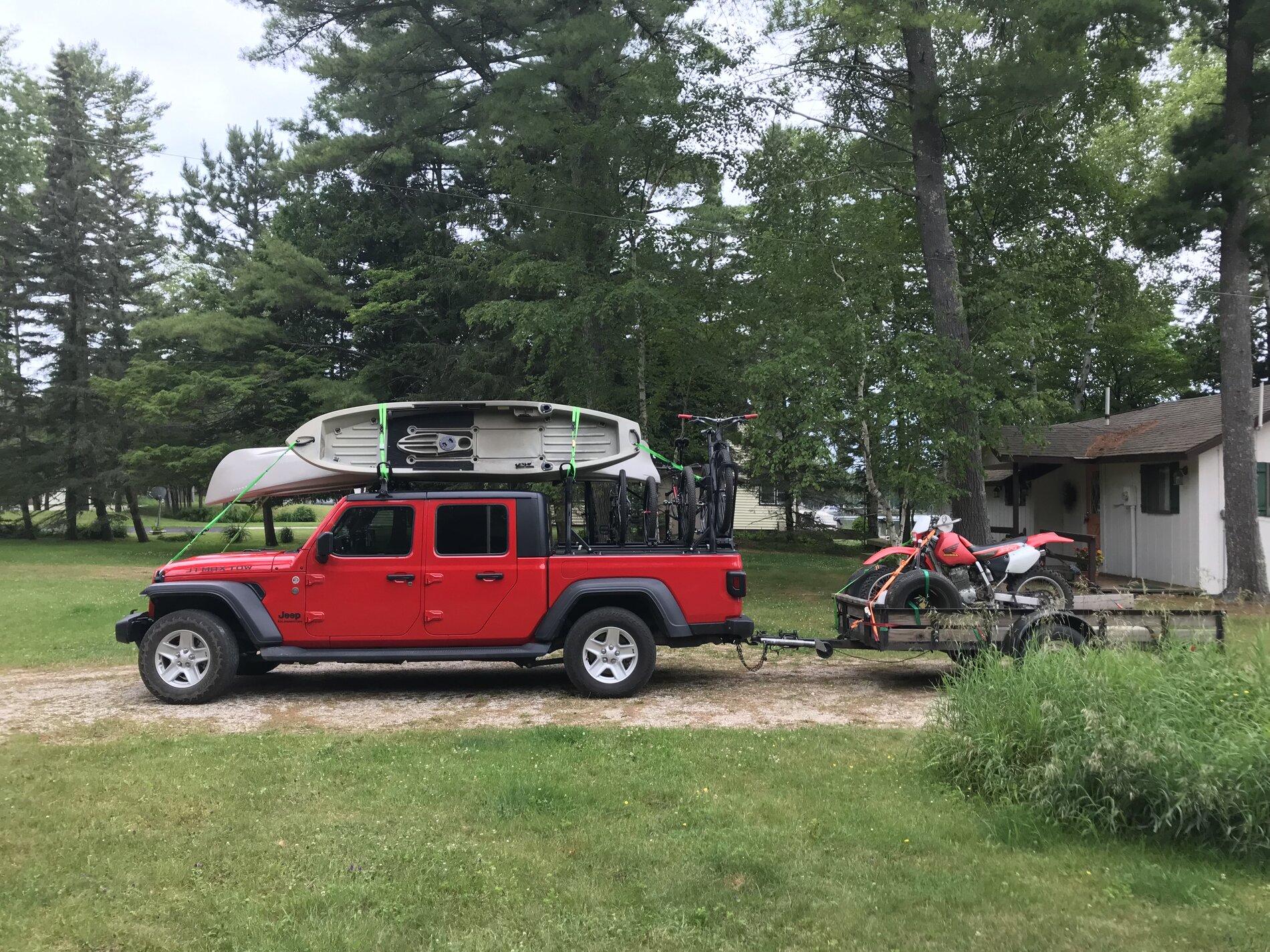

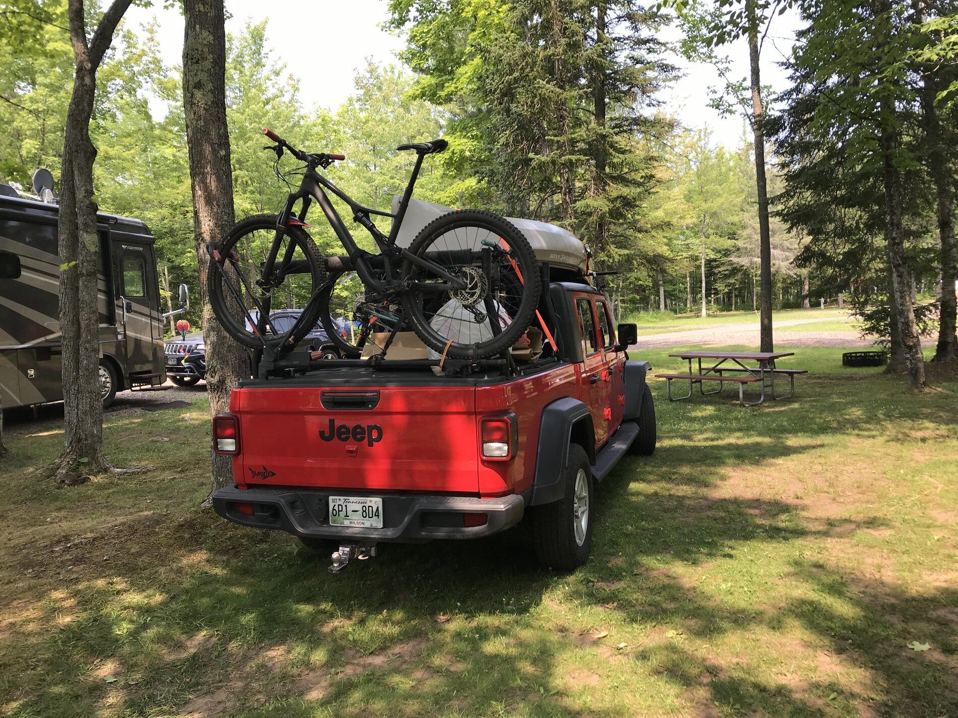

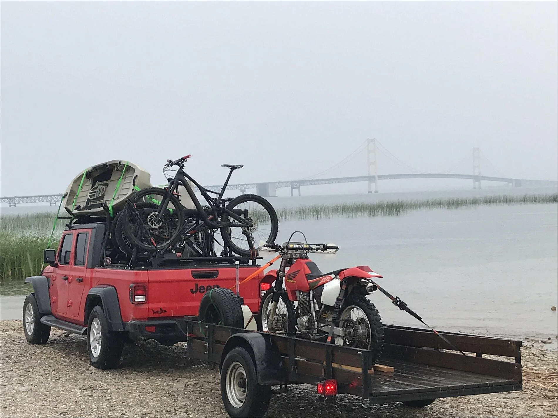

I will change my set up maybe this winter, but still the old COVID bored out of my mind with parts laying around set up made another 2000+ mile round trip. I get questions and compliments on it from JT owners all the time. It just works.

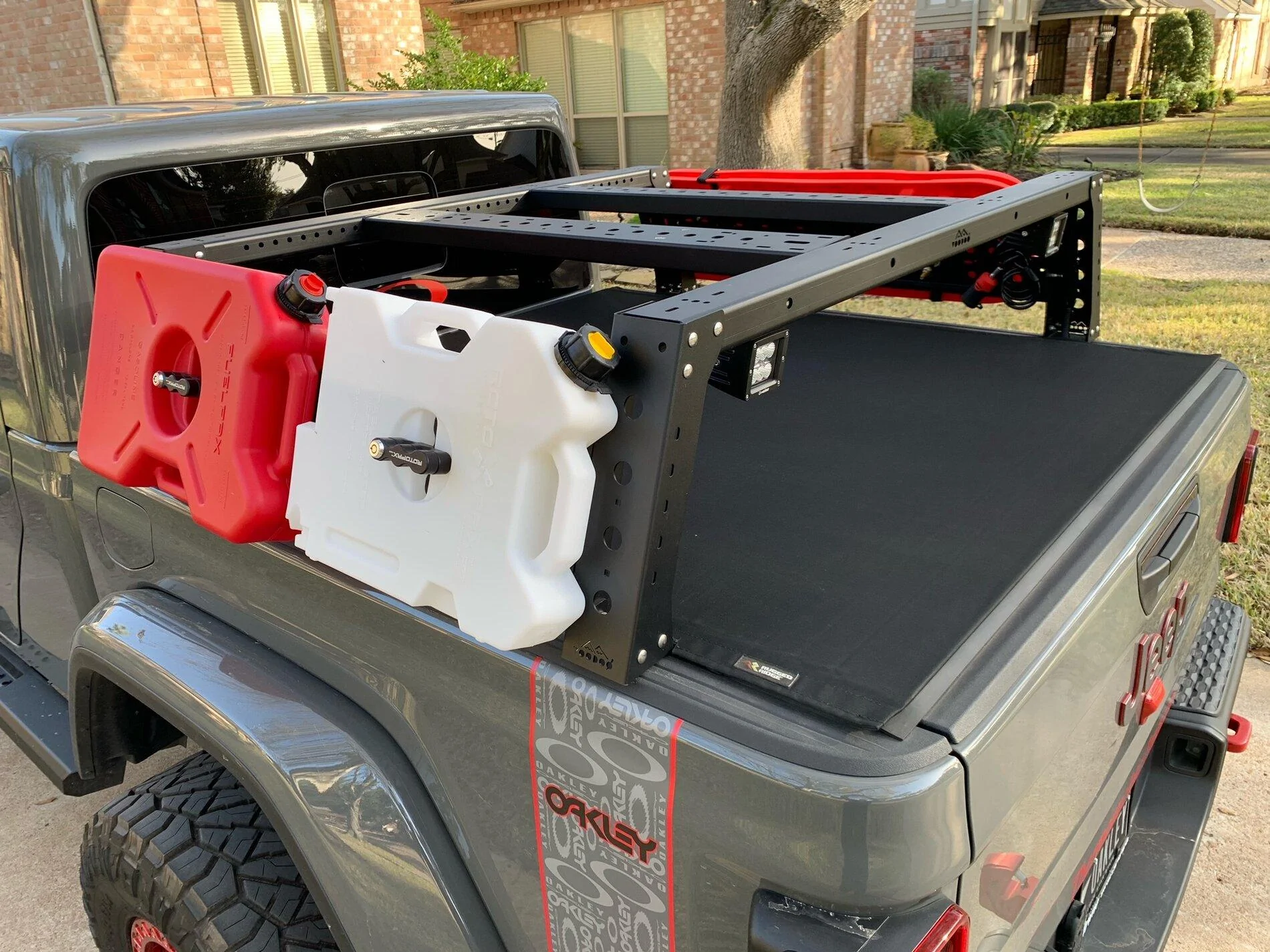

So I'm looking for some opinions. I want to get a Max Modular rack, probably the 14" tall version. I want to be able to have a tonneau cover that I can open even when the rack is installed. I see that Mox Modular offers tonneau brackets but would I need them for a tonneau like a Truxedo Low Pro that is mounted entirely inboard of the bed rails? I contacted Mox Modular but all the advice they could offer was to purchase a test bracket, which doesn't really help as I haven't selected a tonneau cover yet.
I prefer the look of the rack without the brackets. I am not opposed to the brackets if they are required to make the setup functional.
We came across a customer photo of our 14" Gladiator Max with a Rugged Ridge tonneau cover and this guy has it installed with our standard attachment clips. If you look closely, it appear is did some minor trimming of the cover around the legs of the rack.

Thanks! For me, your 14" rack is perfect. Based on my research I think it may work with an Access Literider cover without Tonneau brackets or trimming. Worst case would be some minor trimming like in your photo. Just have to sell my Diamondback....

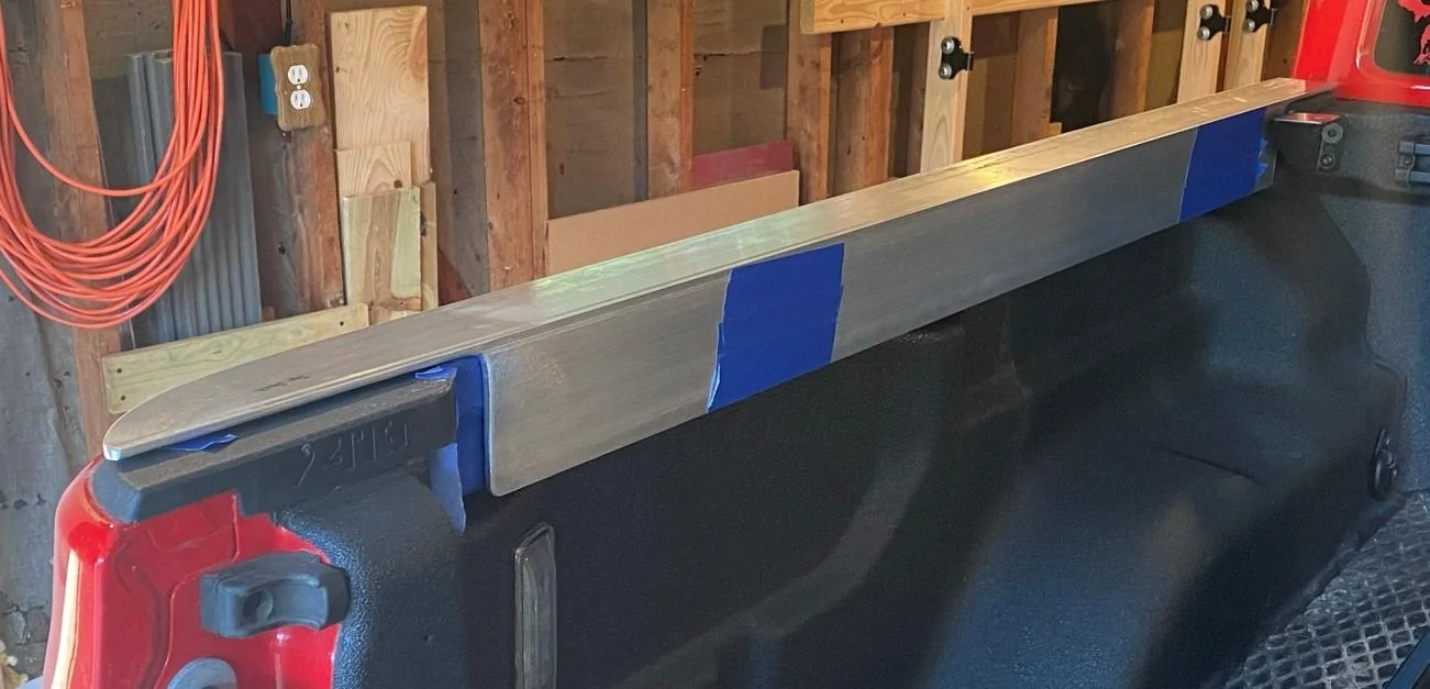

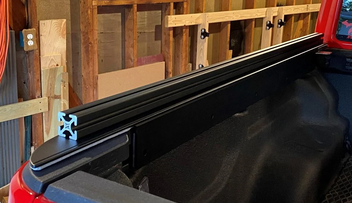

I was able to to build a custom rack using mostly 80/20 that would allow me to still roll up my Truxedo LoPro Tonneau. There are 2 custom fabricated parts, one on each bed rail, but the rest is standard parts bolted together.
No drilling or modification required to the Jeep and the rack can be removed without removing the Tonneau Cover.
Only tools required are a jigs saw, sander and a drill press for machining the bed rail caps.
Can you share pics of how the fabricated bed rails mount to the OEM trail rail?

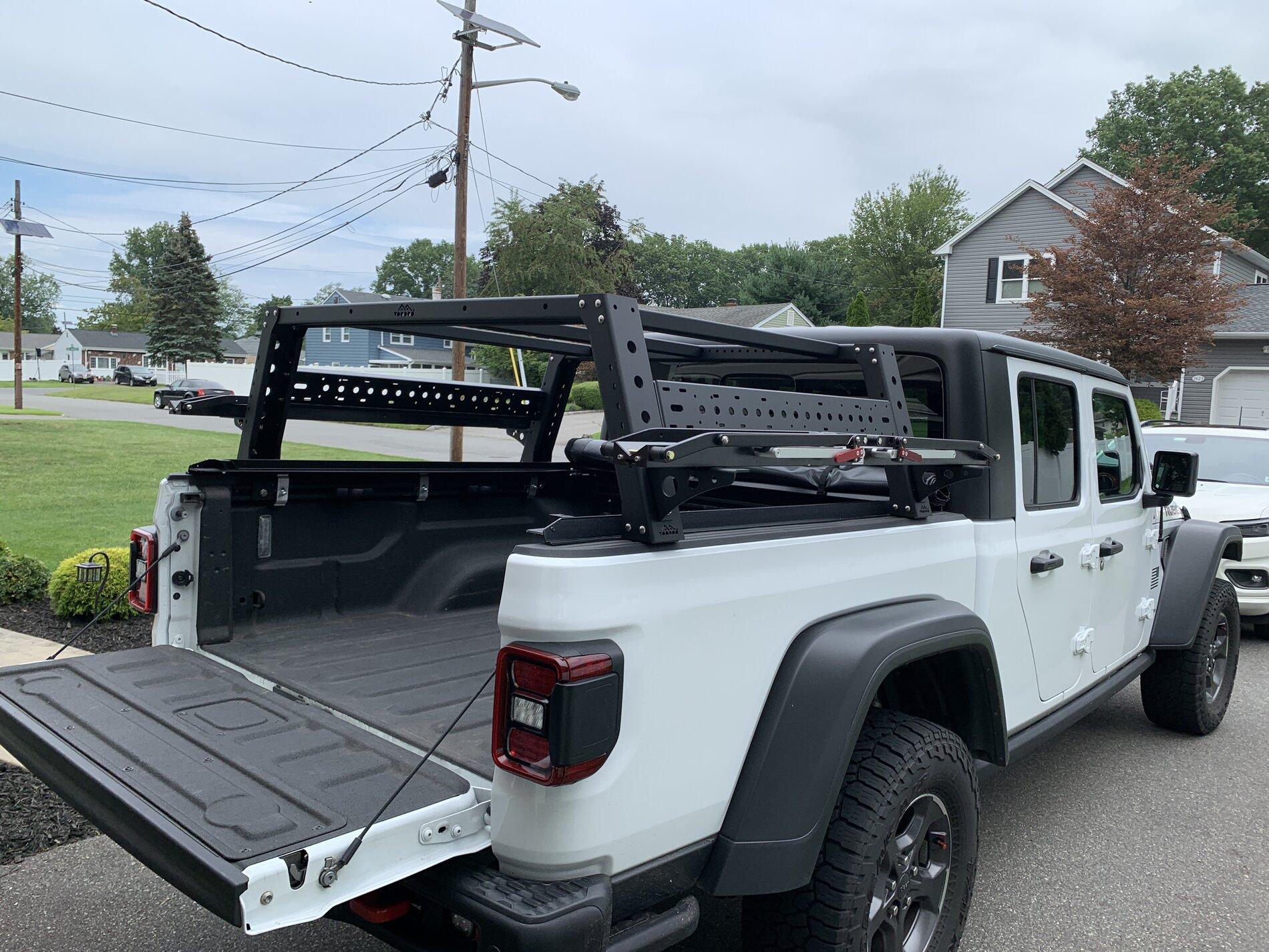

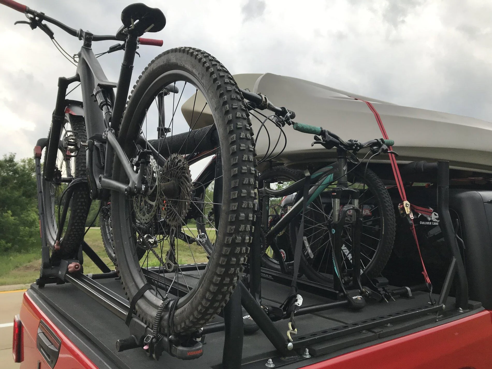

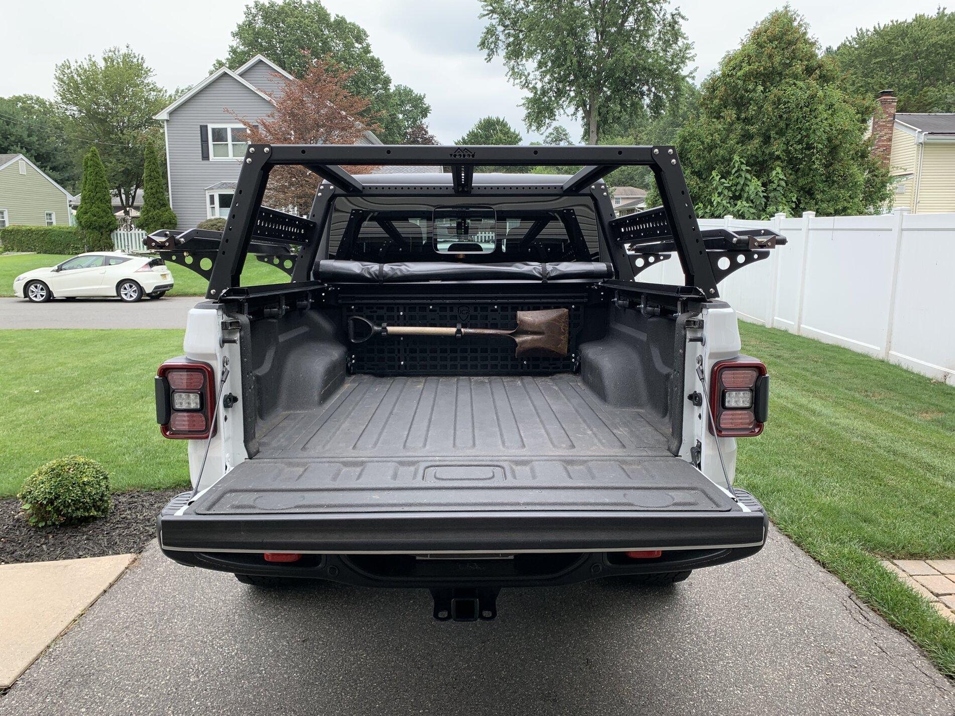

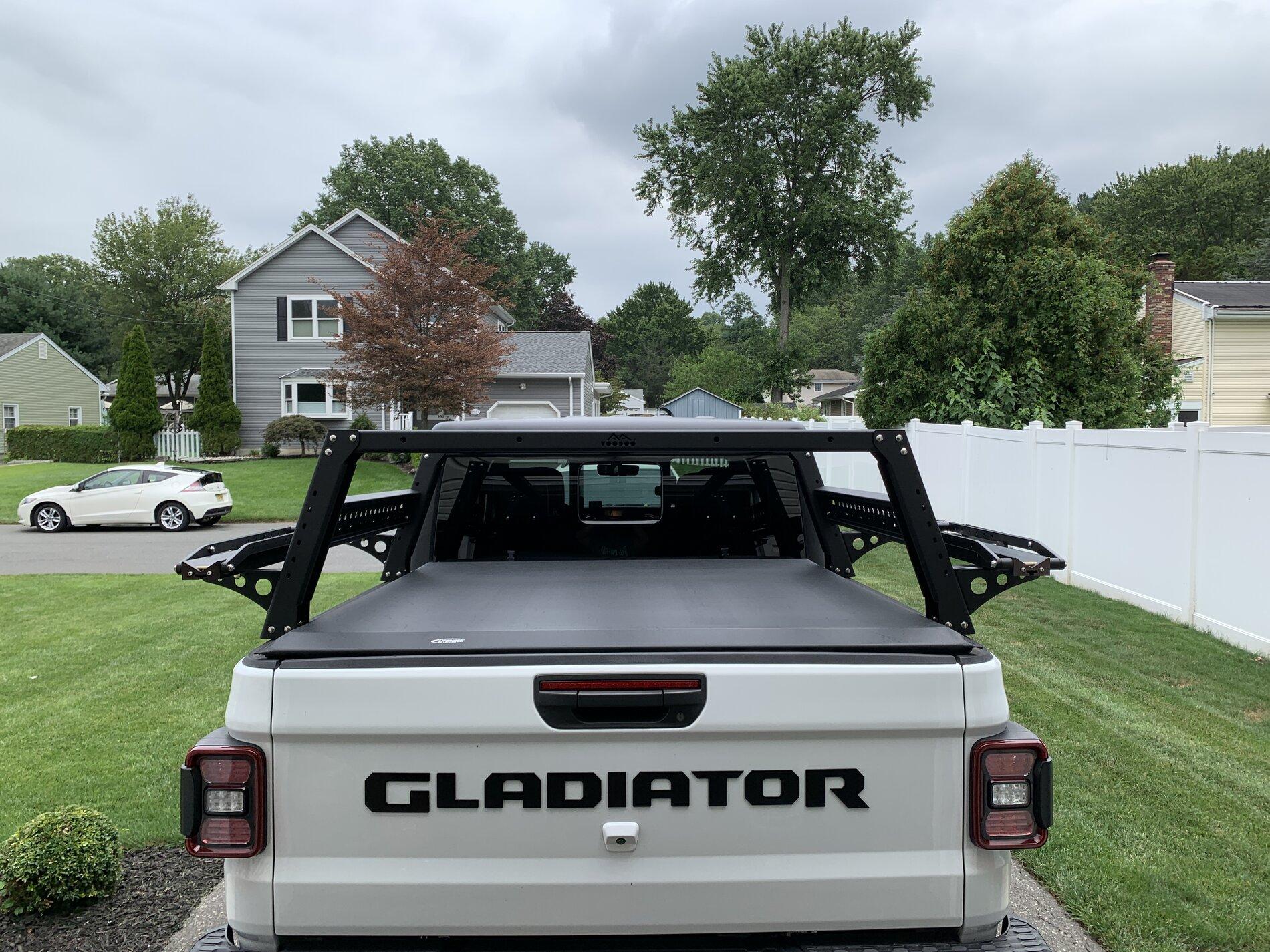

UPDATE:

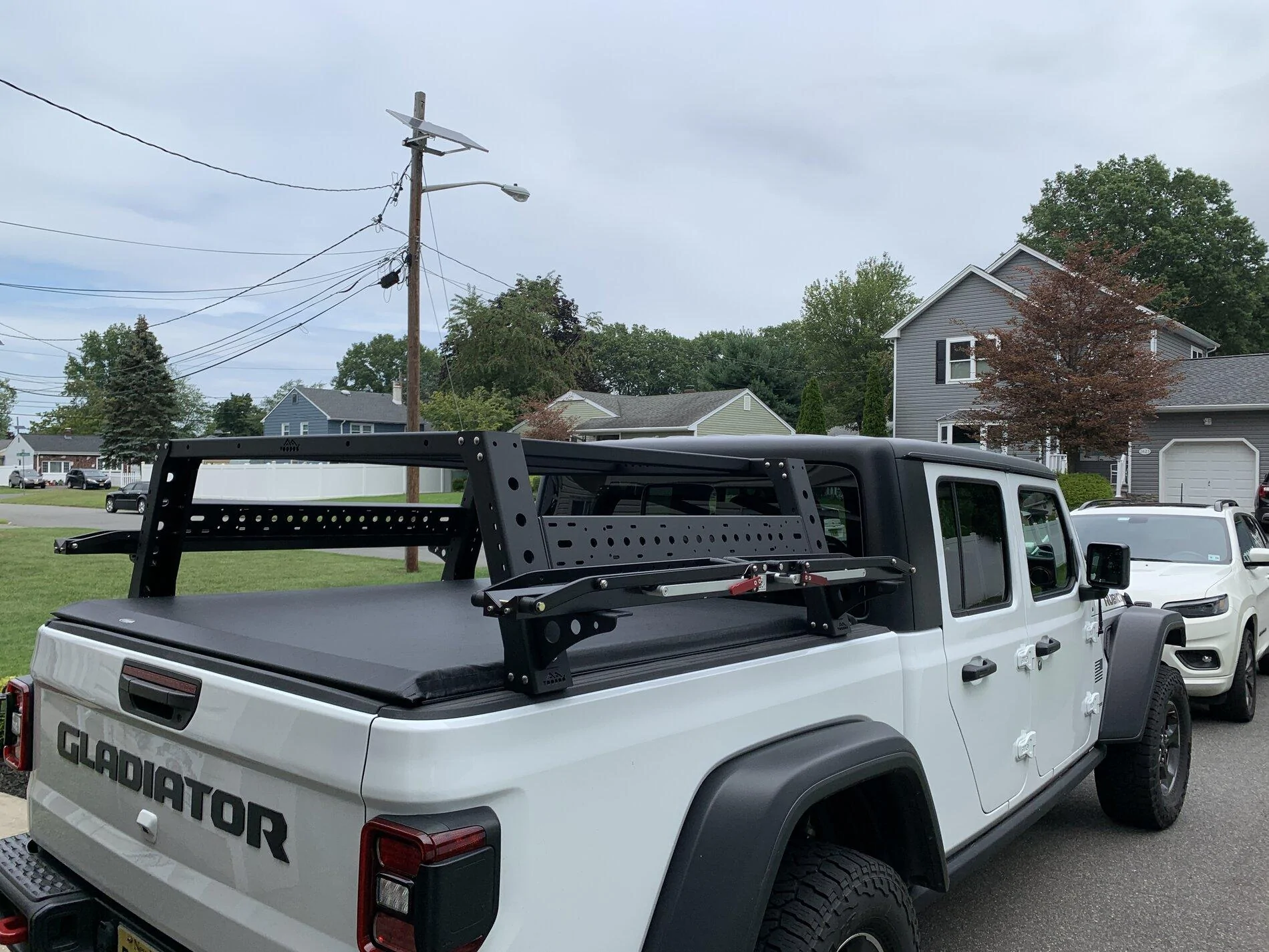

I previously had a Doamondback SE on my Jeep with Front Runner load bars. The cover was awesome. Hands down the most secure and overbuilt cover I’ve ever seen. I can only imagine how stout the HD version is. Anyway, I primarily carry bikes and skis. I tried various strategies in mounting the bike trays (1-up USA as I despise removing my front wheel) and ski carriers to retain as much access to the bed as possible but I never came up with a great solution. I pretty much lost access to the top of the bed unless I took the bike trays off. While removing the Diamondback is pretty easy, it can’t be done spontaneously. One must plan whether or not to remove the cover in advance of needing to do so.
So I changed things up and got a @Max Modular 18” rack and paired it with an Access Literider soft tonneau. I am very happy with how it all turned out. I took a chance that I would not need the tonneau brackets for the rack and I lucked out. I can roll the cover all the way to the cab with the rack on allowing full access to the bed for large items. I can carry my bikes. In the winter I will also be able to carry my skis on the top. All while having the ability to access the full bed or close the cover to keep things dry or out of sight. Obviously the tradeoff is security but I am ok with that in the way I use my truck. I can also put my shovel, hi-lifft, some traction boards, awning, and a DIY waterport on this thing all while maintaining full visibility out the back window. I don’t have a RTT nor do I see one in my future so I should be able to do all the above and keep the weight very reasonable.

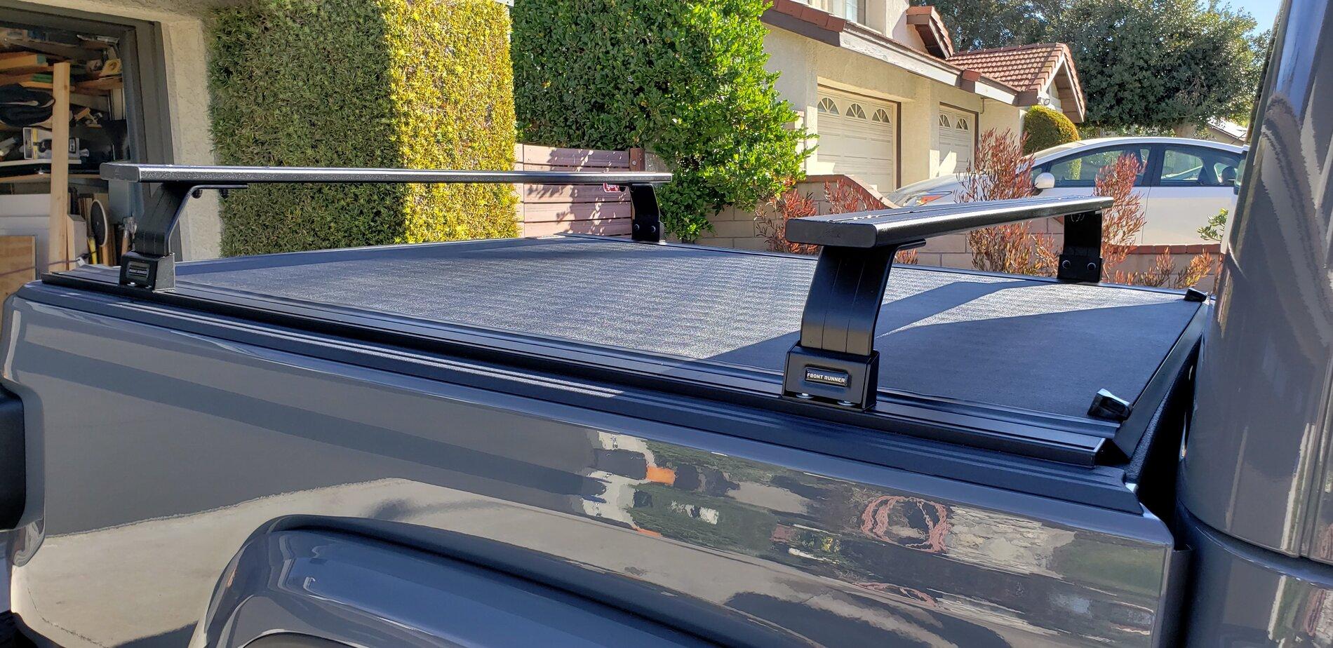

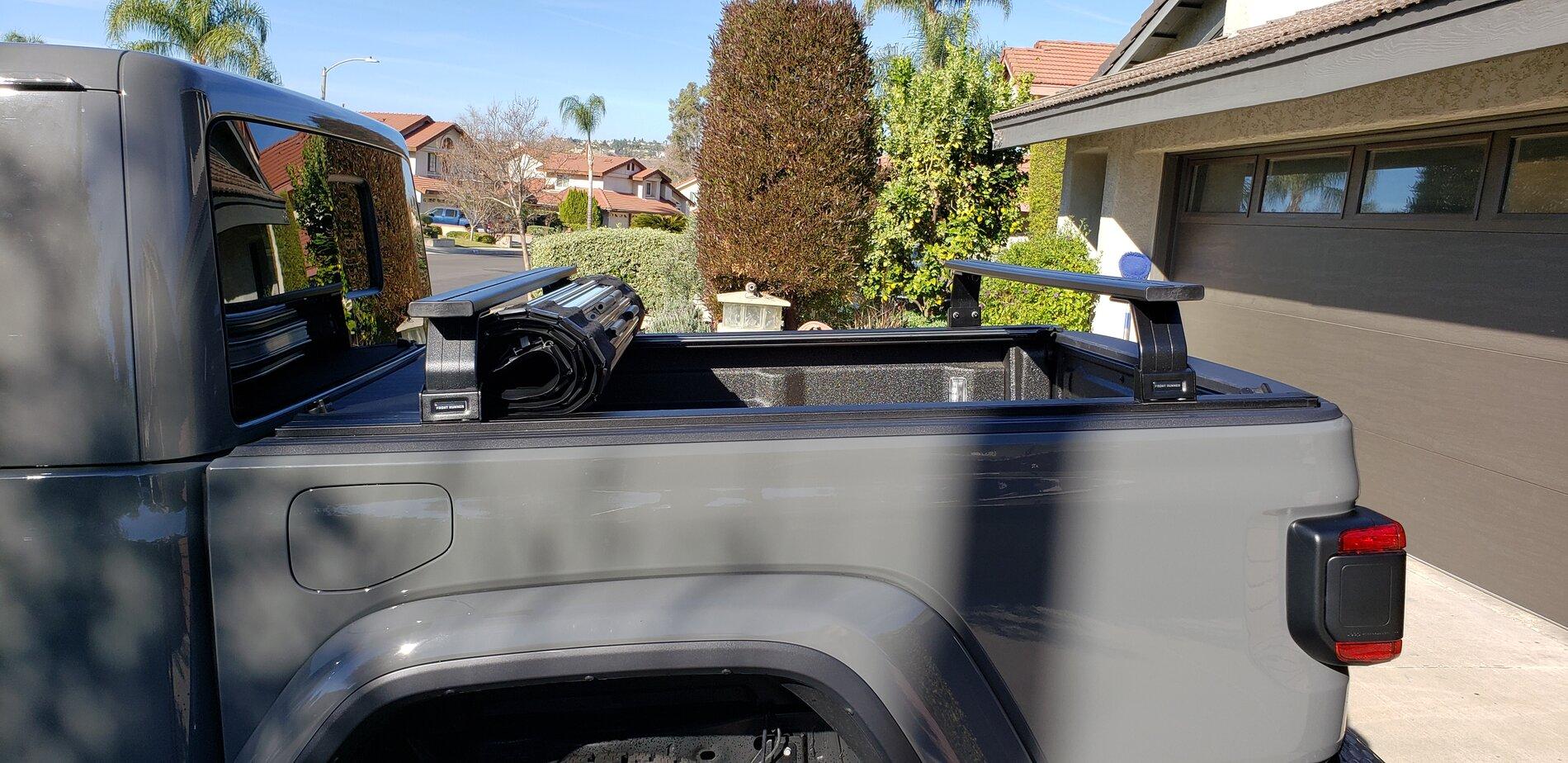

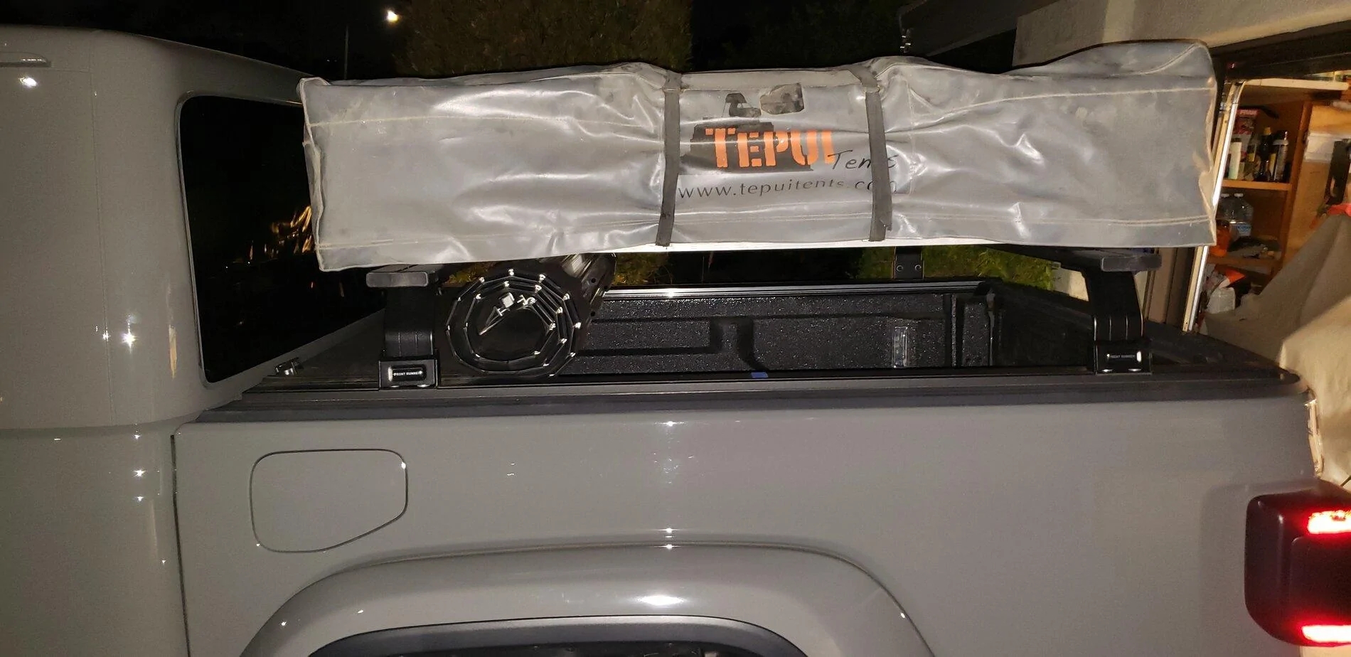

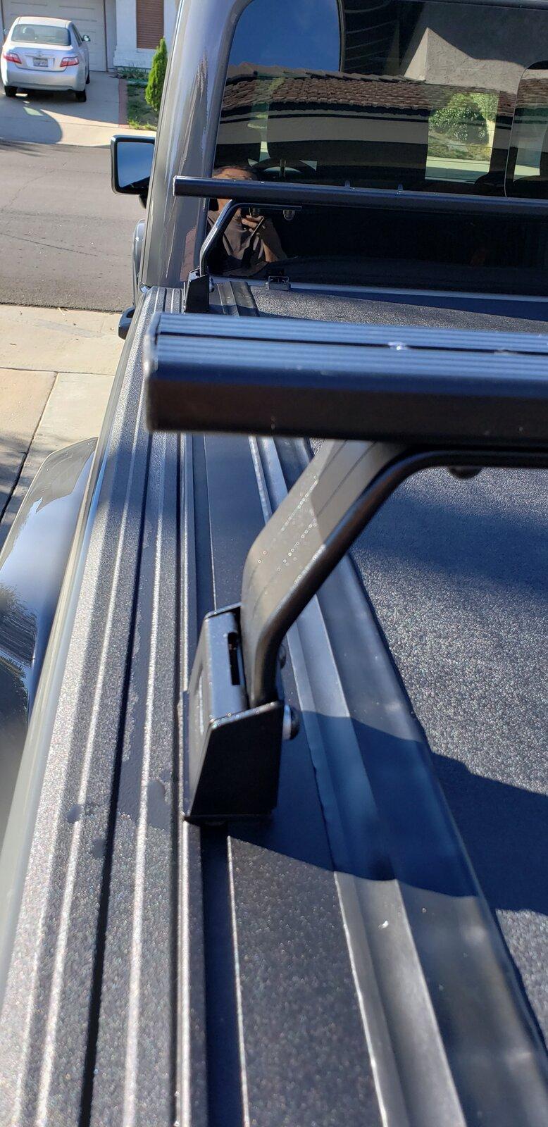

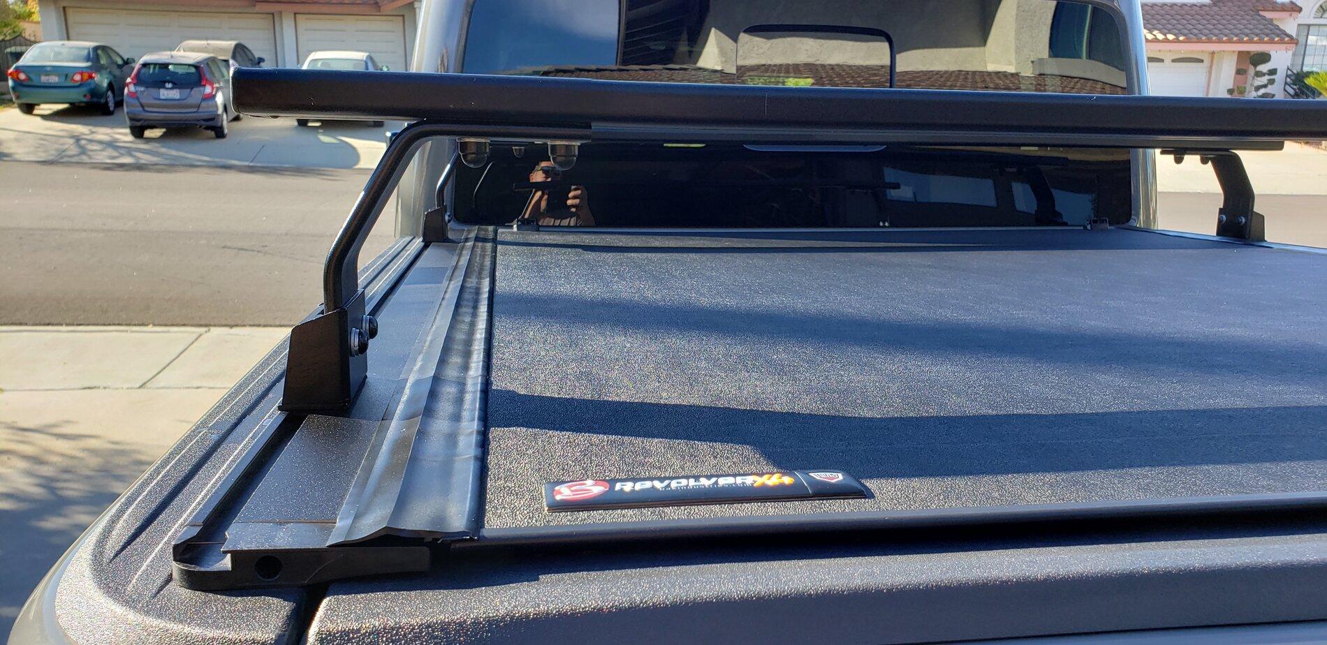

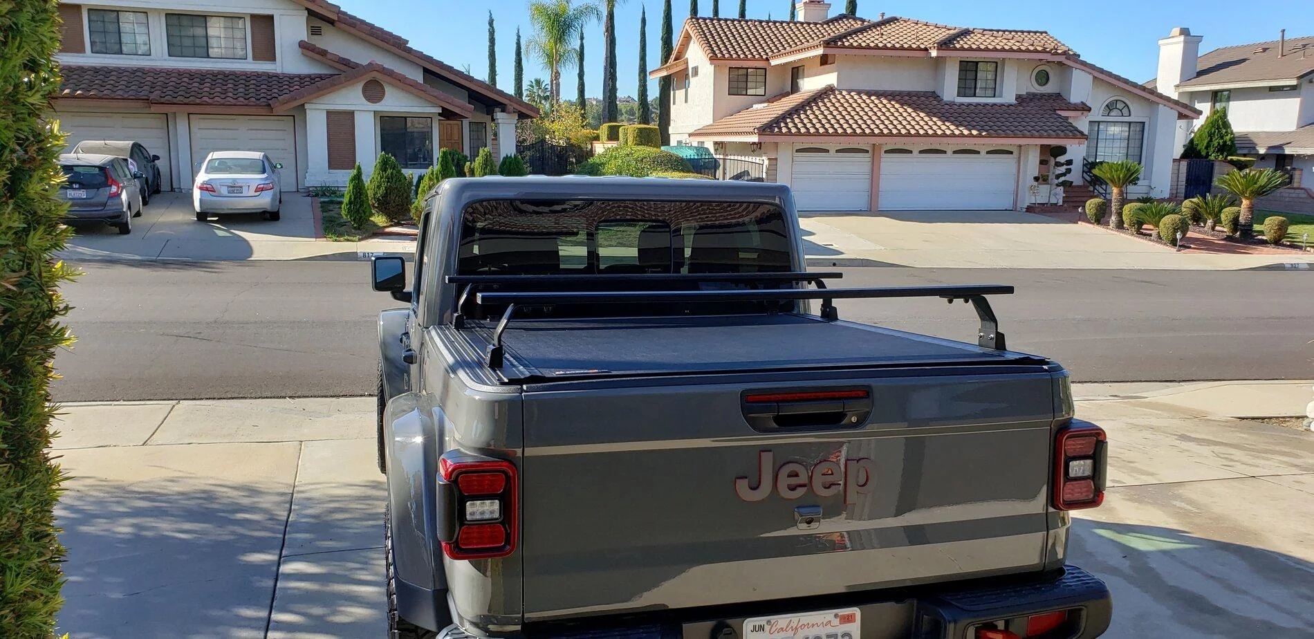

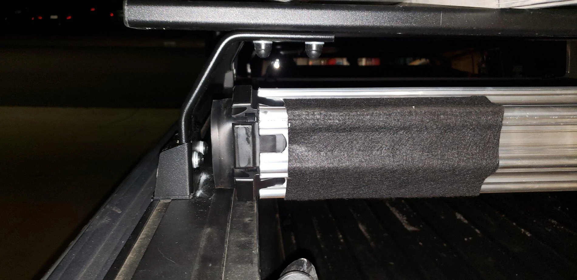

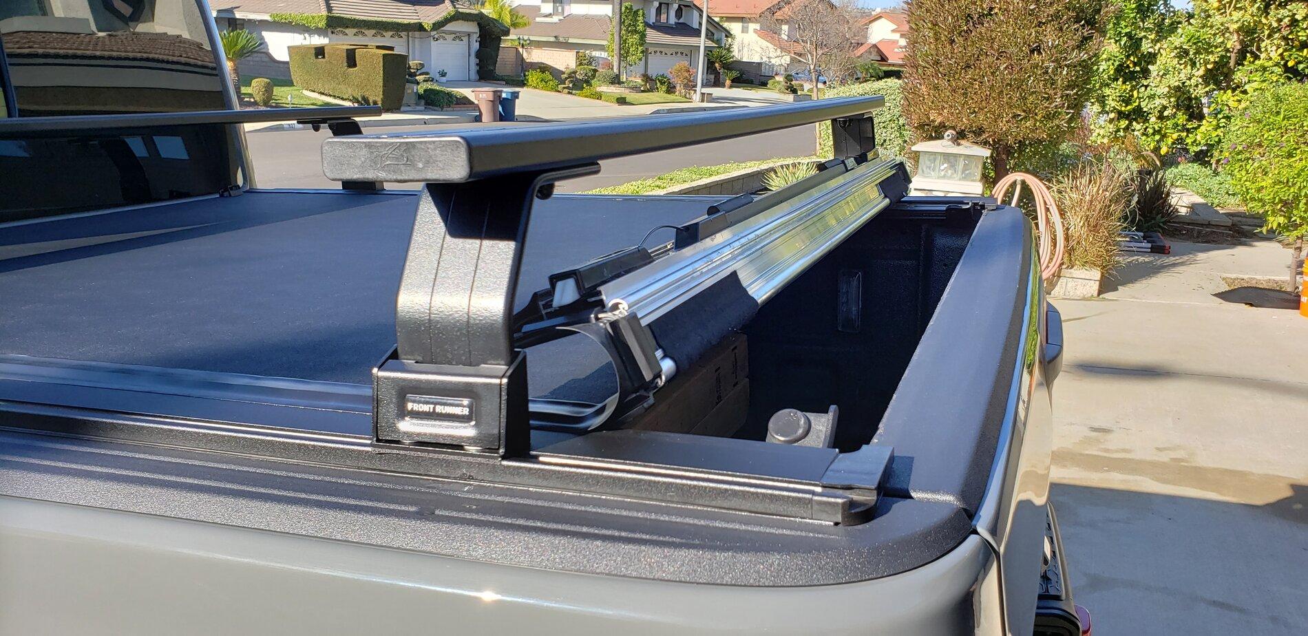

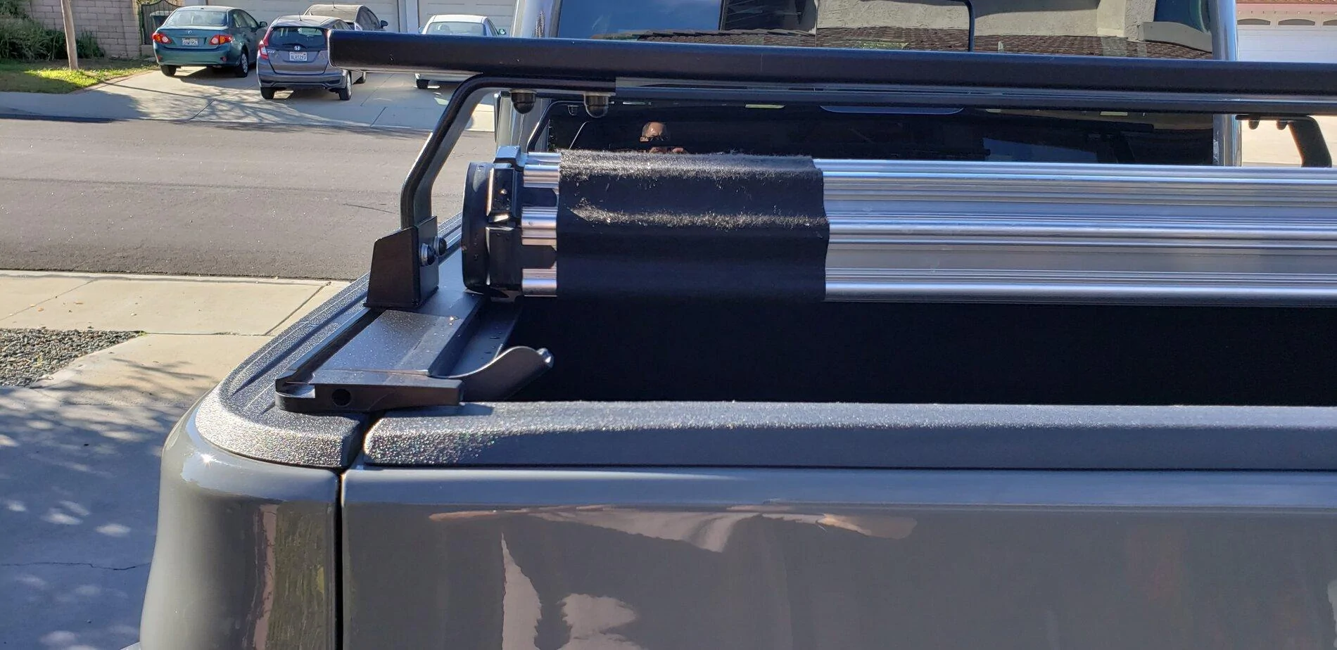

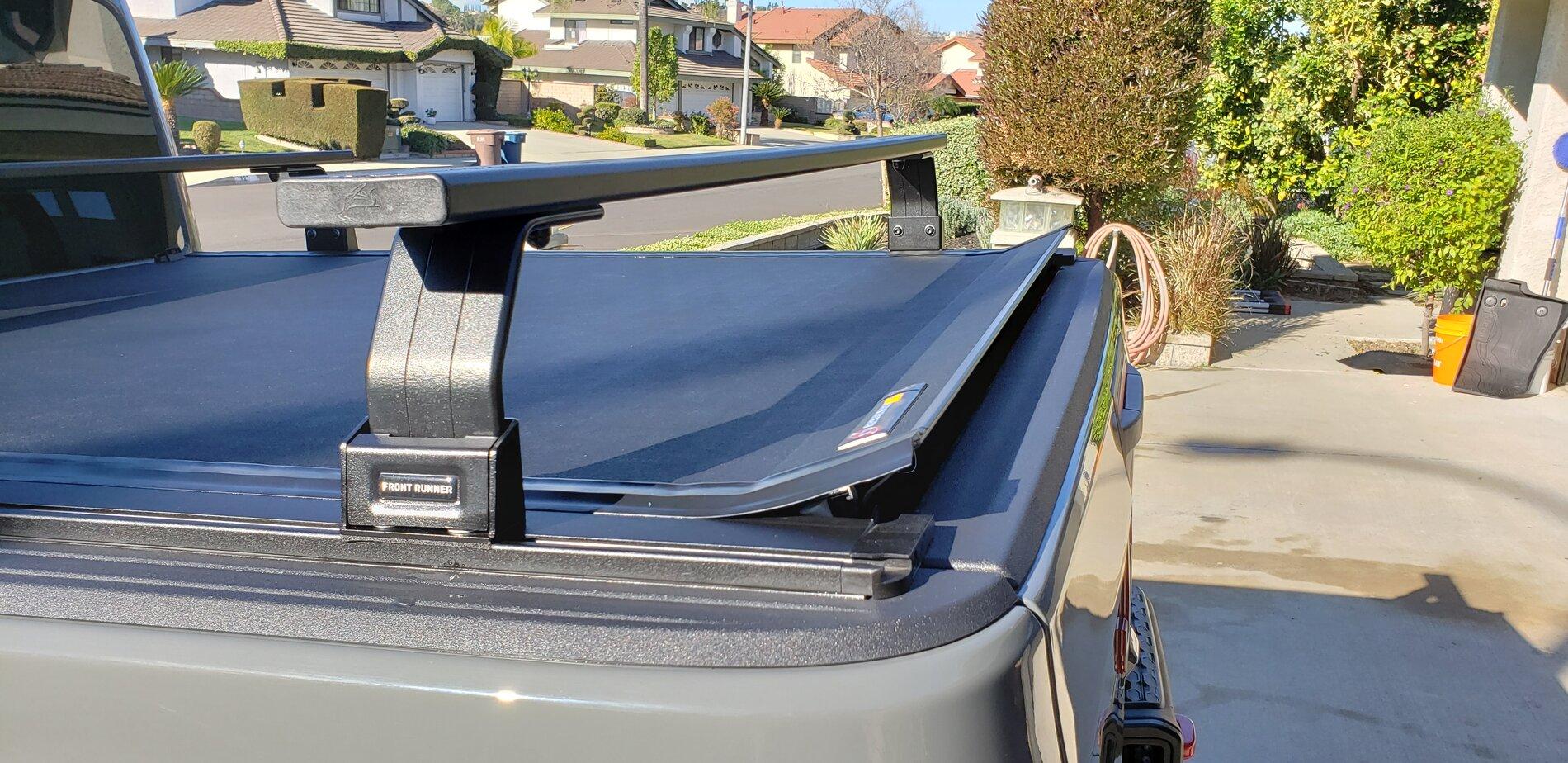

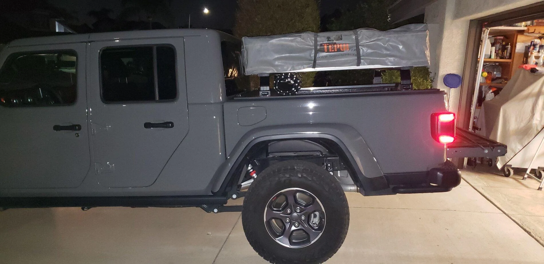

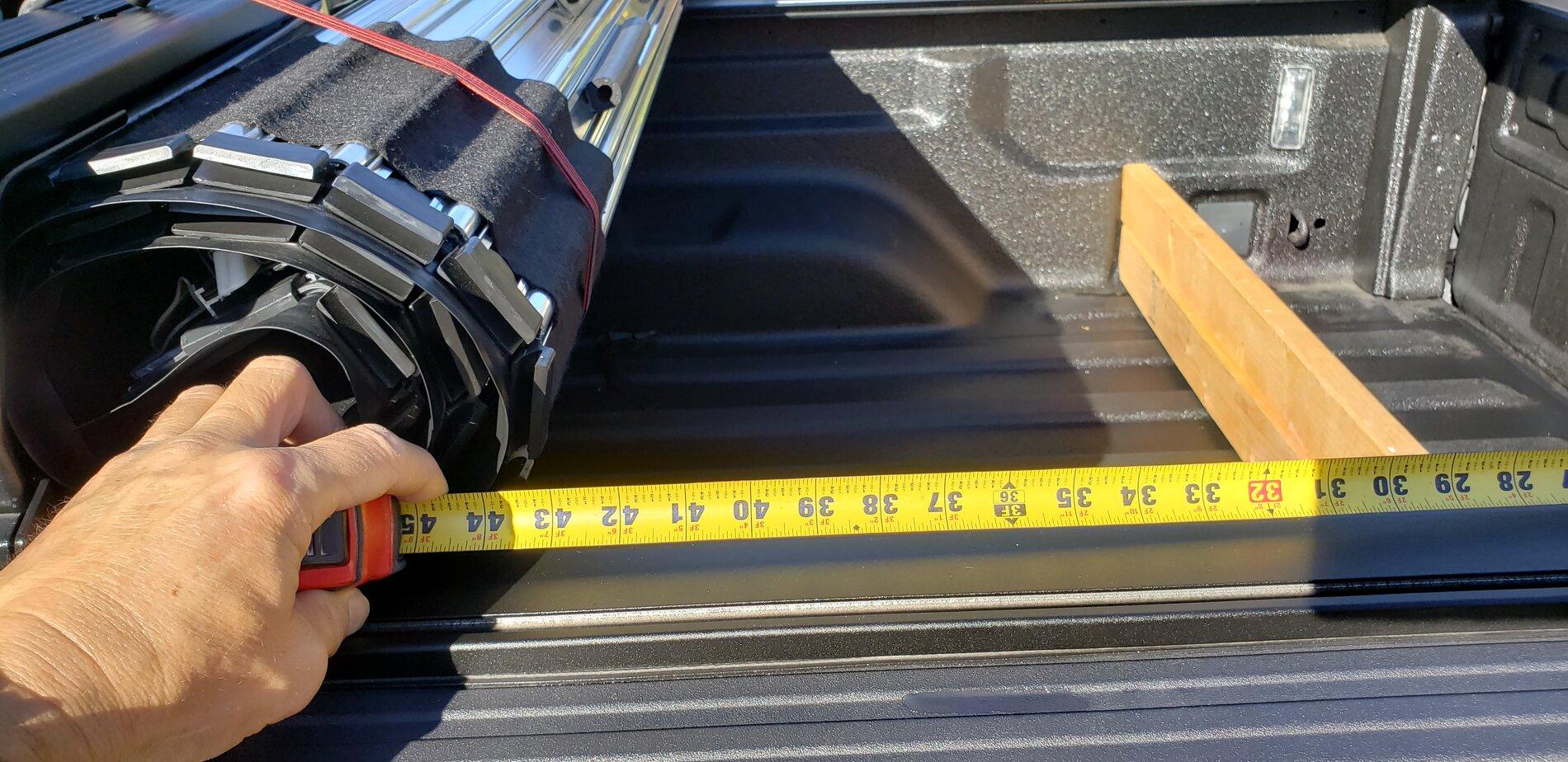

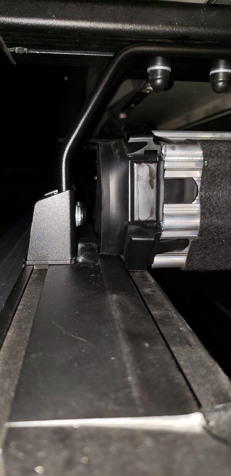

Bottom line, these FrontRunner crossbars with the short legs and Tee Slot mounting feet work "Perfectly" with my Bak Revolver X4 hard rolling tonneau. Okay, nothing is perfect - the X4 doesn't open all of the way, but it works as well as I was hoping.
I liked the look of the FrontRunner rack kit for the Raptor with the Retrax XR retractable tonneau. The Retrax XR, like the X4, comes with a built in Tee slot. Originally, I planned to order the longer legs (about 7.6") for my crossbars. When I found out that the Tee slot mounting plates were only available packaged with the shorter legs (6"), I decided to try out the shorter legs first and then place a 2nd order for the longer legs if I felt I needed them.
Turns out, the shorter legs do just what I need them to do. When you start rolling the X4, it is such a small roll, that it easily clears the rear crossbar with the shorter legs. The roll grows as you move it forward and will not go under the front crossbar. When we test fit the longer legs, the X4 still didn't clear the front crossbar - so I'm pretty sure that I will not be ordering the longer legs.
I only have the 2 crossbars. After mounting them, they seemed very secure with no slop. I put a piece of Armaflex rubber tape under each foot to help prevent scratching (if I decided to relocate the feet) and also to provide a bit of traction in case the roof top tent wanted to move forward (into the rear window) upon hard braking or a collision.
I'm not sure if you can just order a set of crossbars that will come with the Tee slot mounting feet from their website. If you have trouble finding what you need, try calling Front Runner customer service and ask for Farinn. I'm sure they have plenty of reps who can help you, but I am really impressed with how well she was able to talk with their engineering department and get me accurate answers to all of the questions I had.
Here are some pics -
How has this held up with the RTT on it? any issues with it moving or messing up the alignment on the cover? I am working with FR and about to order the same setup. Do you know the length of your crossbars? I asked for 58" (1475mm)
