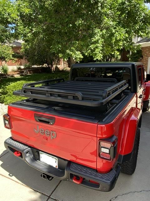

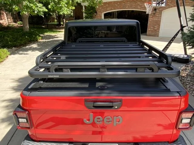

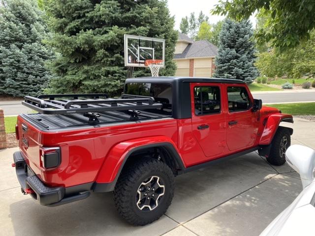

That is the setup I have. Truck Covers USA hard roll cover, Yakima skyline towers, HD crossbars, Yakima LocknLoad platform. The cover does open with the rack installed. Love the setup with a lockable secure cover and the added cargo capacity of the rack. It is expensive, but seems high quality and durable.
I'll get some pics if interested.

Yes, please. Would love to see it!

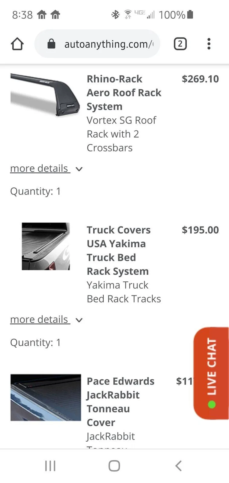

I am looking at this setup but am getting conflicting
Yes, would love to see your setup. This is what I am currently looking at but am getting conflicting info on fittment.
Jeep Gladiator Bed cover with rack Screenshot_20200622-083859_Chrome

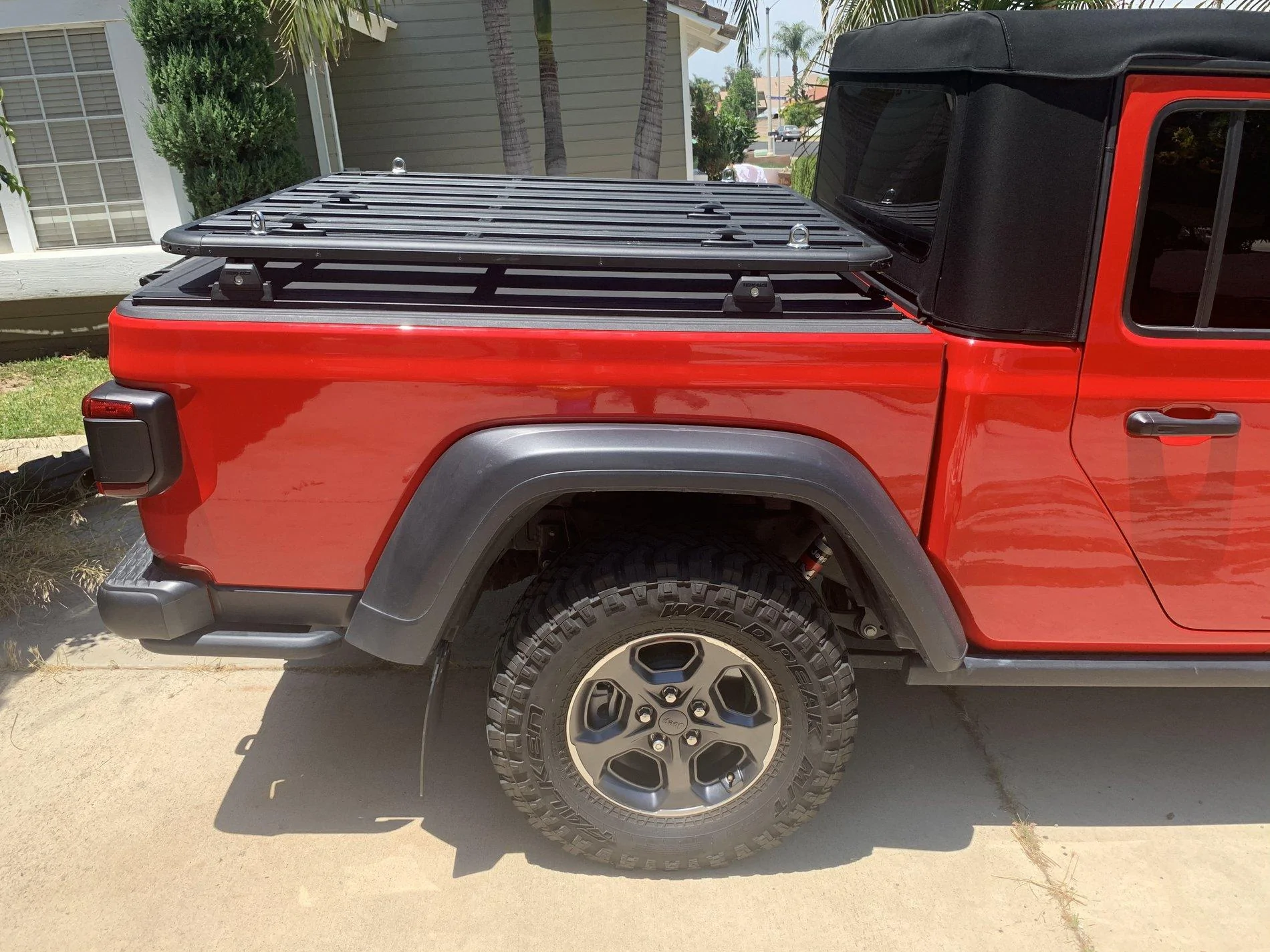

The feet for those cross bars will not attach, you need something like the rlt-600 for it to be designed for t-slot track systems. Rhino rack had another cheaper foot that will work but isn’t quick disconnect, however now that I have the 600’s, it’s worth the price!

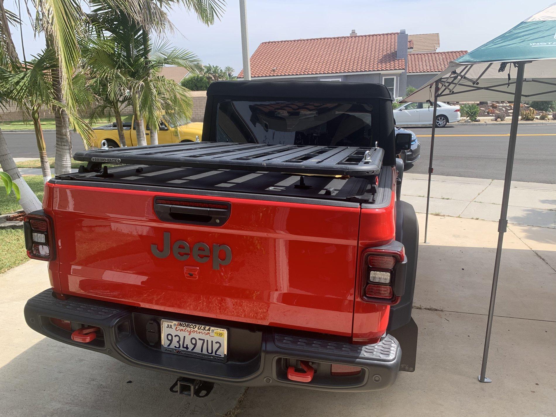

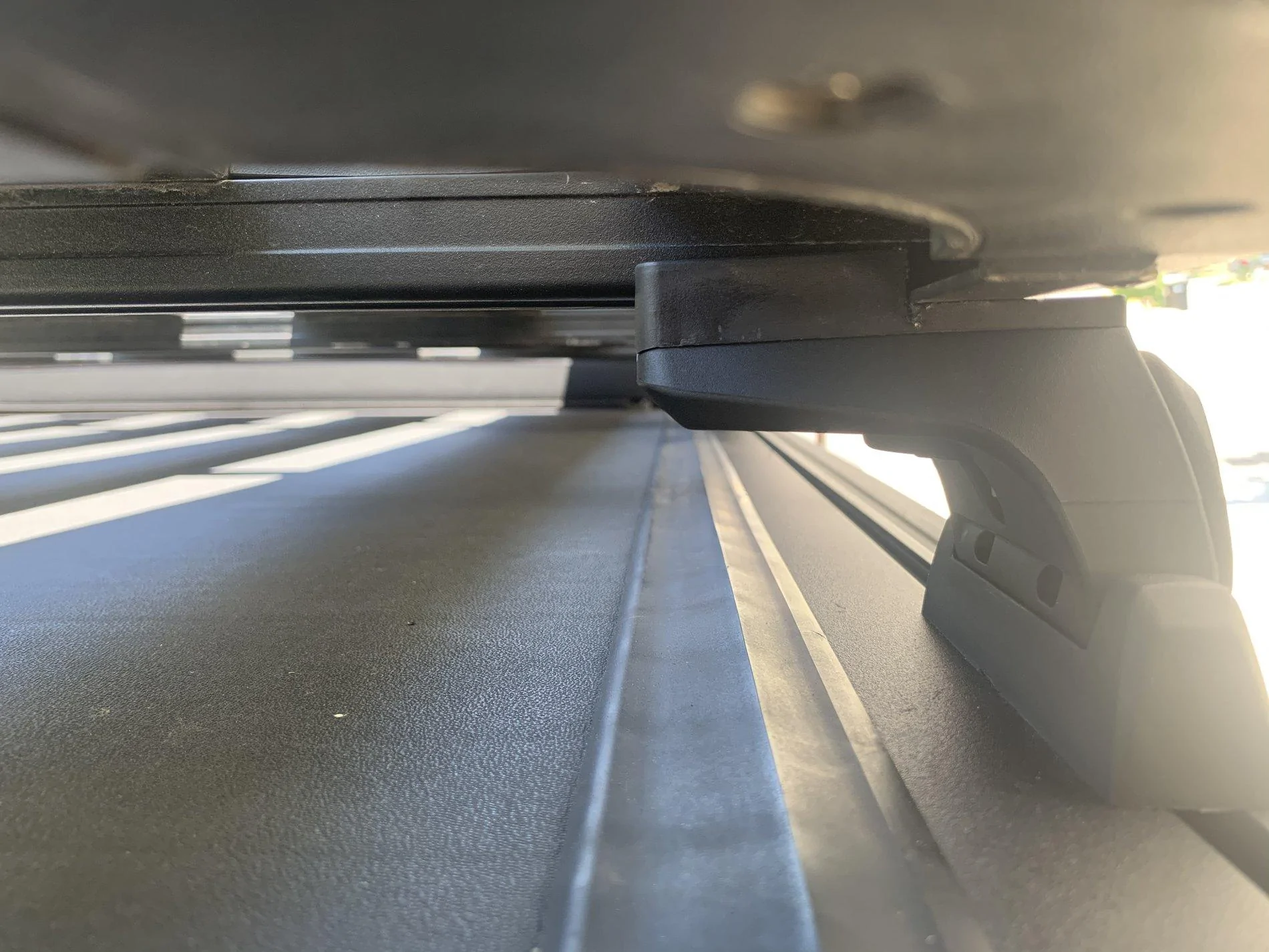

I got the attachment adapters for the rlt600-pioneer in today. Due to the distance of the tracts I needed a little modification, but I’ve now got the rack attached directly to the feet, without the need of crossbars. It looks a lot cleaner, and I may order another set of feet so I have the option for rack or bars without any dismantling.

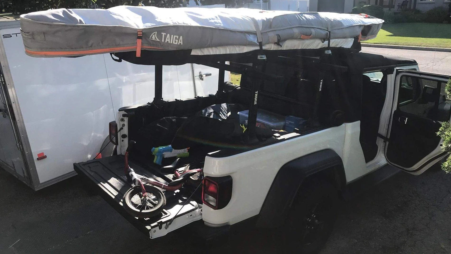

Jeep Gladiator Bed cover with rack 7E5EA0C2-5864-4BD5-A708-6B7FB754293A
Work in progress, Stock roll up bed cover is now at the seamstress for a customization that will allow me to put on or off the bed coverand cover the hole when the bed rack is not in used.
I still need to cut the bar to be able to drop it more in the bed!

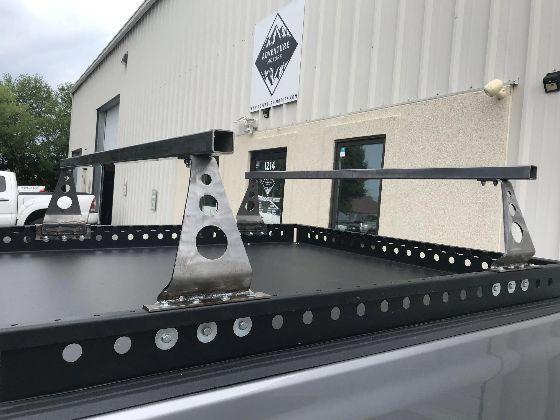

So I finally got my brackets fabricated for my Ace Upper Decker.
I still need to prime and paint the whole set-up (bars, towers, hardware), but here is a pic for now.
The Custom Camping Concepts towers (with cross bars)have been welded to a bracket that attaches into the Ace Upper Decker. Total overkill, but each bracket has 4 bolts on top going into the Decker, and 3 (with washers) in the side holes. It is not going anywhere.
When I reinstall, I will probably not even use all of the bolts - depends on how long it takes me to put them on and take them off!
Once I prime and paint, I'll be getting a Roof Top Tent for this, but I'd also be able to use a Roof basket, or anythign I want with those bars.
