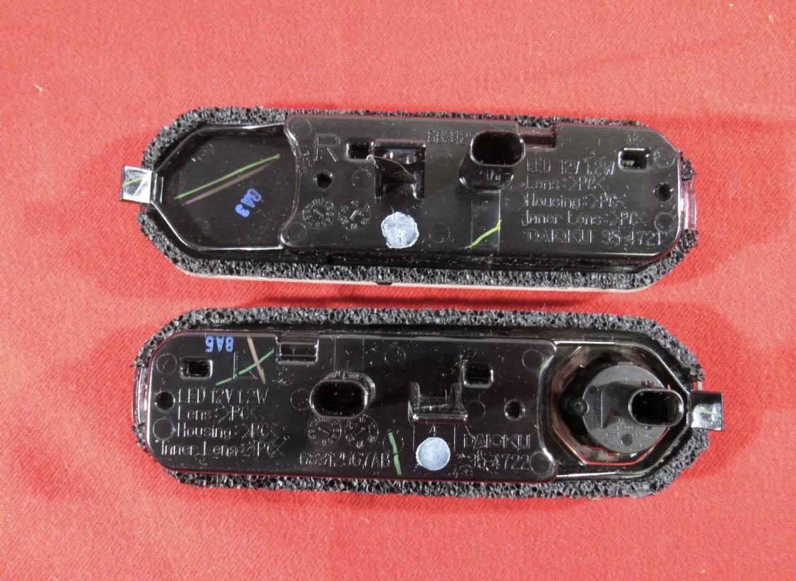

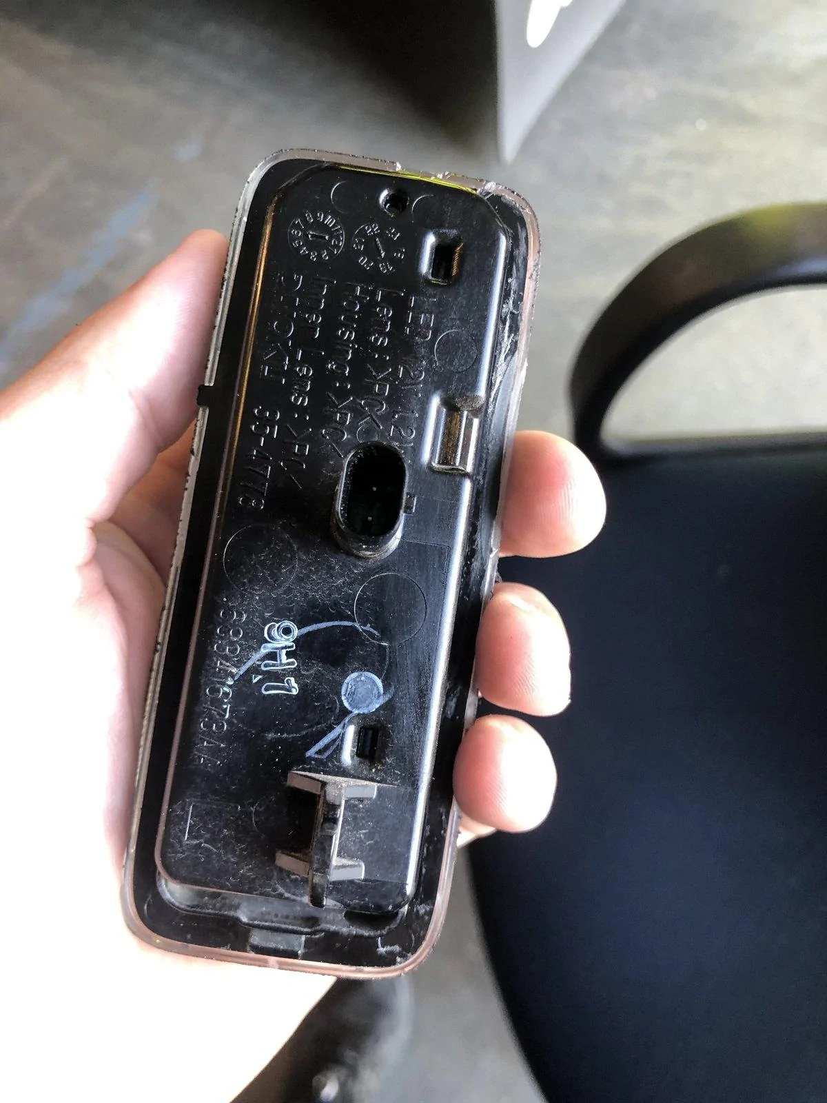

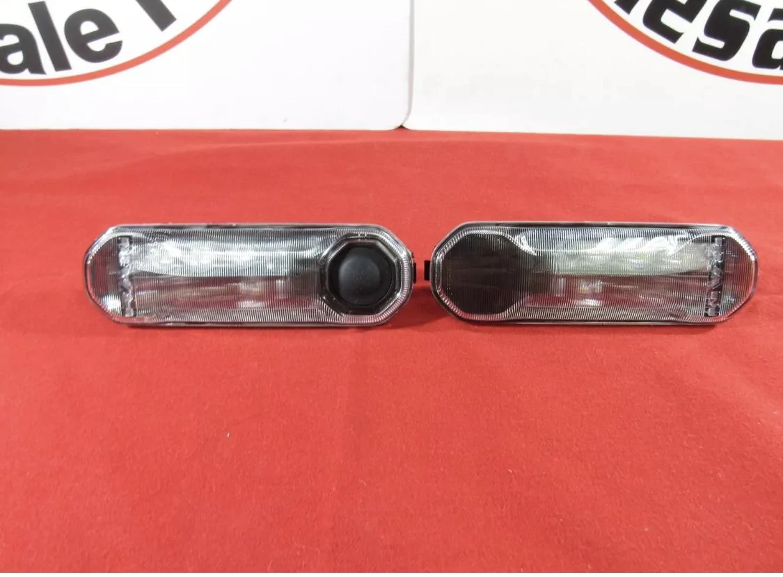

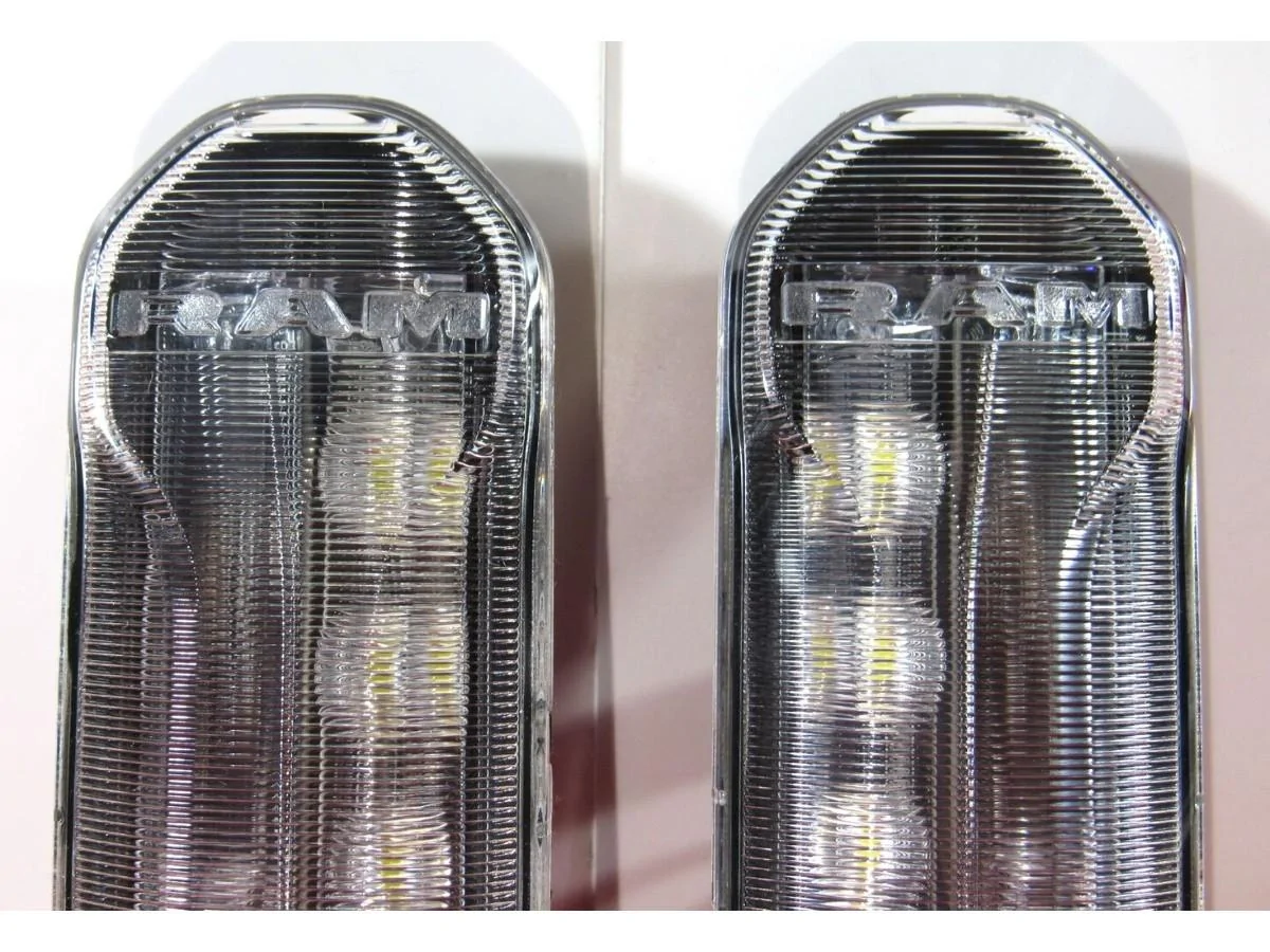

So noticed this was never finalized and no one actually did it. I'm guessing that's because the OP picture of "Oracles Gladiator" is actually just a picture of a Ram truck bed. I've been toying with the idea of using a Ram 2500-5500 bed light switch as it is separate from the light. The lights are strictly CAN controlled. Basically if the voltage drop created by pressing the bed lights button in the light control switch can be duplicated using the Ram bed light switch (or any CAN bus style switch that is mommentary for that matter) then, splice that into the Headlamp Switch Mux Circuit, then basiclly it would become a identical signal that the normal dash switch creates and would therefore turn the lights on and off with the exact system as the truck would normally see. Not exactlky easy and need a good Eletrical Guru to really make sure its done right then pass on the information.

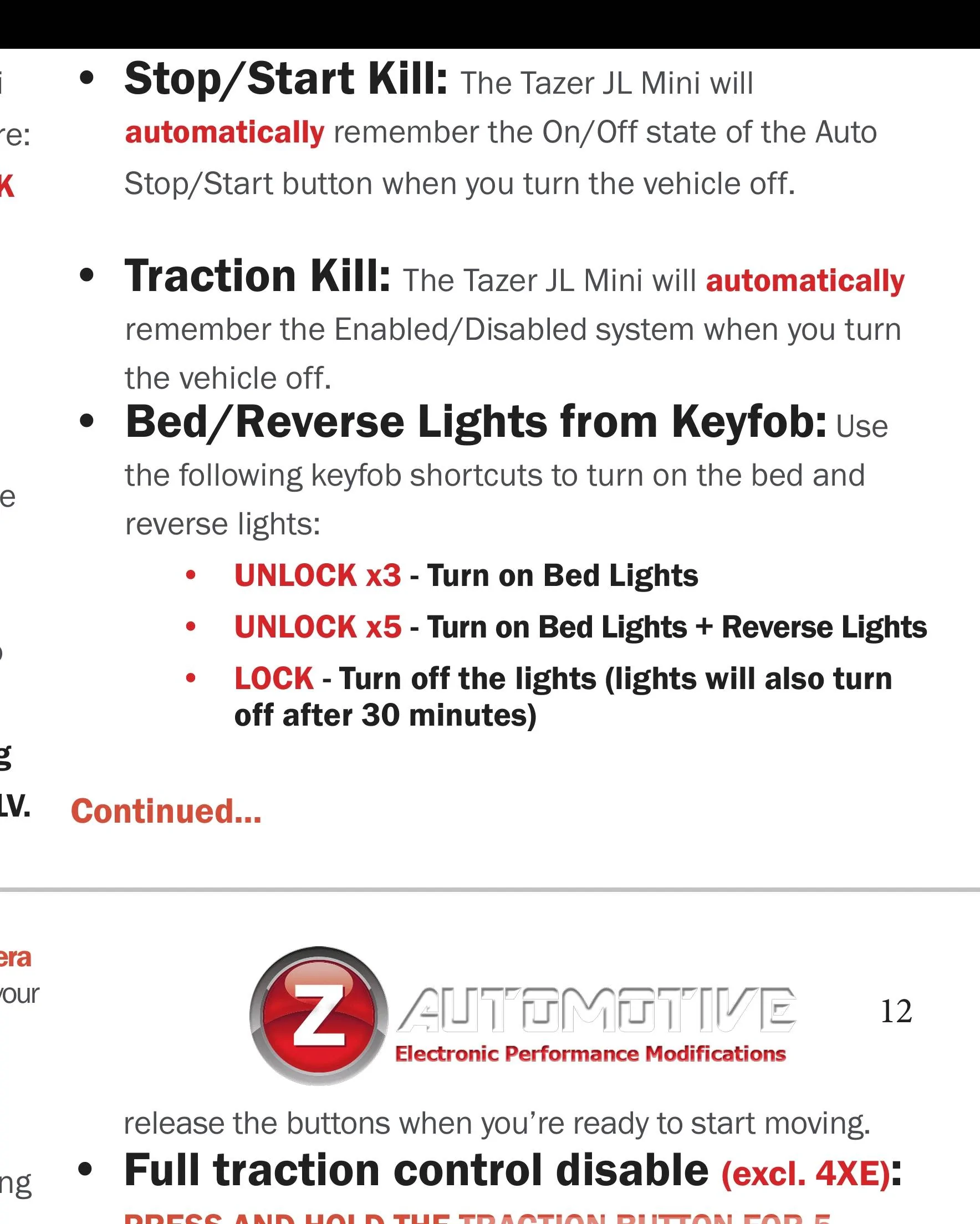

Well I ended up getting a tazer mini a couple weeks ago and you can control the bed lights with the keyfob. Here's the section of the instructions relating to bed lights:
Jeep Gladiator BED LIGHT BUTTON FIX!!!!! 1000004811
I haven't tested it out yet but It's really cool all of the things you can do with the tazer.

Yeah - its something but not really what I'd be looking for. Everyone wants to use whats there or have the same physical button the Ram had. I don't usually keep my keyfob on me when I am loading/unloading so that doesn't really do much for me. I wish they would just set up where you could adjust the length of time on the timer for the bed lights.
It is what it is - I think we all just live with it at this point.
