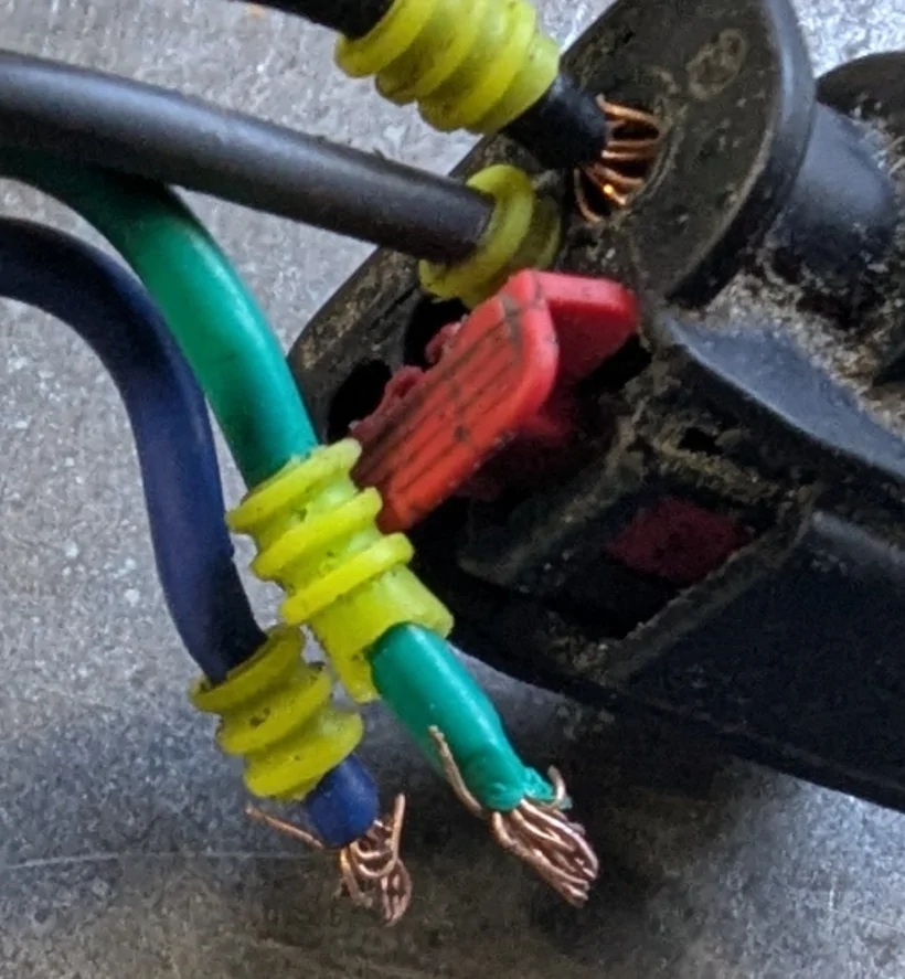

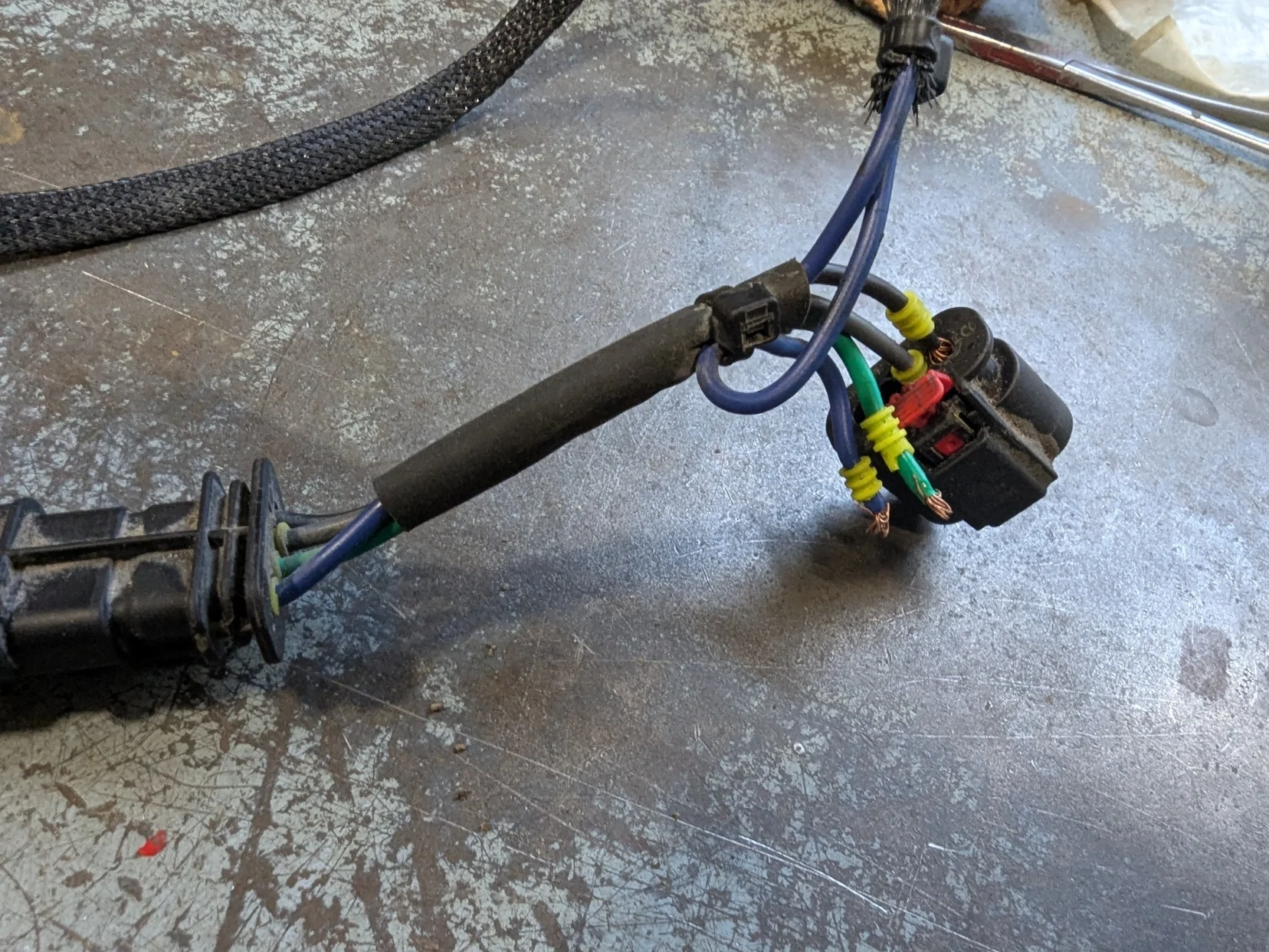

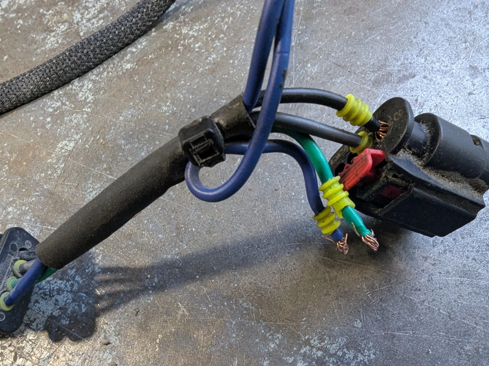

I have one of the eBay versions I ripped out of my 2022 and it's in a bag. Why? Because the wires were too big for the pins and connectors, the crimping was bad and the wires pulled out of the connectors after just a few months. I've got pictures somewhere - the wires were a mess.

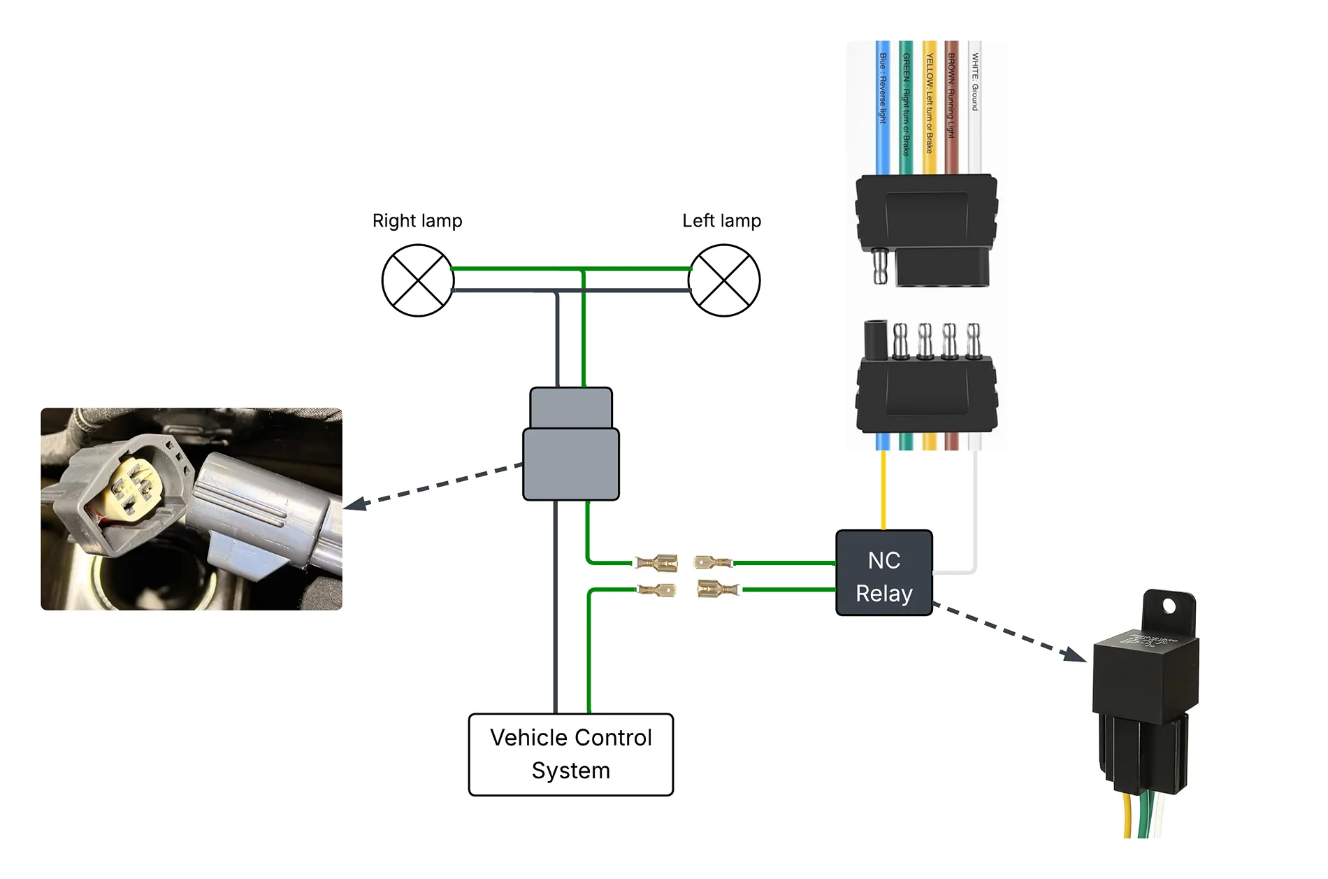

Please share the how to. Would love to do this.
Here's the list of materials:
- Normally closed relay (https://a.co/d/03cVJaVq)
- Spade connectors, or your favorite connector style (https://a.co/d/0eiLNlww)
- Cable taps (https://a.co/d/0aA29s7C)
- Waterproofing tape (e.g. vulcanizing)
If you want to avoid tapping into the hitch cables, or you have other things you want to wire up, you can add:
- CURT 56584 inline tap (https://a.co/d/00n6uj5D)
- Five way flat trailer plug (https://a.co/d/0aj40GCX)
The build is very simple:
1. Remove the spare tire (I find it makes it easier to work under the back)
2. Locate the connector for the license plate lights

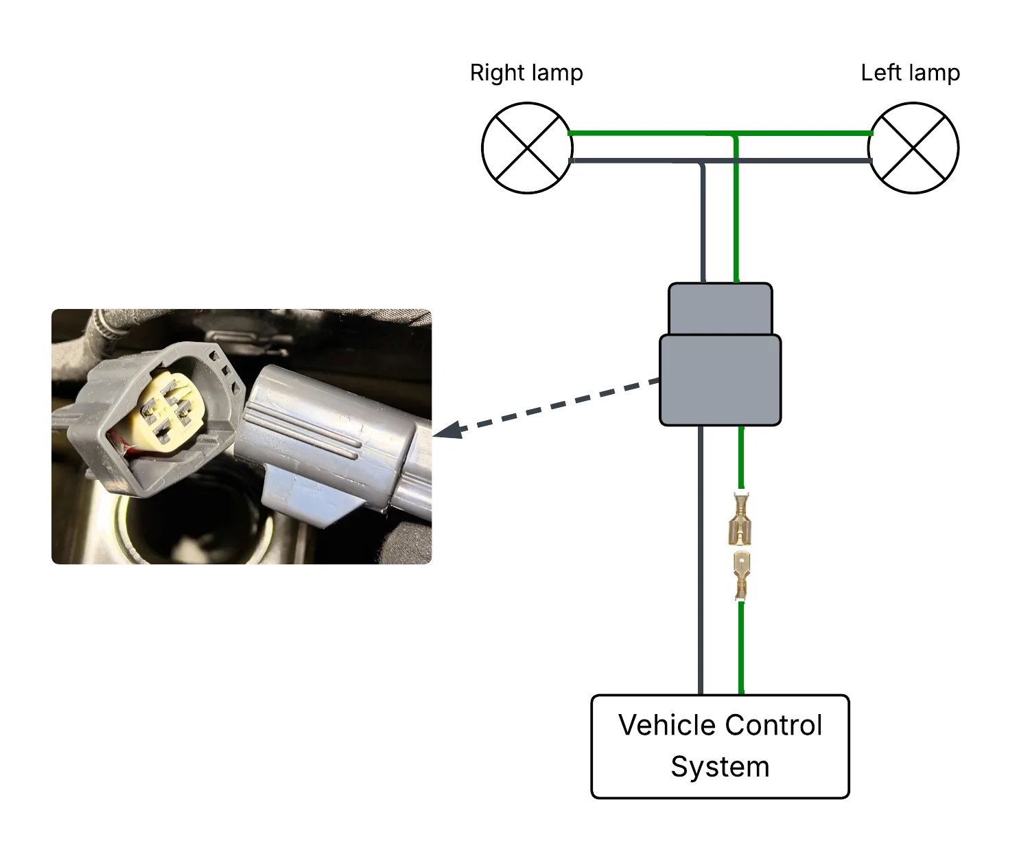

3. Cut the green wire, and add a spade connector, male on one side, female on the other.
4. Plug the connector and check your lights still come on. This is how you'd undo the mod if you ever wanted to.
5. Add two spade connectors to the green cables of the relays, one male, one female.
6(a). Add two cable taps to the reverse light wire and the ground wire on the hitch receiver. Add spade connectors to the yellow and white cables of your relay. The yellow cable then goes to the reverse light tap, and the white cable to the white cable tap.
6(b). If you went with the cleaner option, remove the hitch wiring connector, insert the Curt tap, and solder the blue wire of the five-way plug to your relay's yellow wire, and the white wire to the white wire respectively.
7. Once everything is connected, test! With your car parked, turn the rear camera on and watch the washed out image. Put the car in reverse, and see how the license plate lights turn off.
8. Waterproof the joints at will. Fix the relay to your nearest post or cable run.
Below is a wiring diagram of the finished mod:

If you ever want to undo the mod, this is how:
Jeep Gladiator Reverse camera license plate light bleed - my fix Rear light mod undon

You are lucky - after mine blew apart, I checked it out thoroughly - poor crimps, wire too large for the terminals and look at the ends of the wire -are those neat and straight?
Is this acceptable? I'd never ever let work out of my shop looking like this.
I'd use the proper size and type of wire, and ends properly crimped with the correct tool.
The wire is stiff, heavy and, well, take a look.......
That is not good. I wouldn't let that slide. You should reach out to the guy see what he has to say. The response would be helpful for the future buyers.
If you have any questions, shout!
It would be helpful if you edit your original posting and include this detail there, so the potential DIYers are not searching through posts to see the important bits.
Done! Have added a note at the top of my first post linking to the reply on this page.
