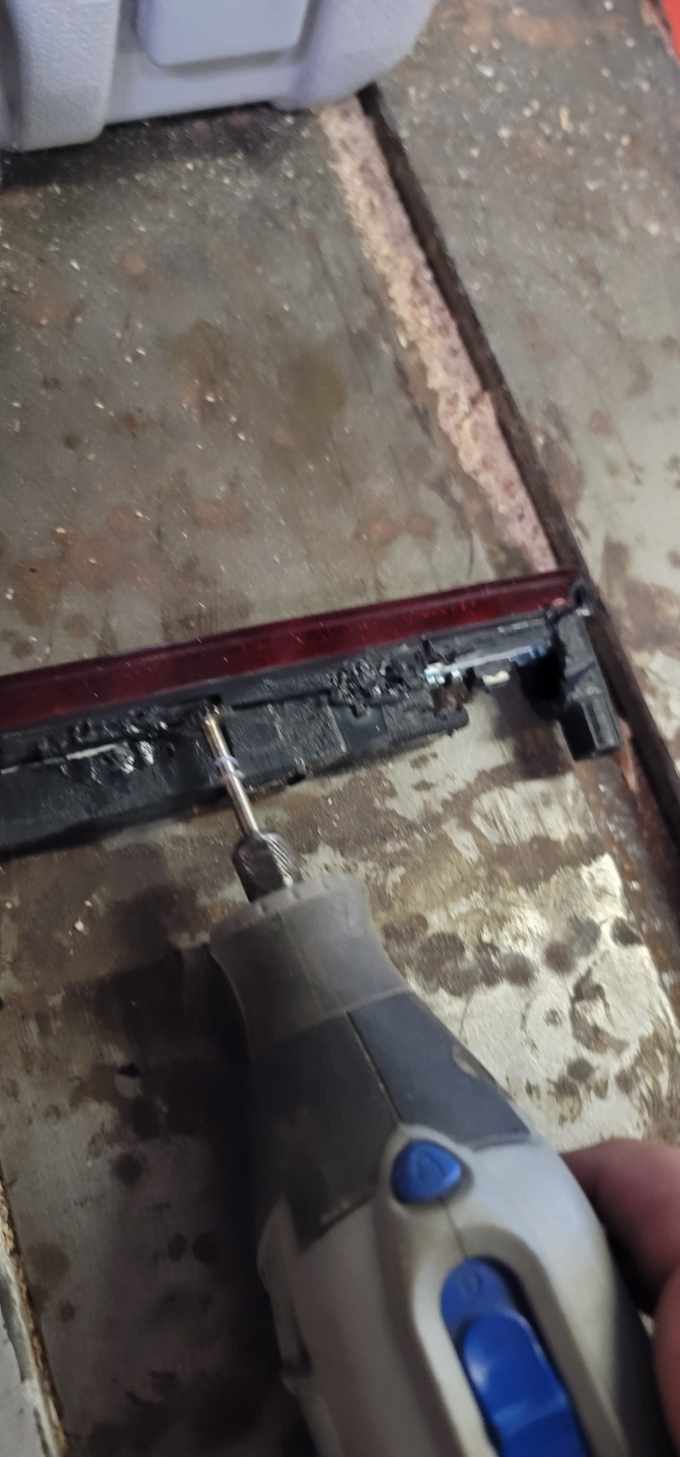

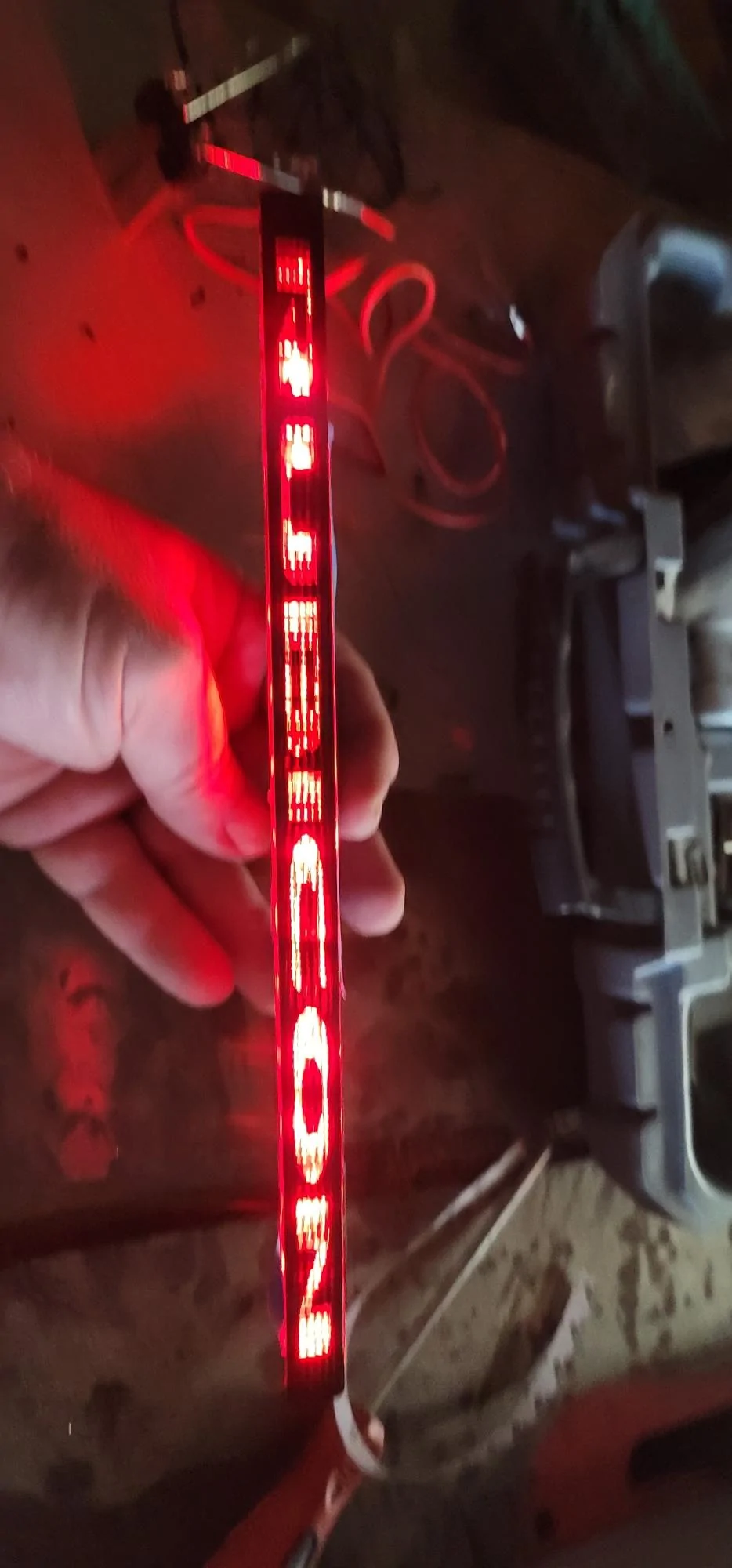

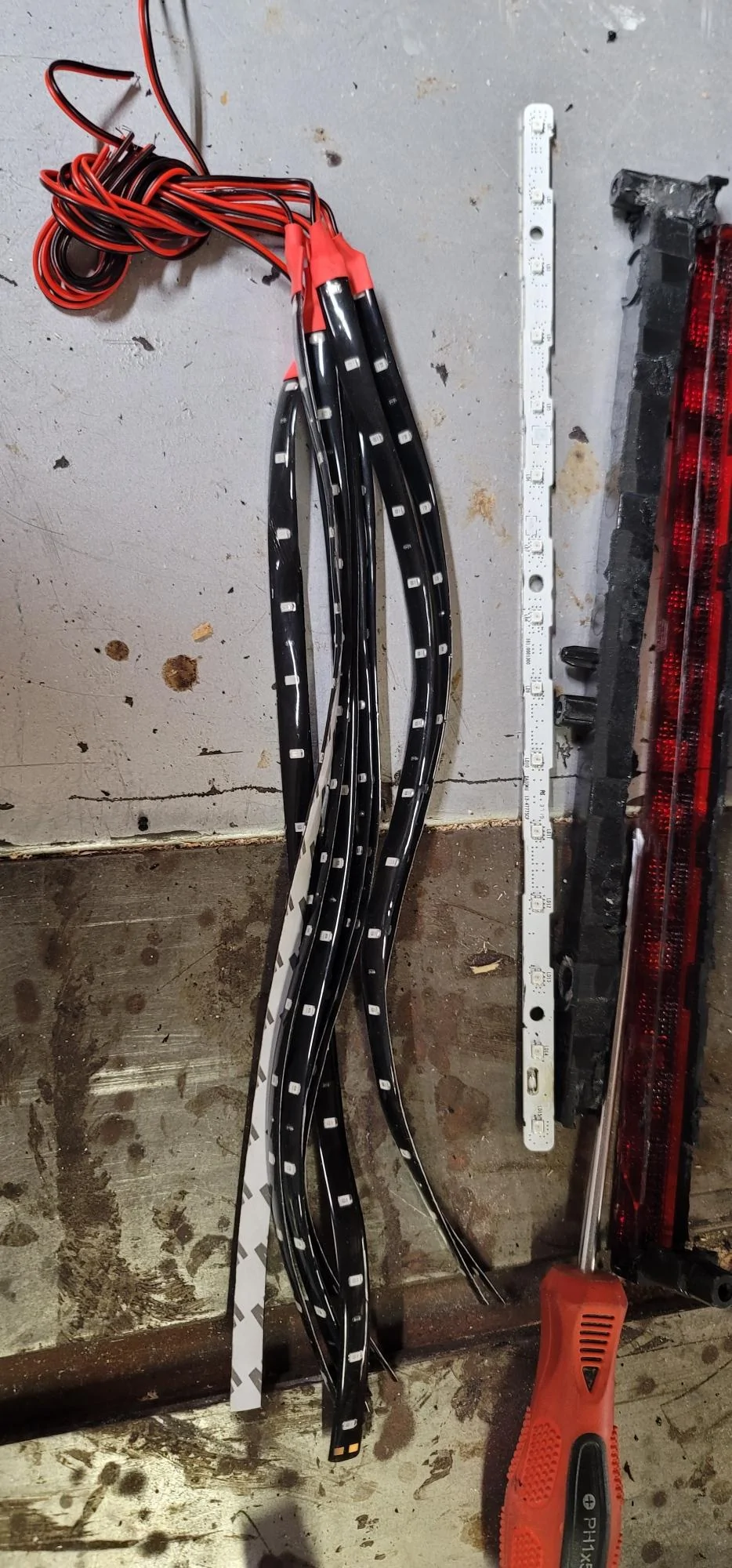

So my 3rd brake light was out. Did some looking and it was the pins on the printed led board broken loose. I had them fixed until reinstalling and they broke loose again and messed up the whole thing. So to the web we go. Found an $8 set of 8 led strips. When they came in, I simply removed the light, opened it up with a Dremel, stuck the strip over the now dead led's and passed the wires outside. Some hot glue closed it up and a quick connection to the wires, leaving the plug in place so it's still usable, and it's fixed. he bench test was simply using a 9 volt battery. The outside of this light was now n bad shape after 2 openings with a Dremel but it's still usable.

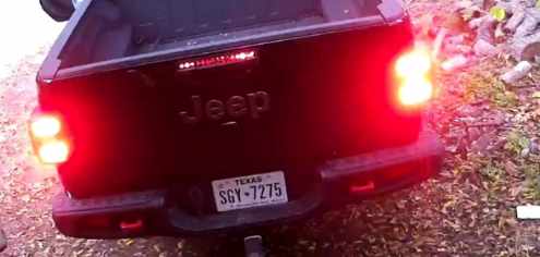

I think the sticker looks cool. I haven't got anyone to step on the brake yet since I got her glowing again. (the pic was from a sucoority cam)

I was about to order a replacement and then I found this, so why not try it. Plus I have 7 more tries or the possibility of adding a strip somewhere else, like my bike, to increase it's brake light visibility. I did leave my plug intact so a replacement is still a possibility.
